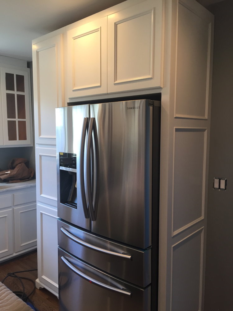

About the same time the floors were done, my father-in-law was finishing up the base cabinets. My wife had given him a few pictures, told him a few details and he did the rest.
Roger is a cabinet building ninja. And now I'm sad I don't have cabinet making skills or carpenter skills.
Thanks, that was the best solution I could come up with. I think the wide gap (~ 13") worked in my favor to soften the blow of totally different floor species and size in that close proximity.
Don't worry grasshopper, I have studied from the master. I have learned his ways, and now I will charge you ridiculous amount to teach you what I know....:massey:.....no pocket holes here. He's old school.

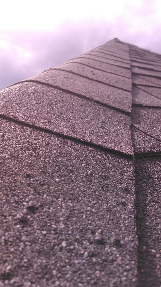

Also saw this while I was up there. Anybody ever seen shingles do this before? It was only on hip/ridge shingles.
Blister rash. Manufacturers mostly say it's a cosmetic defect but over time, the granules wear off faster and create wear craters.
Call the manufacturer and see if it's warrantied. I doubt it is but it might be. So long as you document the issue and contact them, if there is an issue later you'll have the record of the notification.
They will definitely be hearing from me. The roof is definitely not a place I want to settle with "cosmetic defects".

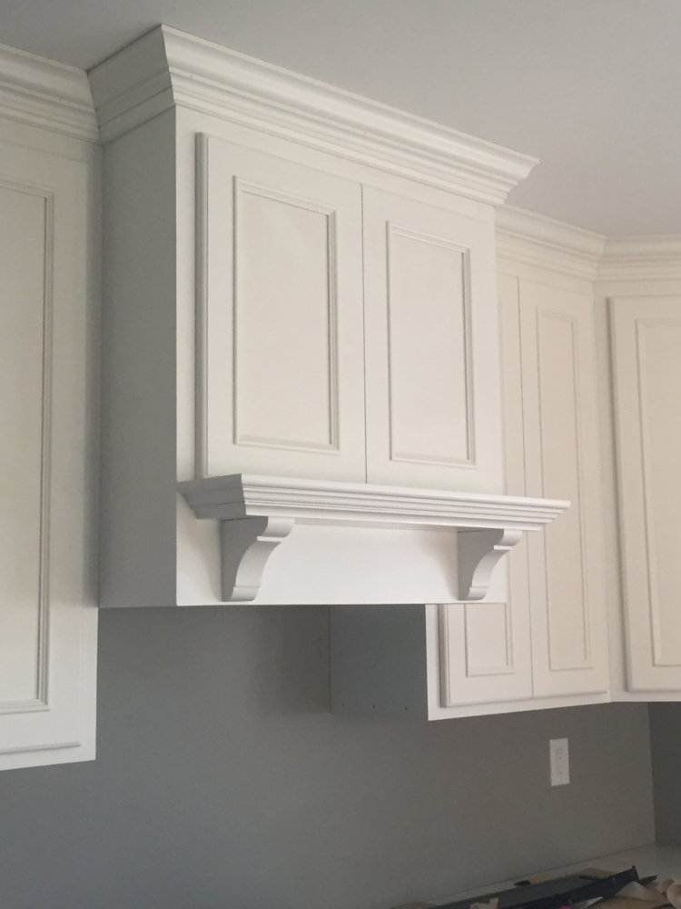

Here are some more pics of the cabinets almost done..... I think this is the only one of the uppers i took. When I get this thread up to speed I might go back and do a finished run through of fresh pics. The cabinet over the range had to be reworked because it was way to low to start with.
Reworked and not in the way now

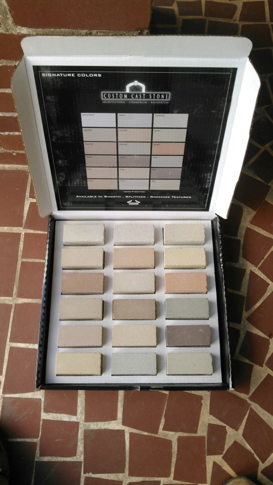

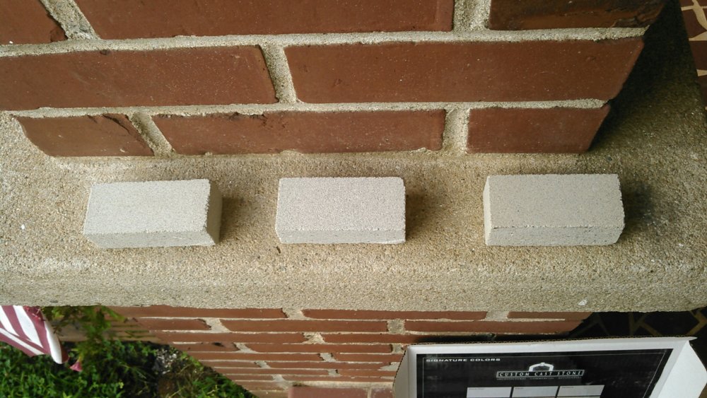

I emailed @trailhugger and @shawn buddy David from Old Castle to get a little info ,a quote, and maybe some samples of the cast stone I could look at. He must have thought I was semi local and offered to bring me some. After I told him I was located near Asheville, he said he would get a colleague that works the Asheville area to get some samples to me. I give him my address and he emails me back to say that the guy that works this area is from Marion and actually lives on the same road I do about a mile away! It turns out I know him (first name only) but I never knew what he did for a living. The internet is a useful tool to help connect you with the people that live on the same road that you do :lol:....
So now I got a few sample for my wife to look through to see what she thinks about it.
Natural white. Natural. Can't remember
Trying to decide if I need to try to match these concrete caps.....

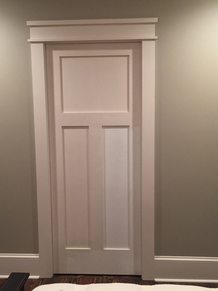

Wife wanted 3 panel craftsman style doors so I searched around to find some I liked. I wanted a solid core door with no profile on the rails and stiles. I'm not that good at internet searching but I found some that fit what I was looking that weren't super expensive (solid wood door prices :eek:) A friend did get me some quotes for some solid doors from one of his Amish furniture suppliers that was about the same but I had already ordered these. I think these will be a little more dimensionally stable plus they came primed so thats a plus.

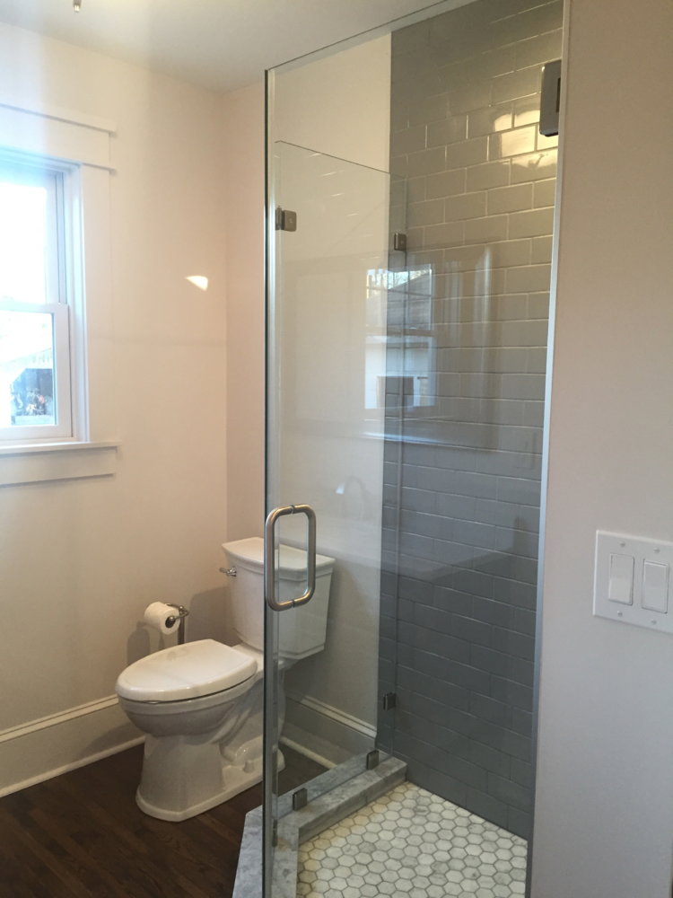

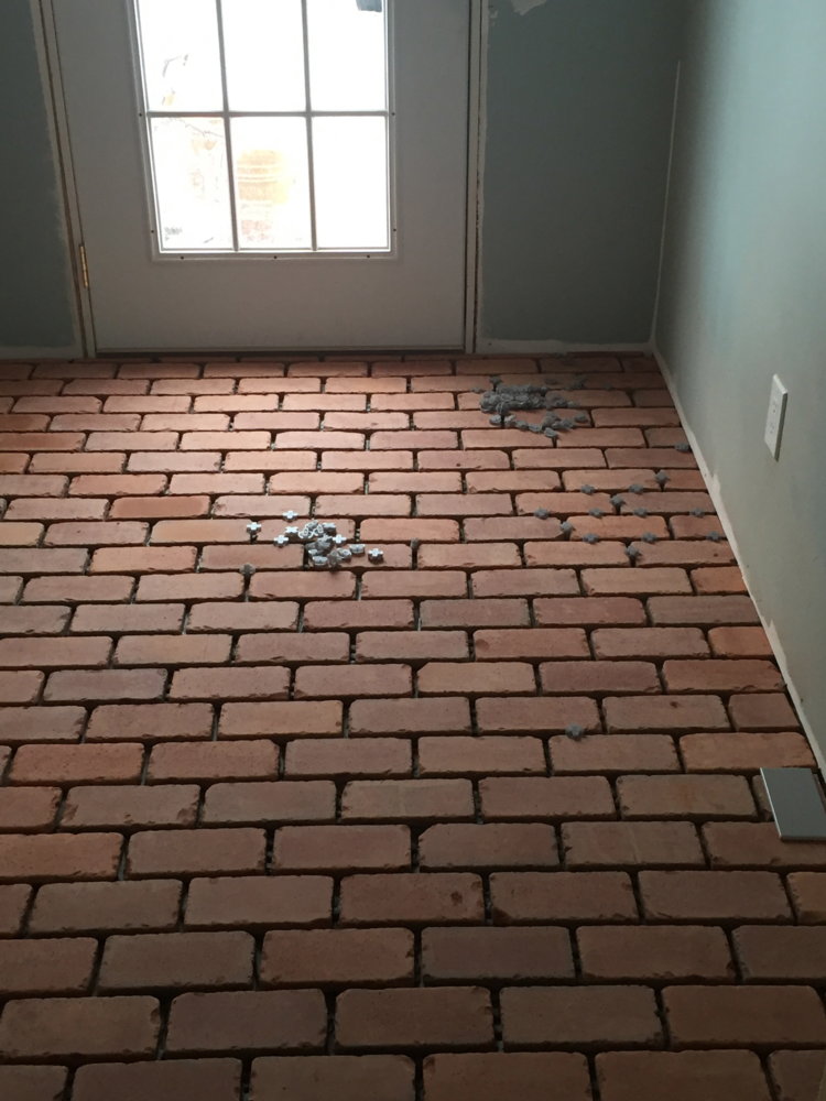

I wasn't able to do my own tile work due to time constraints, but they did ok......could have been better in some spots. I used some tumble brick for the mud room/ wash room. It was about 15/16th inch thick with leveled out nice with the wood floor transition.
Hard to get a good pic in a small bathroom....

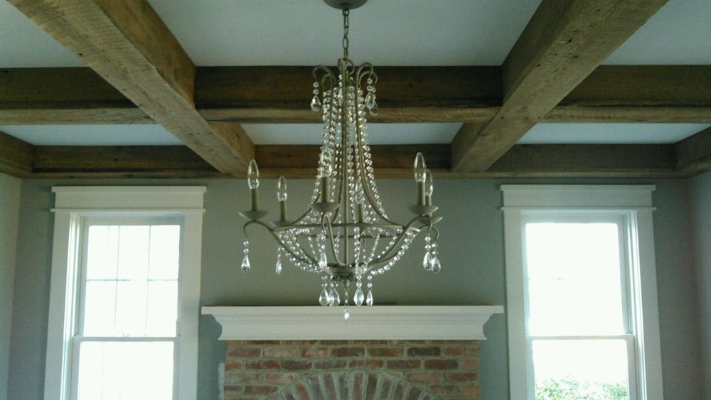

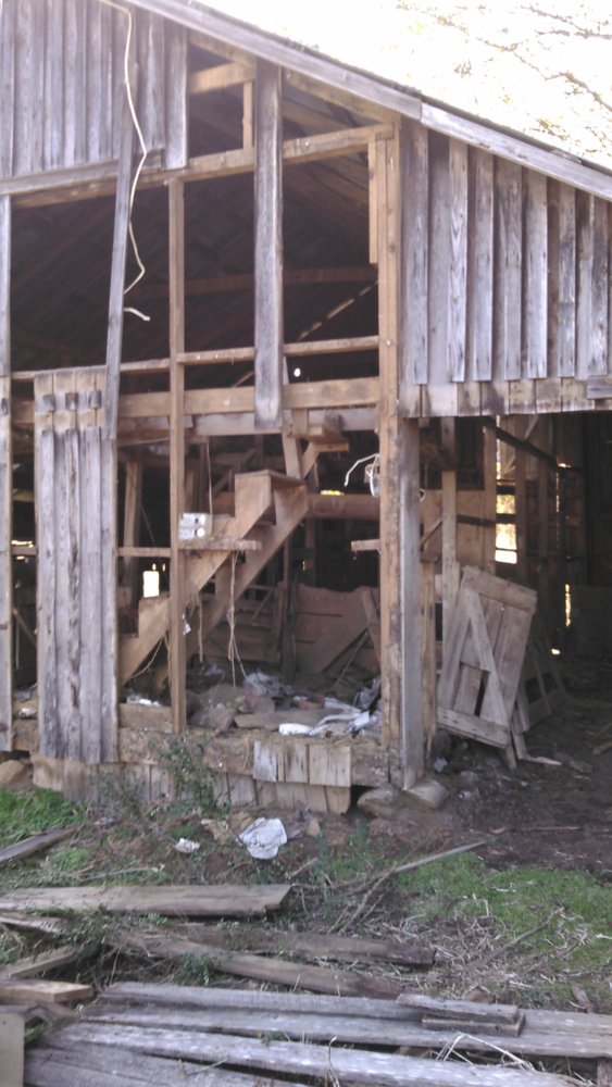

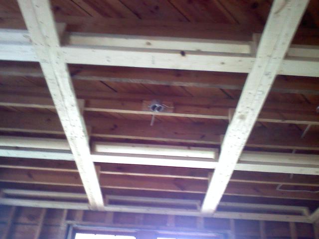

My favorite....Dining room ceiling. The wife wanted nice and pretty wood, but me and her best friend talked her into some barn wood. This came off one of my barns. I hit it with a wire brush to knock off some of the horse poop and a light sanding to knock a little of the rough off.
Is that a wrapped beam or solid?
House is looking sweet.
Thanks! It's just wrapped. Although I did see some 8x8s sills under the barn in a few places that I will dig out eventually.
My wood supply :cool: . Lots of good oak. Most of the wood that I used on the beams came off of interior wall. I wish it could have been a little more weathered grey though
This was my tic tac toe framing
Right after the wire brush and a light sanding
4x12 carrera marble pieces on the sides of the curb, the top was 1.5" x 6" marble too. It was leftover scraps the countertop guy had at his shop

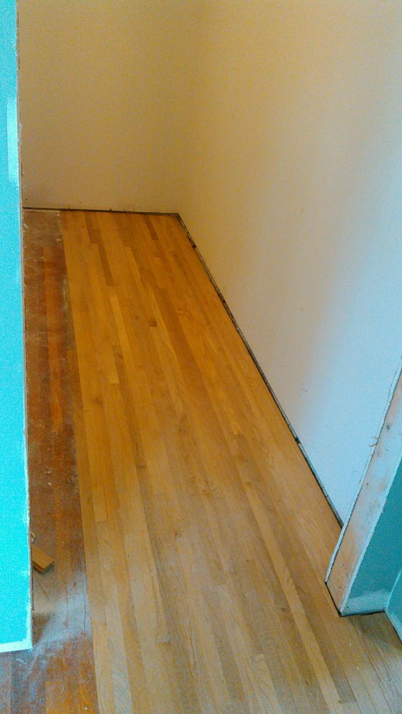

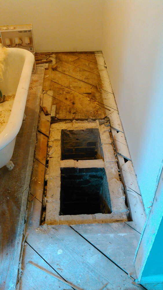

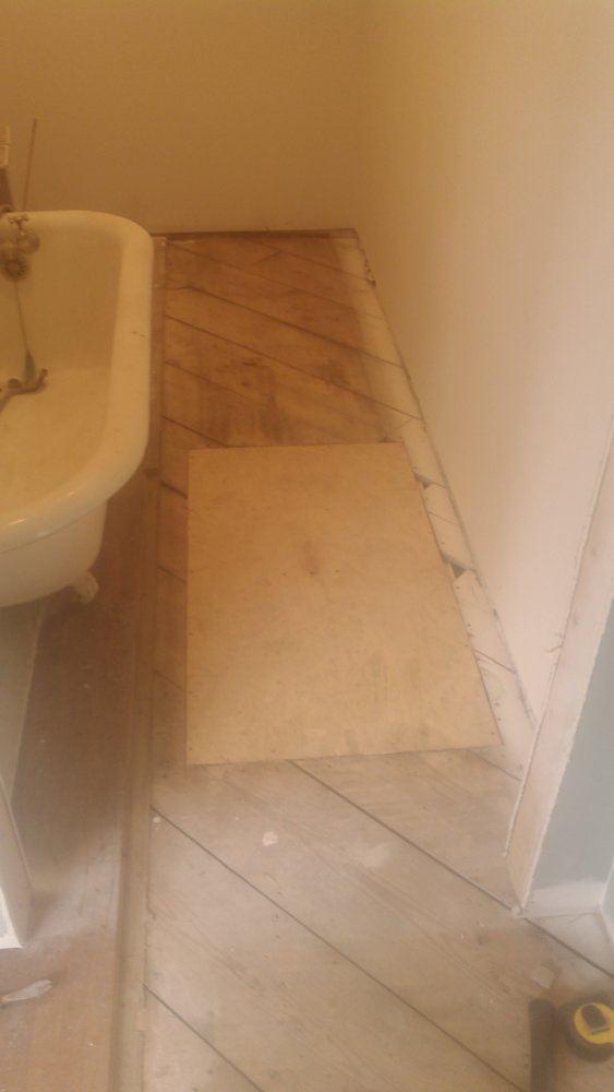

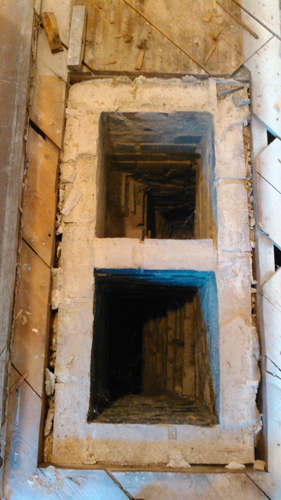

I had some free time yesterday so I decided to do some flooring on the second floor. Patched the subfloor over the chimney in master closet.

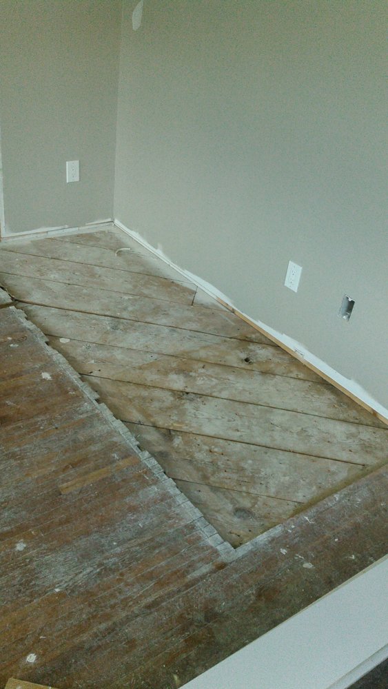

Also started patching in where a closet used to be in another bedroom.
Chiseled out the short pieces and using the toothless Porter Wagner to get the rest.

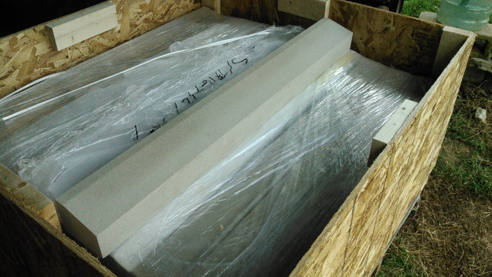

Got my cast stone sills delivered. Anybody have recommendations on how to make straight/clean cuts? I'm going to get someone else to put them in, just wondering on the best way to trim them.
Crosscuts, to trim to length?
Concrete saw, brick/block saw, or a chop saw with a diamond blade. Chop saw might not like it as much as something more optimized for concrete cutting. Something with a diamond blade. Cast stone is just a concrete-based product I'm pretty sure, so anything that can cut concrete with aggregate should work.
Are those about 3.5-4 inches thick?
Always see people cutting them with a quickie saw
Yea, I need to trim 6" off of them. They are 4" thick in the back,3" at the front. I've cut block and brick with a skill saw and diamond blade before, just didn't know the preferred method for cutting this stuff.
That's what I figured they would use...I guess a man that uses one a lot could make a cleaner/straighter cut than I could with one.

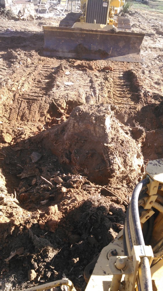

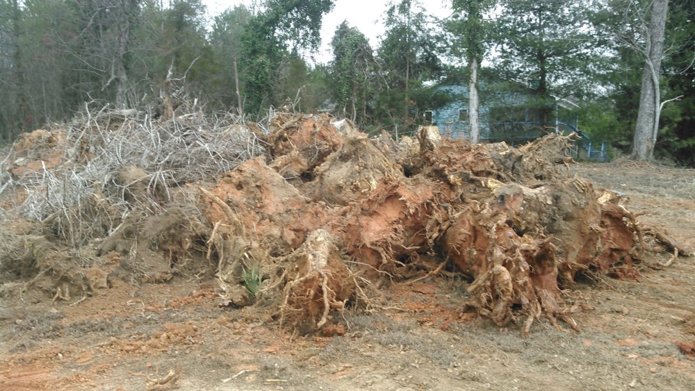

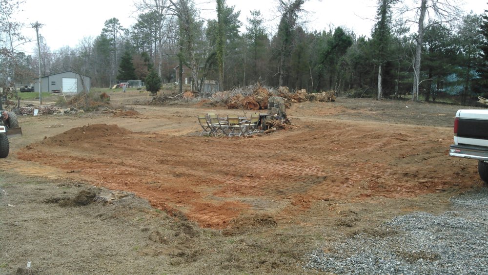

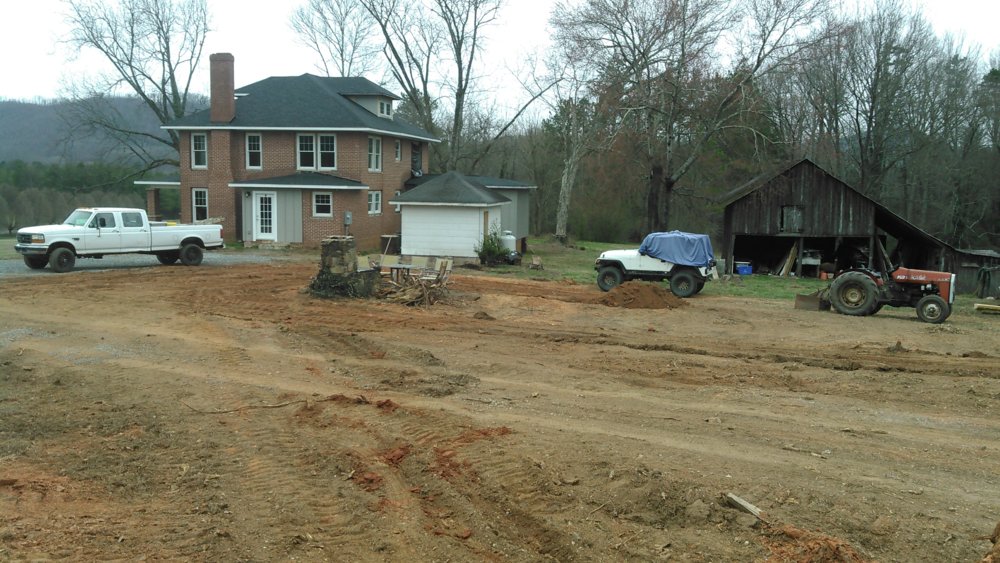

Me and dad have been taking turns digging up stumps when we had some free time. I would say there were probably 30 or so in this area, all fairly good sized. Still about half that many left around the house to get as well.
Don't know what stump grinding costs these days but Looks like the backhoe and dozer are paying for themselves. Y'all got it looking good out by the hibachi
