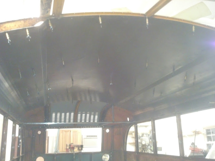

Here is the ceiling panels in place. There will be two 14" roof vent fans that will be installed, for ventilation obviously, but also to keep from having to patch two holes in the roof panels.
The side sections of the ceiling were originally 4 pieces per side, the center section was 4 pieces as well, to eliminate seams (and save some time), they are 10' long each, so went from 12 pieces down to 3... Guess the bus shop didn't have access to a 10' shear back in 1936...
alh4.googleusercontent.com__LwLPRjeGa_A_UODY103Zu5I_AAAAAAAACK6fff8e45dea51f89f298117a354315b6.jpg
OK to show my ignorance - what are all of the pins sticking out of the sheetmetal?
They are called Clecos. They come in several versions. The most common is a spring loaded style which require a pair of Cleco pliers to install and remove. There are also threaded style clecos which provide more clamping force than the spring loaded versions. They typically are either 1/8" or 3/16" diameter and are used to temporarily hold sheetmetal in place as you are fabricating and or mocking up. They are used in aircraft fabrication and racing as well.
