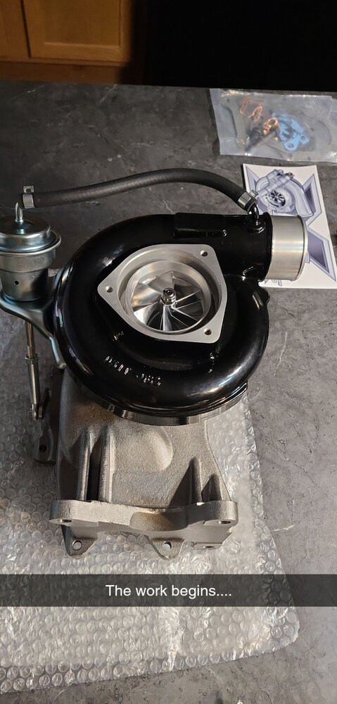

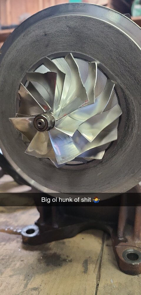

Took the turbo out today. The shaft isn't bent, turbine is fine, but the bearings were a little galled up. There's no oiling issues, so it's likely from the wheel breaking and throwing it terribly out of balance.
My thoughts are...it's his lightweight wheel. The blades are pretty flexible. I mean, it's 7075 T6 aluminum, after all. It likely didn't enjoy any of the towing I did and sometimes you could heard it bark or stall. That's a lot of stress when all that air is trying to stop the compressor wheel. It probably fatigued and eventually just let go. I never ran it without the intake and air filter on it, so I know it didn't ingest anything to kill the wheel. I work on airplanes, so very very particular about FOD free near spinny stuff :D
That, or there was an assembly issue. Either way...it's out, not running another Tater Built turbo, and the new one will be here tomorrow.
I'm wondering if going to slightly larger exhaust manifolds and up pipes killed the exhaust velocity, but I feel like I'm overthinking that. The turbo was just too damn big and that's what he wanted to sell me. It needed 2000-2100 rpm to be happy. At this point, I just want to fix it and get my truck back up and running.

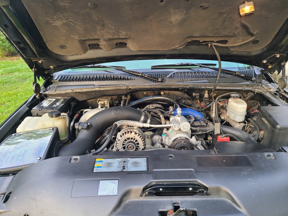

Here's some pictures from today though!

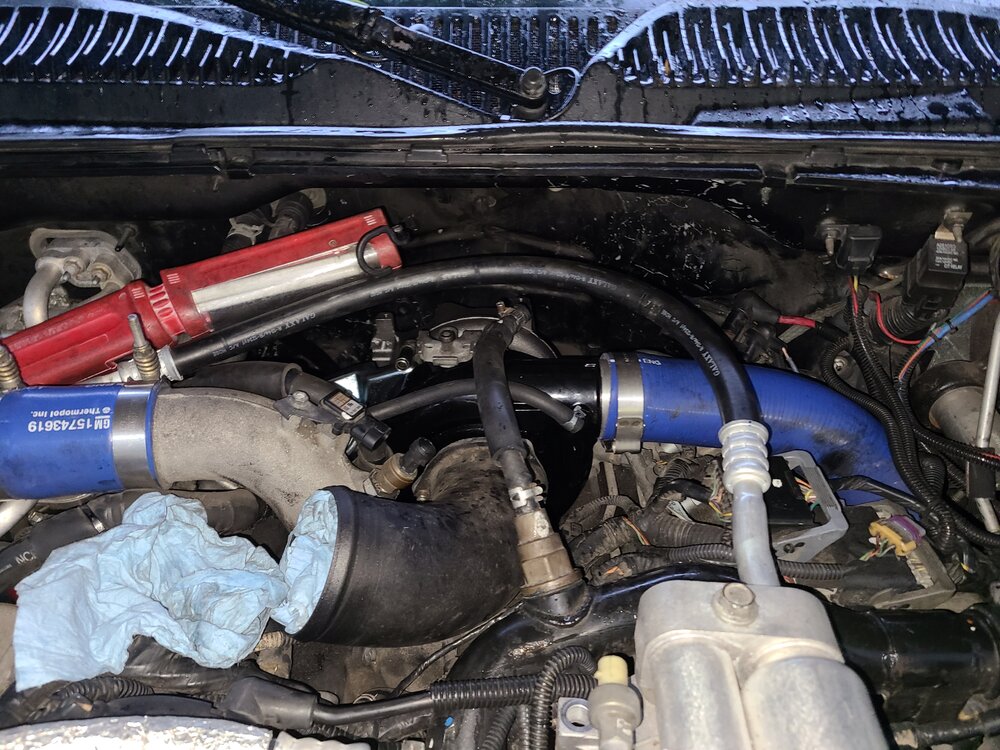

I did some Googling and YouTubing. It's possible to pull the intercooler without pulling the radiator. Looks like I'm gunna pull that out tomorrow morning. Worst case, I've actually got a spare one that I could throw in there. Might as well do it now and get it over with. I'm interested to see what's in it. It can't be too awful much. It's not like the wheel exploded and the inside of the compressor housing had surprisingly little damage or ding marks.

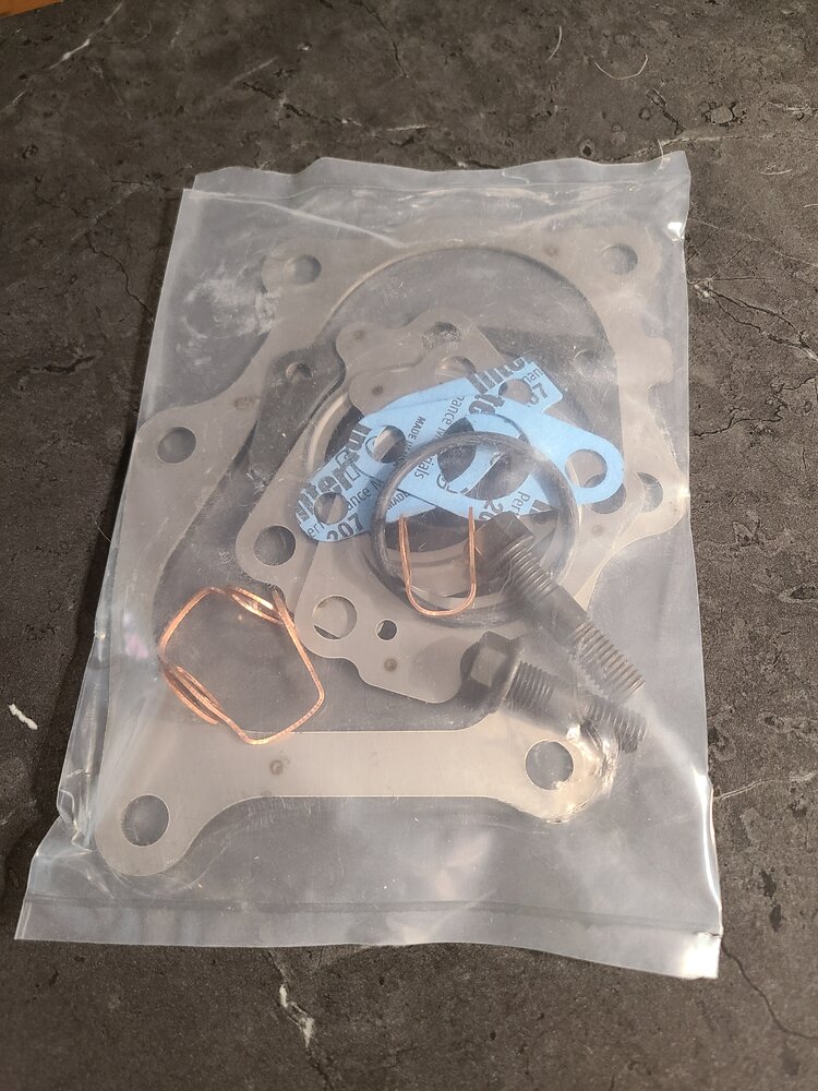

I did notice that it was really hard to get oil through the center section, but I'm pretty sure it's assembly lube and as soon and oil pressure hits and it gets a little heat, it'll be just fine.
I was pretty impressed with what LDS sends. Obviously, you get the standard install gaskets and these are real, quality items. They even send two new studs for the downpipe so you don't have to pull the old ones from your prior turbo. It's the little things that really make all the difference!

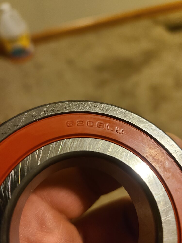

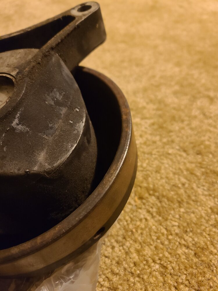

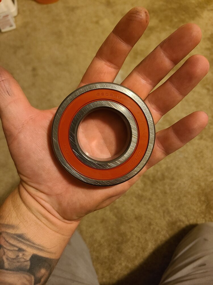

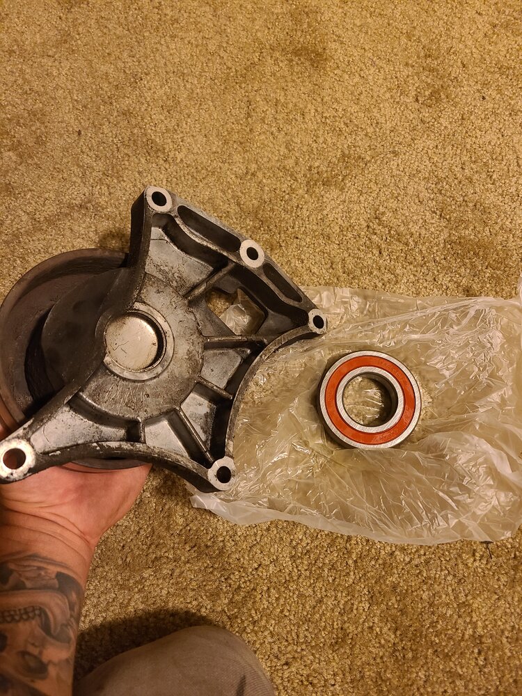

Had some noises arise and couldn't exactly pinpoint them, but it sounded grumpy, like a roaring roller bearing, but from under the hood. So, I pulled the belt off and checked everything on the belt drive. One idler pulley was a little slack and the fan hub had some play.
I ordered two new idlers and a fan hub. Got them installed today and it seems to have cleared up. I'll find out next week on the 6 hour drive back home.
I also ordered the bearings to rebuild the fan hub I removed. I've seen one write up on it, but very few pictures...so...guess what I'll be doing next!

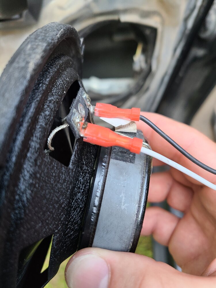

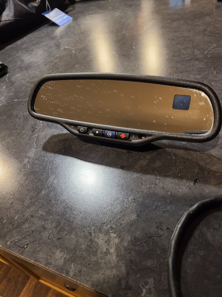

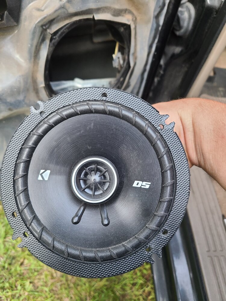

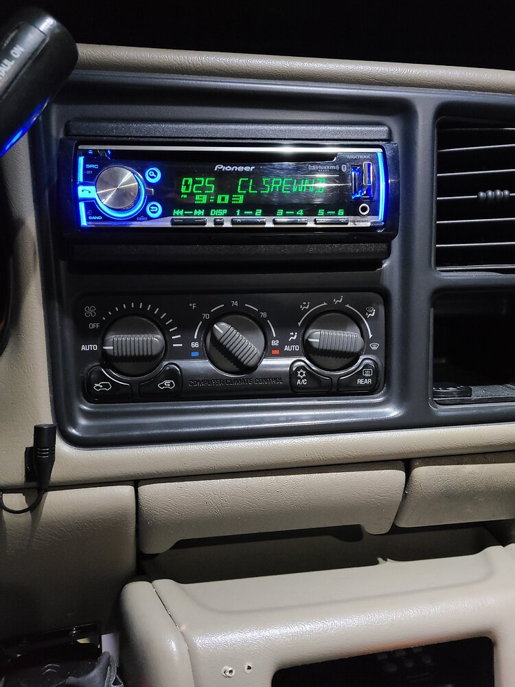

Knocked out a few small and annoying things today. Adjusted the tail pipe, fixed the temp/compass display in the rear view, and figured out/fixed a dead speaker issue. The wires had popped off and fallen in the door. Next small issue will be the lights in the HVAC controls. They died about a week ago.

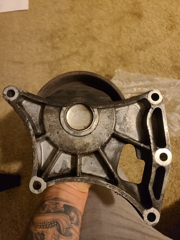

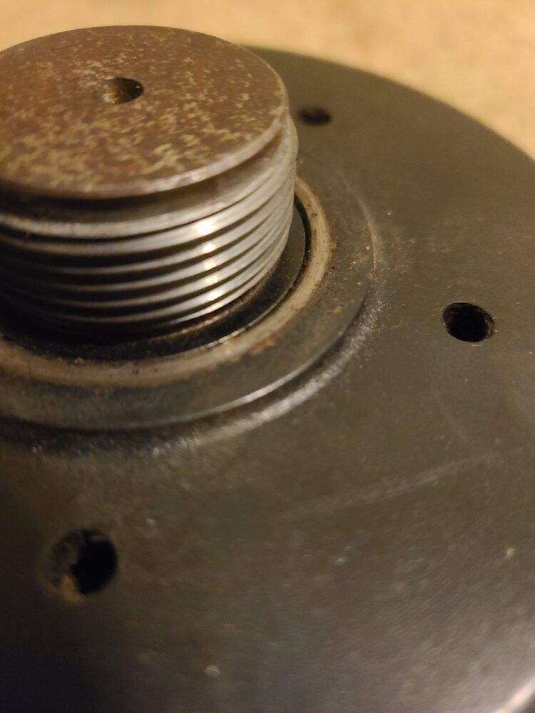

I also started looking at the fan hub. Looks like it won't be too hard to get torn down, I'll just need a press. Gotta knock the freeze plug out of the back, press the pulley off, the pull a snap ring out of the front, and press the guts out of the bracket. Reassembly is the reverse of disassembly :D
Had to put some solder on the back side of the LCD board.

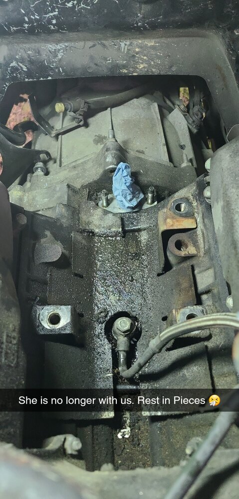

Well, guys, it happened. At 336,830 miles...this thing decided that 4th gear was no longer necessary. No amount of clearing the code or resetting the transmission would get it working again....and 35 miles from home at my buddy's house. I even got pulled over on my way home.
I don't have 4,000 bucks to rebuild the transmission, so she's down for a while.
