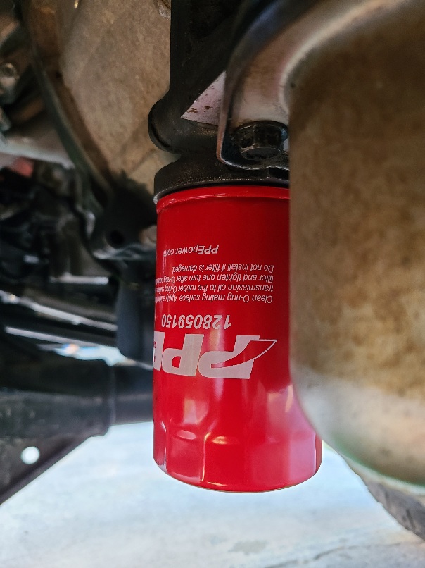

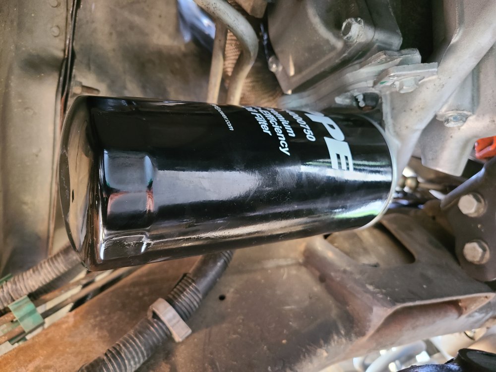

Got my spin on trans filter swapped out today for the bigger PPE one. We'll see how it does. I suppose I just got a little excited, but it won't hurt anything that I gave the transmission a good servicing.
Here's the new, big ass oil filter. You can see the size of the new transmission filter too. So far, so good.

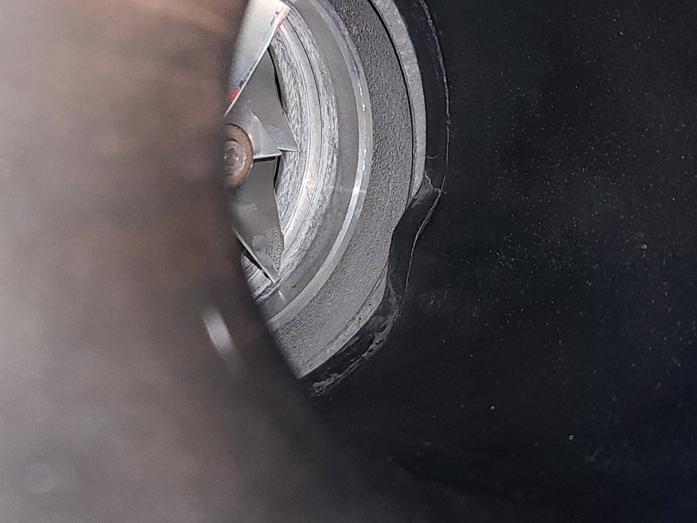

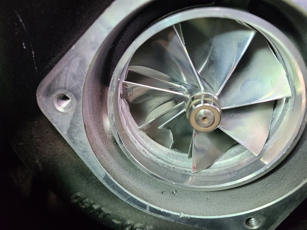

Well, I was planning to change the turbo again, but now I don't have a choice. Driving home from supper last night with the cruise set on 65, it started making noise. I just went and did a little digging and found that the 7 blade compressor wheel is now a 6 blade compressor wheel.
I'm sure the guy that built it won't warranty it and I don't exactly want him to. I've got to figure out what I'm going to replace it with and get it fixed by the end of this week because I leave for work again next Monday.
Ordered up a 64mm drop in from Lincoln Diesel. Should be here Thursday. That wasn't cheap...

Dude that built the turbo texted me today. Said he could whip up a 63.5 for me and overnight it for 100 bucks. A few hours later, he says it'll be 1600 shipped. I straight up said no thanks. Not at all what I was getting from our earlier conversation. Sorry. Ordered one from somewhere else.
Anyway, all I've got left to do is unhook the oil/coolant lines and unbolt the turbo from the block.

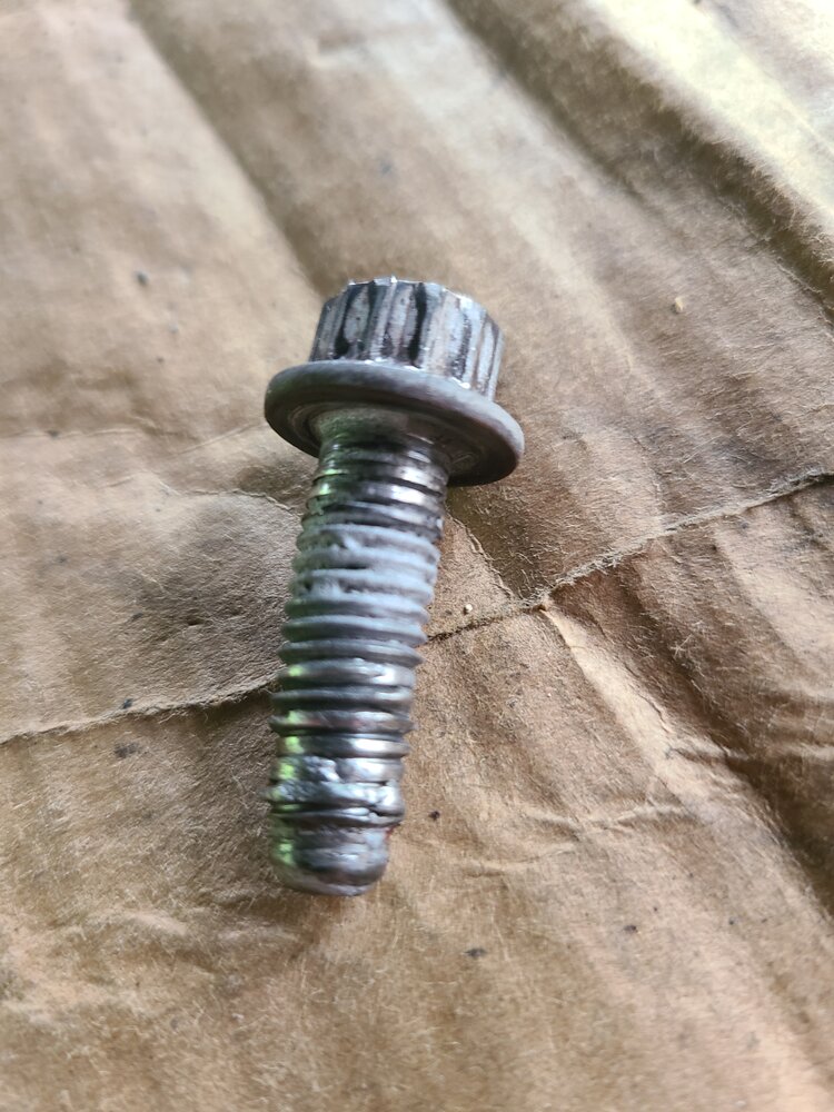

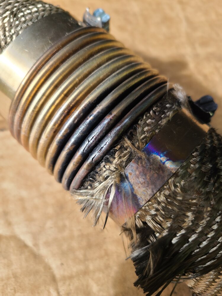

I did manage to rub a hole through one of the up pipe bellows and one of the up pipe bolts ALMOST got me, but I won. New bolts and a tap through all the holes will make it good as new.
I will have all of you know that I didn't say a single cuss word, offend Jesus, insinuate that this bolt's mother provided sexual favors for monitary contributions, nor did I suggest its parents were never married! I was gentle, yet firm. Yes, it IS bent and has several missing threads.
He said he wasn't sure why it gave up. I am...he builds shitty turbos! I have no idea why he thought I'd want to run another one of them, unless it was free.
BTW, that bellow is getting TIG welded and I'll make a spacer for the downpipe flange. Same guy that's going to weld it has a plasma table. 1/4 material and the thickness of two gaskets oughta make it clear. I hope...
