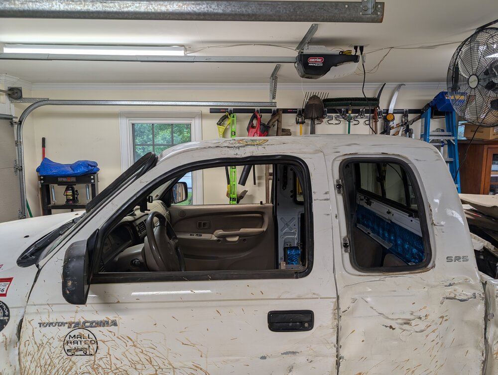

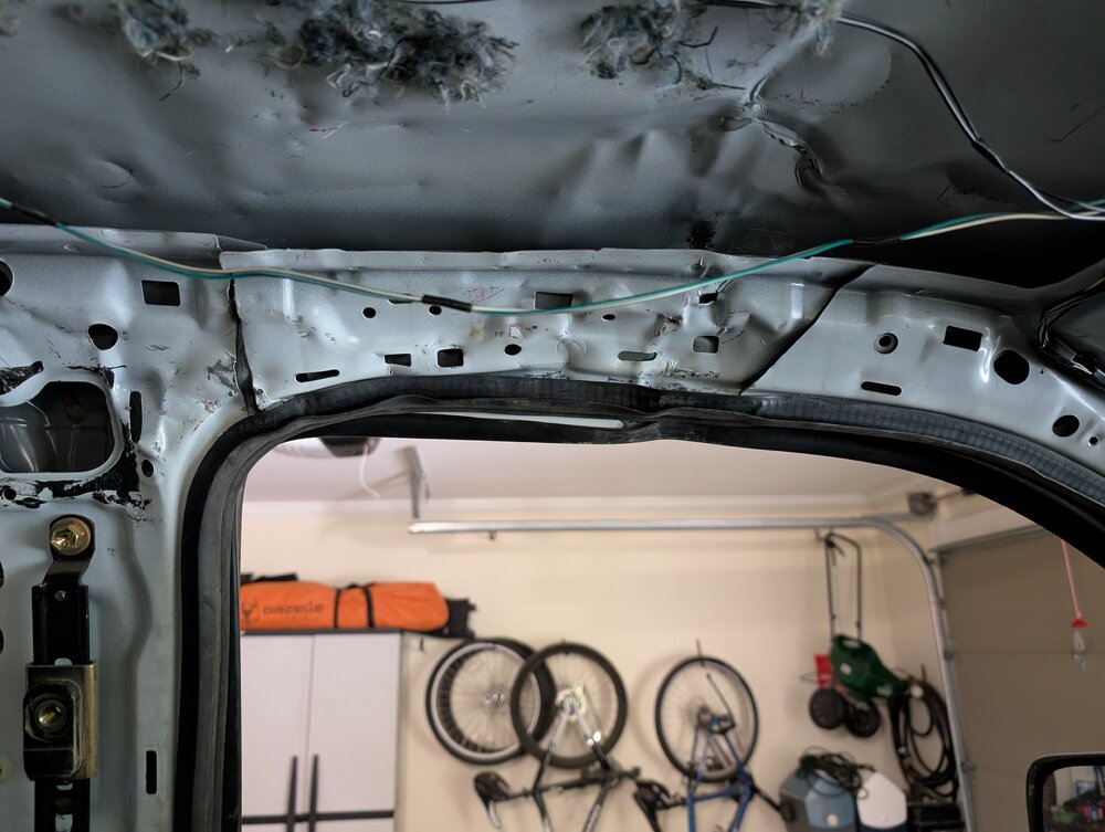

Thinking about cutting this wrinkled section above the door out, pushing the roof out and welding it back in, or even getting a new one from Toyota. Most of the damage has been done post flop pushing the roof up with the hilift after getting it back over and then me pushing and banging on it with the porta power. I assume this is part of the cab crash structure, what does the equally unqualified forum members think? Am I going to kill myself and a bus load of nuns?
Medium term plan is probably an exo cage for this truck since I still street drive it and don't want to be banging off an internal cage in this small cab.
It's not going to win any best in show awards, but the door shuts now, the window goes all the way up and the "V" is just about gone
I need a new door, but it's good enough for summer wheeling season and until one falls in my lap. I think the A pillar has a slight bend, I'm going to try to fix that later in the year, probably right around the time I'm going to replace the windshield.

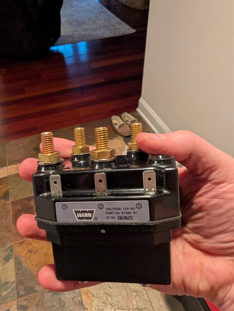

Ranch was good, didn't wheel it as much as I wanted to as it was me and 8 buggies and they wanted to hit all the buggy stuff, but it was fun anyway! My winch took a shit, I'm pretty sure my 20yr old solenoids finally shit the bed, going to upgrade it to a contactor because the internet said it's better.

I wish they had these when I originally tossed the winch in the truck, crazy how small this is!
Debating if I'm doing an in cab controller or just using a remote.

They are so much better than solenoid packs in every way. I would wire up an in cab switch AND wire up the remote plug somewhere near the front of the truck in case you find yourself in a precarious situation where you need to be outside of your truck to winch.

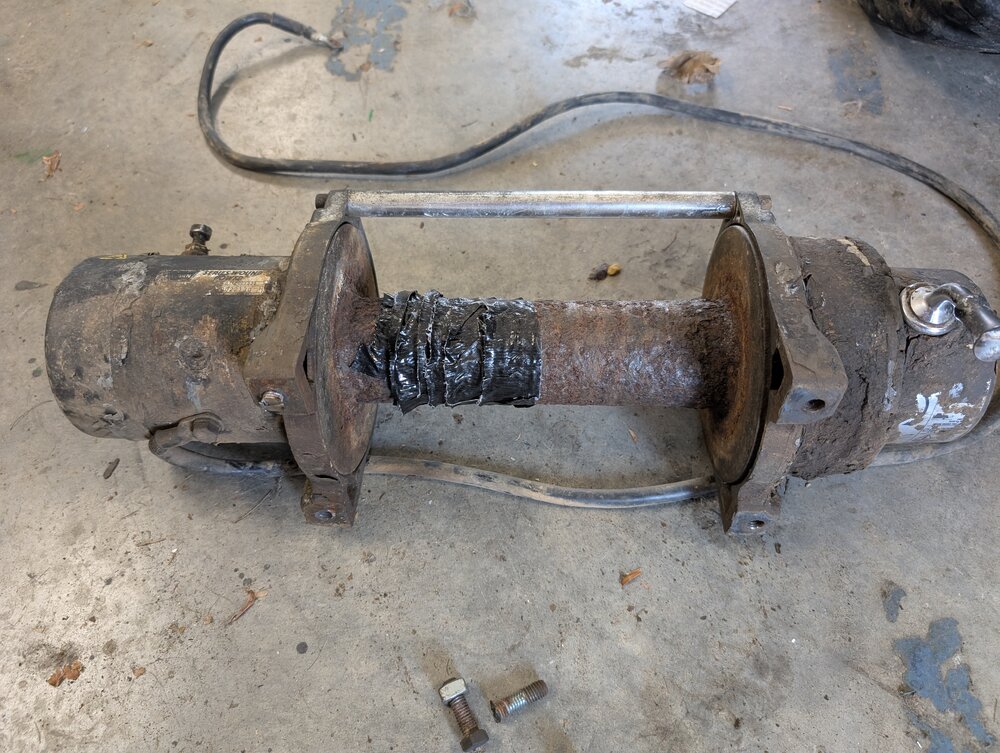

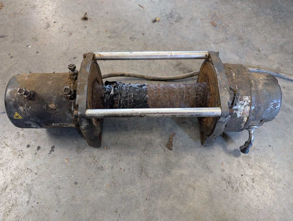

I bought everything to overhaul the winch, even the fancy aeroshell grease, and I'm out in the garage waiting for some charcoal to heat so I hook the controller up, wiggle it and it works, figures LOL. Looks like I have a loose pin in the controller. I think I'm going to pull the winch off anyway and rebuild it. It's been on the truck since 2005 and the drum is rusting very badly, may as well do some maintenance and modernize it a bit.

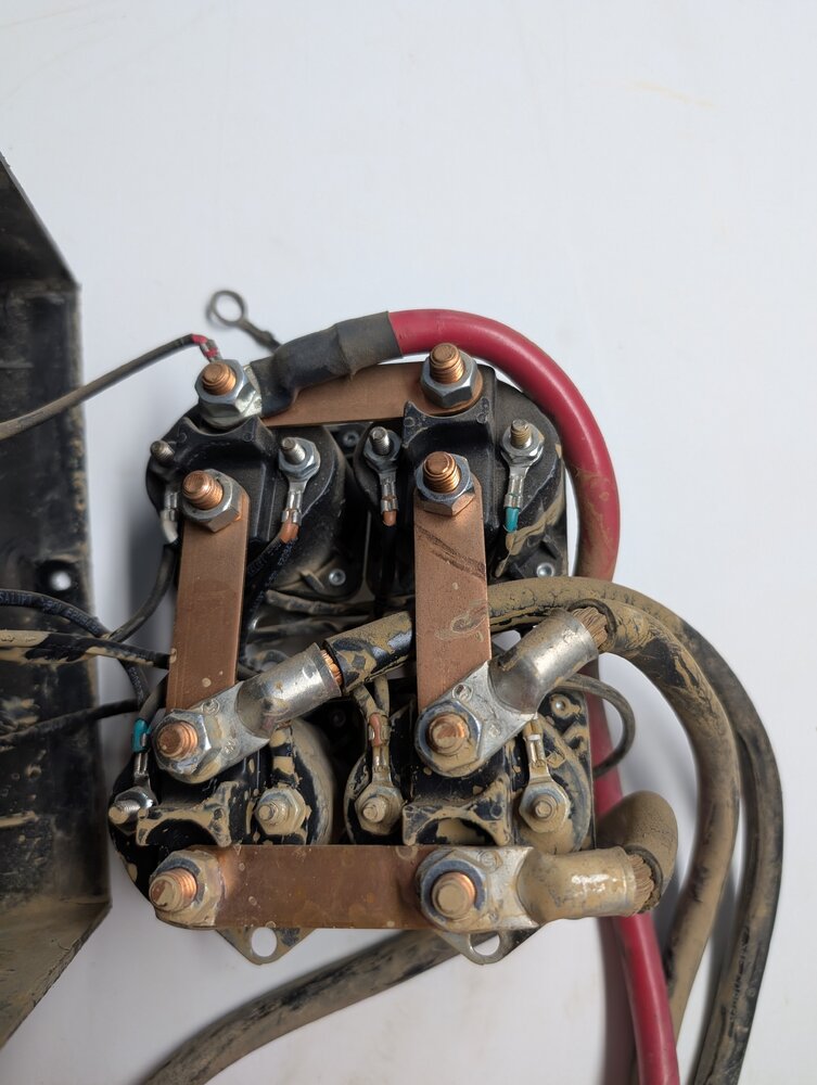

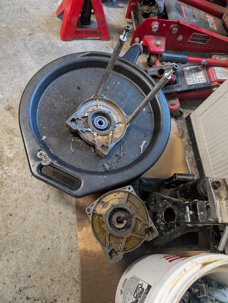

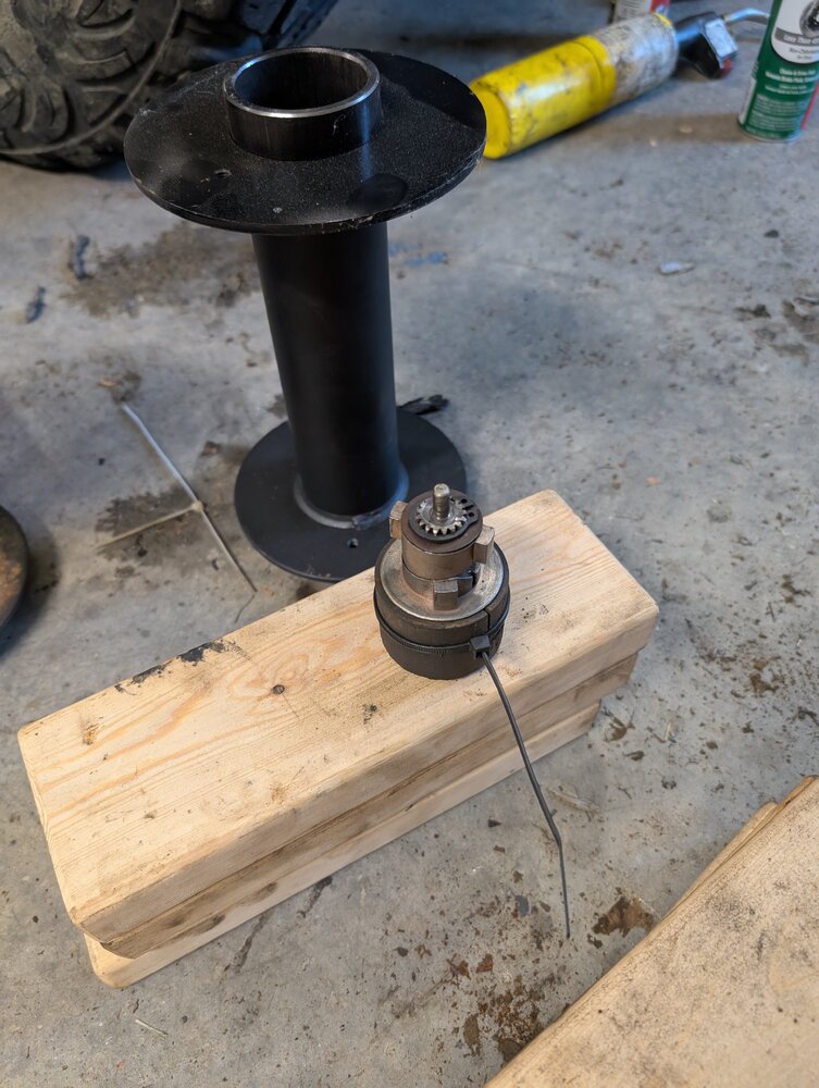

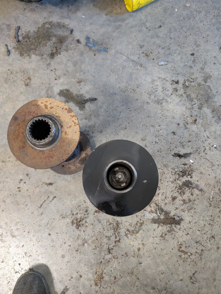

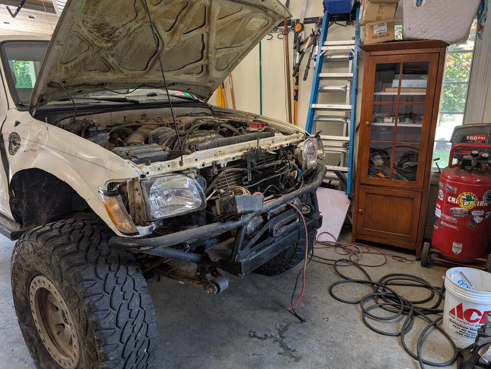

My DD Avalon blew a brake line while my wife was driving it, so while I wait on parts, the Tacomas going back into DD duty. I was planning on pulling the winch off, so I did that today. The plans are to replace the solenoids with a contactor, install a new remote plug, install an in cab controller, replace the drum, and clean and re grease the gear box.
Solenoids are not bad considering they have been on the front of my truck since 2005 and a good portion of that was in DD duty getting blasted with road salt every winter.
