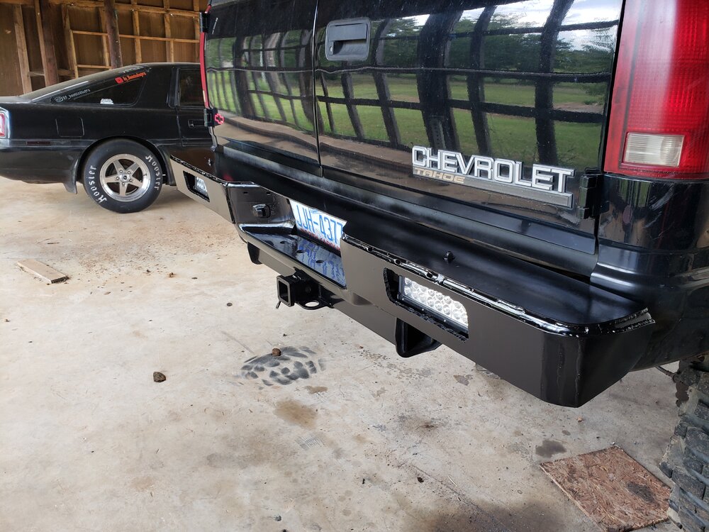

Rock lights installed and reverse switched lights mounted. My rock lights are those 6" pods that were on top so they're bright lol. Definitely coolest rig I've built, not the best looking haha.
Did you plate the stock steel unit? That is the shiniest rattle can black I've ever seen.

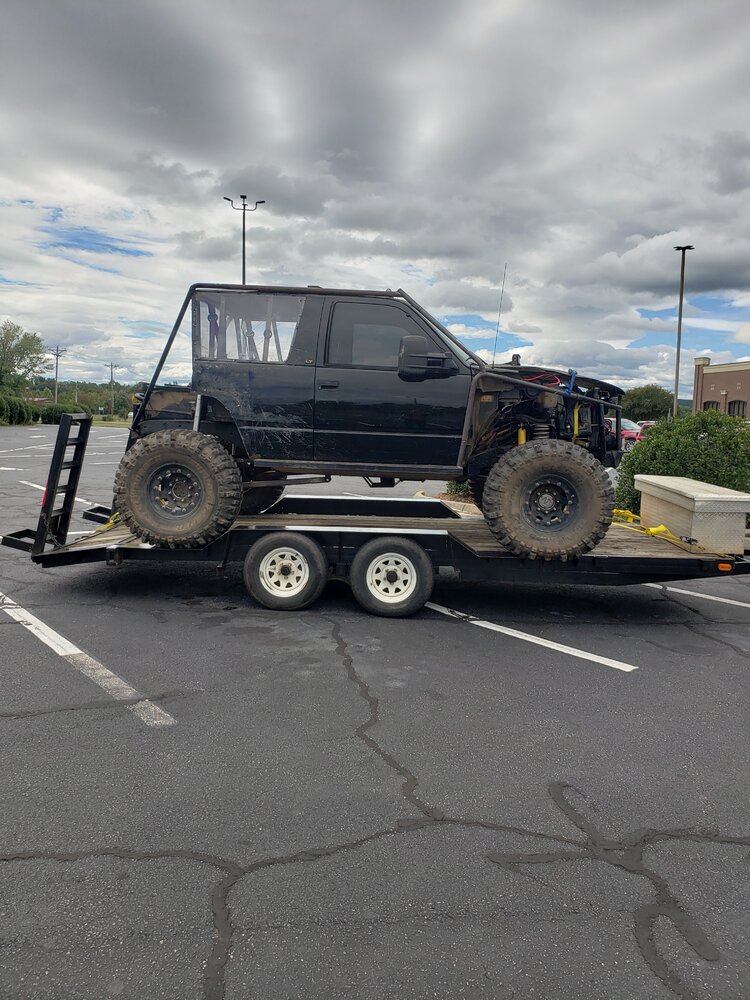

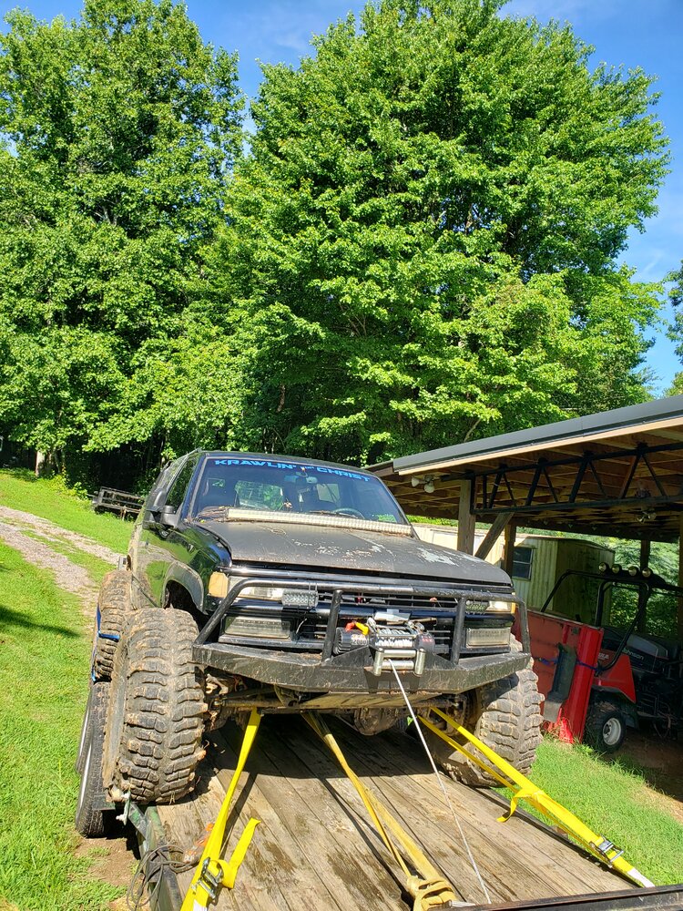

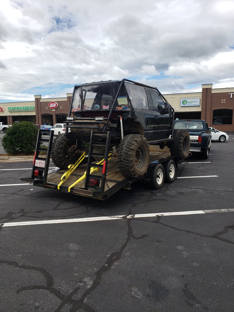

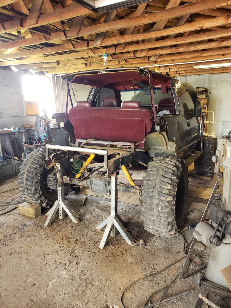

Well she's coming home after 3months of plowing through the woods...its nickname is "I-40" lmbo. Back half getting cut out, full hydro steering, rear 4link (air shock or coilovers?!), 241/241 doubler (ditch the 231 crawl box), and hoping a cage. Shes beat up pretty bad lol

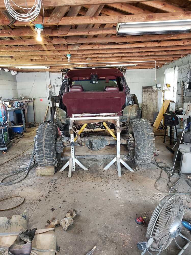

Well I did a thing lmbo...hehe its gonna be awesome heat and a/c in short cab, buggy style suspension!
16" air shocks going in the back, later on 14" coilovers in front, full cage obviously as well

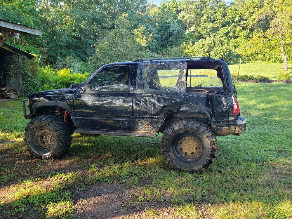

Ladies and gentlemen I present to you the Abominable Hoe..."Killdozer" vol 2...bahahahaha lolol lmbo lmao. Going out for test run. Its not finished but ready to play for now

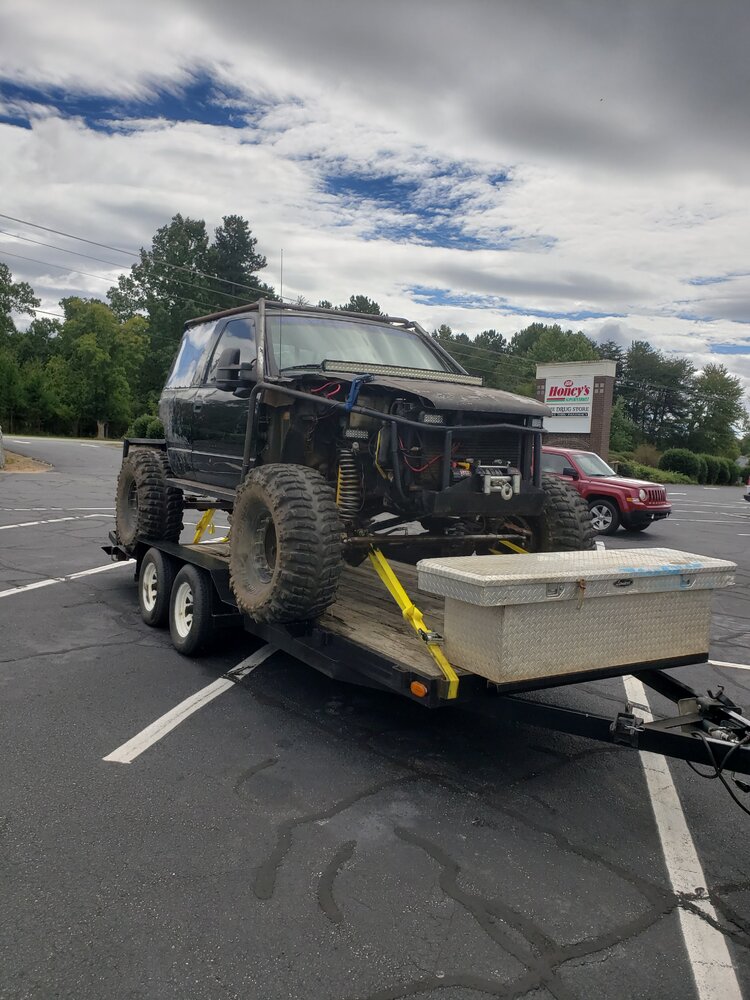

but I din't make it but maybe 1/16 of a mile into the woods and lost all steering...WTH, second brand new pump apparently burned up somehow (I'm assuming?!?!), new orbital, new lines, new pump, new fluid, everything was flushed/drained during this redoing process ....drove around my house plenty of times the last few weeks, even for 20/30min long and today I get out in the woods, made it maybe 1500ft into the woods (tight turns everywhere) and then, bam, lost all steering..new power steering fluid smelled burned up, clear though, not foamy at all, no whinning in pump either...WTH so that was fun getting the rig turned around and driven out of the woods with no steering only straight lol
Id increase fluid capacity.
It’s a stock gm pump and a 2.5x10 single ended ram with factory size return line. I don’t see how the pump isn’t starving for fluid/cavitation when the ram is fully extended.
I would…add an external reservoir. Mount ithigher than the pump so it gravity feeds
I would agree with you. When bleeding the system, he turned it to where the ram was fully extended, and said there was still fluid in the reservoir. When fully collapsed it did not overflow. Not really sure how both are happening, but I havent calc'd the volume either. More fluid definately cannot hurt.
After the 1st pump died, the magnet in the reservoir had shavings/debris on it. Id be interested to see if the 2nd on does. I suggested to try and flush the system and add a filter.
