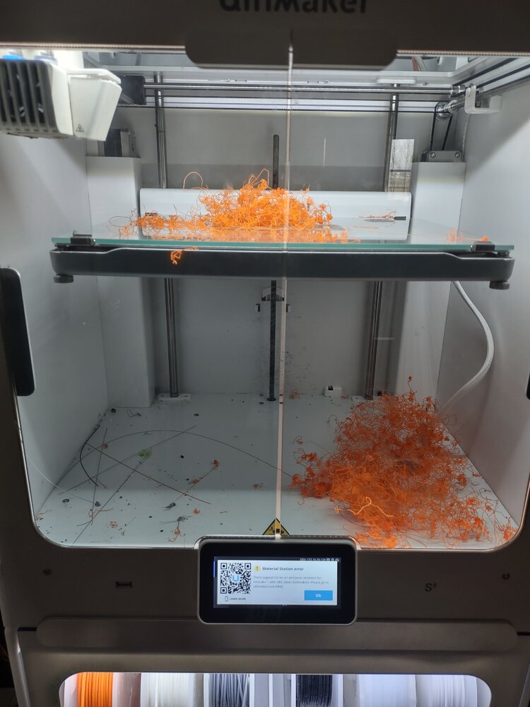

Oh how I love walking into work on Monday morning and get to play detective to figure out what failed over the weekend.
If you look closely it says that it detected a problem with extrusion. No shit. But wait... With the extruder printing Silver? Wut?
Well this was a two material print, with color interlaced. Apparently the silver clogged but it didn't figure it out for awhile, printing air... Then orange comes it, printing over air.... And voila, spaghetti.
Looks like it was even polite enough to clean off the plate at least once before refilling it again.

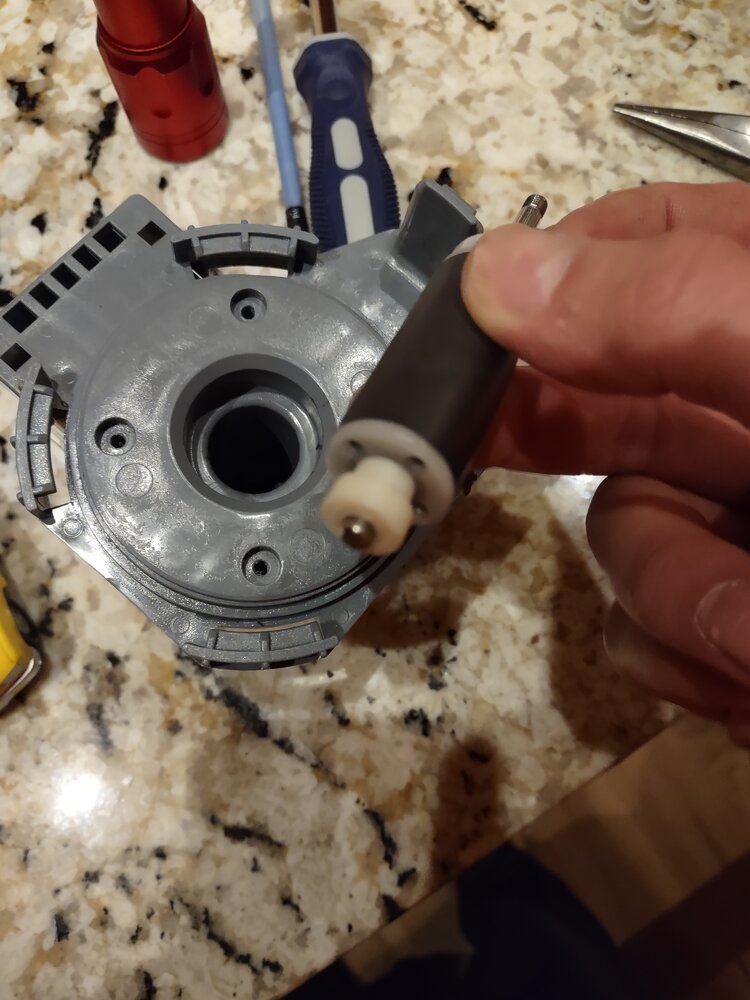

Bought our current house (2018) from my my mom after my dad passed in 2017. They had just remodeled the kitchen, new dishwasher, a KitchenAid (fairly nice one, all stainless inside/out, but not overly expensive at $650). Well maybe 2020 it messed up, I took it out and gave it to a guy to fix, he replaced the whole bottom assembly at around $200-250. Well about a year ago it messed up again, I took the circulation pump off (the pump wouldn't spin) cleaned it, reinstalled, and it has worked for awhile. Yesterday after having the same issue I took it apart again, noticed the graphite bushings in the circulation pump were worn out BAD. It would let the armature touch the plastic housing, causing it to not be able to spin. I decided I was going to try to make some bushings on the lathe, but didn't have any brass. Then my mom had the genius idea to 3d print some.... There are actually similar bushings on eBay printed out of PETG for $13 shipped. I printed these out of ABS, hopefully this will be the 'fix' for a poor manufacturer design... Actually found the file on thingiverse, but I had to modify it a touch as they were a little loose.

ABS is awfully soft for bushings though, it will likely wear out very quickly.
If you find it doesn't last, send me the STL and I'll print in Nylon for ya ;-)

I thought abs would be better that PETG? I can do PETG too. But I may just send you the file and get some nylon ones on the way to store in the drawer.

PET is actually harder than ABS.
Honestly PETG is better than ABS is pretty much every way, even less hazardous when printing. Its just more tricky to get good prints.
Send the STL, I'll drop it in the mail.

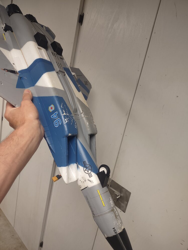

Added thrust vectoring to a little 64mm F-15. This is one of those planes I ended up with and it's a great plane, but small and therefore not super capable or fun. Found the files for the TV on thingiverse, but made the nose wheel bracket and the two black brackets to cover the TV servos. I figure it can roll on the front wheel and kind of skid on the back, better than having the servos dig into the grass. Hope to fly it this weekend, I imagine it should do 'flips' with ease. No TV for the rudder so flat spins probably are not going to happen.
