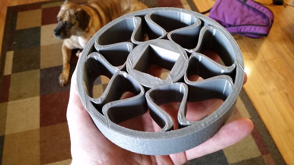

New compliant wheel design, with fuzzy outside for grip

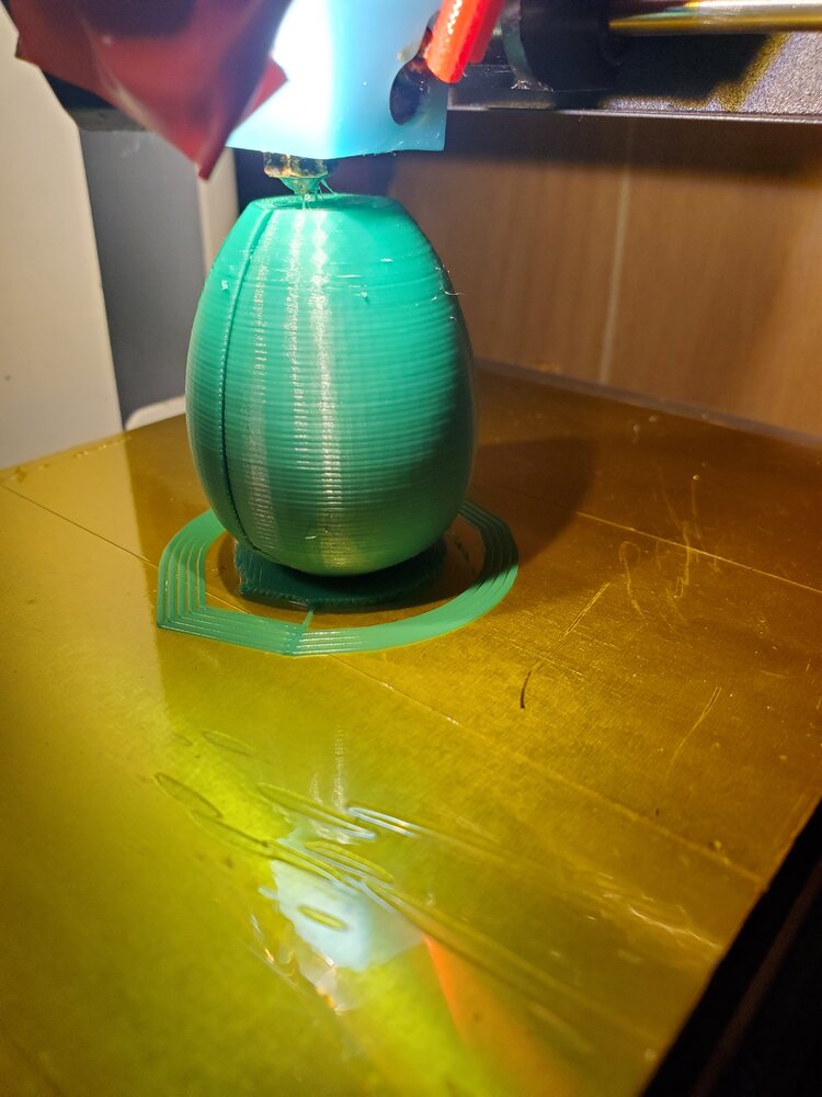

Not the prettiest, but made an egg for Easter. Also added a light. Still need a better way of attaching it.

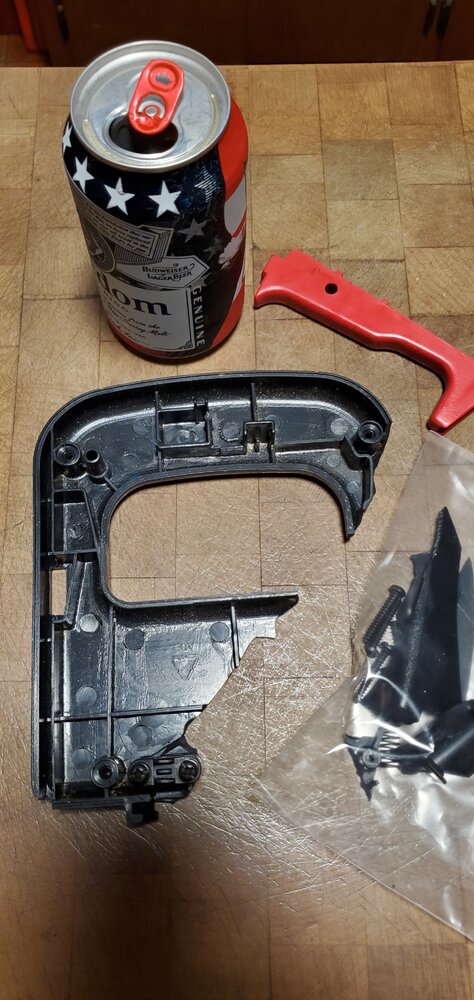

I don't know much about printing, I assume you can scan an object and make another one. Well, a piece of metal fell on my old Sears compound miter saw handle and broke it into pieces while I was reaching to get a 10x2 board. The top half is good, the bottom half shattered into many pieces, some I've not found because I have to clear a bunch of stuff out of the way to find them. If I find all of pieces and glued them back together could it be scanned and printed? AND how much would it cost? I think the saw bout $130 when I bought it on sale many years ago and the parts are gone from sears.

Not a lot of people have a scanner, but you would be surprised what it available on the web.
For instance 137.212290 Craftsman Miter Saw Handle by CalvinChristopher
See if you can find a part number or post the model of saw. If the stl file is out there, I can print it for you
That would great if you can find and build another one.

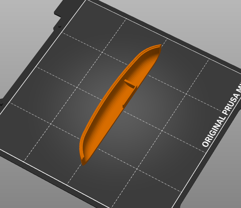

@mommucked I was able to get the files to were I think they will print good. The handle is just a little bit bigger than my print bed, so I'll have to make each handle into two pieces (see pic for example) and then glue them together. Either way if everything fits with your saw, it will still make it useable. I'll start printing tonight, but may take a couple days to finish everything. I'll get up with you later once I see how they come out.

If for whatever reason this isn't going to work for you, it should fit on my CR10. It will definitely fit in the S5 at work ;-)
This may be a case where PLA isn't going to hold up, ideally it should be in nylon (probably what it was originally) but ABS likely good enough (I can't do nylon at home yet). Or PETG. This reminds me I've been meaning to try some on the CR10.

I'll give it a try with PLA, it should be strong enough as long as he doesn't have more metal dropping on it. I also have ASA but I would worry about warp on a part that big and flat.
