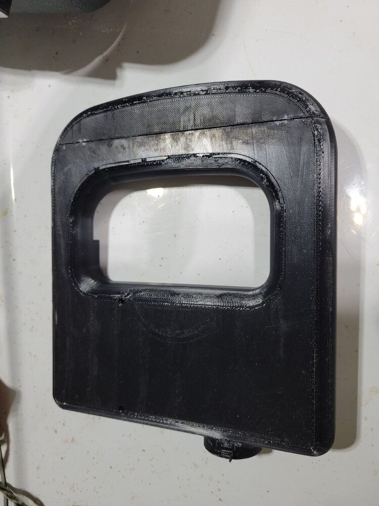

I'll give it a try with PLA, it should be strong enough as long as he doesn't have more metal dropping on it. I also have ASA but I would worry about warp on a part that big and flat.

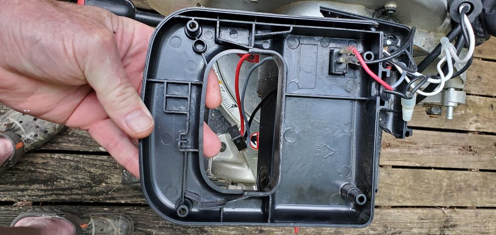

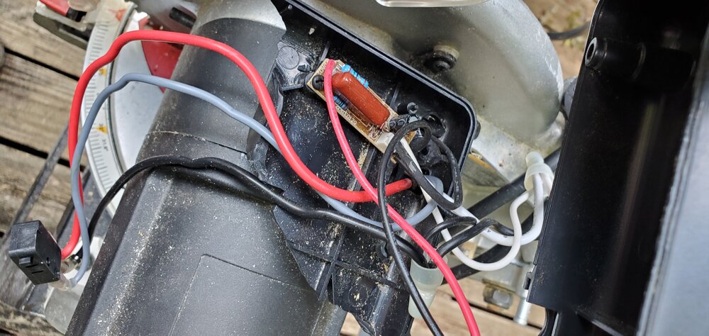

The handle was tight and strong before It was broken off. The spring that holds saw up after the cut is pretty stiff but the handle was solid/strong.The top piece is fine.
the bottom piece is in pieces, many pieces...

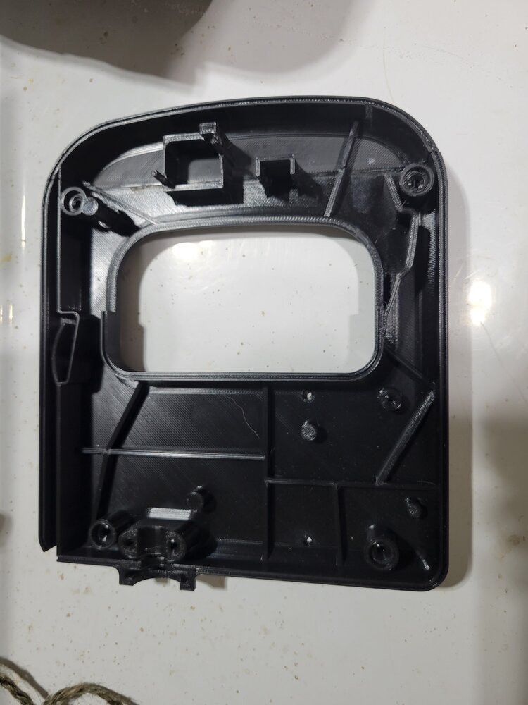

Yes I use Cura. Everything I have printed turns out fine for the most part (as in to scale). Of course have normal issues I have had to figure out like z offset, temps, etc. Have printed mostly parts for rc crawlers.

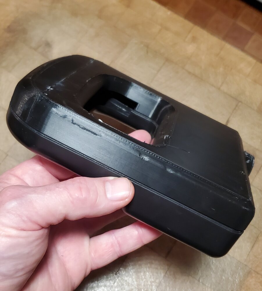

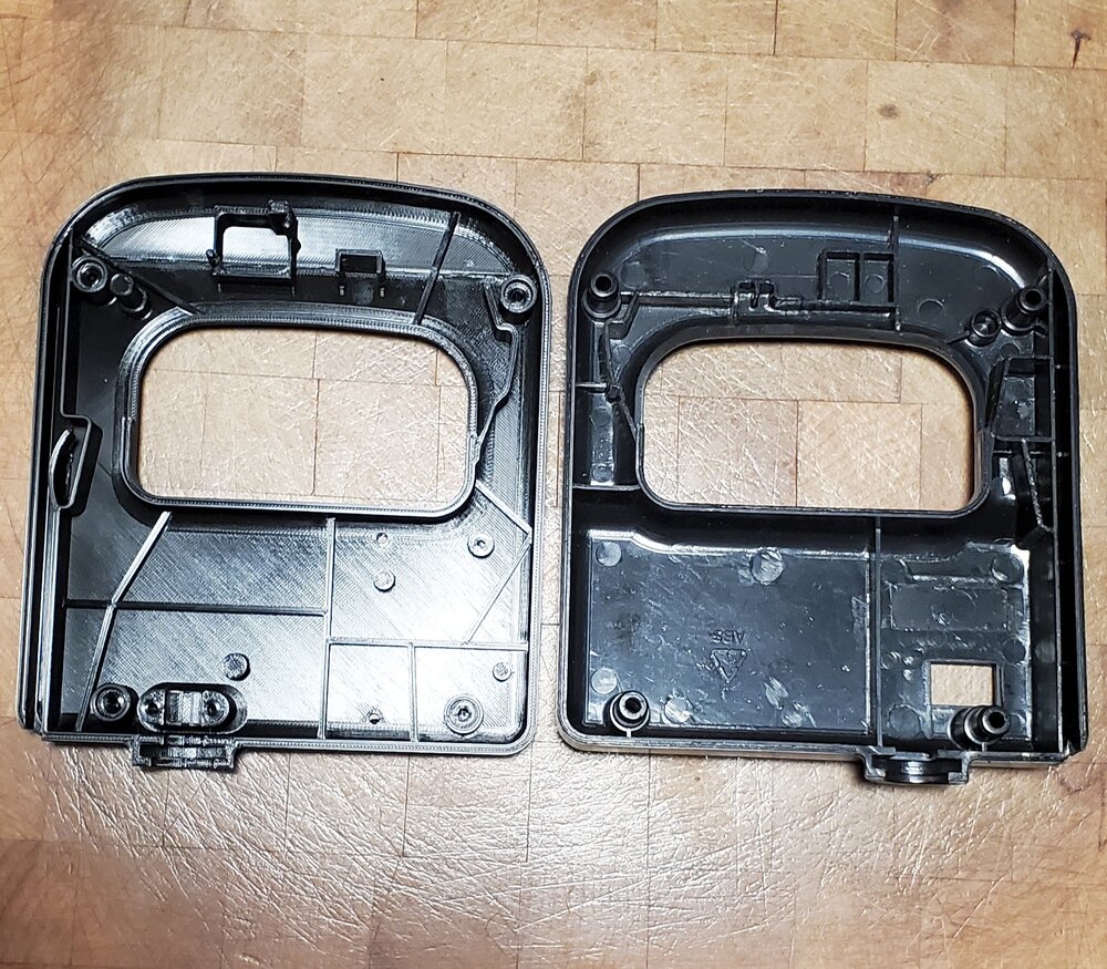

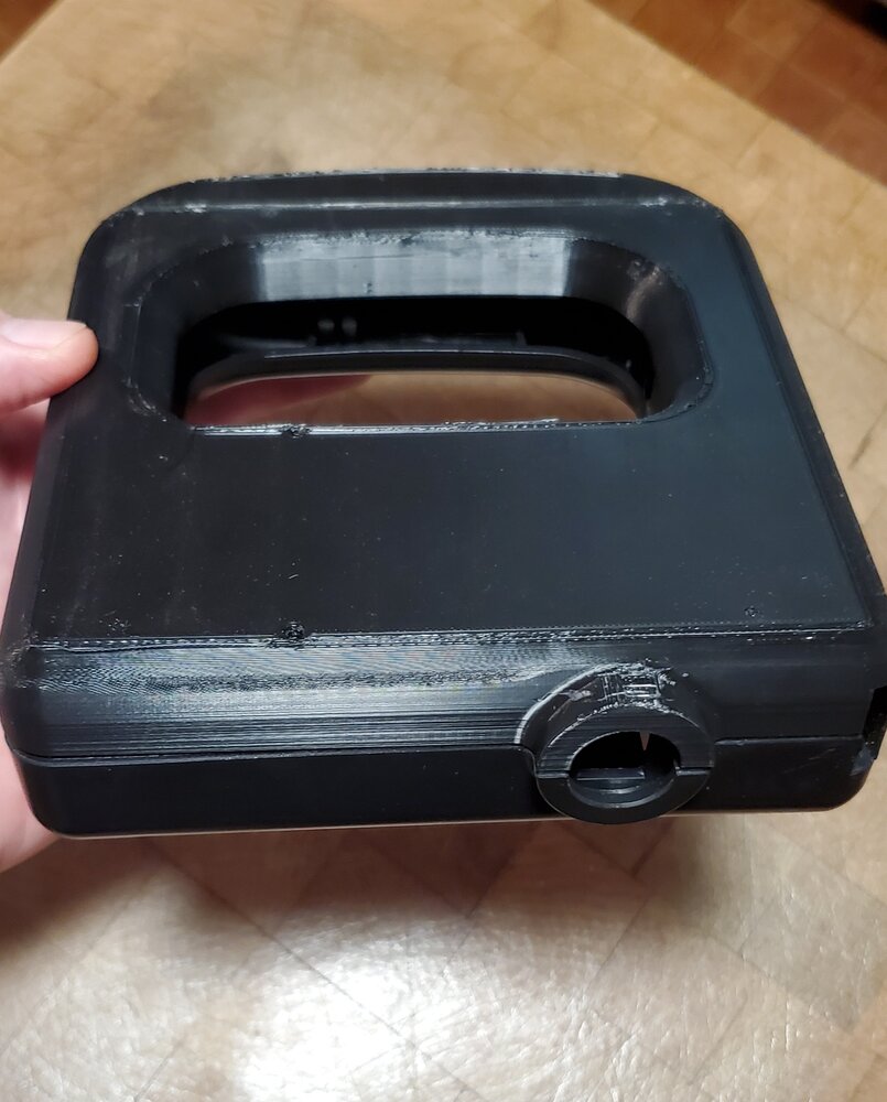

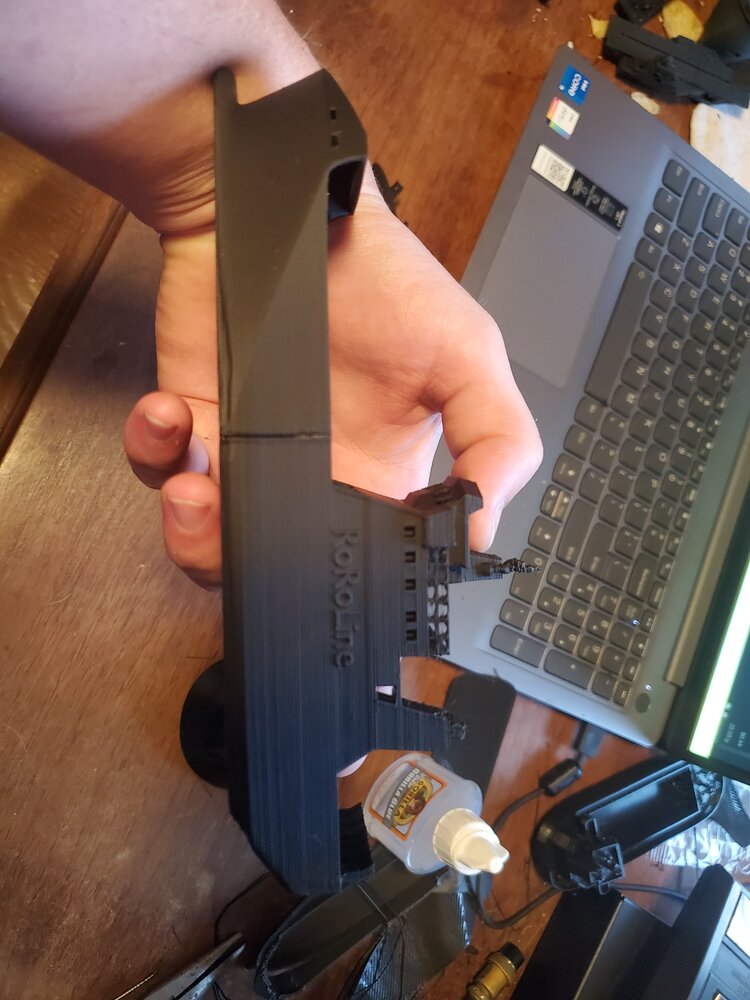

@mommucked I've got the lower handle printed. Had to do it in two prints then glue them together, but it should be strong enough for what you need. I'll pm you on getting the part to you.

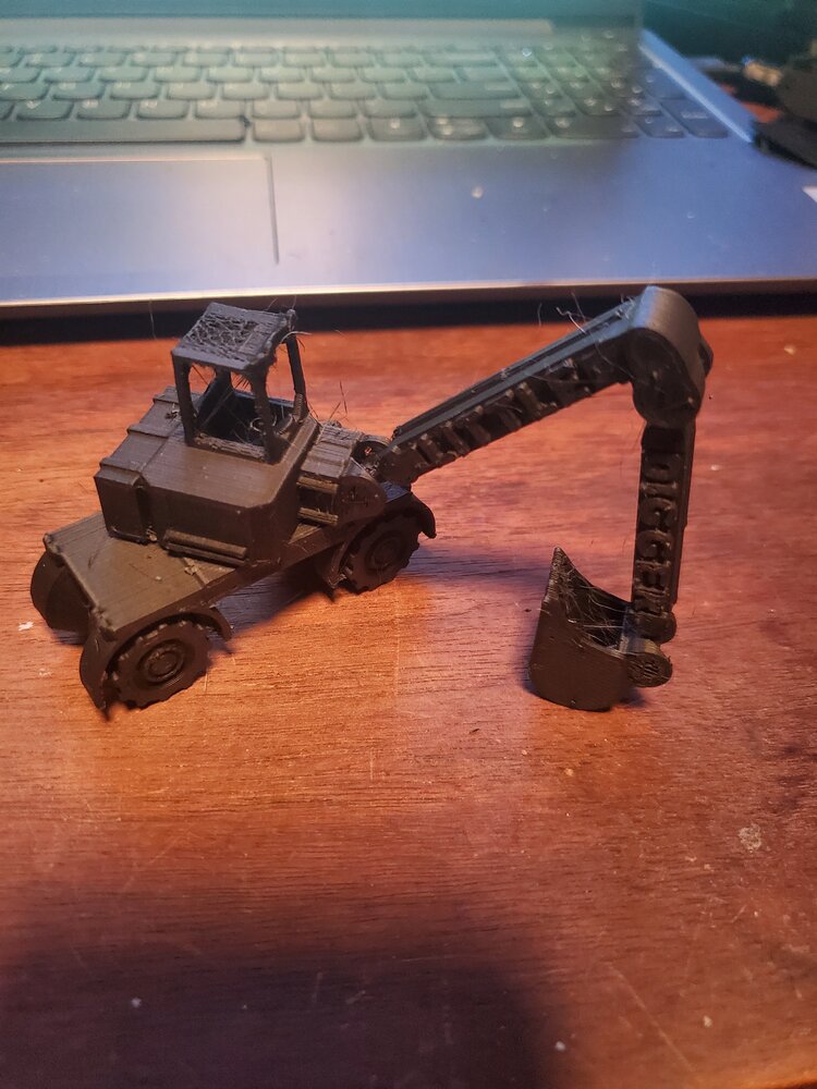

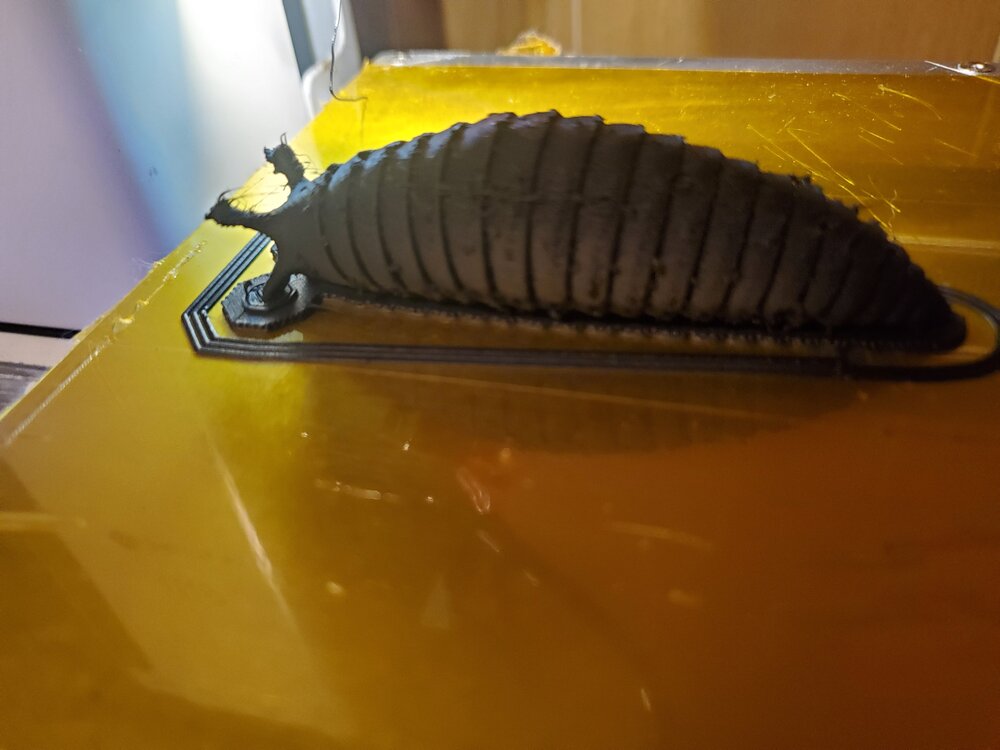

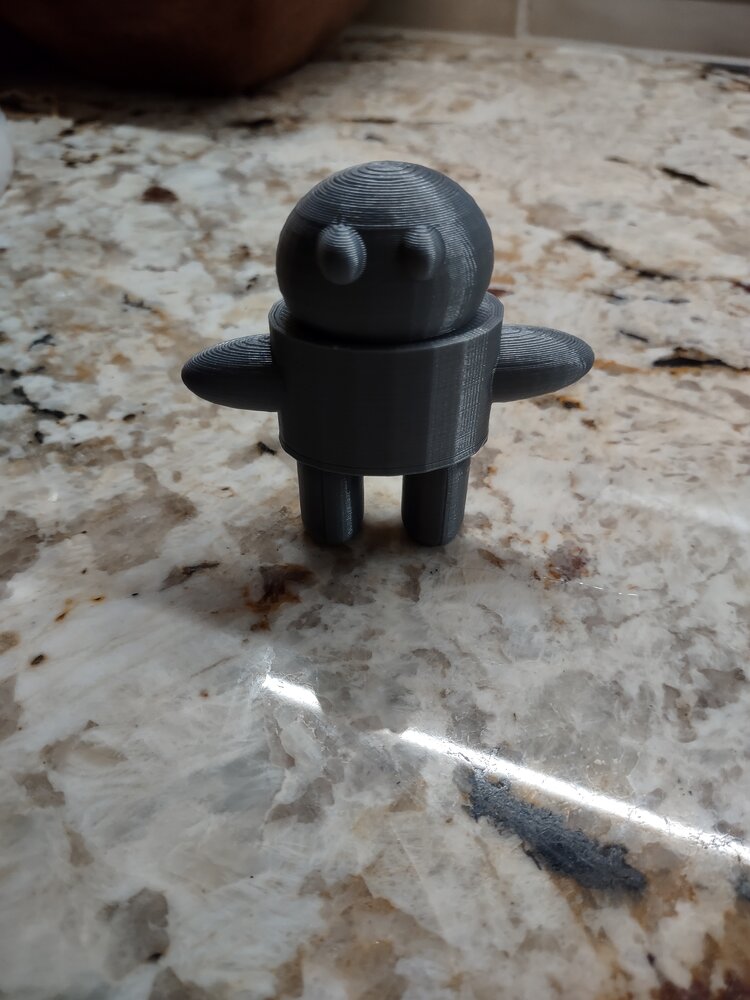

The 9 y/o drew this by himself (2nd thing hame has drawn). The first 'bot' he drew printed horrible but he was still happy with it as a nerf target, but I think the bed had gotten out of level (I guess the knobs on the bottom of the bed need locknuts or something?)
I did separate the legs from the body on this one to avoid having as much supports, just hot glued them on.

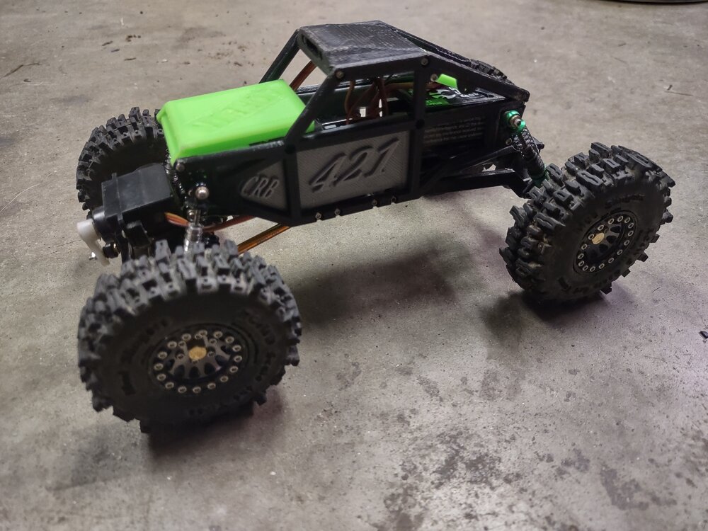

R/c crawlers chassis' rotate to new versions on a regular basis, or adding things like the custom panels and name on the hood on this one. I have had decent luck selling excess parts for these trucks on eBay or at the local hobby shop. I am printing a modified version of this chassis right now for my crawler.
Best thing you can do for most cheap 3d printers is replace the springs. Def helped w/ my CR10. Get some longer or stiffer ones so it really take a lot to move the bed, it will stay in the same place a whole lot more. Aside from it making it harder to shift out of whack, the extra stress on the tightening bolts decreases the chances they will move.
I rarely have to level by Bibo or CR10 anymore.

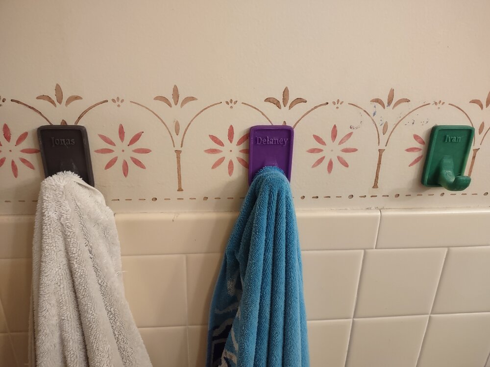

We're hosting a Spanish HS student again, so I made named towel hangars for all the kids.
They are thermochromic PLA, changes color when it gets warm, to orange, pink, and yellow, respectively.

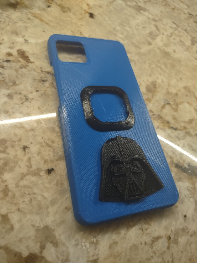

Found the file for the phone case, quad lock, and Darth Vader on thingiverse. Added them all together to make myself a new phone case. It fits the quad lock as intended, and fit the phone, although I wish it wrapped around the front of the phone a touch more.

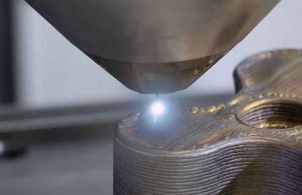

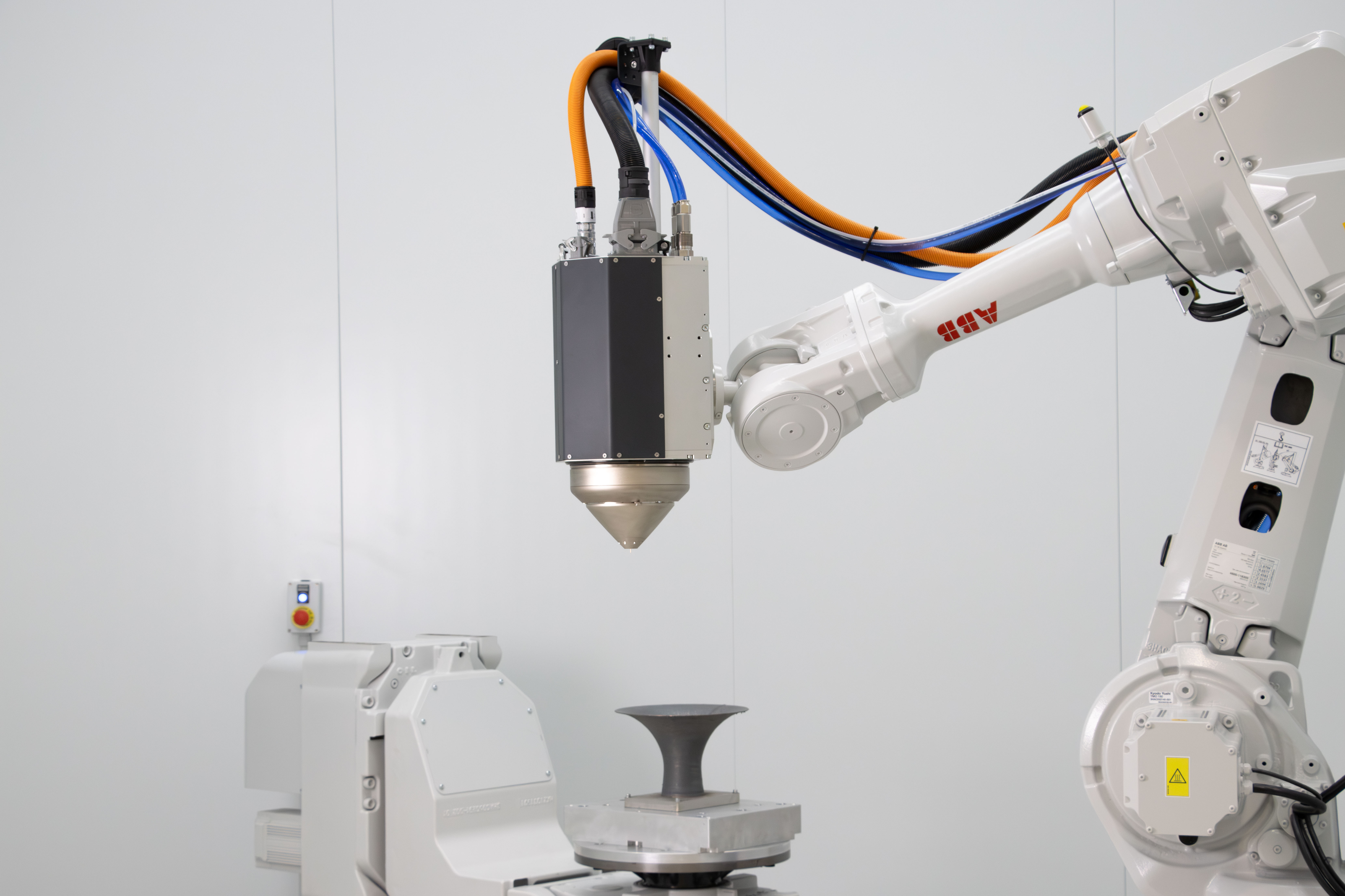

You need to just buy one of these
I'm not very familiar with metal 3d printing, but the ones I have heard about require a post processing with a CNC to get a machined like finish. Some really good ones maybe capable of a finish similar to a steel forging.
Just getcha one of these:
I am going to be honest, I looked at that machine on Okuma's website a few weeks ago and I'm still not totally sure what all it's capable of.
I've seen it in person, and it can do a lot, but not sure it justifies the 7 figure price tag. Basically laser welding additive mfg combined with a CNC in one package. Seems like an extremely narrow use case. But it's cool, and I look forward to buying a broke one in 40 years and spending $17 million dollars to fix it (i assume that will be the equivalent of about $5k in todays dollars).
