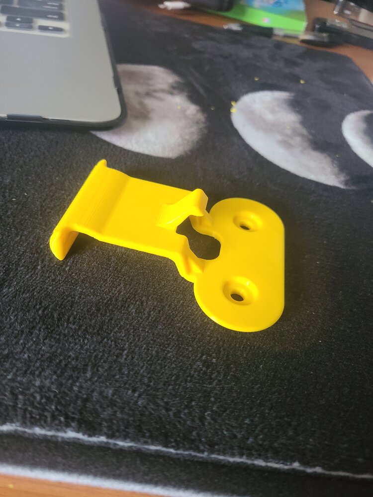

I'm currently learning more and more about 3d printing to hopefully be able to do some projects with my class. I test printed this center console latch to make sure I understood slicing and setting infill. I did get the original file off of thingiverse. 20221027_130901.jpg

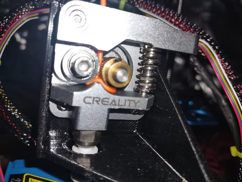

I did print a couple things with it today, but EVERY time I try the phone case out of TPU it screws up (starts pushing filament out at the extruder). I can print other stuff out of TPU with no issues, I think the fix is just going to have to be a direct drive. SO, Tell me what I need to buy to convert to direct drive. It seems like the V2 is a unicorn in the fact that nobody makes a direct bolt on setup. But I can't seem to figure out the reasons the other CR10 setups don't work. I like the MicroSwiss setup, but I don't really know what I am looking at.
I don't understand, what's different about the phone case from other TPU stuff?
Technically if you waned to chase this down, it's probably something with teh extruder... the gear may be a little worn and slipping. Maybe possible your heat isn't quite enough and it's slightly pushing back from pressure at the nozzle.
If you want to switch - why not just get a replacement V3 head etc, and then update Marlin? The only difference between V2 and V3 is that V3 is direct drive. In fact w/ some digging if you want to save some $$ I'd bet it's the same stepper motor and maybe even teh same extruder, you reaally only need the V3 frame.

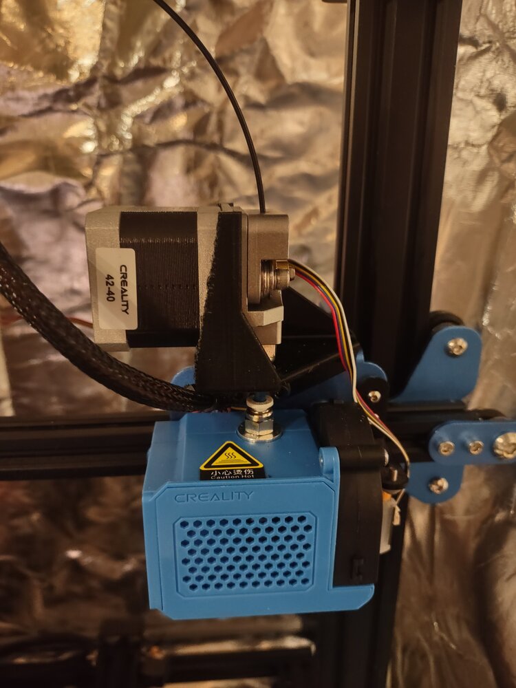

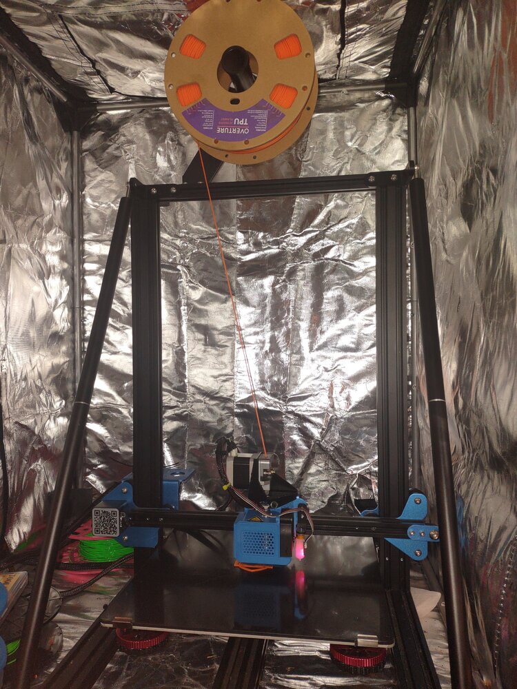

I found a 3d printed bracket on thingiverse, so decided to try the cheap options first. Seems to be a nice setup, I think with this maybe all I will have to upgrade is the tensioner assembly (not sure what it's called) if there is a better one for tpu. Just have to extend the extruder wires now but that should be it. The 3d printed bracket came out alot better than I thought it would. Took 4.5 hours to print.
It functions. The issue I am having is shown in the one picture. I wonder if maybe the flow setting is set too high or something and causes it to push more than it can handle. It did this again even with the direct feed setup. Hopefully it was a table level/offset issue. Have printed a few things with success, just the phone case always causes me trouble.
I DO like getting the print spool inside the enclosure though.
I don't know how I have had so much luck with TPU because my current luck is horrible. One thing prints great, the next horrible.
I'm betting your speed or flow isn't right, or the temp quite enough to get good flow through the hot end.
Also, if you're having trouble only with this specific model, watch closely and see if there's a particular location it fails. Does the first layer work out well?
It possible there is something weird in the slicer settings that is getting called up with that particilar model.

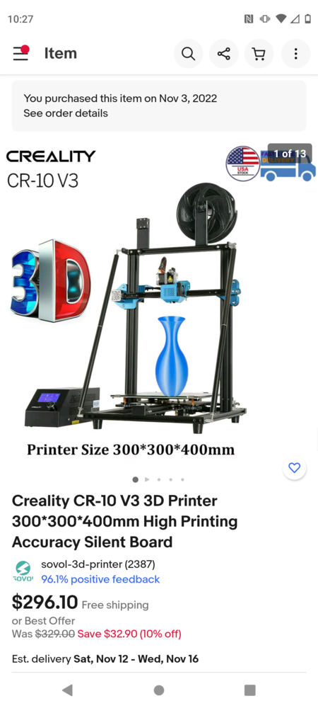

Sold the cr10v2. Threw it on FB marketplace for $200 and sold it the same day, was tired of messing with it. The guy that bought it already has it going apparently. I don't know if it was a bad connection or what, tried changing the thermistor but that didn't help. May have been the board I don't know.
Bought a cr10v3 and got it up and running today. Have printed three things so far without issue. I printed a new phone case that I had modified some from the last one, but the end product I want the case to be out of TPU so it has a little more 'give' to it.
Overall, it was worth spending $120 as opposed to spending many more hours and probably money fixing and upgrading the V2.
(That's an expensive phone case) 😆
how the hell did you get a new CR10V3 for only $320?
