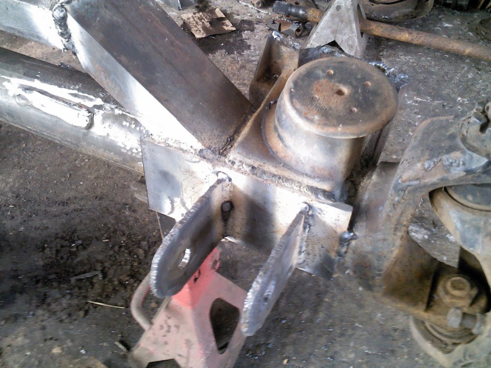

hey you can't comment like that and not explain lol. Please do explain briefly, it was bare metal to bare metal and all was sanded down/grinded down ...i guess not 100% but i got most of it...is that what you're referring to?The welds don't look as boogery as I have seen on other piles. It is all in the prep work. Obvious there isn't a hint of prep work going on here but he will improve.
oh you mean after i weld...OOOHHHHH LOL man this whole time you guys are saying my welds look like shit just cause i don't clean em up? dam man really ....well i feel stupid. Seems i could've avoided some "welding bashing" if I cleaned up my welds everywhere and showed how descent they look underneath...oh well. funny thoughwould help if you cleaned the flux and spatter with a wire wheel on the grinder. Until then, they look like shit.
I actually stated wire wheel (cup brush) so we can really see better what we are bashing him about.
I'm just gonna pretend this dumness is just a joke...ha ha hashew lawdy. Do you have any friends with a better welder? The flux core works for tacking stuff together but the things you're welding could kill you if they fail.

dude seriously Lincoln 140 welders are a very popular welders for the average mechanic shop and way more than capable of welding to any and all vehicle frames and stuff we...ok maybe I do. I bought this welder 4 years ago over a 220 cause a "professional welder" told me it will handle just fine anything up to 5/16 safely and easily yet not take up so much room and power and is easily portable as I also have used it many times for mobile jobs. Bigger is not always better for everyone's needs and these little welders would surprise people if they gave em a chance...those who still desire the 220, nothing wrong with that. I just have better needs for a smaller more compact versatile welder that suits every one of my needs and when i need a bigger hotter burning one, i just go borrow one.Truly, I wish you would take heed.. your failure to put your ego away and better your self will surely one day cause you more suffering. Pride goeth before the fall..

yes i have cleaned my welds for years when i started learning long ago but over time, I'm comfortable enough to not have to clean and inspect what I'm doing...It's not ego either...it's just knowing what i do. Same with I can take a Jeep 4.0 head off in 22 minutes with air tools focused ....that's not ego just know what I do but others would call me prideful.I was just giving my honest opinion. If the flux core must be use then clean your welds and inspect them. I've used a flux core before, that's why I offered that advise. If I was in a pinch and had to use one then I would damn sure clean my welds and probably do multi-pass on something structural like that.
I'm not trying to be an ass....just trying to help you be safe.
Having you shit break on the trail sucks, having your shit break on the road if a whole different animal.

hey hey hey by no means a hero in anything and my flux welds are by far anything to brag about ....obviously from pictures....but i know they are solid and safe!I crown you the Fluxcore Superhero.
just sayin bud...many factors i took into consideration. Price, mobility, size, ease of use, quicker/easier to plug in (especially when renting residential homes), mobile jobs....I will say you excuse for not having a 220 due to size it crap now a days. I've been looking for a new one and most are under 50lbs and are 2x2x1 ft
