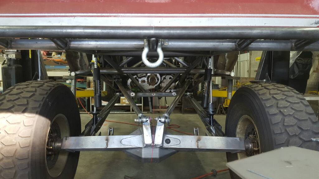

So overall, roughly a 35 lb gain over simply running 2"x250 dom links for the rear lowers. Since my uppers are only going to be 1.75x120 versus the 2" as previously on the buggy, I'd say it's a wash on the rear.
It's actually only 20# more for the pair.
Going off your 30" long 2" link, it's .58 pounds per inch of link, so a 40" link should weigh about 23.5 pounds. So 10.1# more per link to get the trailing arms in the first picture. And the trailing arms are massively stronger.

Anyone that's curious about how the jig worked out.
As far a the jigging goes; using the 2" rectangle and 2"dom made keeping it straight easy. After every weld cooled I check the link bolts, to make sure I can spin or slide them.
From DR;
[quote name="Josh40601" post=3891217]Are you going with just a single coilover on the trailing arm? That thing looks awesome, and like a pain in the ass to build. lol[/quote]
Yes, building to 4800 legend ultra 4 class whether I race or not: single shock per corner. But, I can easily add bypasses behind the c/o. Nothing a little fabrication can't fix. My jig I made definetly paid off. She's straight, and flat on top. Before I took it off the jig, I preloaded downward pressure, because it was climbing. Then once I pulled it from the jig and on the table to weld the bottom, she pulled back down nicely!
It was definetly a lot of work. Obviously the second will go MUCH faster, due to templates are made and the brainstorming is done. Have nearly 20 hrs in this one. Hope to have less than 12 in number two.

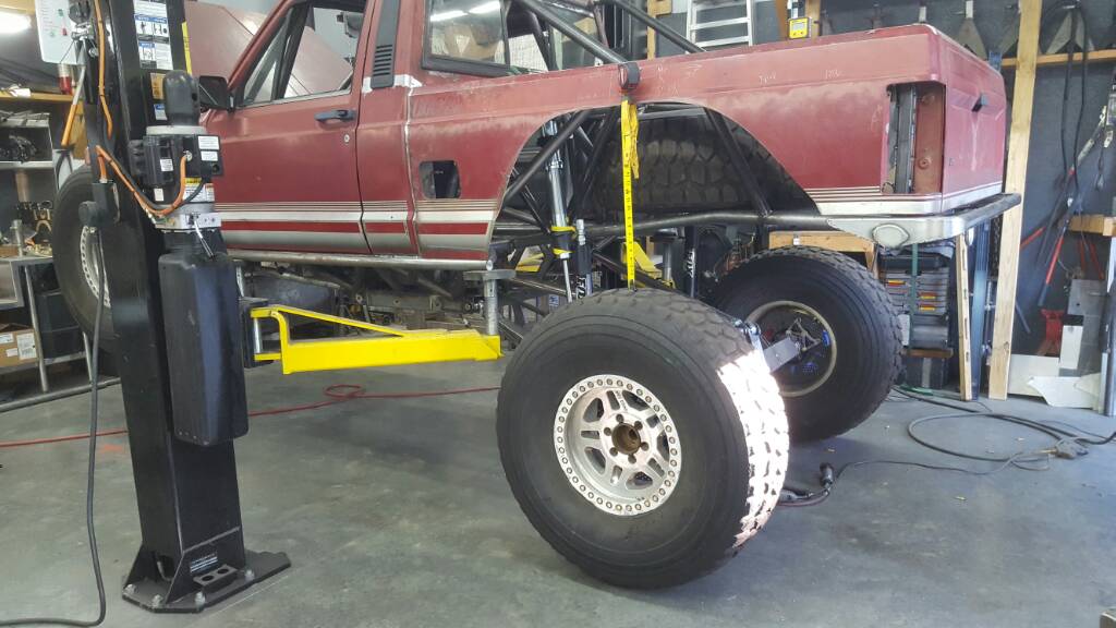

Time to get some shocks mounted!
Number 2 done, only 10 hrs on this one. 30 total, from first cut to completion. Not counting heims or labor, less than $75 in materials...save some cha- ching over buying kit. Just loss of time. [emoji481]
Plus I choose the motion ratio[emoji12]
