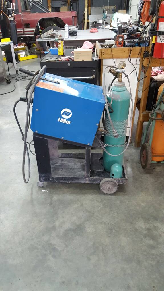

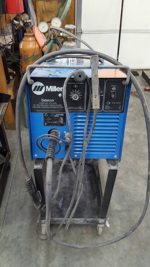

New addition to the miller army in the shop...belonged to my late FIL who did body work for 40 years.
Millermatic sidekick 110 welder.

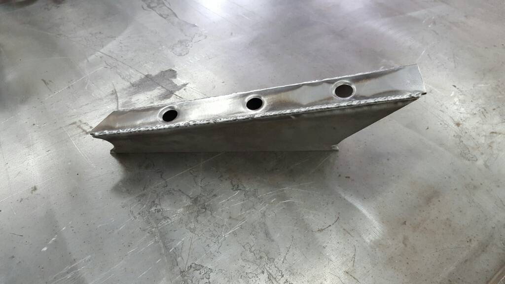

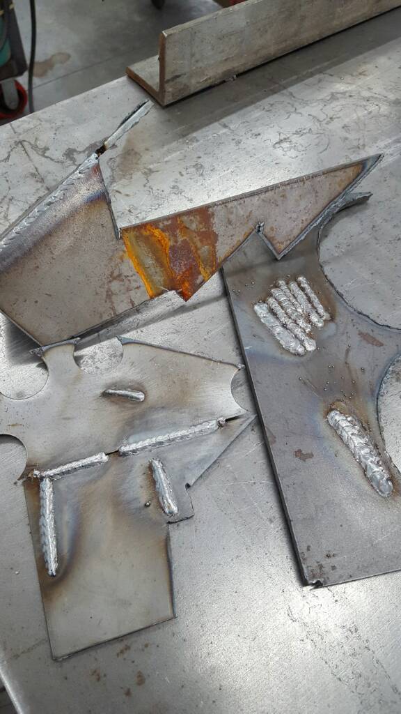

Some playing around, 1/4 flat, 1/8 corner, 14 gauge butt joint. Will definetly be a valuable tool with sheet metal.
Good compliment to my millermatic 185, and diversion 165. Same consumables as the 185. Be nice to have this unit near the table, and big welder near the project; save moving agrravations.
Matt
Still waiting on that cordless version aren't you.
