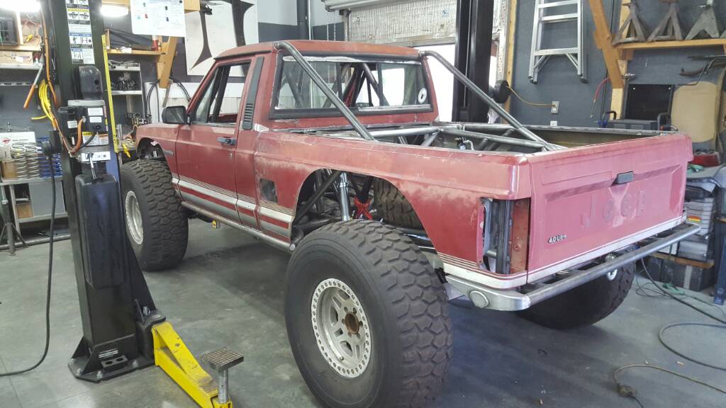

90's throw back.....Manche build

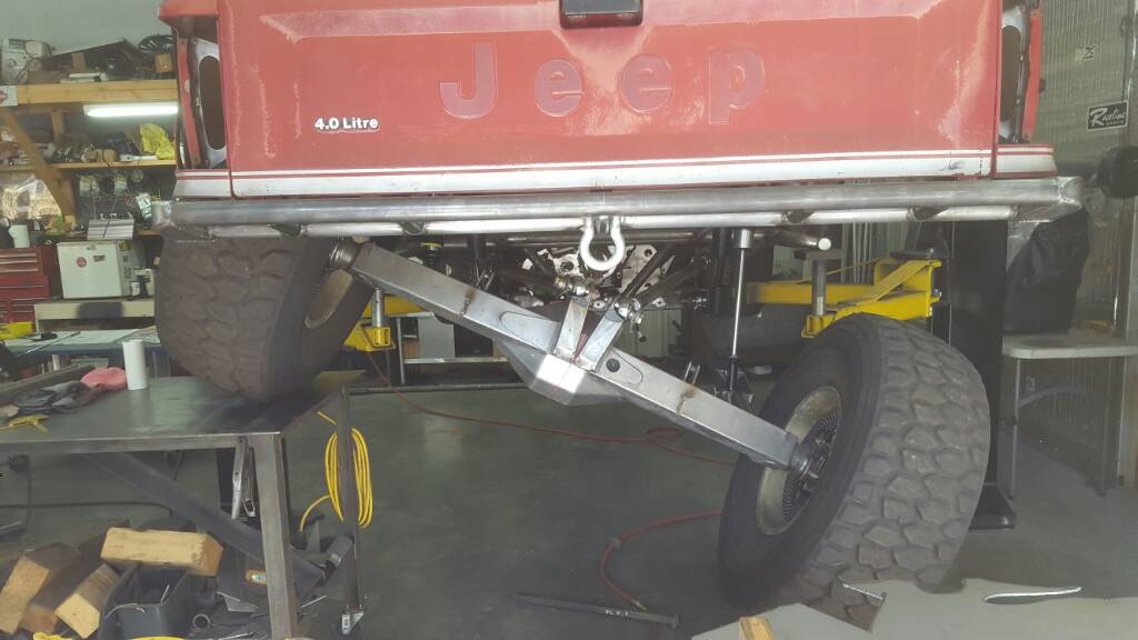

9° of angle change on driveshaft, always pointing at tcase through travel, matching angle at ride height. 3.625" driveshaft plunge through range of motion
how are you gonna deal with the driveshaft bind and all that travel? with your motor moved back so far will you actually get that much travel when driveshaft is on?
I had a ton of travel until I installed the driveshaft and then I had to put limit straps on due to binding

I expect to strap the droop at 19-20". At ride height I have 9.5" up. Wouldn't be upset at all with 18-20". Without going through the measurements, I'm sure the shaft will operate properly with. +/- 19".

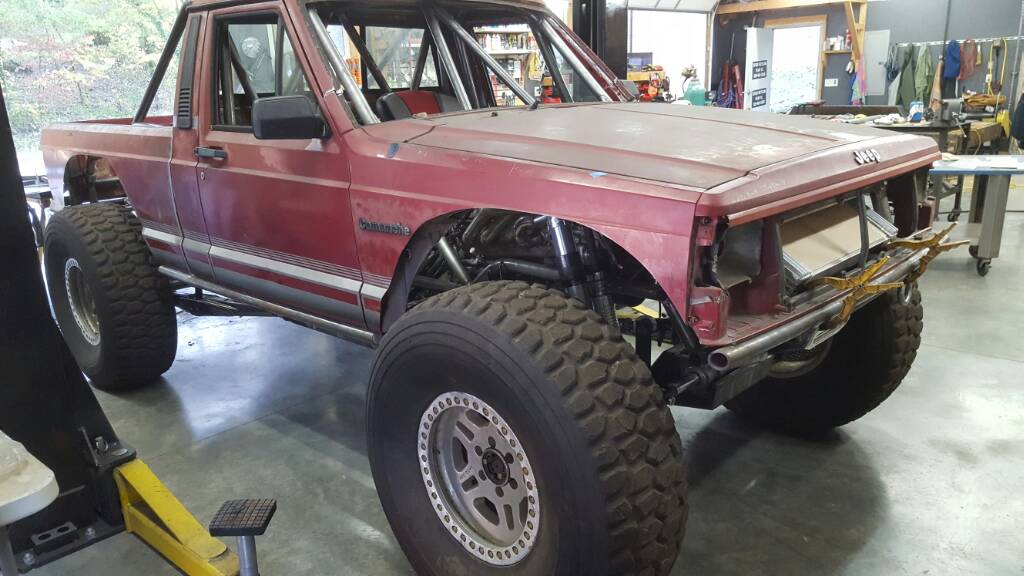

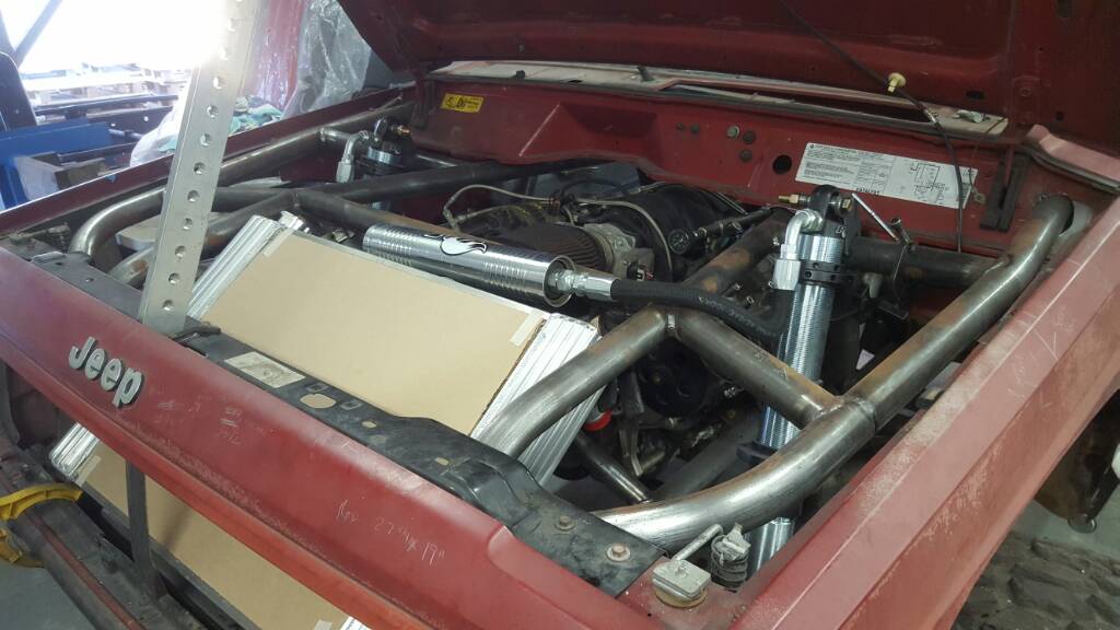

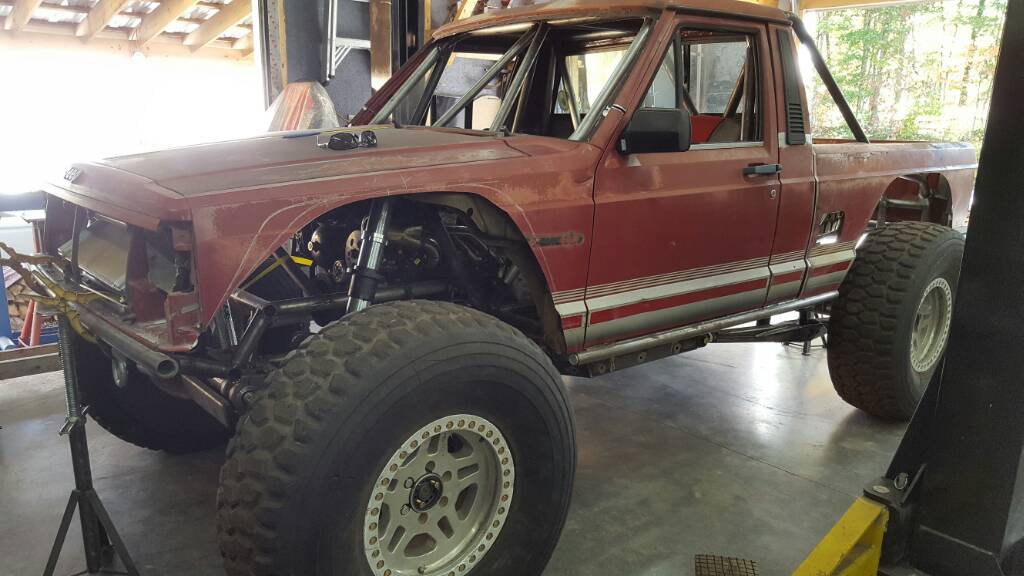

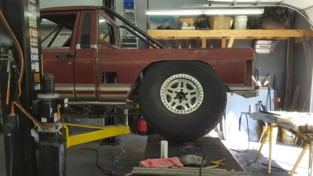

All shocks are mocked in now. Haven't cycled the front yet. Was able to get the front shocks under the hood! Lowers on front will probably be wiggled a bit to make room for the bumps. It's tight at the axle up front with 40° of steering.

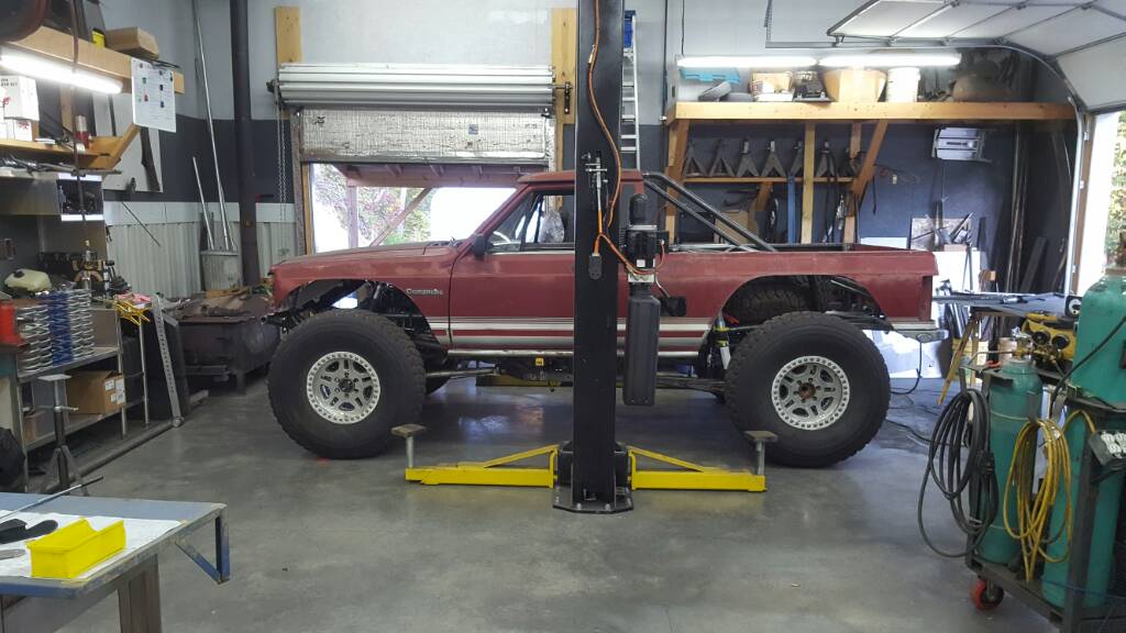

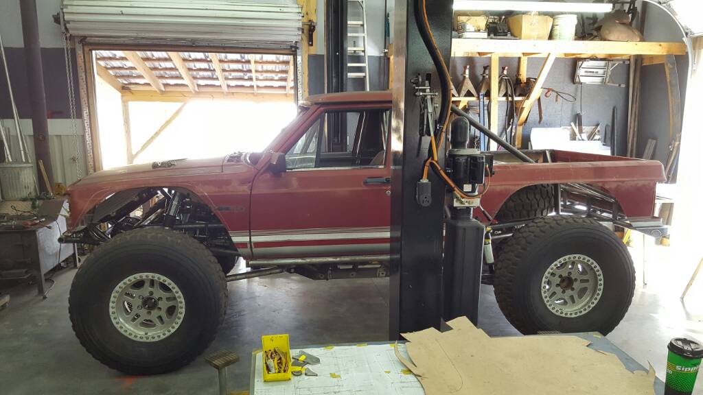

Also some spy shots at ride height with pvc spacers on the shock shafts.

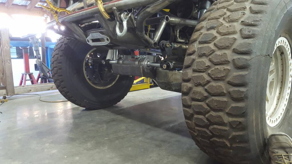

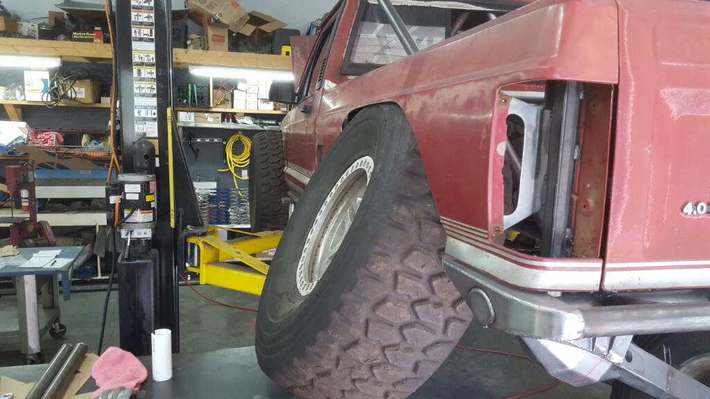

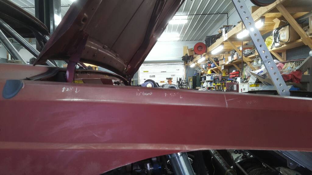

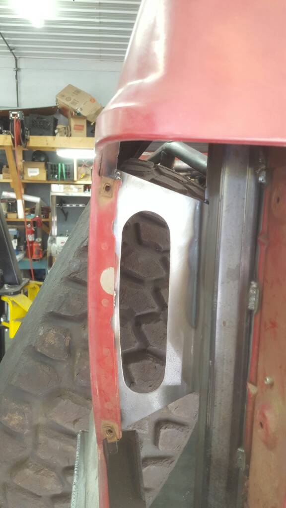

Did some cycling on the front today. Started clearance the fenders for articulation. Can't get the tuck like the rear, due to the natural taper and slope of the front clip. The tires will probably bump the outermost fender tube at stuff. Made some discoveries, (of which I was anticipating due to just slapping the shocks in there yesterday)--
Will be reducing front up travel from 7.75 to 7, and moving both upper and lower mounts to adjust to reach full bump, clear the top of the knuckle at full lock, and have room for the bumps.
It's tight up there, even with the motor sitting in my lap...[emoji481]

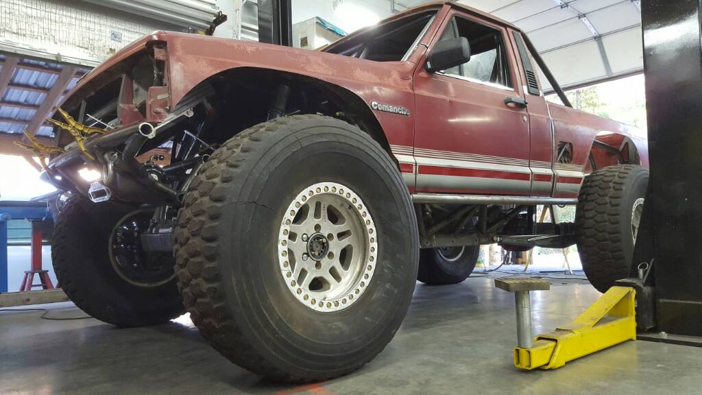

Just a shot or two of the front fender trim, you can see the line of where I will finally stop to clean it up and resemble the rear radius', I only trimmed as I needed...still some removal to do on the cab sub structure.
In actually really liking the absence of material, showing more space in the fender well.
