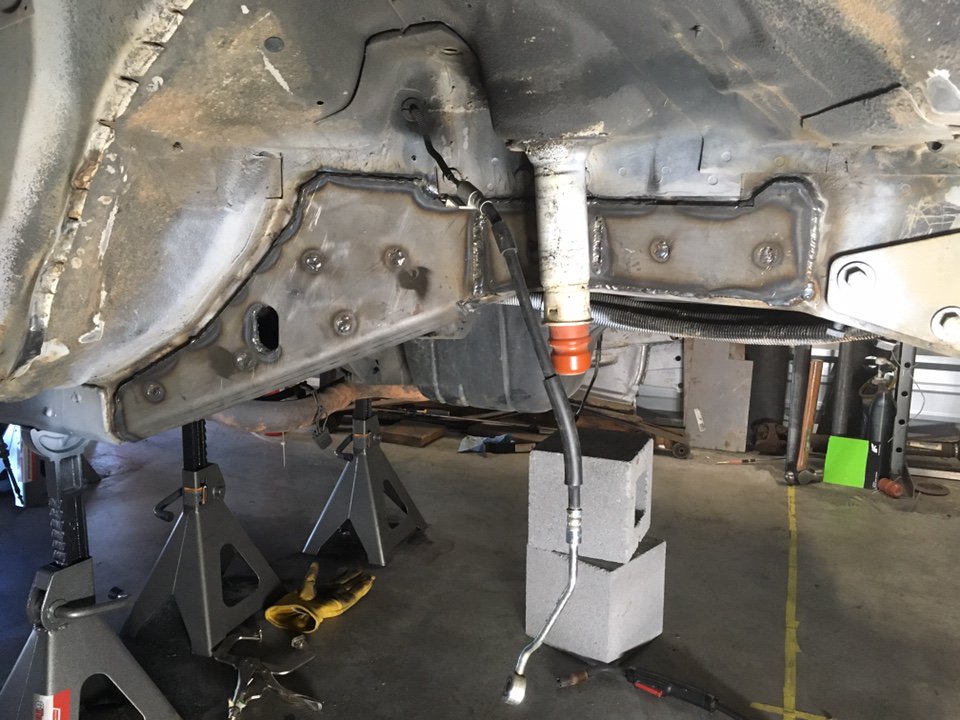

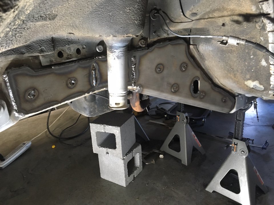

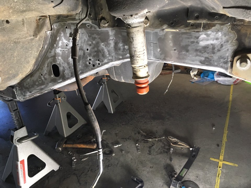

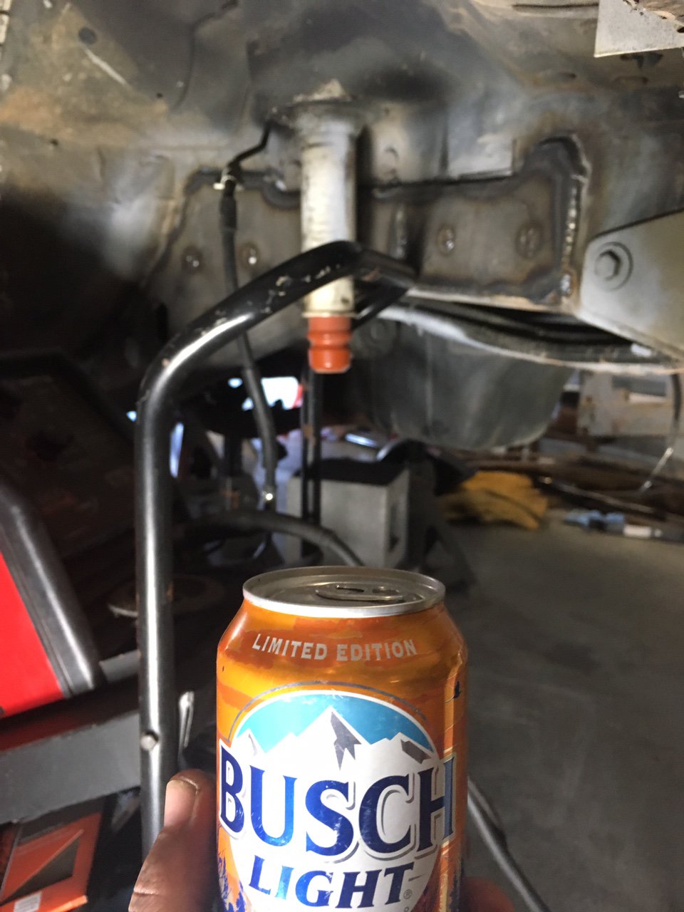

Knocked out front stiffeners. The lower control arm brackets are triple layer uni-body seam and spot welded all over. There’s a 99% chance that any robust structure from the factory converged on those damn lower control arm mounts.
Shoot a little weld thru primer and pulled out the squirt gun.
Enjoyed a leftover AOP beer to celebrate.

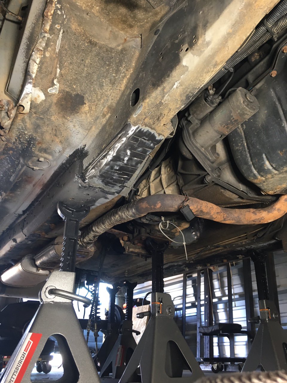

While I was covered in dust I went and chopped the rocker sliders out. Taped off the bottom of the doors that will be cut. They can basically be cut flush with the door sill. Gain about 1.75” of clearance at the slider.

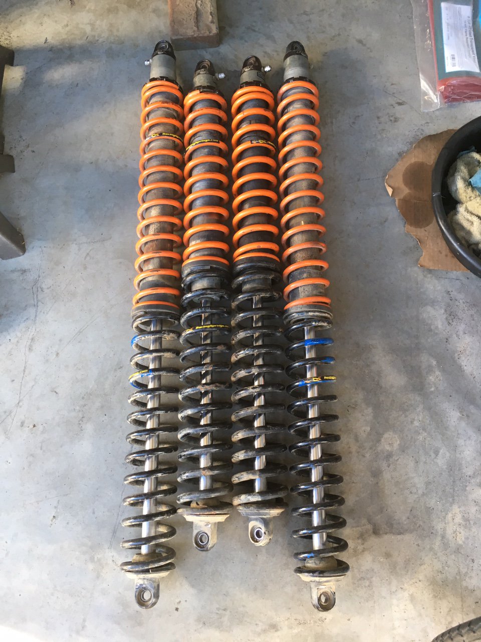

Sunday I met up with the fellow I bought the rear coilovers from and bought his front coilovers. He upgraded all around to ORIs. He also has a set of race car scales he said I could use after my suspension is done :D

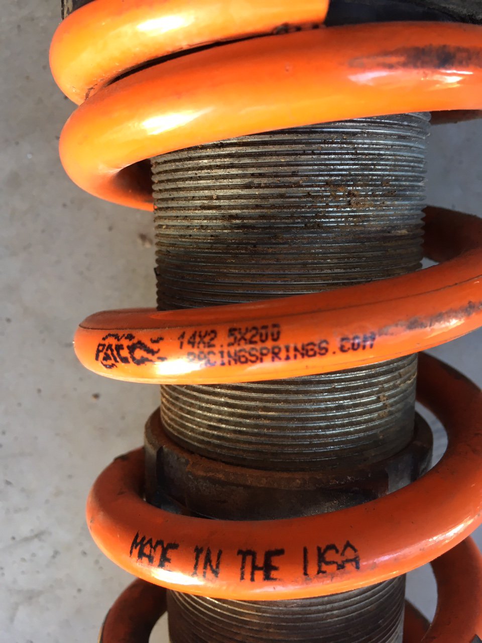

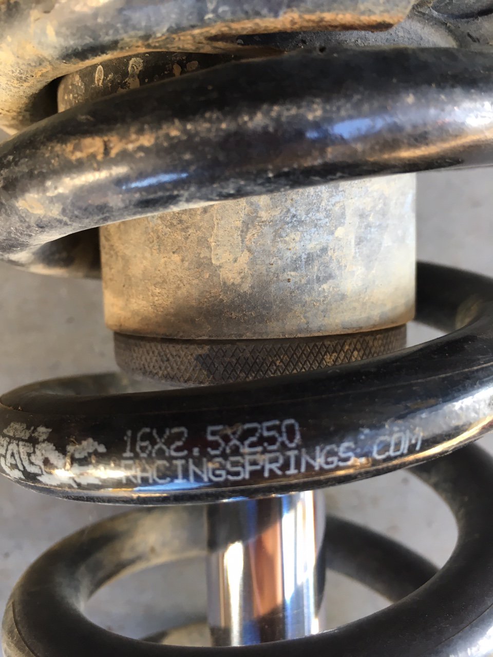

Same situation. Unknown valving. 14” fox coilovers. 14”x200lb/in coil over 16”x250lb/in coil. Should be a good starting point for the front suspension.

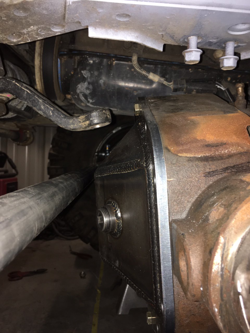

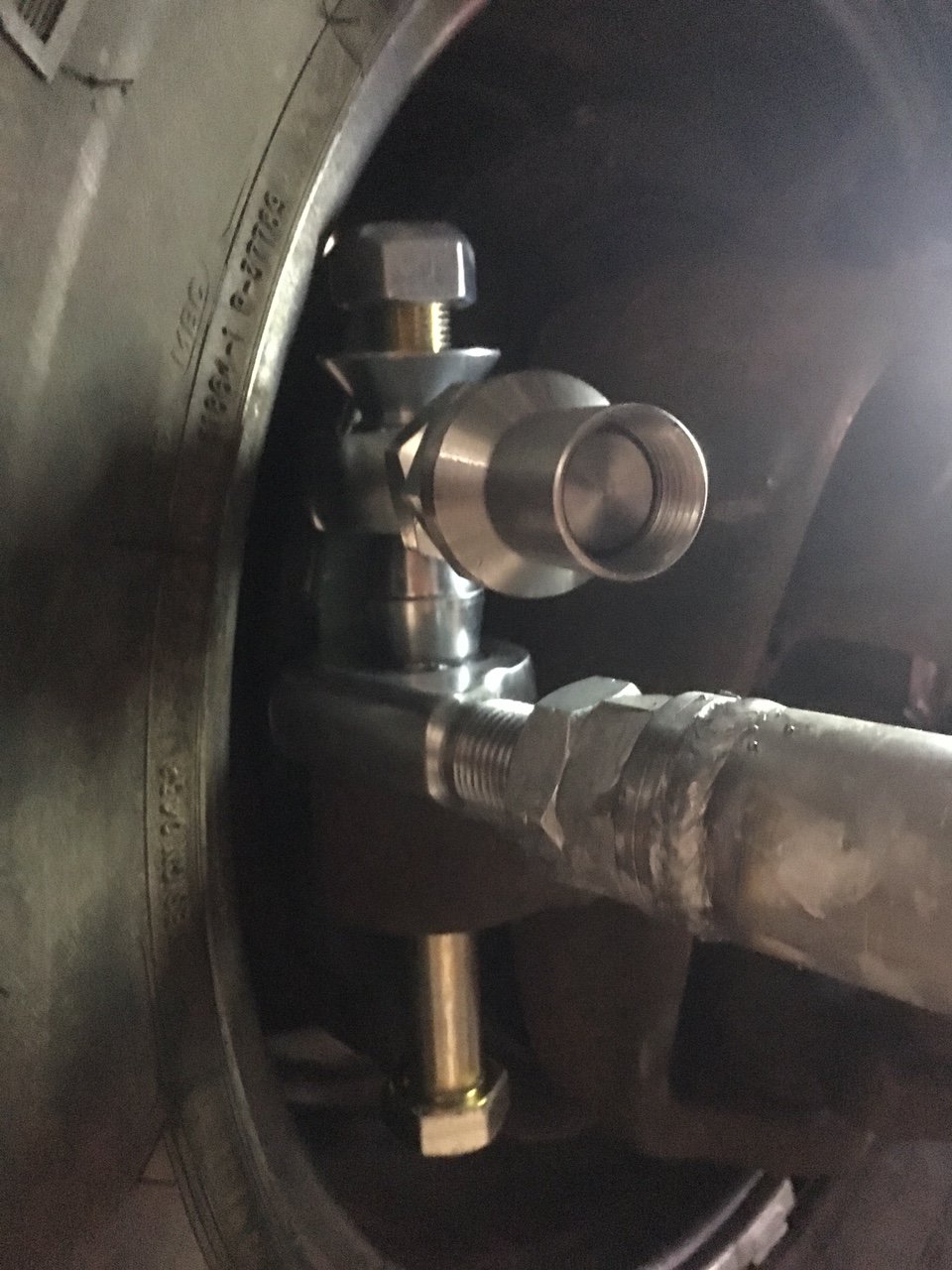

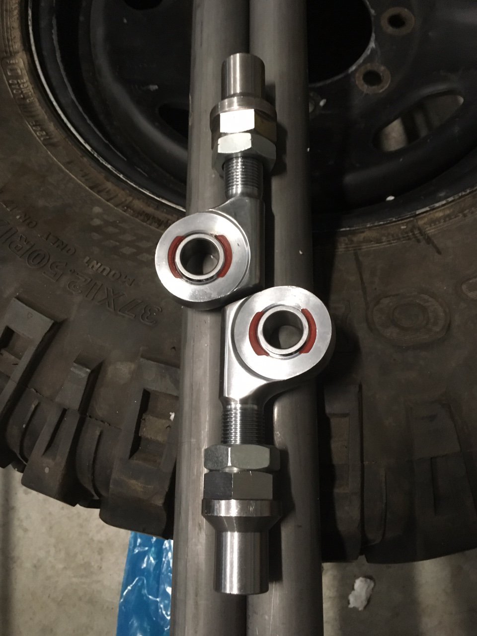

Lastly I ordered a heim steering kit from Barnes. Even with a super tight diff cover I felt I should go ahead and grab some offset heims to help clear the cover. Three inches of available thread is awesome. I set the threaded inserts neutral after having the 1.25xthread OD thread engagement. Can adjust .65” in or out on one heim and not worry about shearing the threads.
Ball-parking the tie rod length :flipoff2:
Bc you know the current rates, you won’t need scales. Just measure the preload before install.
Check the bottom cap for factory valving numbers.
Very true. As a note I am curious to see what the total weight is. Note sure what sort of unsprung weight numbers I will see. Like everyone else I want to keep this light but I do enjoy the cozy interior. If it becomes a heavy pig so be it.
I’ll check the caps tonight.

Do what Mac said but with your current coils. Figure out what their spring rates are and measure how far they compress under full load from an unloaded height.
I have some coilovers for Ghost just not the knowledge to install them and no springs..... What does this mean?
You take a known rate coil, measure amount compressed, this tells you sprung mass at the shock.
Helps to figure out what springs to use without scales or TRIG.
Shoot for 2” preload, but there are anomaly’s that happen with light sprung mass and heavy unsprung.
Most newer fox shocks have the factory valving engraved on the bottom cap. This usually lets you know the baseline valving and generally is a starting point to tune from.
Initially I would guess rebound is too firm lol.

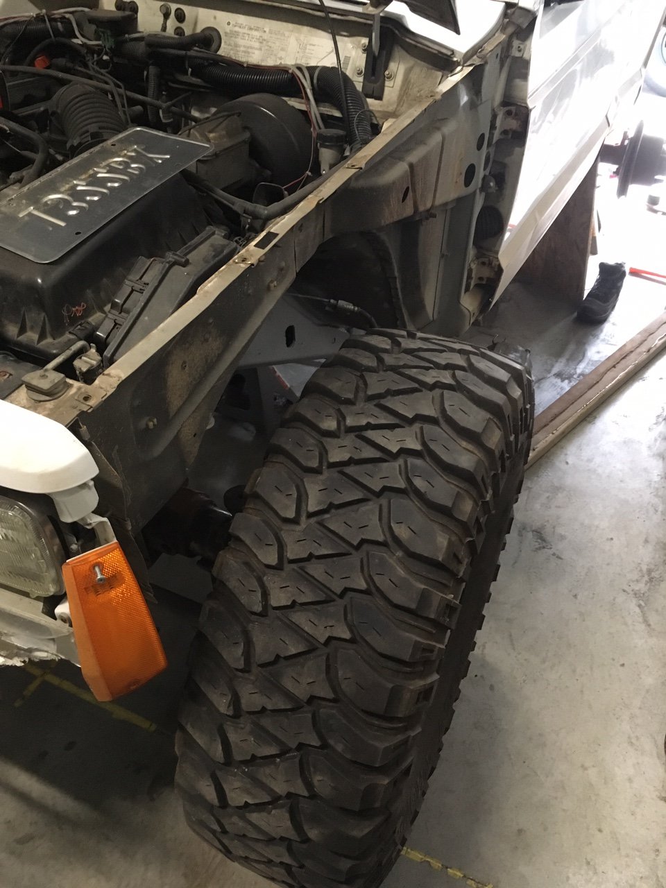

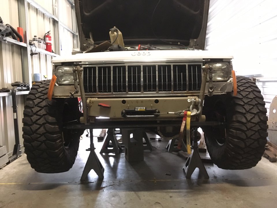

Most tired I’ve been in a while. Tagged up the tie rod. Still hits the diff even with the low profile cover but only when turned driver.

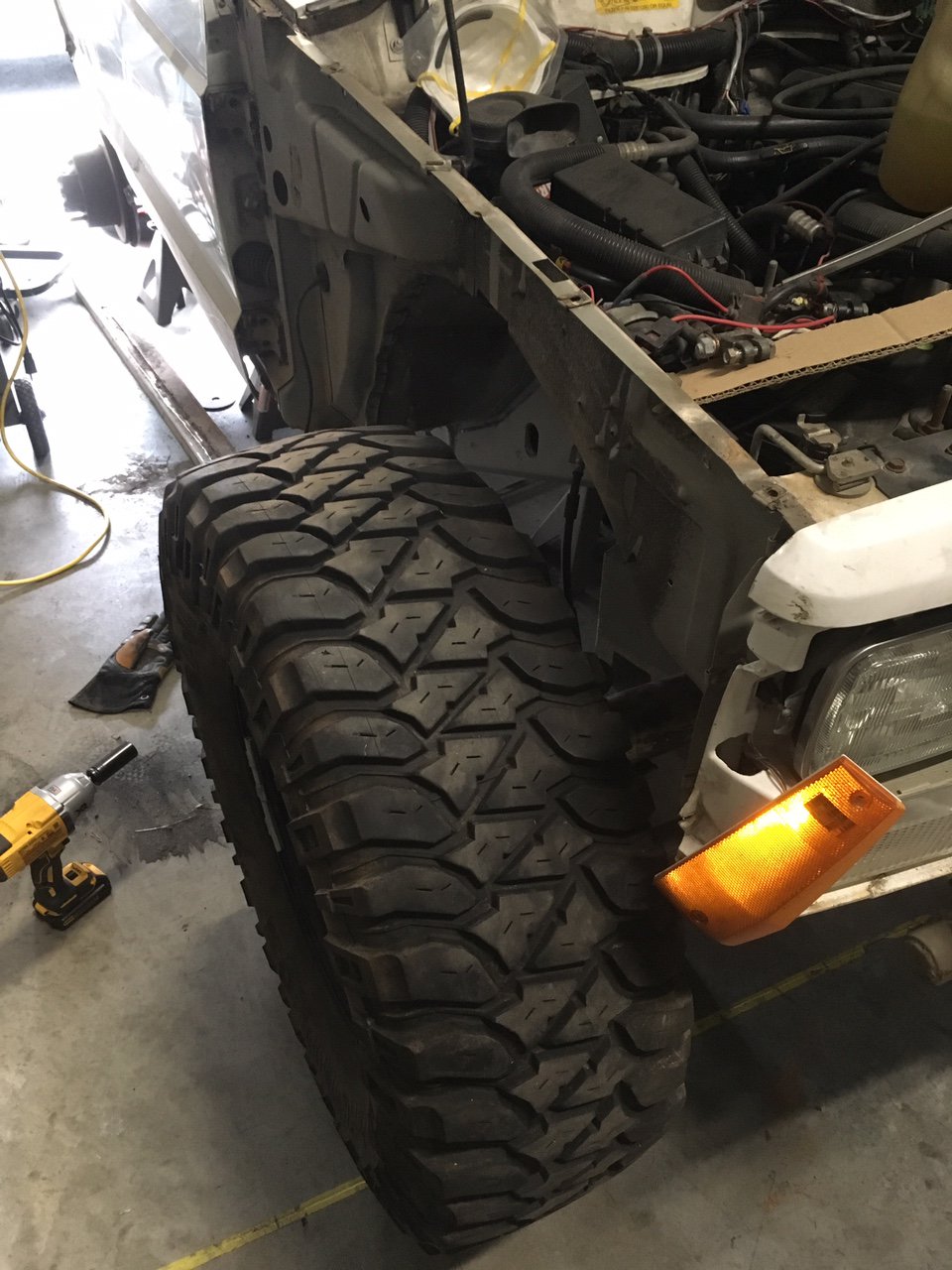

Stuffed the front axle to get a taste of what is to come.
Pull fenders. Seemed like a good idea.
Yeah, steering gear will need to be pushed forward. Which will push the winch and bumper forward. Lots of drilling to come.
Knuckles will need double shear welded in. For now it’s time to figure out spacing to stack the heims.
