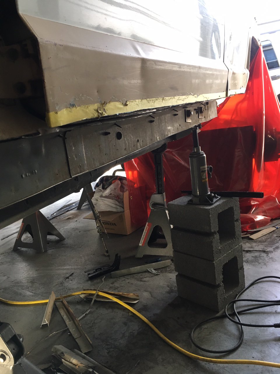

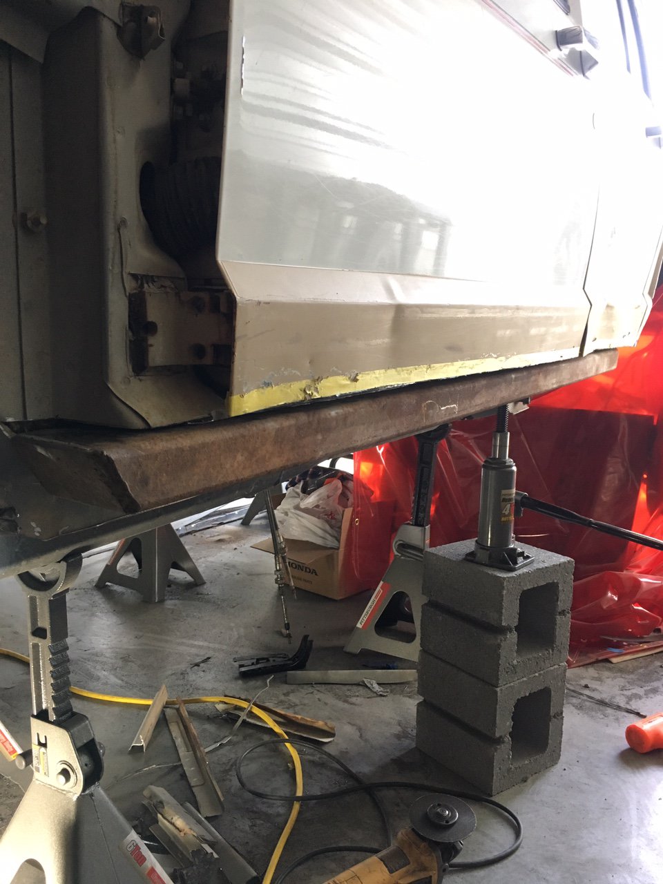

Been getting carried away with the cut off wheel and sawzall recently :) I blame dewalt.

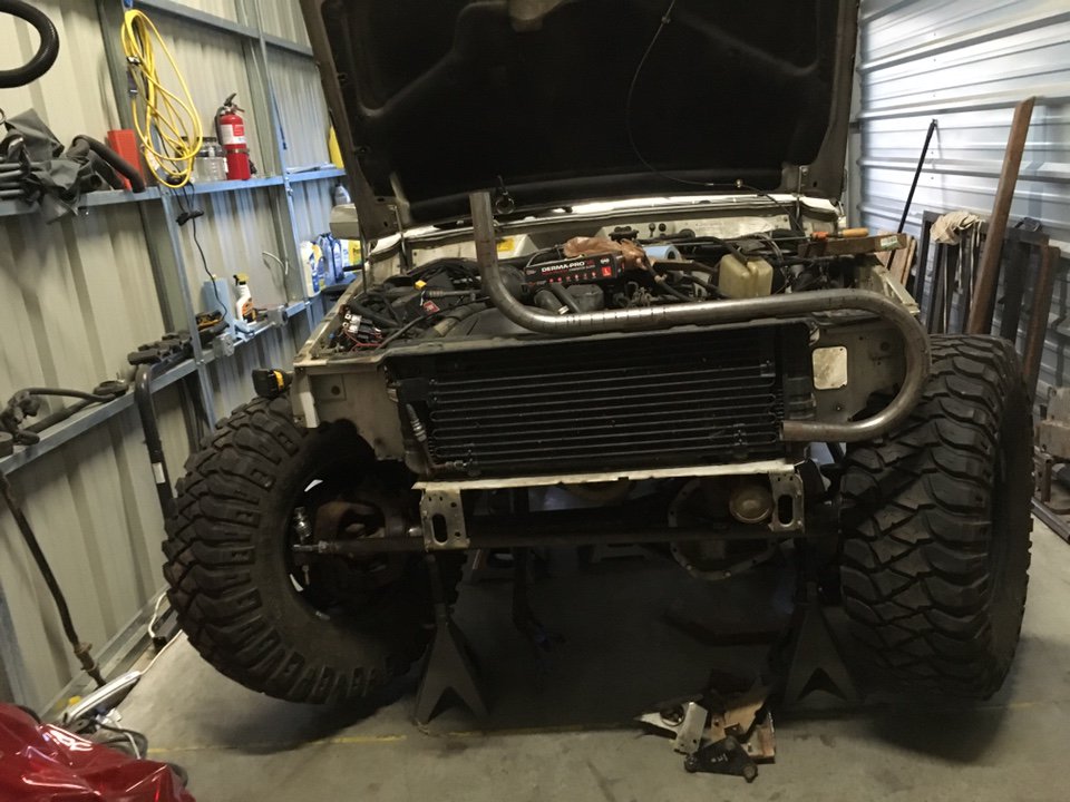

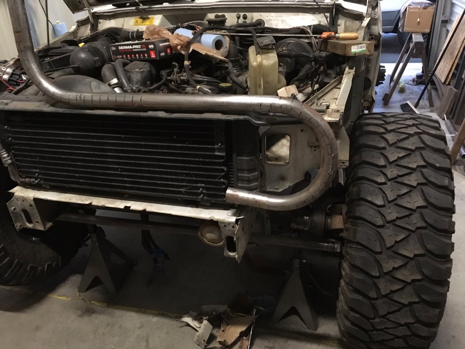

Flexing my creative juices here. Keep around my 90* and 180* bend tube to help find what clearances I can bend to. That front clip might be history...

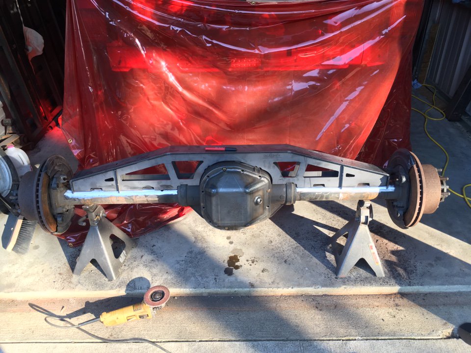

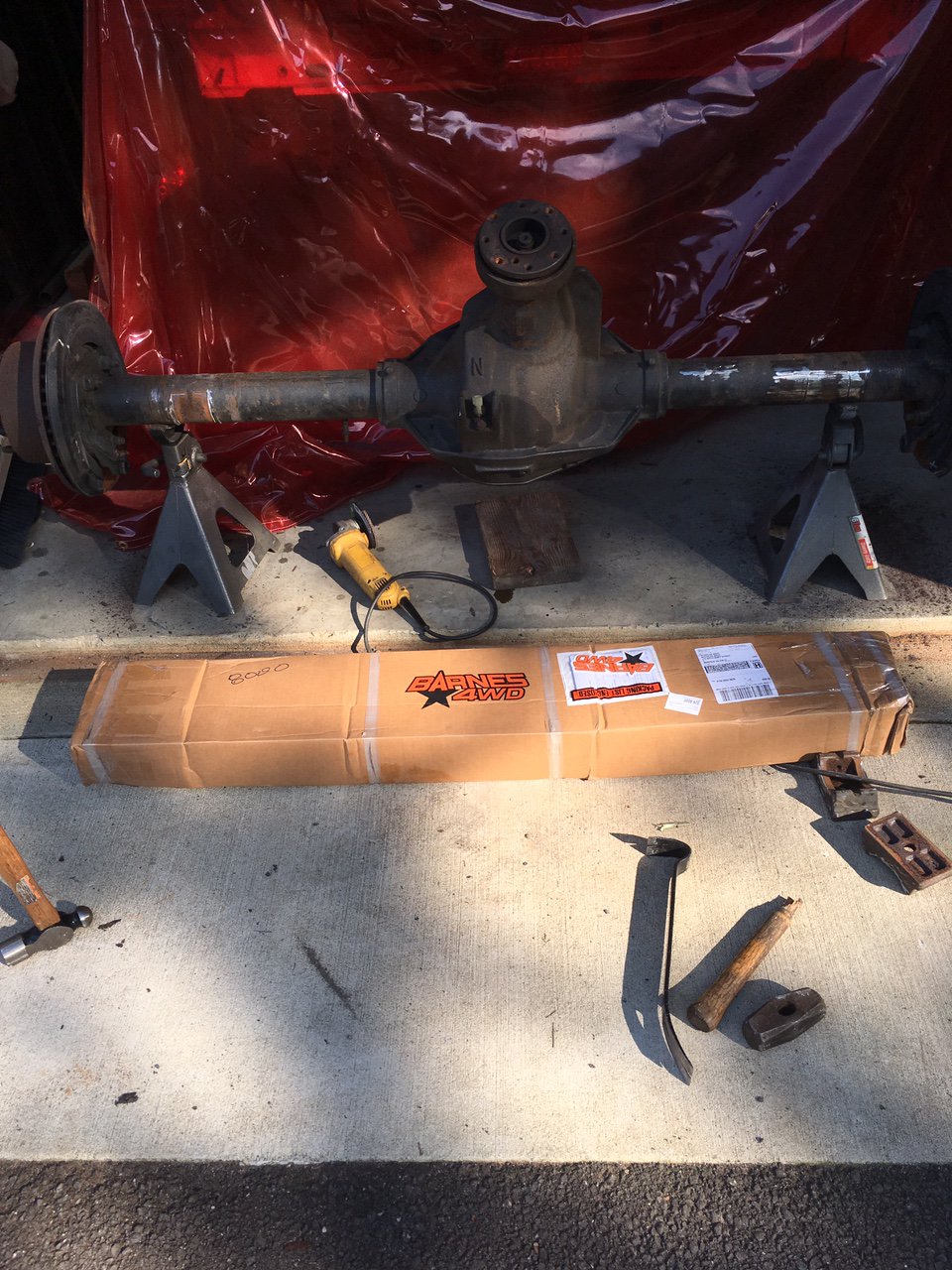

After a few months break from making progress (I blame work and traveling) I am back at it. I have all of my links, joints, and brackets from barnes4wd for the front 3 link and the rear triangulated 4 link. I have some metal to move the steering box forward and make hoops for the front coilovers. NWF finally dropped off the Eco box which I was waiting on so I can get everything back under the jeep to find where links can even fit. So it's time to get this thing underway.
At this point it would be nice to have it back on 4 tires :D
Bought a new 6 pinion planetary for the eco-box
On-to the np231 input shaft
All the np231 parts are harvested
