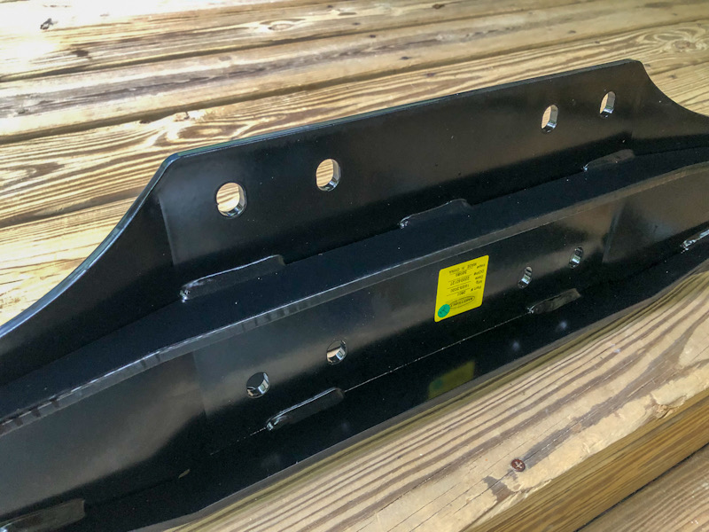

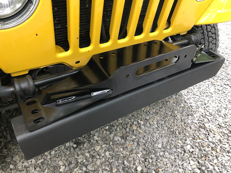

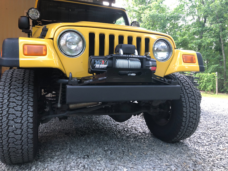

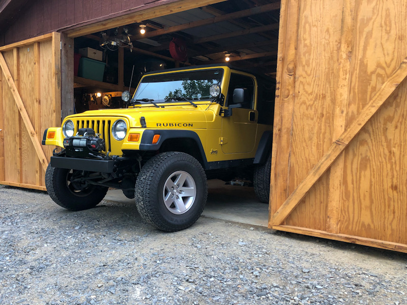

I will mount the solenoid tomorrow. I really like how simple and clean it looks! I kept my stock hooks even thought they’re not super functional, I just like small homage touches to originality. It is pretty flush with the bumper but of course the Hawse fairlead will lead the whole shebang.
The mounting plate is made well, 1/4ā€ and gussets top and bottom.
Guess I’ll pull off the cable and keep it. May come in handy for something.

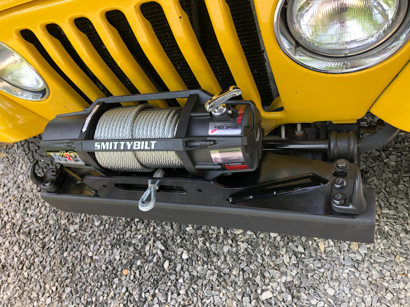

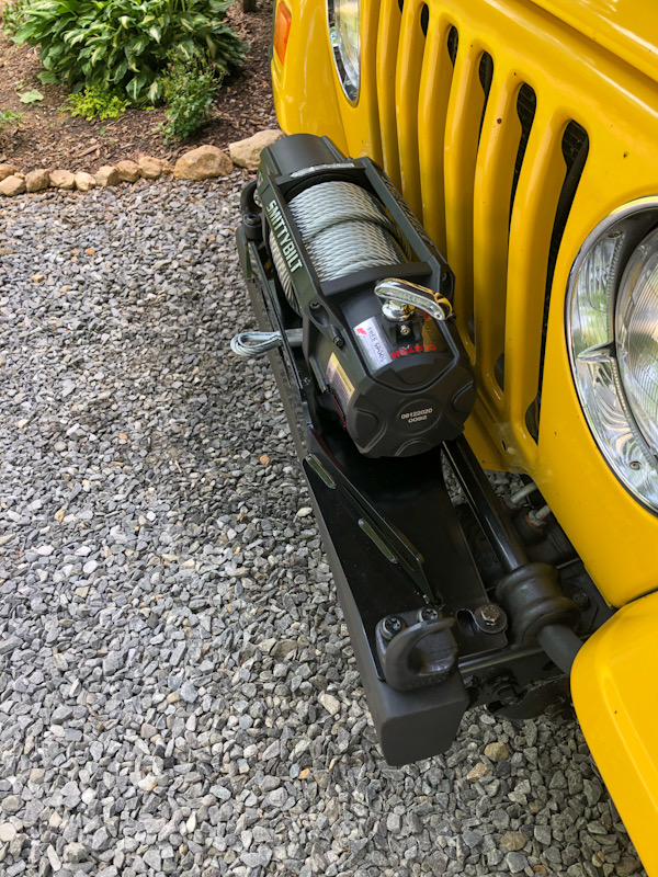

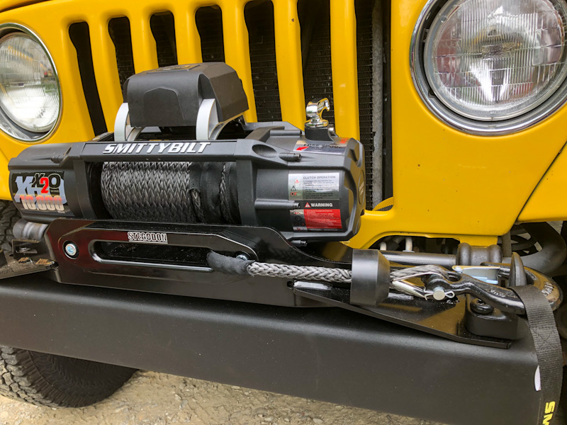

Well I have the winch solenoid mounted and battery cable is run. I have tested it and all seems well. Having the wireless capability seems nice šŸ‘šŸ»
Synthetic rope, fairlead and stop should be here Monday.

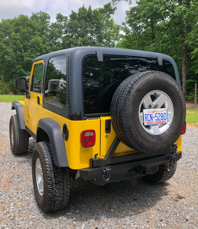

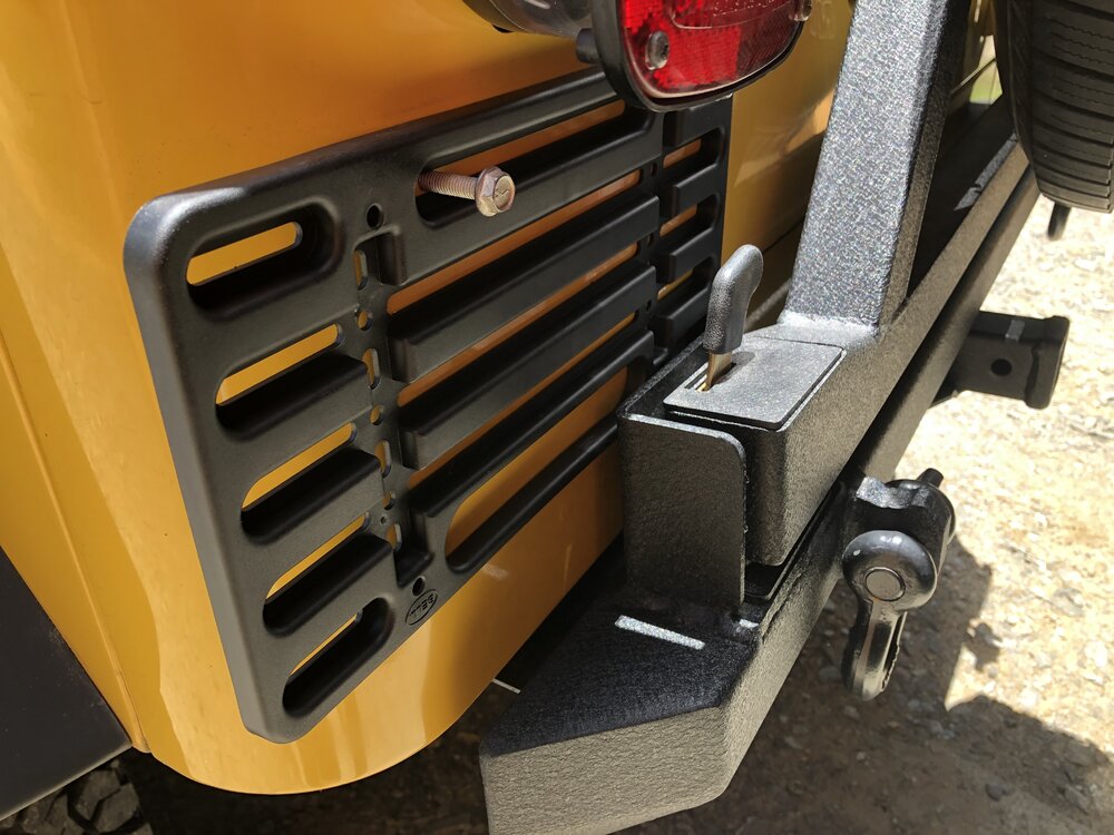

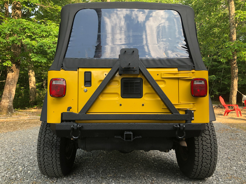

I got the rear bumper mounted. It overall seems well done. The latch is pretty nice, automotive door style latch. The license plate mount had to be removed for the latch plate to clear when mounting. Not a deal breaker but this question was asked on Amazon and the manufacturer stated the plate bracket did not have to be removed 🧐
I need a 285 spare so I’m going to a local used llantas store to see what they have.
I will figure out the plate and a light once the tire is on. Think I’ll skip the high mount stop light, none of y’all run em it appears šŸ˜„

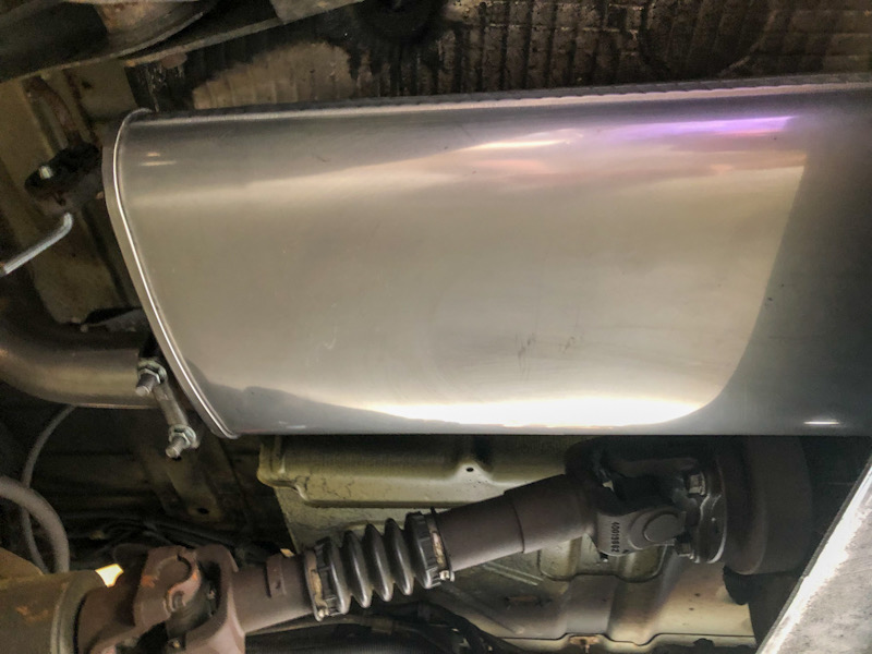

I have a stainless muffler and tailpipe in the shop to bolt on. May do that if it isn’t pouring rain.
:driver:
Today I rushed to get the new stainless exhaust on so I can make the trip east for a funeral. Winch rope, fairlead and stop got installed as well.
I used my tractor as a weight coming up my drive for spooling. At least 1000lbs I would imagine.

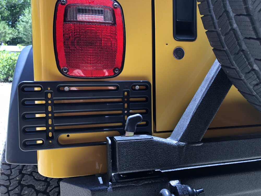

A replacement license plate mount that is thinner is inbound. Hopefully it clears the tire carrier latch. Still not planning to do a 3rd brake lamp unless I can’t get it inspected next year. Stations here are fairly laid back. The NC statute says 2 stop lamps are required (used to say one) but I know the 3rd lamp is a fed thing.

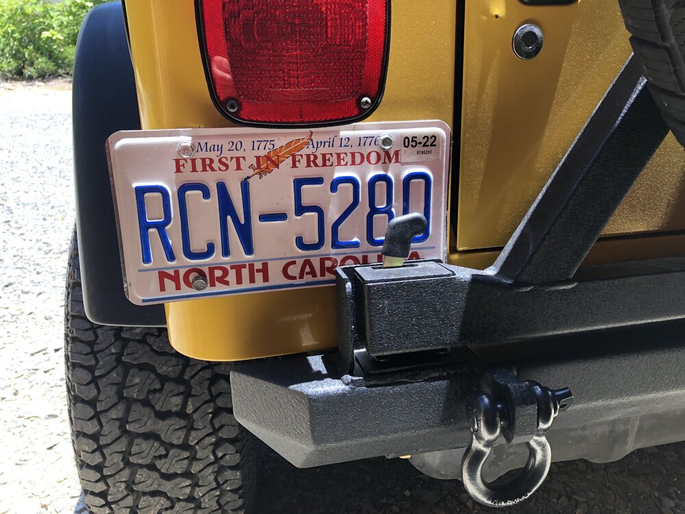

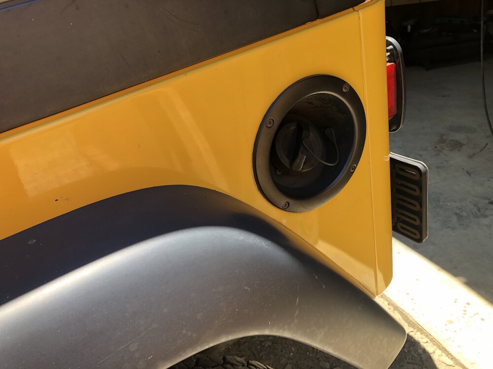

I received the Bell brand universal license plate holder and it was a success. It was thin enough but sturdy blow mold plastic. I was able to use the factory plate holder body holes and just had to shorten some plate screws so they don’t get in the body.
I decided I didn’t like the plate in the spare and the factory lamp works with this setup.

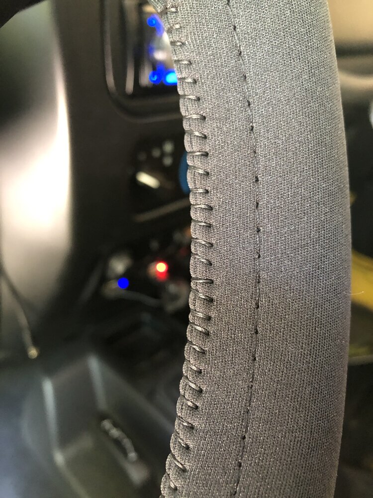

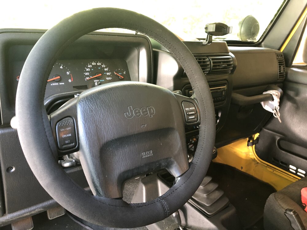

My steering wheel leather is in good shape but for some reason it is sticky. I have cleaned it with everything I know and it is still tacky feeling. So I bought a thin black neoprene cover from WM and stitched it on like a factory cover…sort of. I had done this before with my first Super Duty and it works and looks nice.
