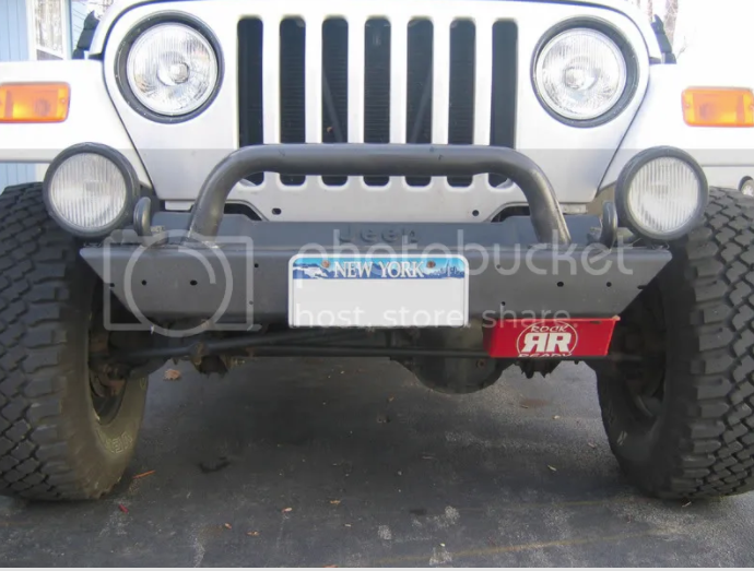

Yeah mine is Rusty's off-road. About the cheapest I found that wasn't shit quality. Actually the powder coating on my bumpers is outstanding. All these years later and still looks great. But...I mean I don't wheel 😎
@CasterTroy from Rusty’s Offroad?
What would cutting down the factory bumper and adding a winch plate look like...?
X2 on Rusty's. That's what we put on Cyd's jeep about 5 years ago. The aluminum bumpers on mine are broken and will likely be replaced with Rusty's f/r.

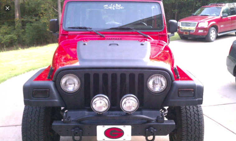

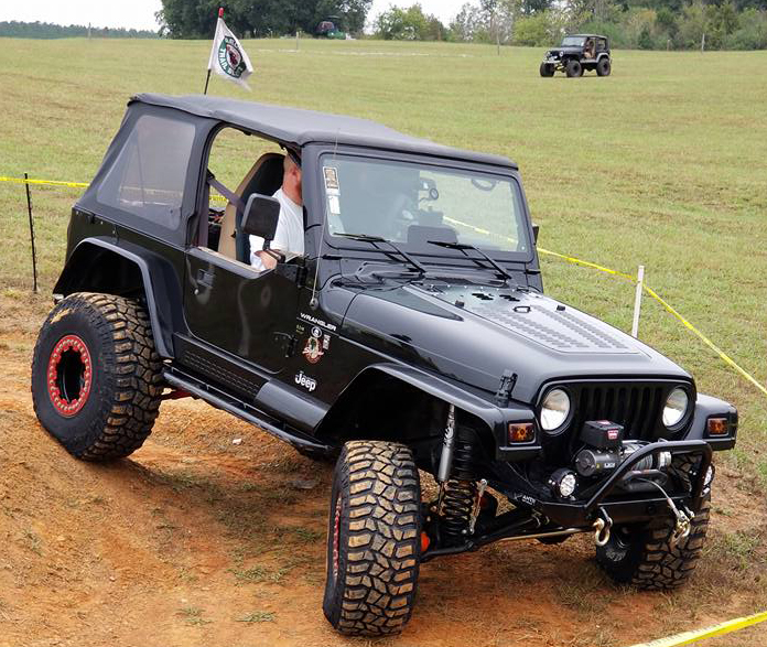

I saw one done similarly to the red Jeep with black on the hood. The guy had boxed in the ends and welded up all the holes. Looked pretty good.
I know it isn’t as gorilla strong as an aftermarket one.

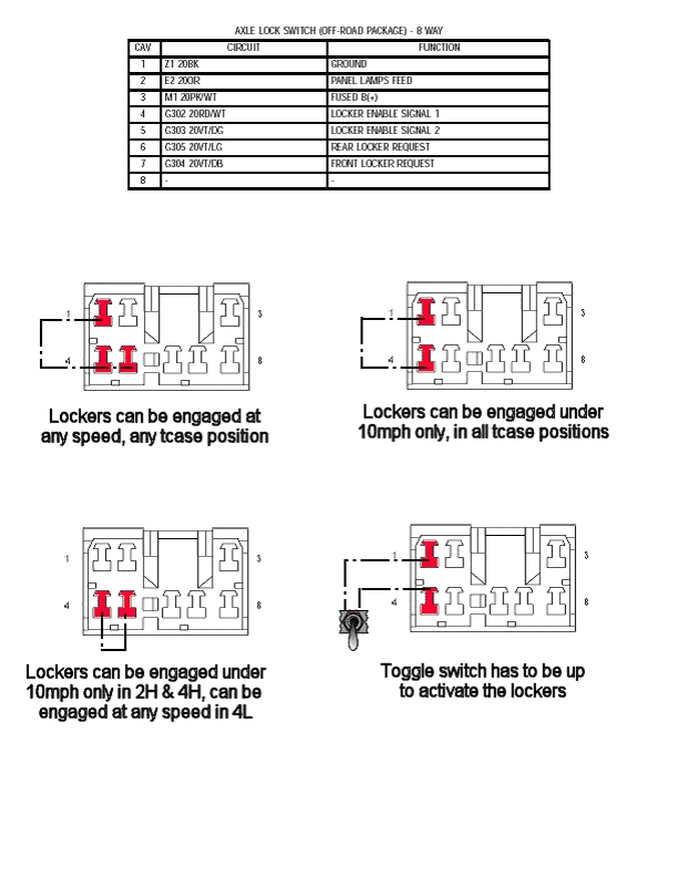

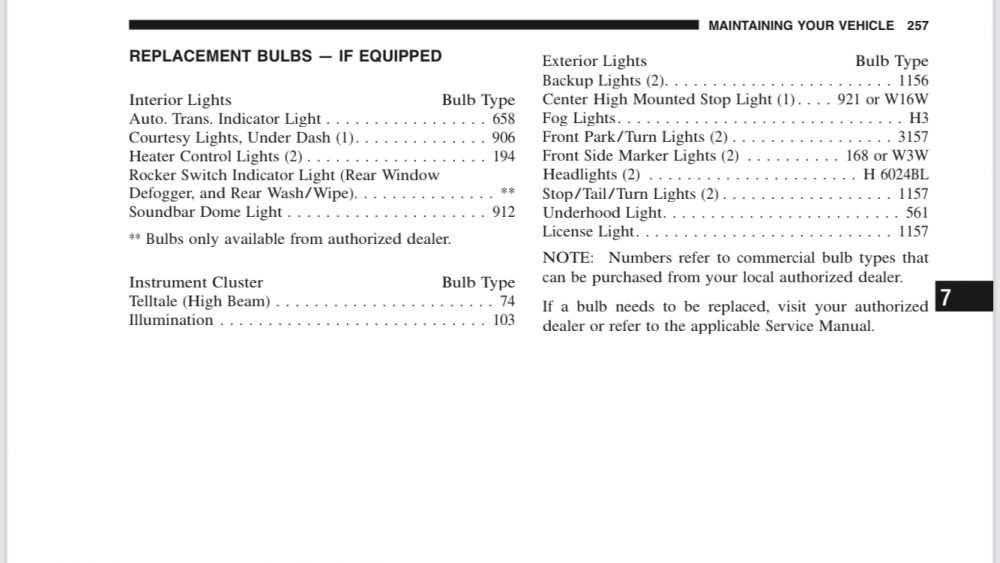

Couple of things that may help someone.
Jumper locations at the Rubicon locker switch and what they do.
and bulbs

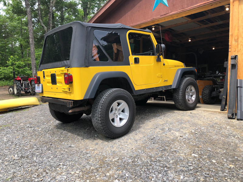

Picked up my hardtop from the guy I bought the Jeep from tonight. Wow what a difference at hwy speeds!
It is SO much quieter and it honestly seems easier to maintain speed.
Hearing the radio is nice LOL

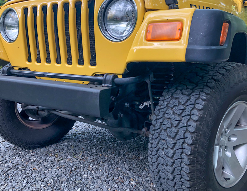

I need a stock straight TJ front bumper

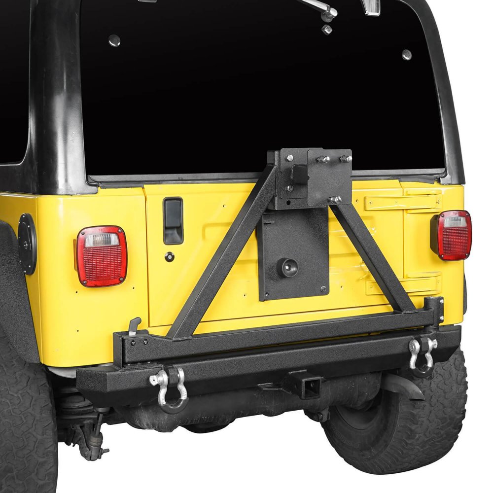

Ordered a rear bumper and swing away tire carrier from Hooke Road.

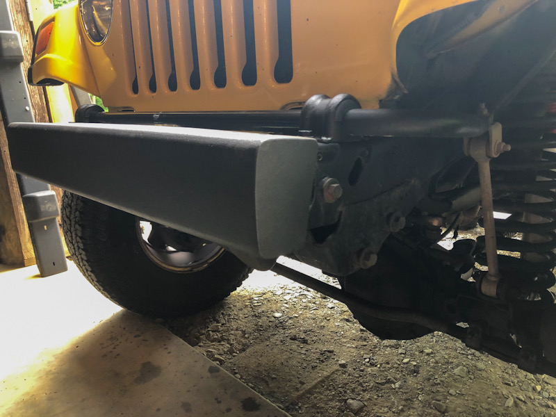

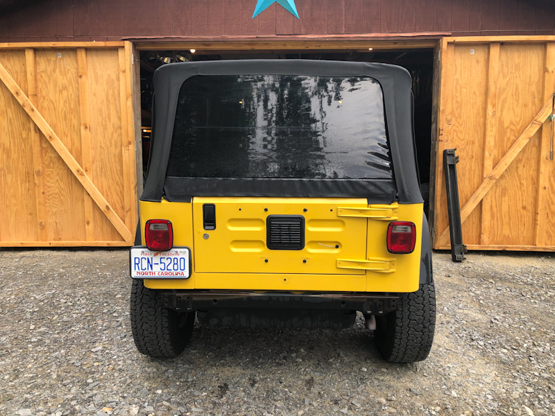

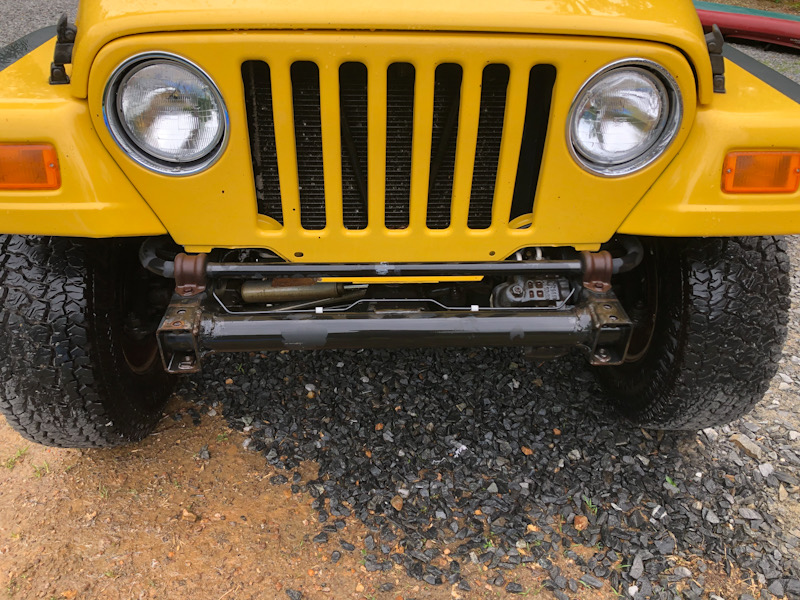

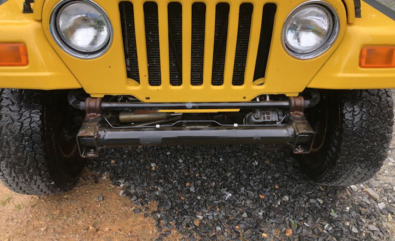

I removed the bumpers and spare today. Cleaned everything up in preparation for the bought rear bumper and carrier and my (re)built front.

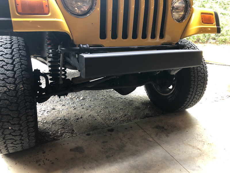

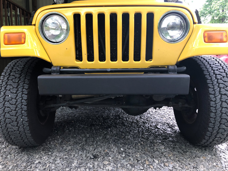

Smittybilt winch and raised plate will be here today so I put on my modded bumper in advance of their arrival.
I chopped the bumper that I picked up from @Lankford off about 2” from the frame and cut out end plates from the pieces left over.
A little welding and grinding and suddenly I’m @MarsFab 😄 I coated it with some etching primer and then Duplicolor Bed Armor.

I know simple builds like this are not as exciting as the real fab threads but…it’s ok.

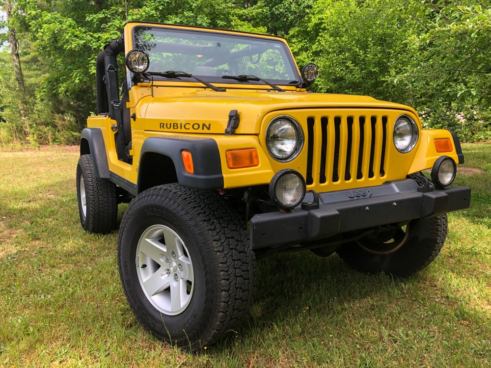

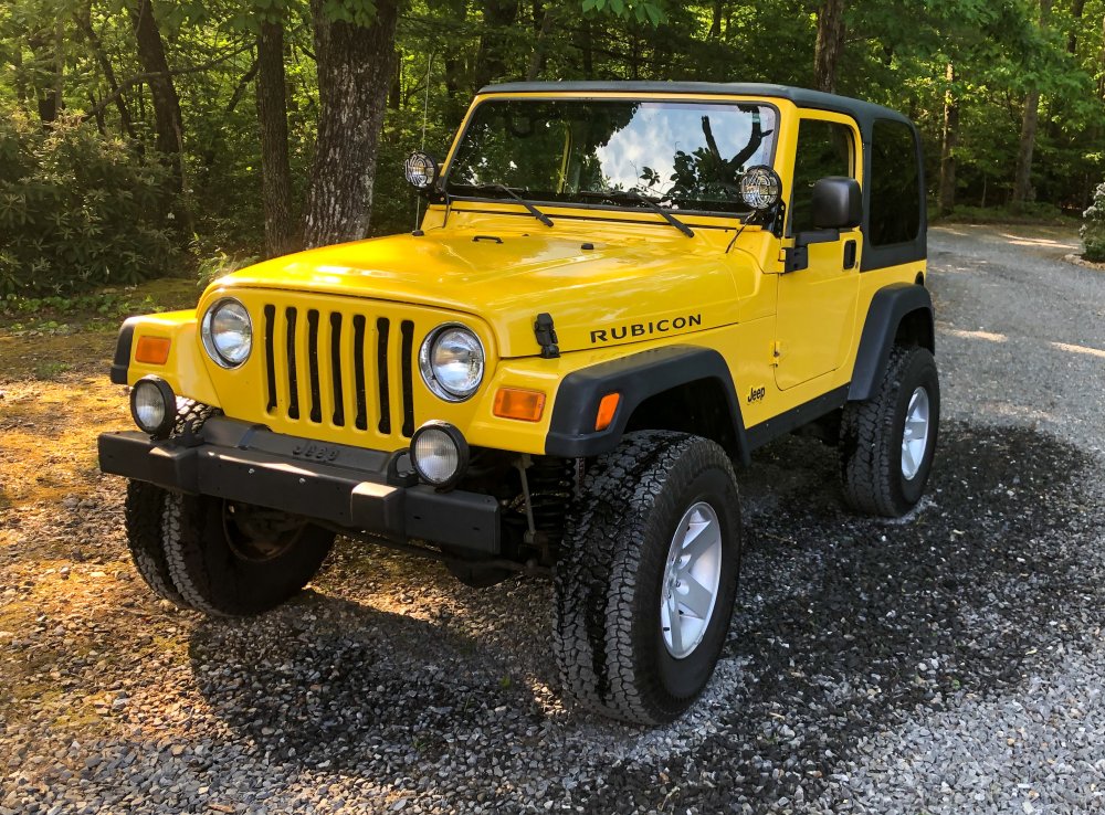

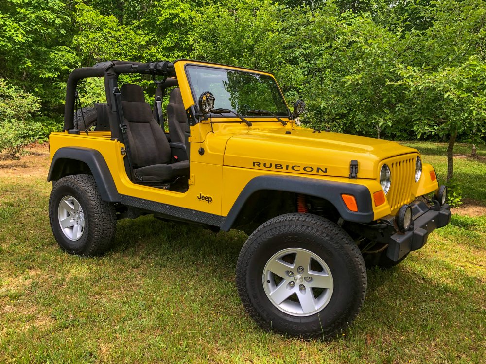

I actually really appreciate this simple build's like this because its more relatable, and reminds me of when things were simpler in my jeepworld.
Even though I initially said I wasn’t... I’m really considering flat fenders but they’d have to be painted body color.
My bump stops are factory, I measured them at about 3.5”. The poly Daystar type stops are 5”. Would these help to keep the bigger tires out of my fenders?
