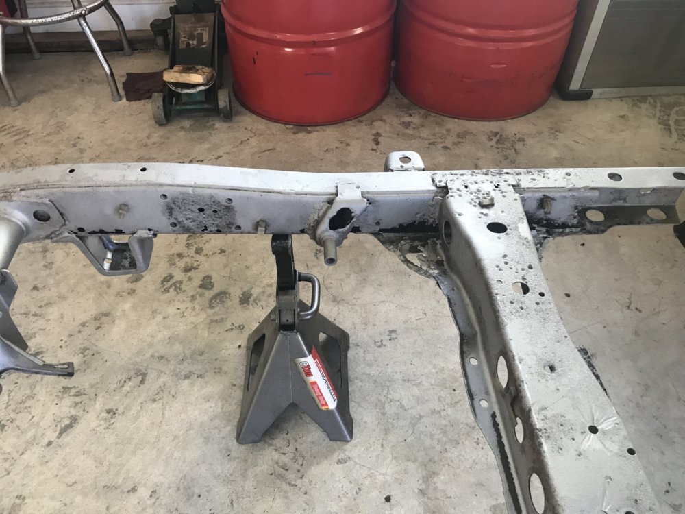

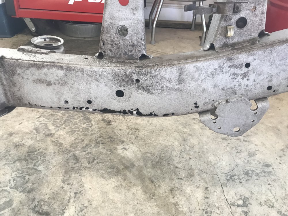

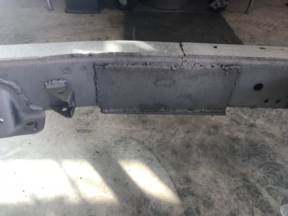

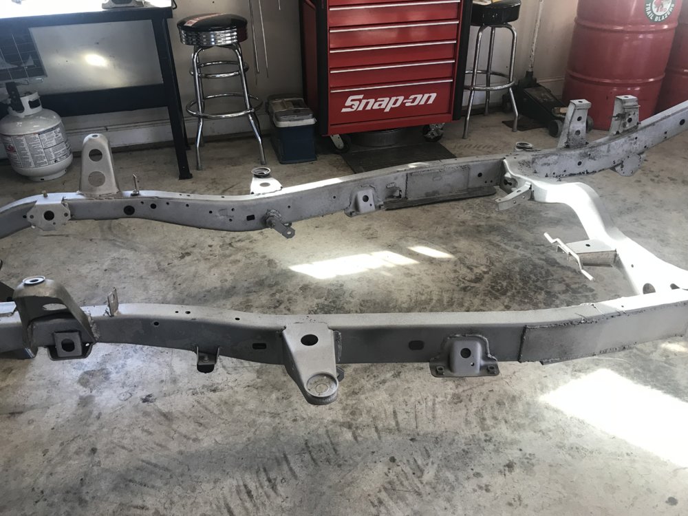

Picked up the frame today, had it sand blasted. Not in too bad of shape, it appears the back half has already been replaced once.
I think I’m going to replace all of the rear frame from where it was originally cut for the repair with 4x2 .250 wall....
The front half is in good shape.
You're Rockin it there!
Looks like the frame really isn't half bad! Kudos to you for getting it blasted before trying to work on it, you wouldn't believe the crusty rusty nasty gunk frames the install guys at my work have to deal with that would be so much easy to work on if they were blasted! For the back half, honestly I don't think .250 wall is necessary, 2x4x.188 should be sufficiently beefy and a lot easier to deal with in terms of moving pieces around building it. (.250 frame rails get heavy fast!) Especially since you (I assume) are going to be adding something in the way of a bed cage which will add more strength than a thicker wall or greater section height would add. Granted I build street rod frames and not 4wd frames but, our truck frames go under big engined fullsize street trucks and are most often 2x4x.188 for the back halves.

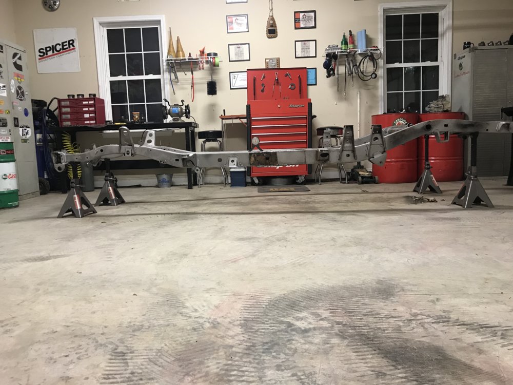

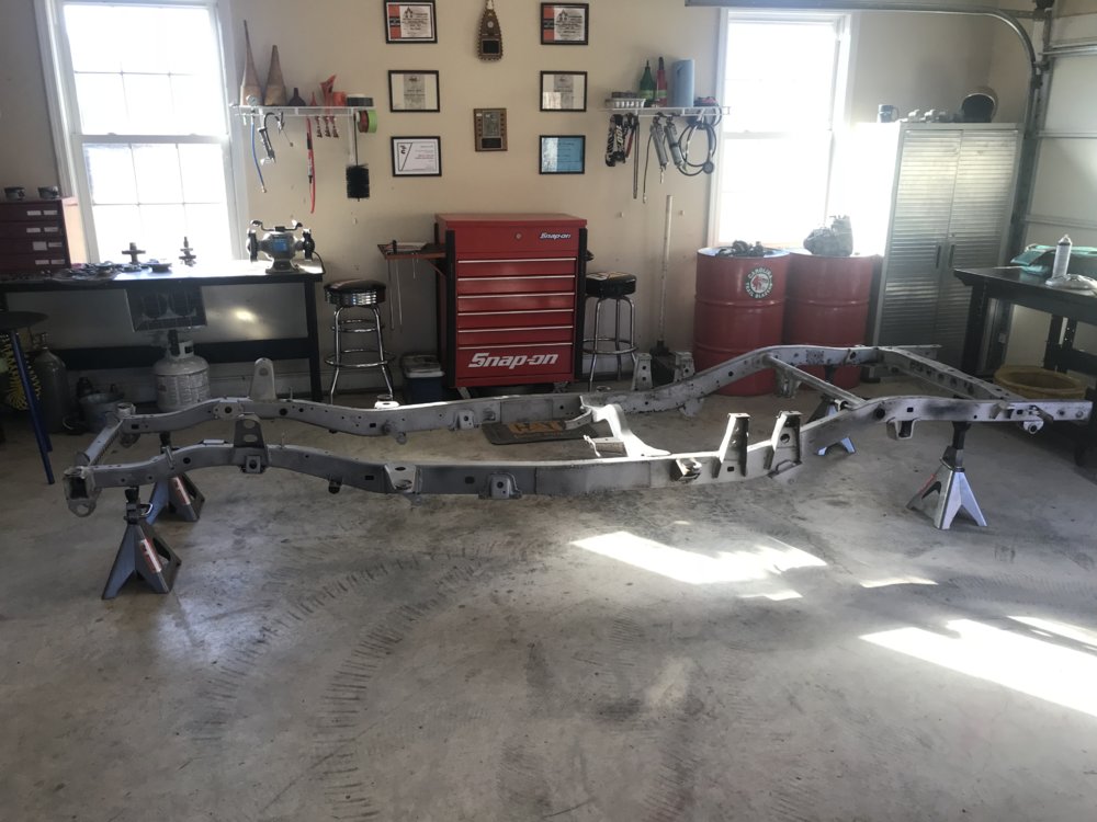

So...after having a few beers and looking over the frame the other night, I realized that there are very few mounts/brackets that I will be using on the frame, And the fact that it is not made to my standards...I have decided to build a frame. I am picking up my 2x4 3/16” tubing Saturday. I am probably getting in over my head, but what the hell! First question, looking at the frame from the side, would y’all keep the same profile, or change it up? (And why). I don’t have enough experience to think far enough down the road on the build to know whether or not to keep the factory profile. Keep in mind i am using factory axles with 3 link front and 4 link rear. I’ll ask about width later.
View attachment 281002 So...after having a few beers and looking over the frame the other night, I realized that there are very few mounts/brackets that I will be using on the frame, And the fact that it is not made to my standards...I have decided to build a frame. I am picking up my 2x4 3/16” tubing Saturday. I am probably getting in over my head, but what the hell! First question, looking at the frame from the side, would y’all keep the same profile, or change it up? (And why). I don’t have enough experience to think far enough down the road on the build to know whether or not to keep the factory profile. Keep in mind i am using factory axles with 3 link front and 4 link rear. I’ll ask about width later.
This build keeps getting more and more interesting :popcorn:
Sent from my SM-G950U using Tapatalk
You just opened a massive can of worms. But if I were starting from the ground up I'd build off a subframe. More than likely a goat built kit like @mcutler did on the Manche.
