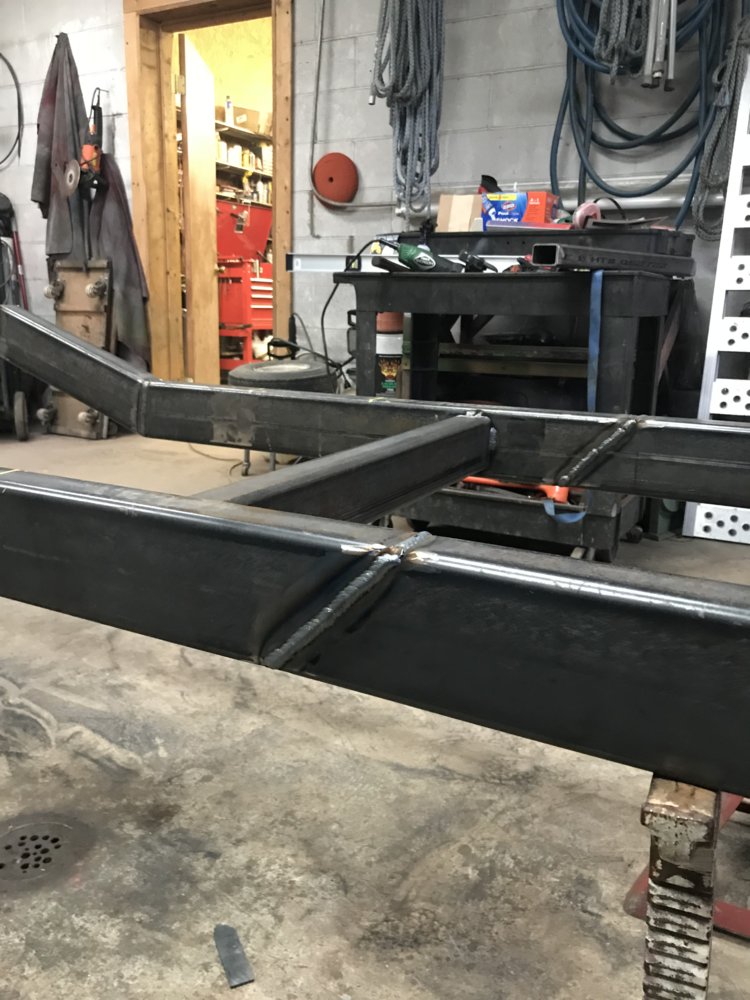

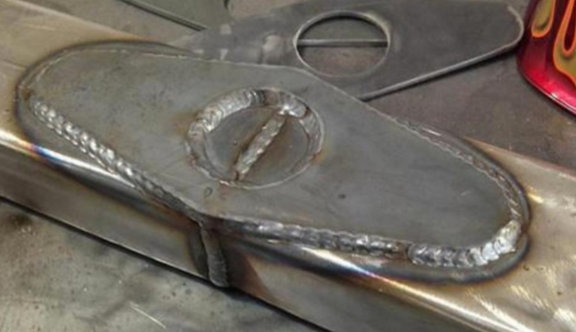

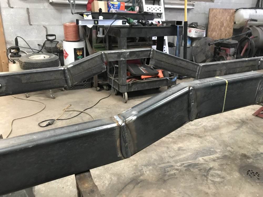

Not a problem at all, a little cleaner and easier to work around if internal, try to avoid vertical welds, diagonals will give more strength, less stress.

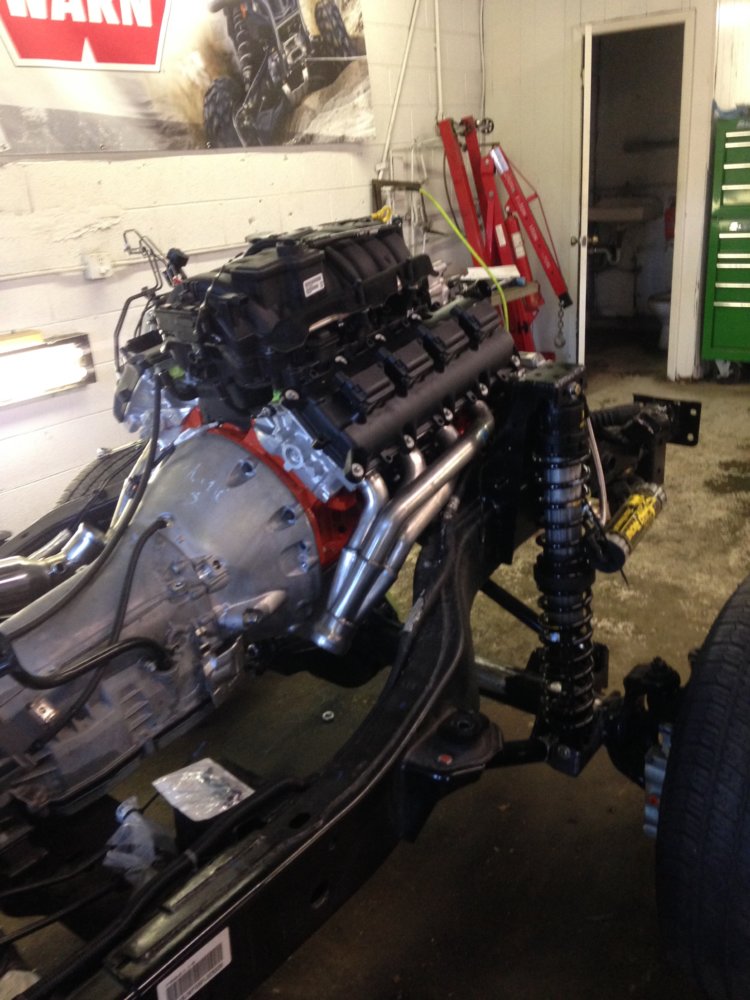

That engine made 700 horse at the crank, naturally aspirated, came with a big price tag! 40 grand installed! My rig didn't cost as much as the wheels that went on that machine!

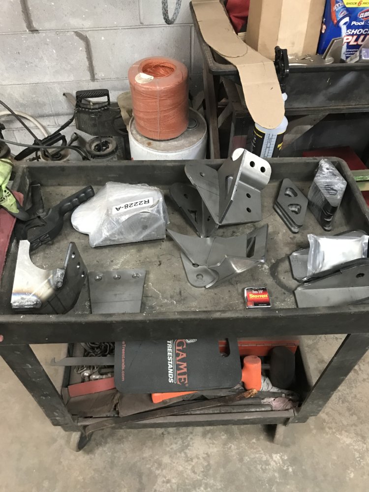

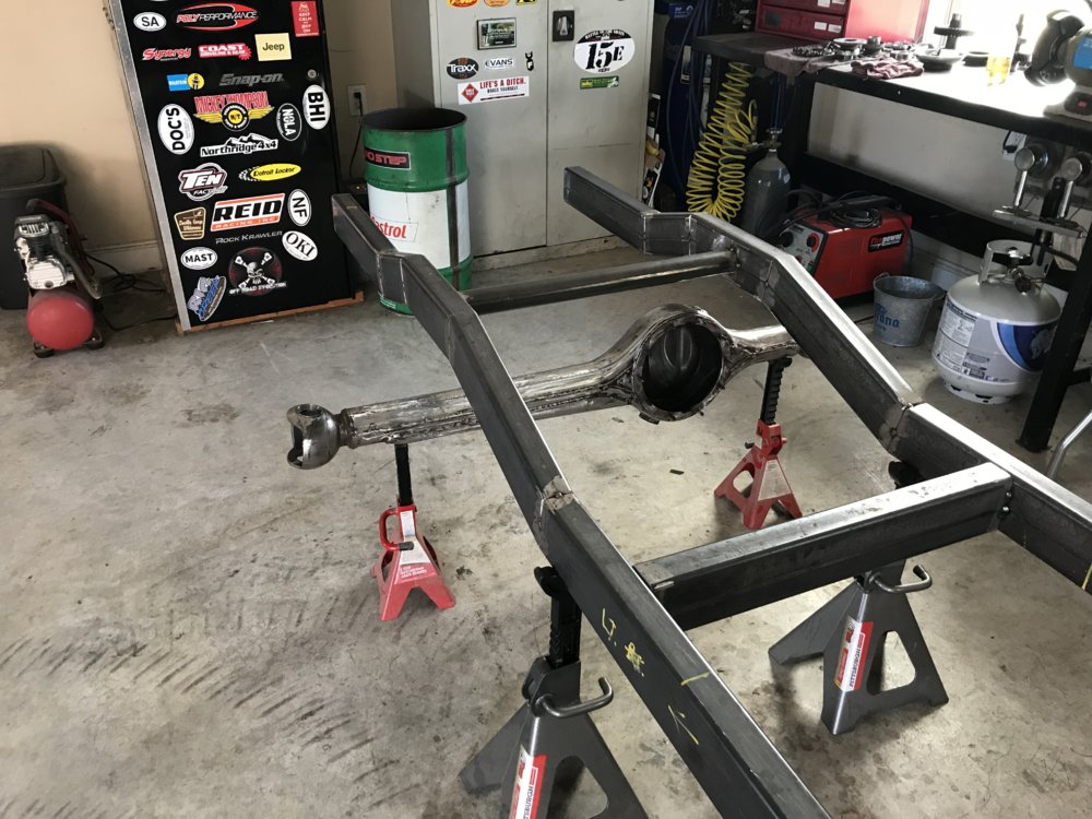

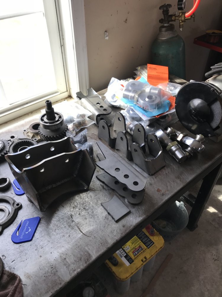

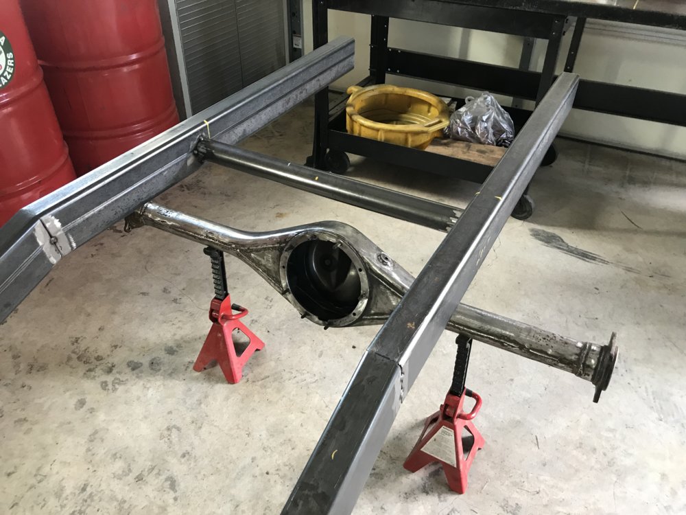

Got the axles torn down and all of the brackets off of them. I’m not sure what’s next. Maybe start acquiring suspension brackets and stuff. I don’t know. But I do know that I’m glad to put the grinder down and grab a drink!...yes the mail has already ran here in the suburbs of Dobson!!:beer:
Are you going to run leaf or link?
It's really coming together nicely, I just got my pile in the garage and started tearing off extra parts, got the week off hoping to get the bed and fuel cell put together.

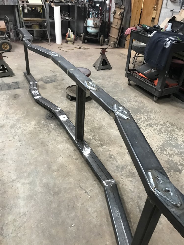

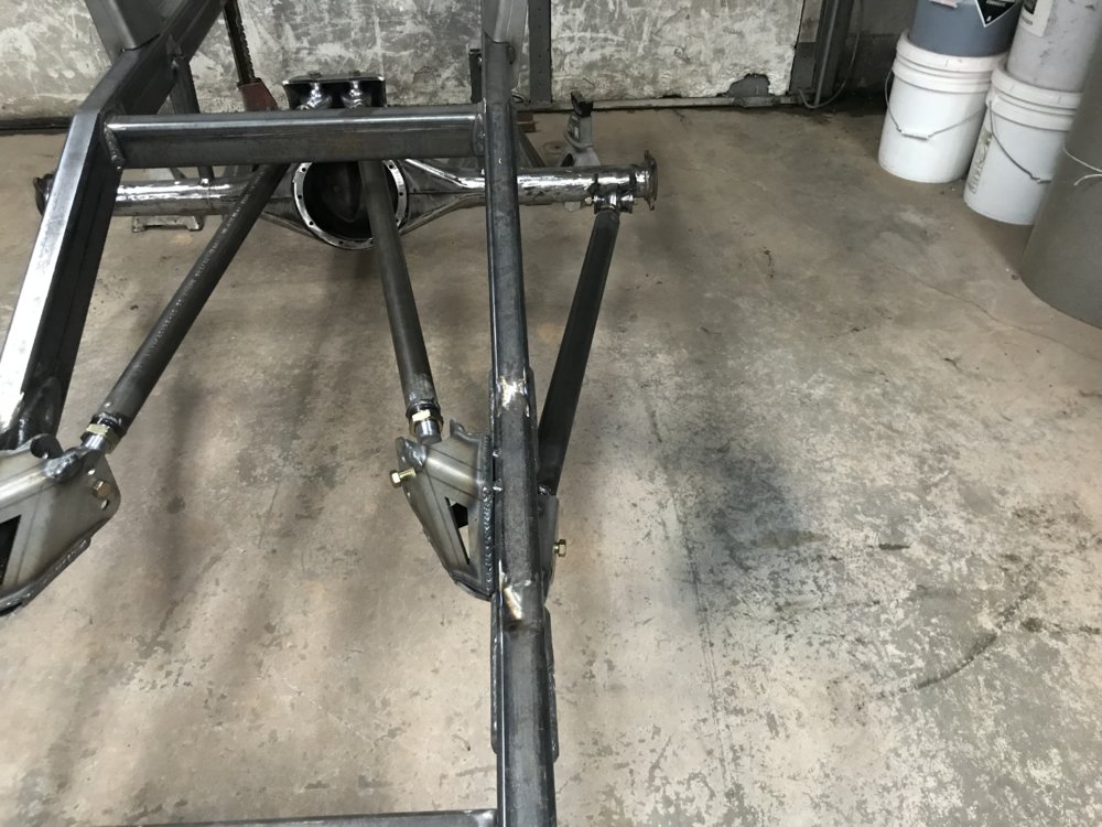

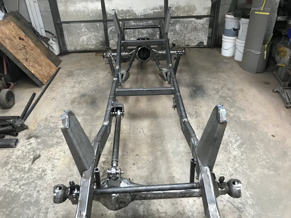

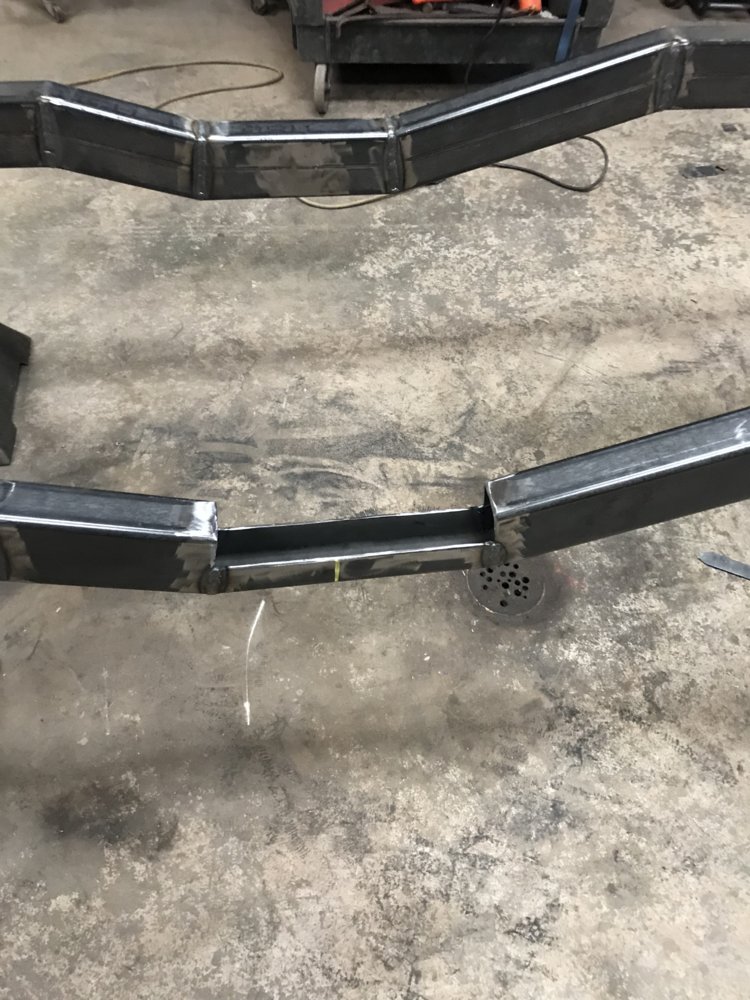

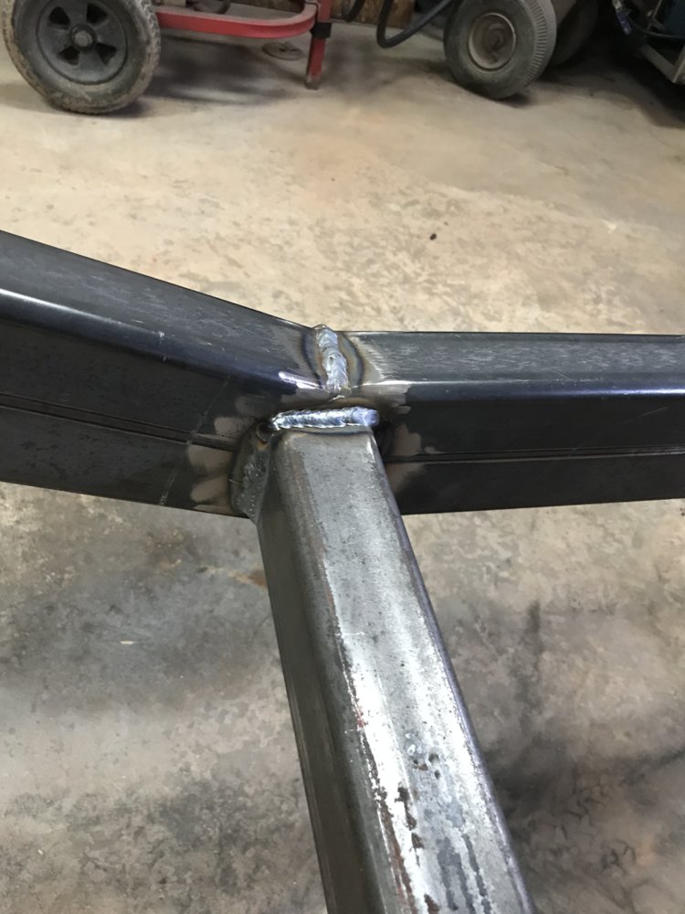

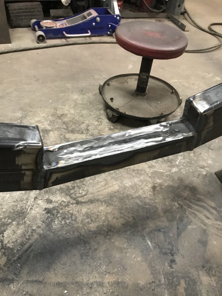

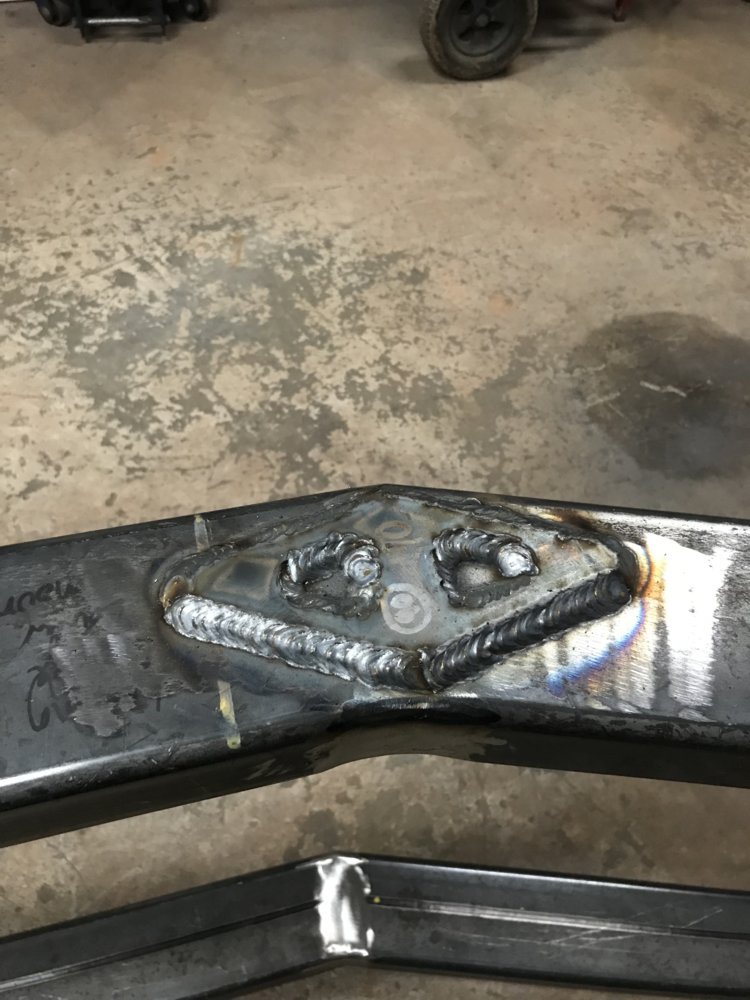

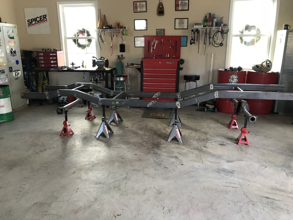

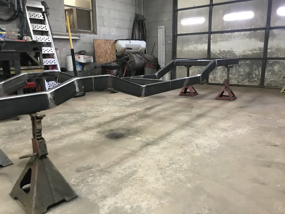

I finally got to work on the rig this weekend. I got the final welding done on the frame and it’s prepped for the plating. I am doing a 4 link rear and a three link in the front. That’s why the frame is notched in the front. And thanks @Chris_Keziah for helping me with the link calculator. The reason I am doing links is that I want to learn more about building a suspension and the only way I will learn is to do it. I will post up some pics when I get the link set up done. And keep in mind, I’m a mechanic, not a fabricator or welder so this is a challenge for me.
Looks Great There!

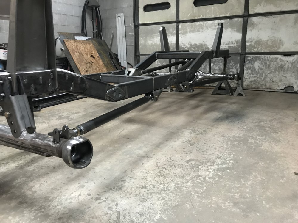

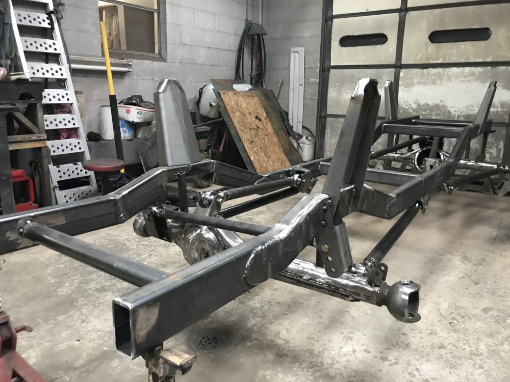

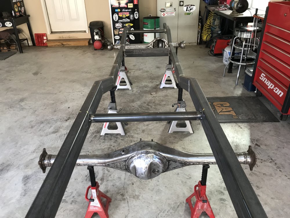

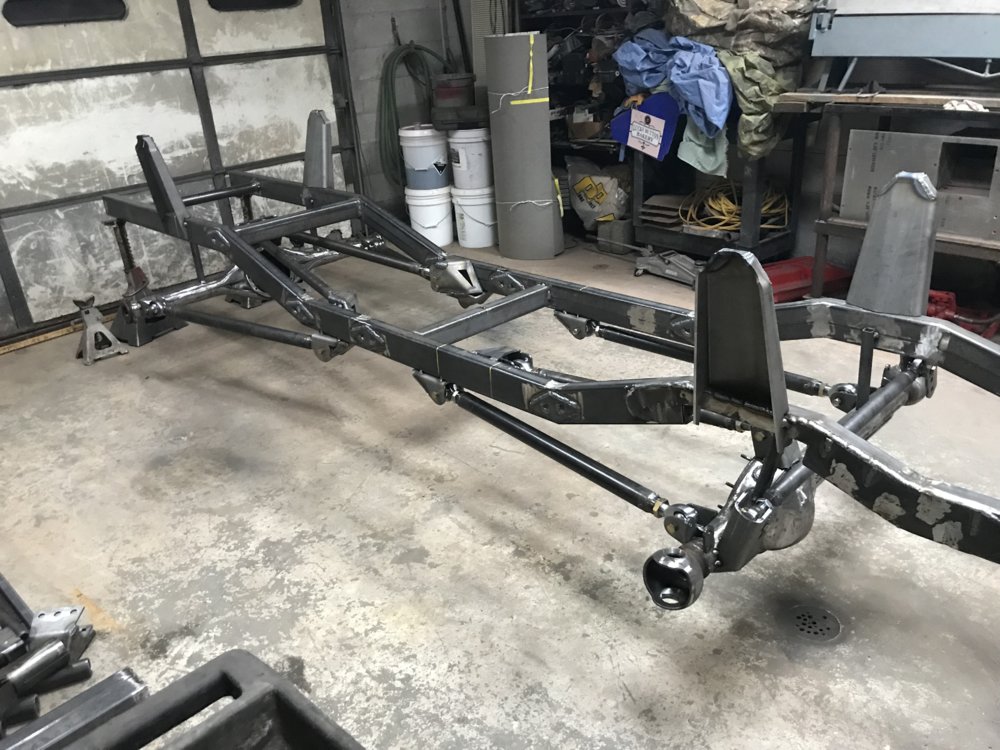

View attachment 286929 View attachment 286928 View attachment 286927 View attachment 286926 View attachment 286925 Some progress on the build. I feel like I’m at a good “check point” in the build process, so I’m going to take a little break from it and start getting some parts for the axles.
Looking good man! Excited to keep seeing the progress updates.
