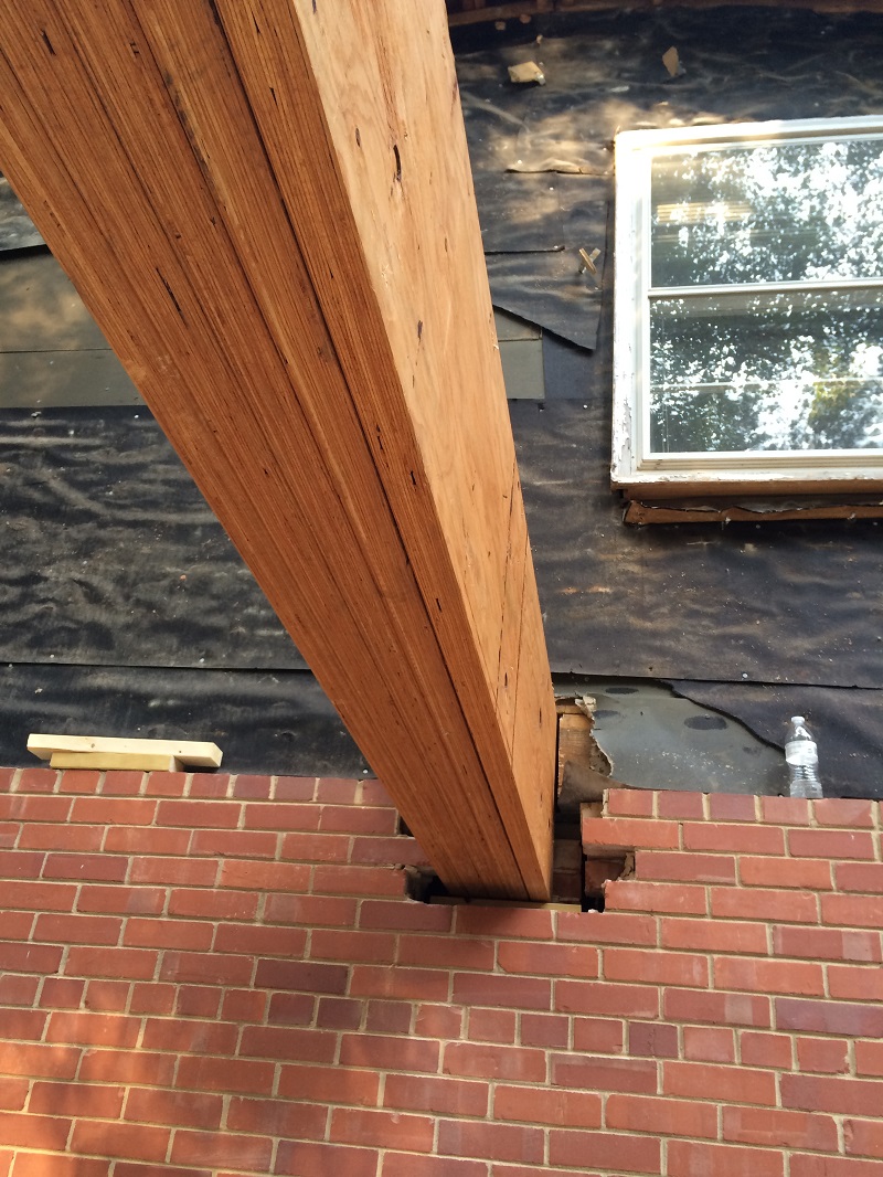

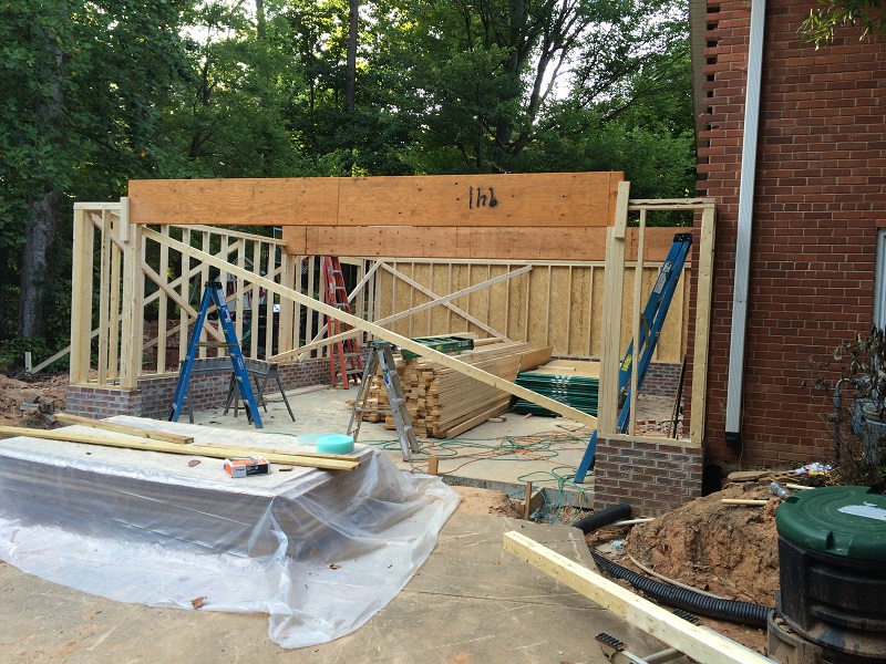

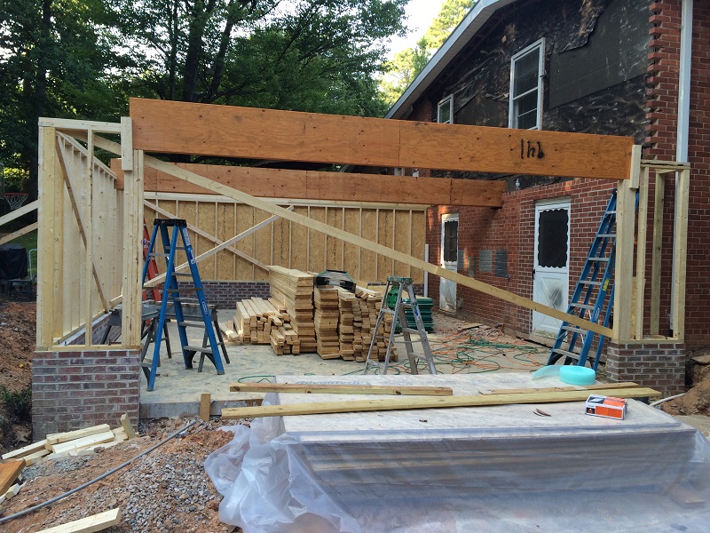

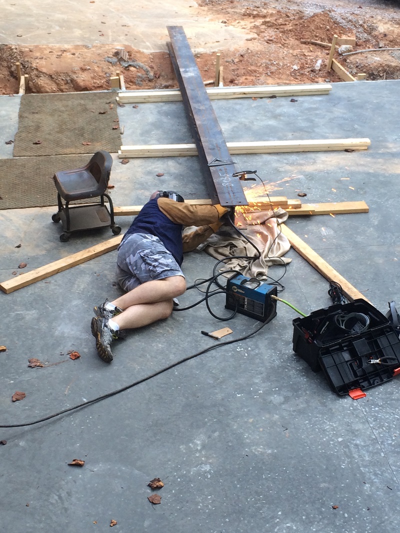

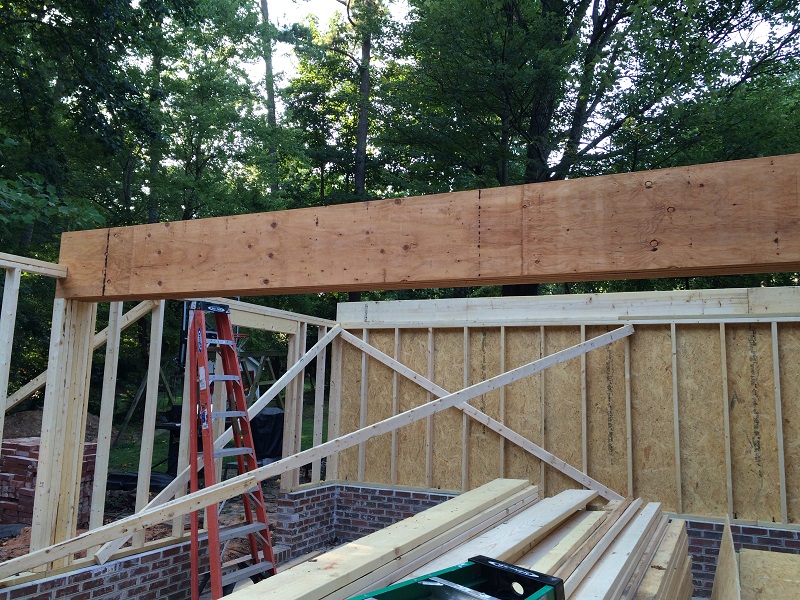

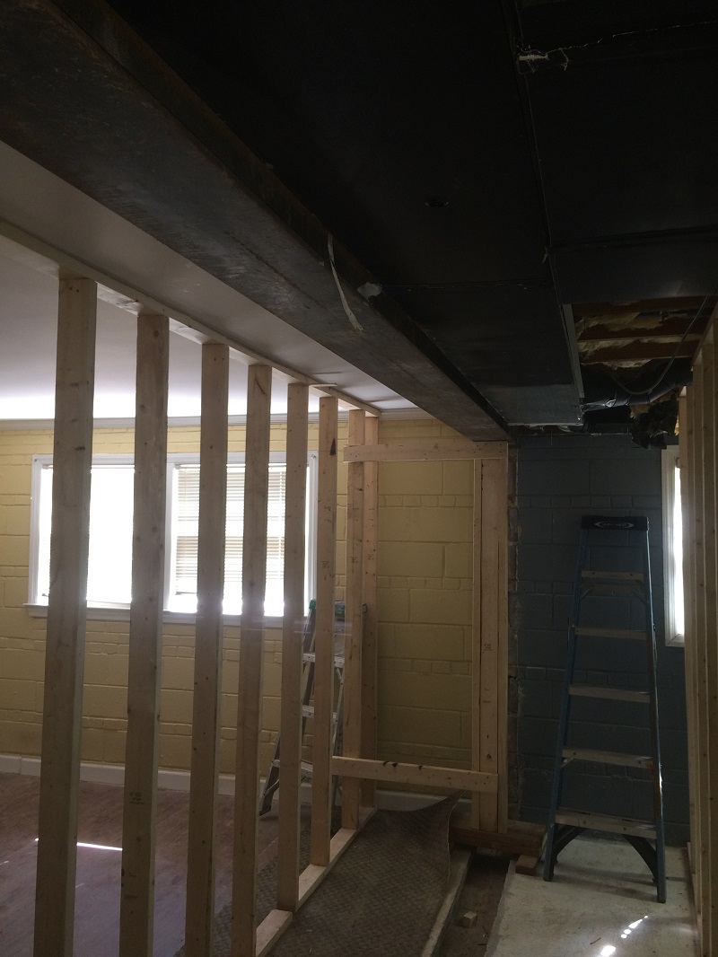

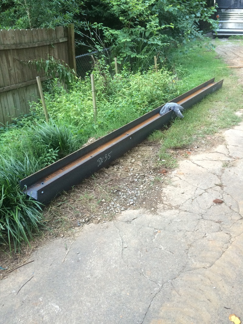

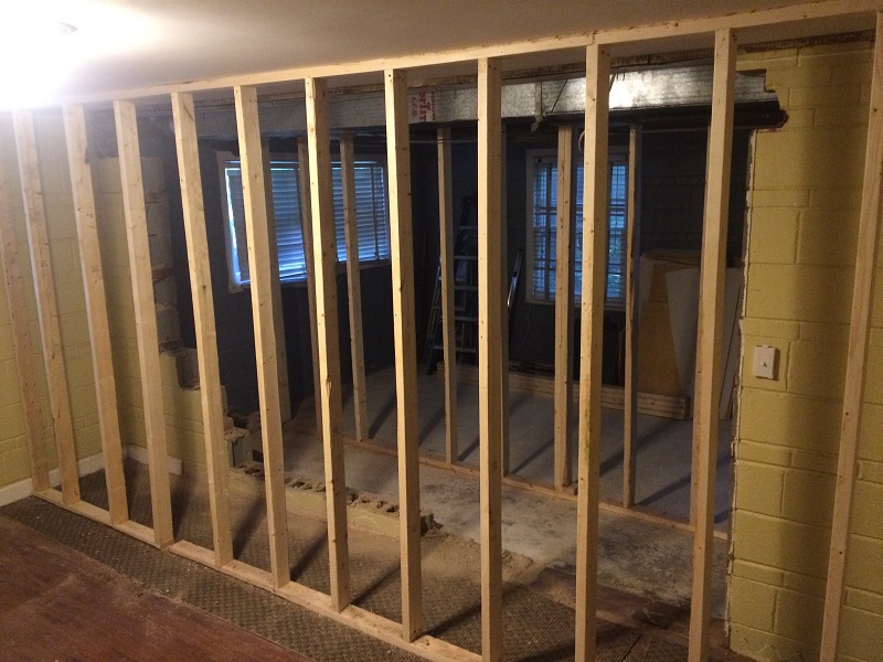

Is there a height limitation for the beam? They could have used a taller, thinner beam and gotten a lot more stiffness.
Is that container #69? Pretty sure it's been at my house before. That's the sort of thing you don't forget.
Cool. When I was doing the calcs on the loft for my shop, the ideal beam height was around 16" for a 34' span, but I could have gotten away with an 8" beam if it was thick enough. That one in your picture could easily hold a truck if properly constrained.I need it to be as short as possible.. we do have a height issue that this is helping us fix

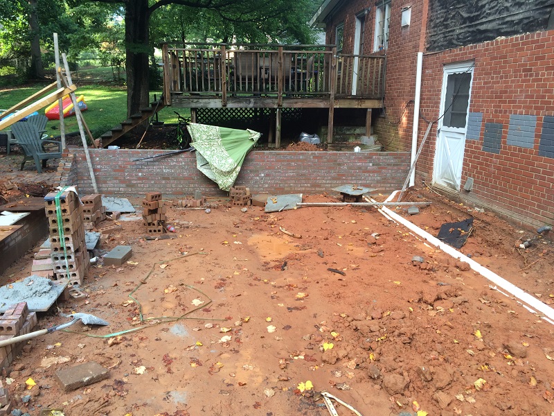

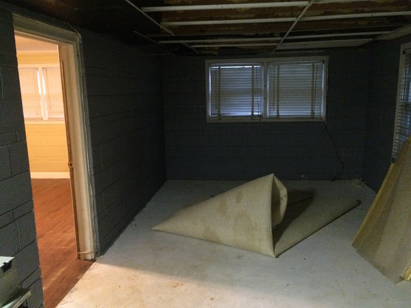

Ken, are you planning to use a block sealer/primer on the brick before you paint? We're getting ready to paint ours too.

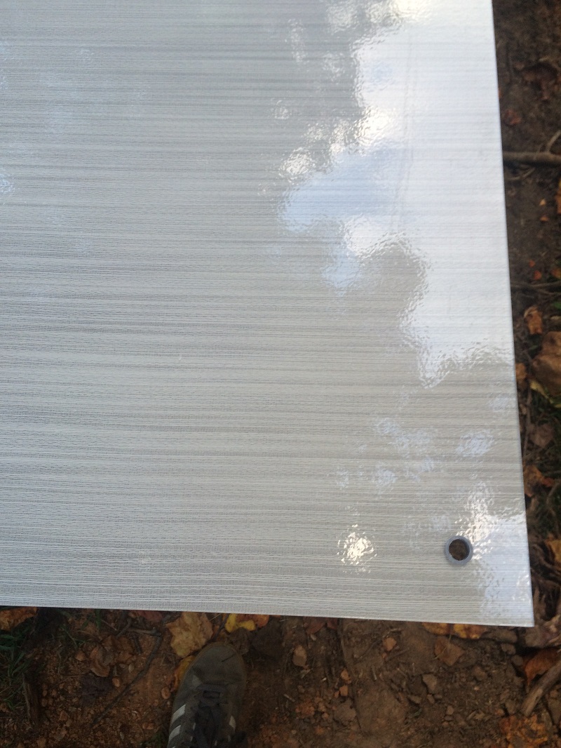

Are those door glass, and do they have a tempered mark on them?
