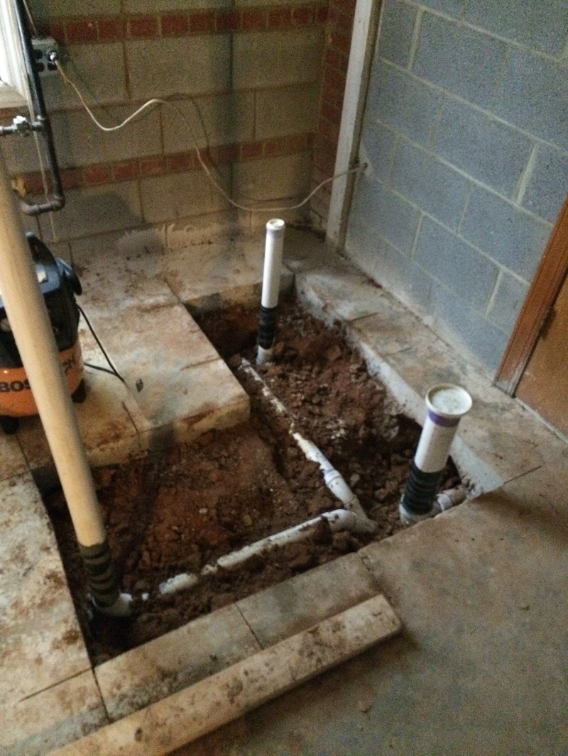

plumbers came and did some more in basement but I guess they cant measure very well as they were off by about 2.5' so they need to redo that

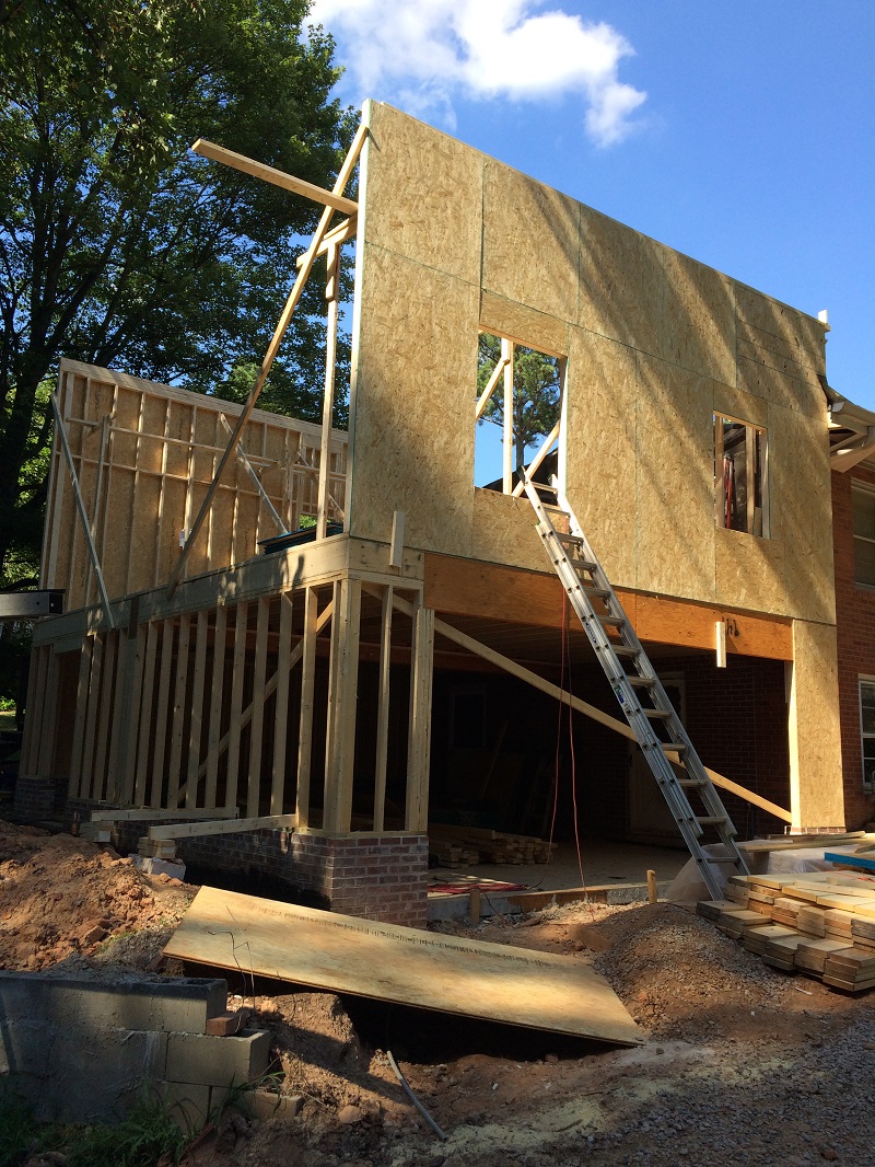

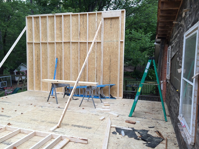

the guys got all the joists up and second floor layed down

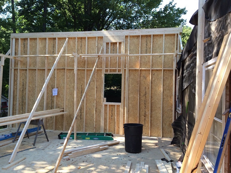

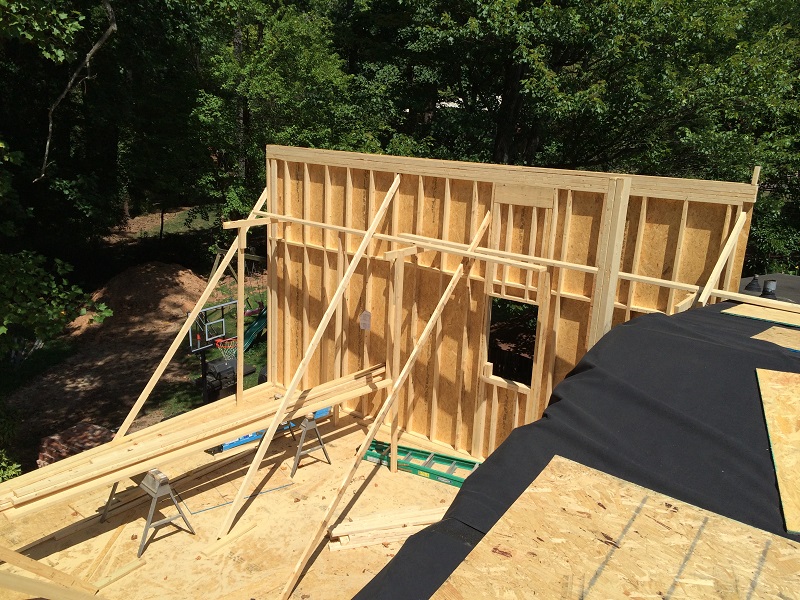

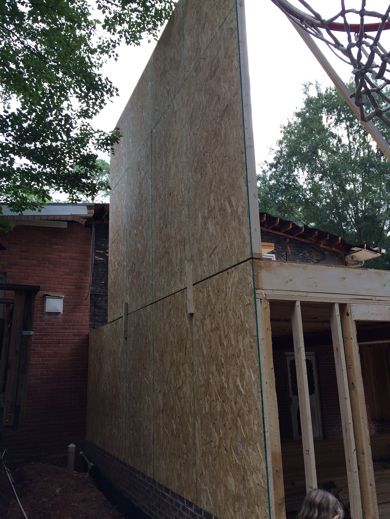

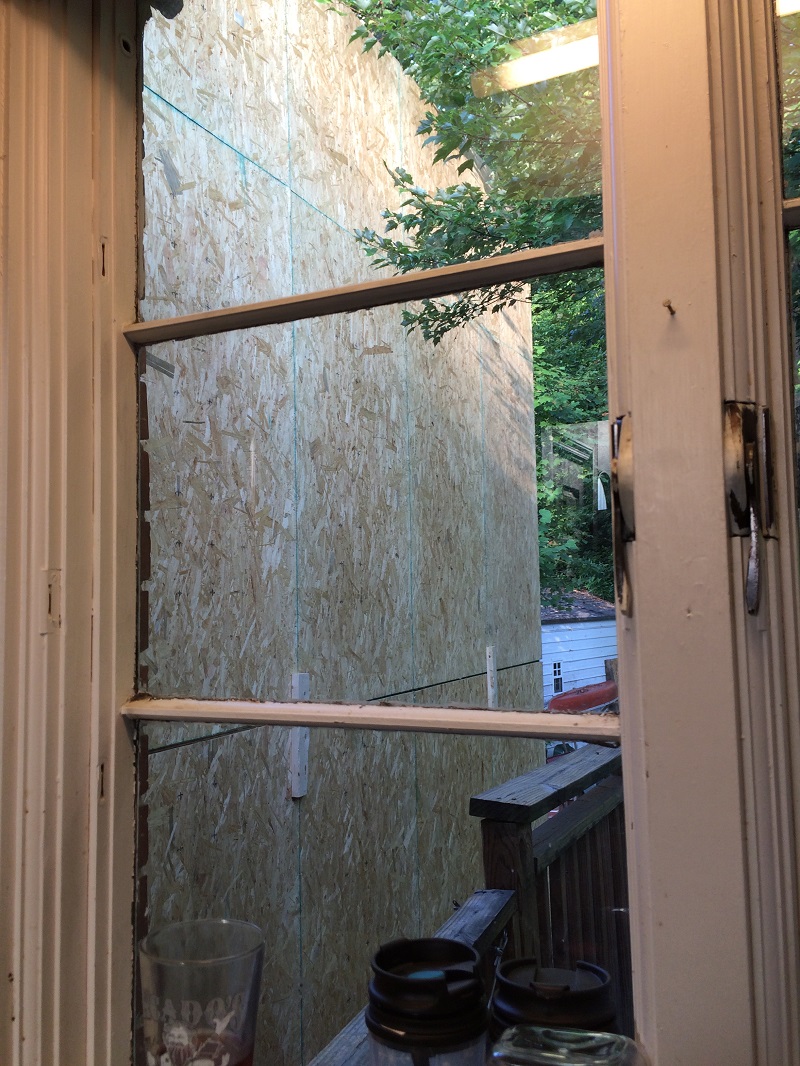

and that outside wall looks HUGE just sitting there by itself

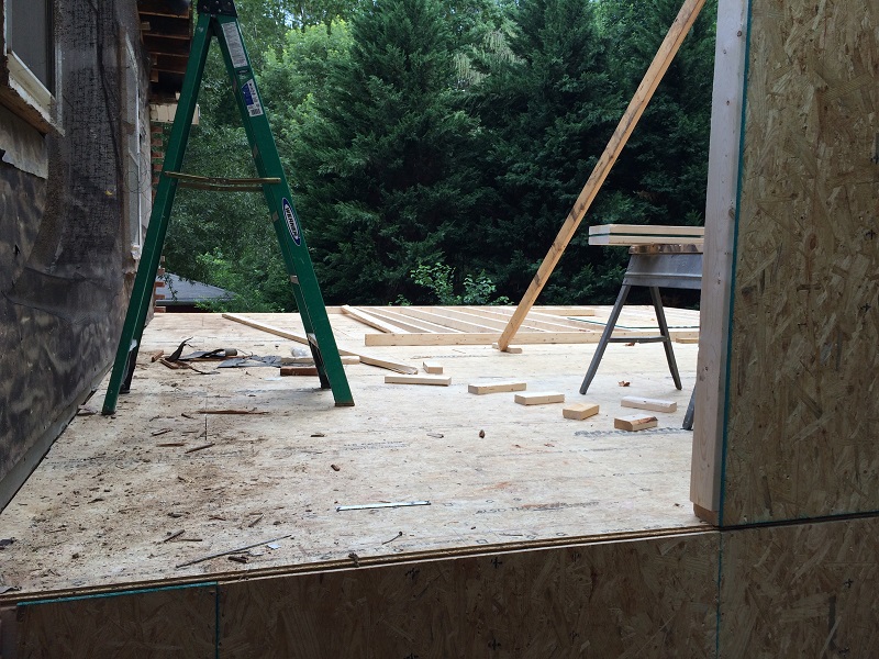

and lastly my view this am from current kitchen window

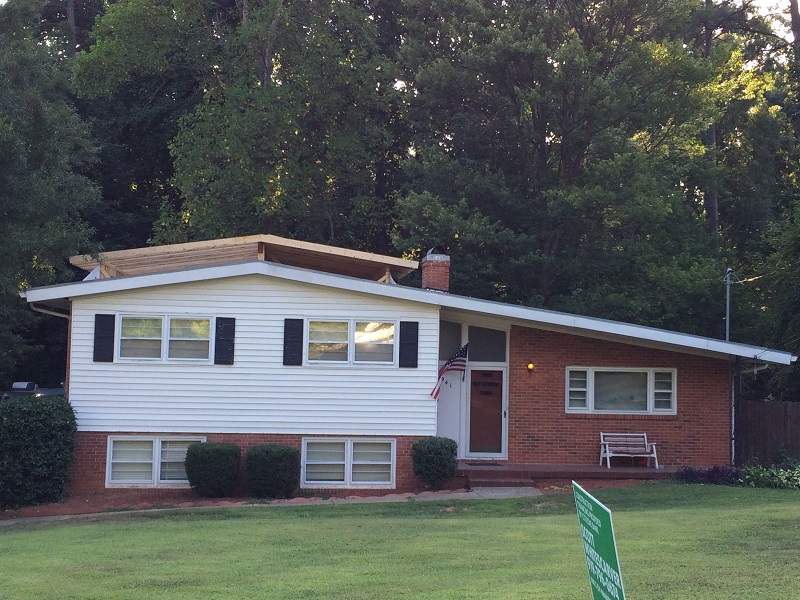

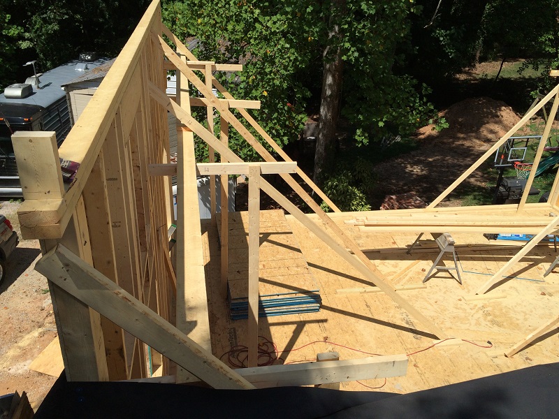

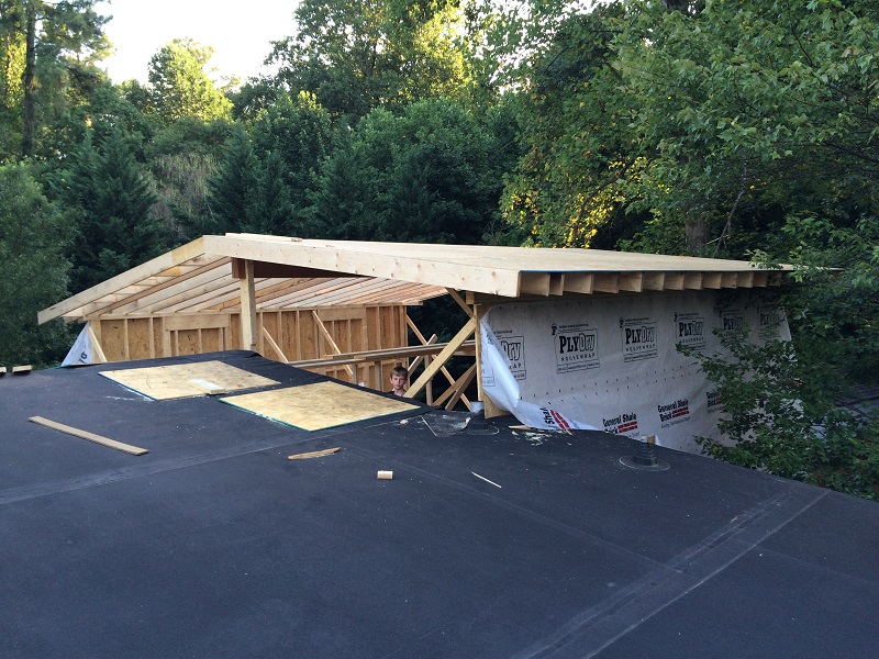

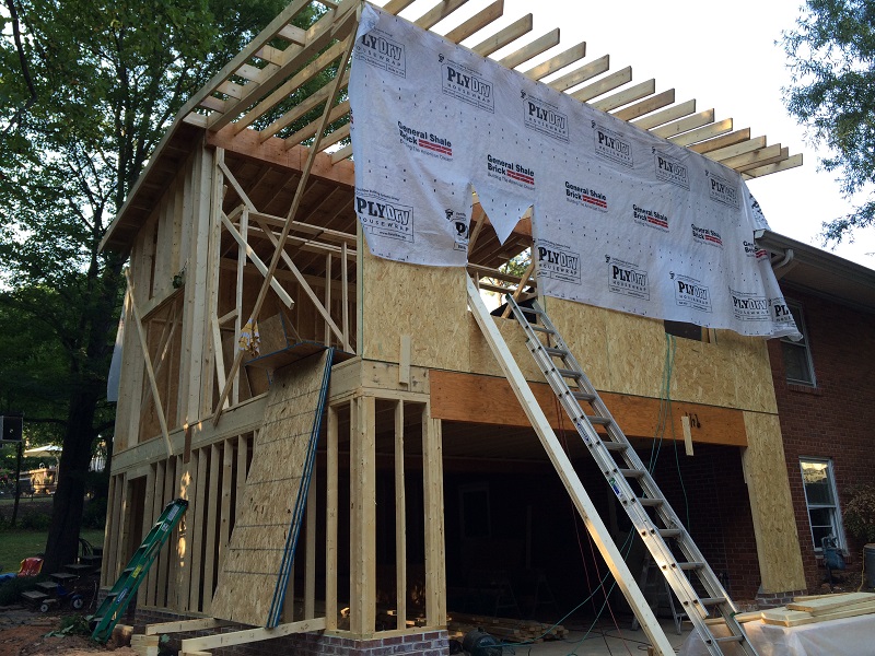

new roof line.. and my son found the ladder :)
The guys got the roof on and all the walls enclosed.. waiting on windows to show up and also plan to start the inside wall framing today or tomorrow

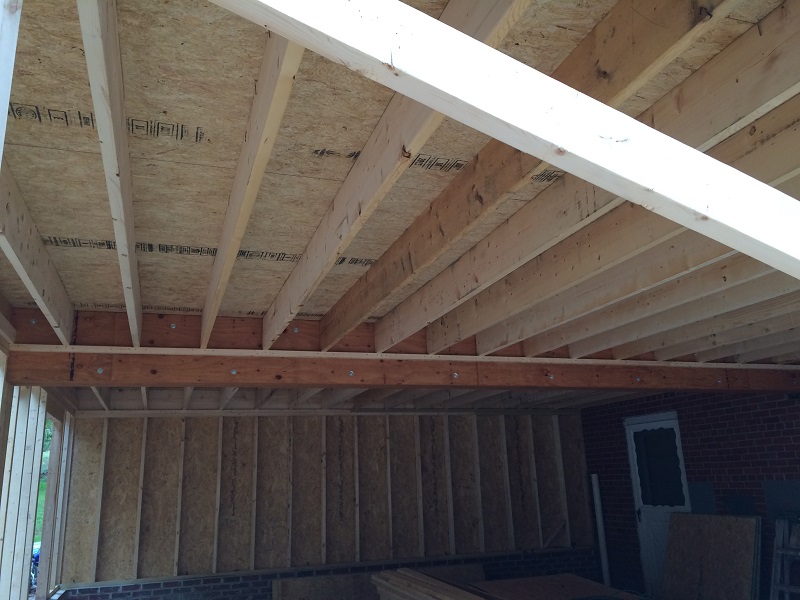

we also got the steel supports in place that hold the steel beam up so now we can start framing the downstairs

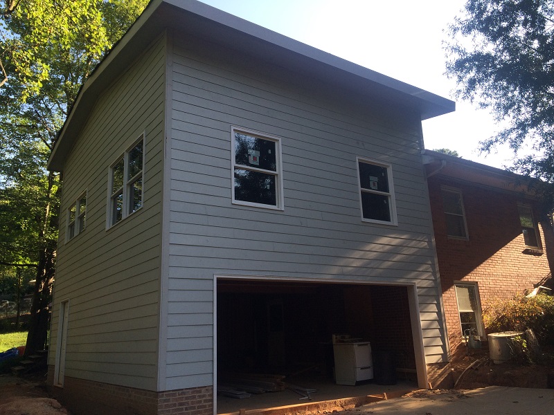

new garage side

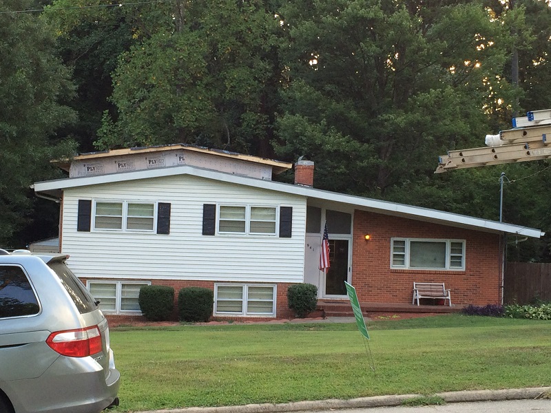

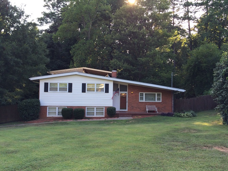

new roof line from the street.. we are very happy that you really cant see a lot of the new addition to the house since the trees block 80% of it

It's nice that you didn't have to use pre-fab trusses. I bet it was a lot cheaper without them, huh? How old is that house? Looks late 70s-ish. How many sq ft will is be once you're done?
What kind of beams are the ridge beam and the headers? Those look perfect for my upcoming build. I don't want to use trusses because I want to keep it low and lean and use all of the available interior height.

Yes built the beams on site so we can keep the low roof look to match existing house. House is 1955. The house will be around 2300 when done.
The beams used in garage are 18" by 22' we put 5 nailed together then drilled and bolted them all together. The roof line are 14" by 22' we put 3 up there.
All are laminated wood beams

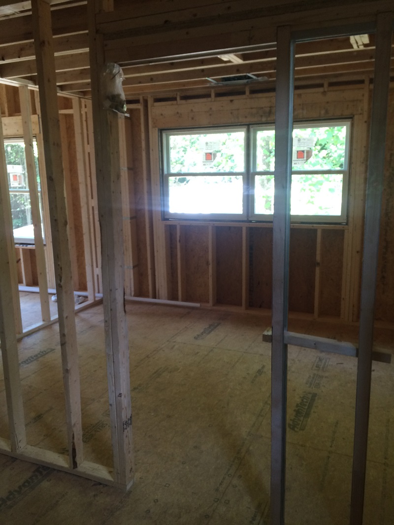

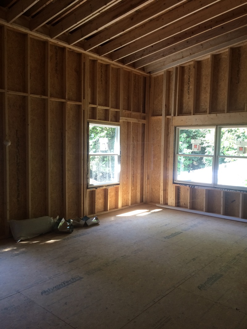

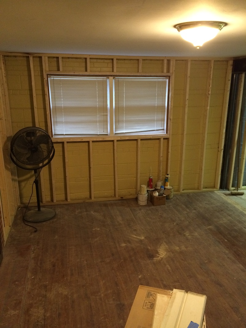

Finished all outside on new addition, ripped out kitchen and finished all interior framing.. plumbing is 50% done and new HVAC is 50% done. the electrician should be starting this week which means within a week or two we should have all permits done and then we can start insulation and sheet rock
exterior done
looking into new master

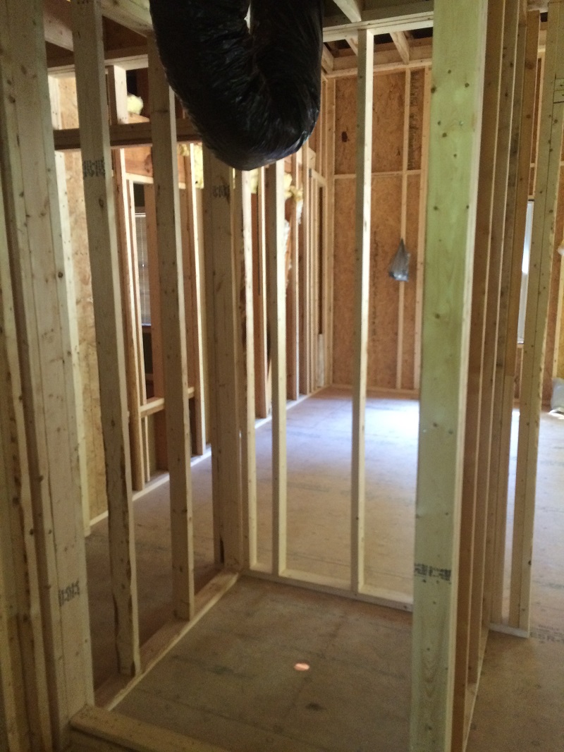

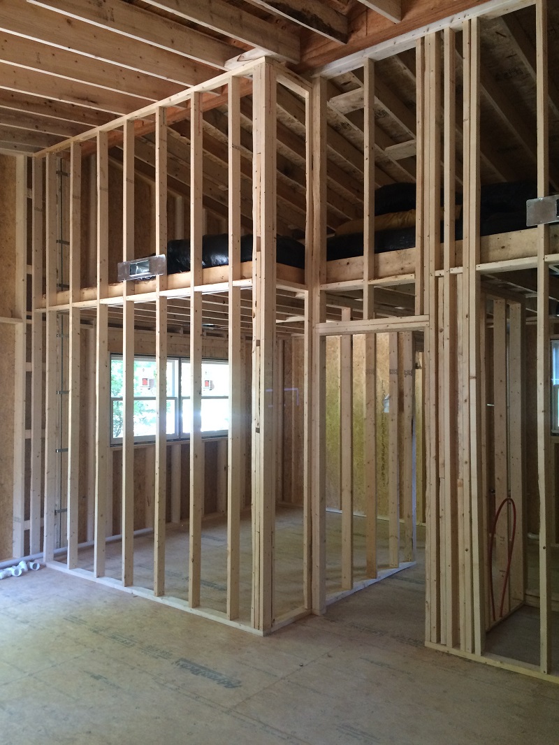

I highly recommend insulating outboard of that ductwork. You want to avoid putting the air handler and/or ductwork in a 130F attic.
:lol: Good for her. There's a lot of window in there, too.
If it weren't for IKEA, mine would easily fill 8'x8'
yup entire attic space will be insulated when done

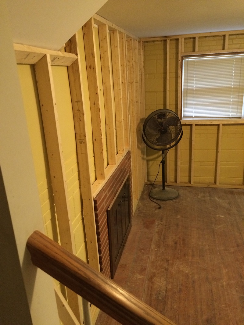

Oh yea, when you have a stud wall in front of block (like you have) you have to put the Styrofoam sheets in there against the block first. They made me do that. Sorry I'm late but at least I warned you before the initial call.
