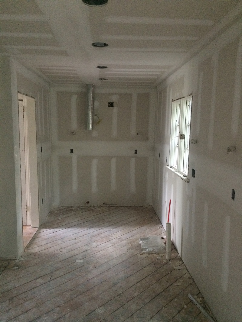

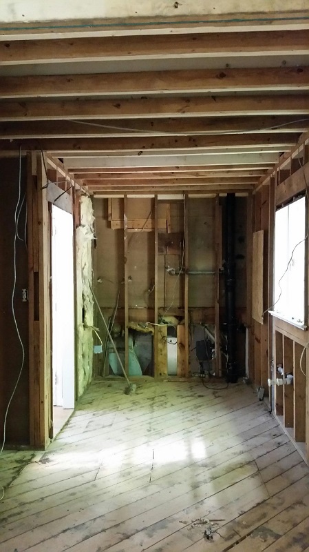

kitchen gutted

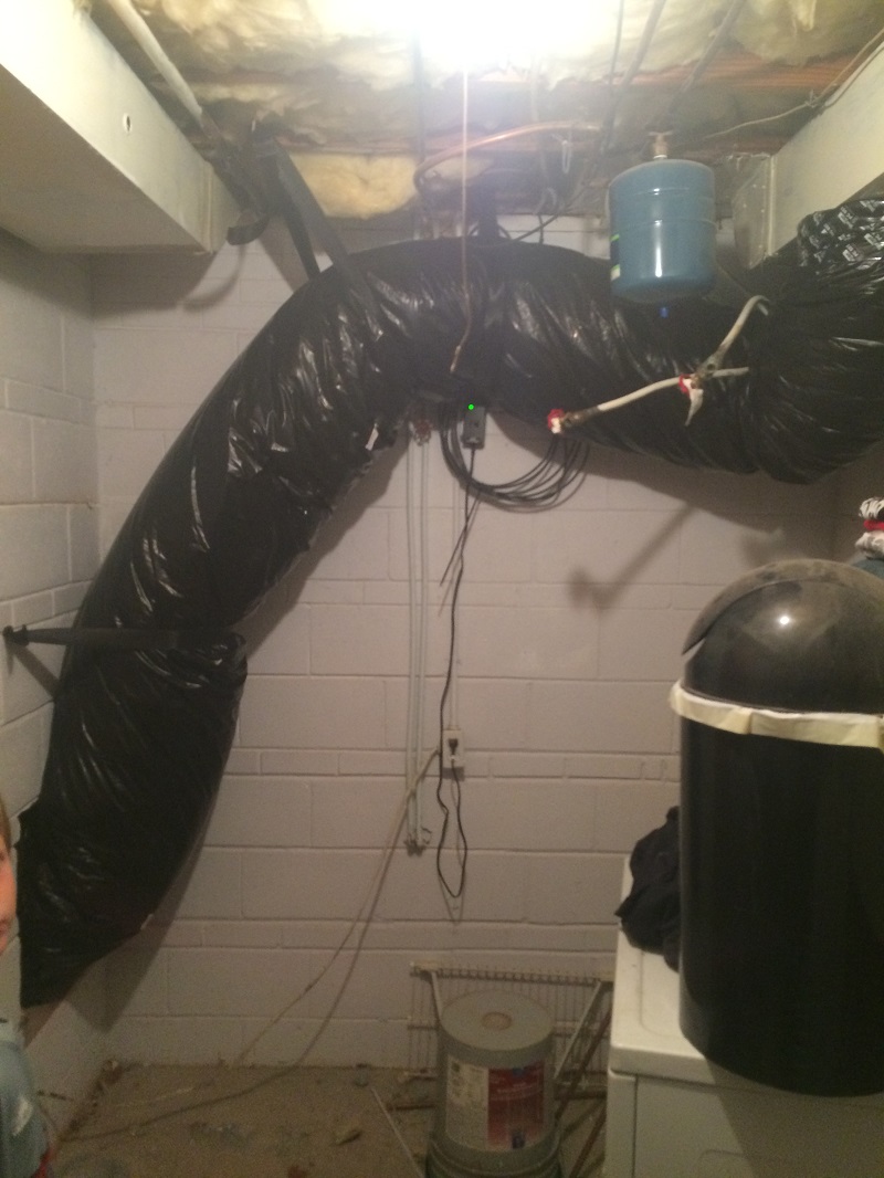

how not to run HVAC return line.. I had them rip that out and do it correctly in a better location ( no pic yet)

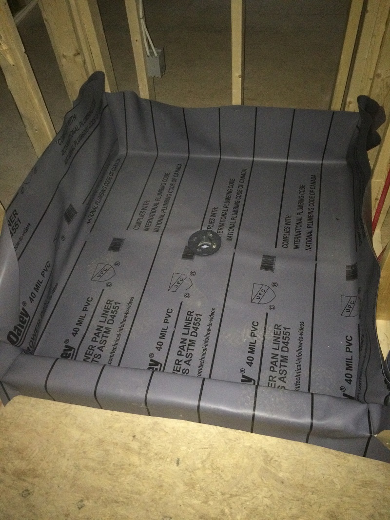

bath floor water testing to make sure it wont leak

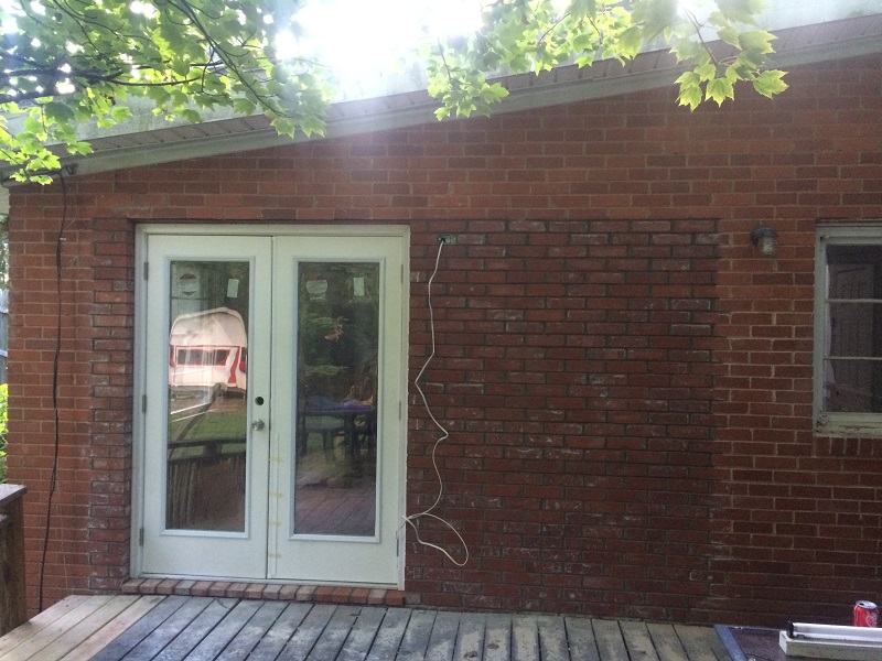

old walk in door gone and we will be putting up a peg board over it to use for tools etc

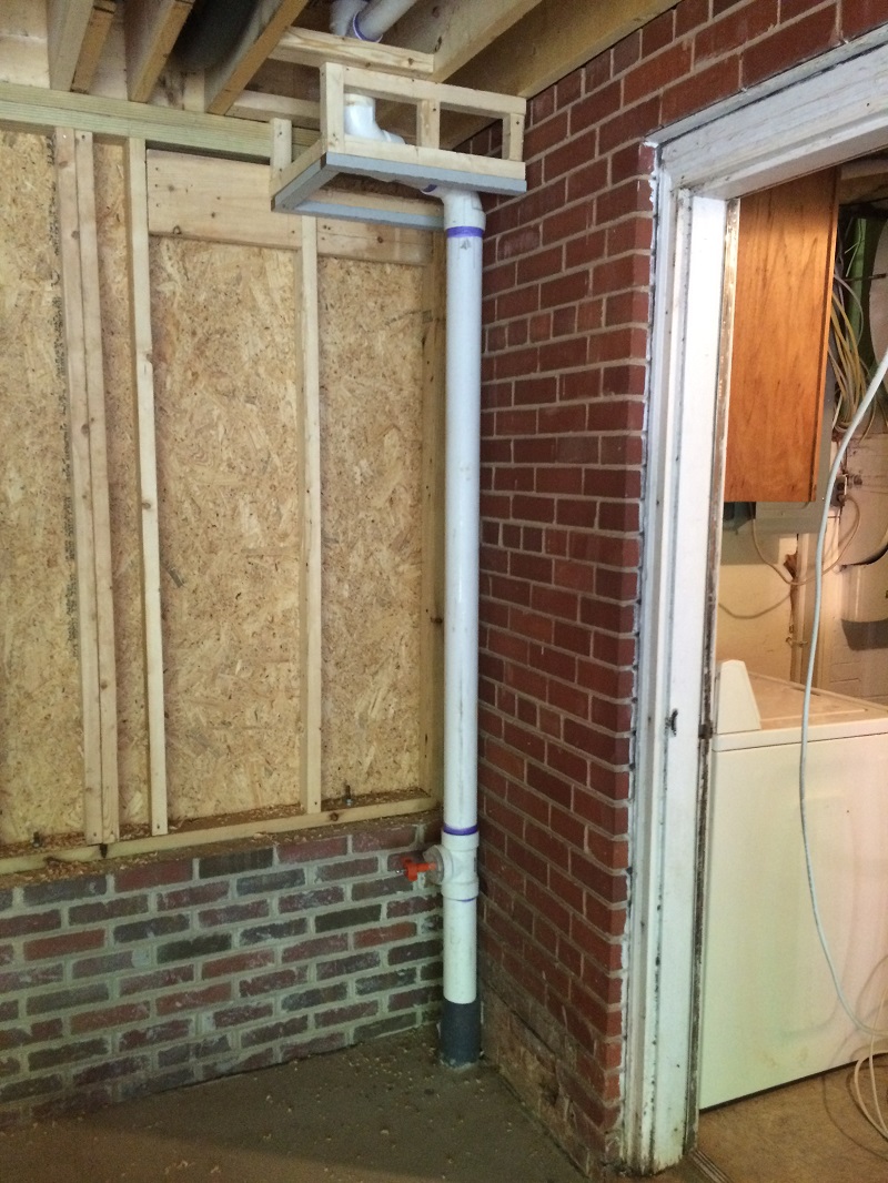

plumbing is all done

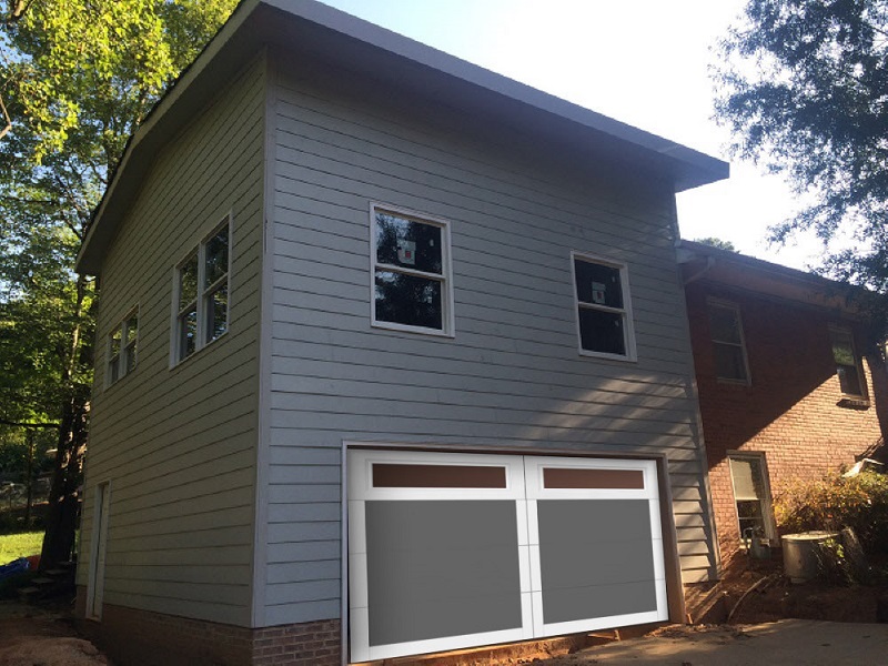

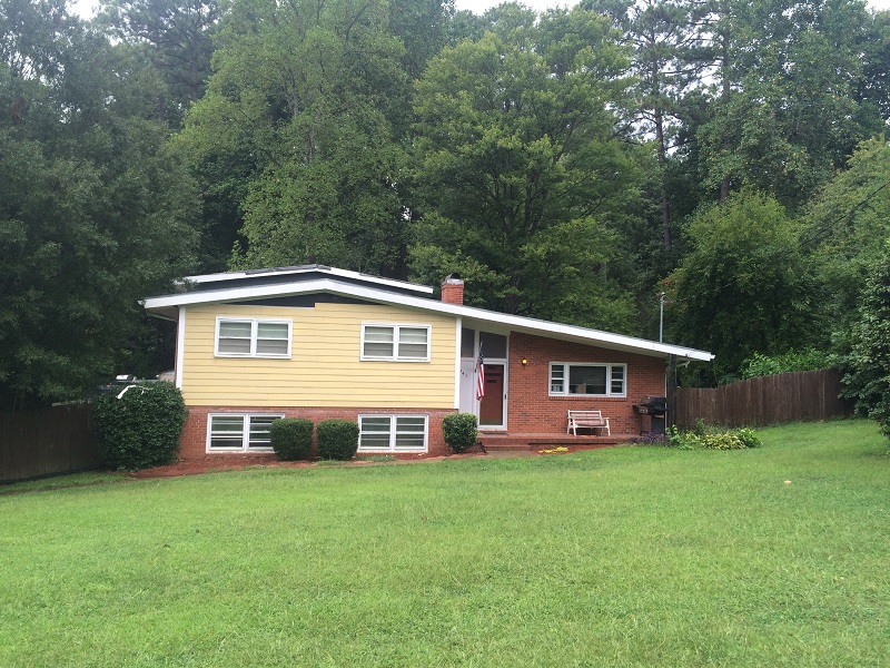

we picked the exterior paint color and painter came this weekend to get new addition painted
exterior all painted
and also a rendering with garage door on it

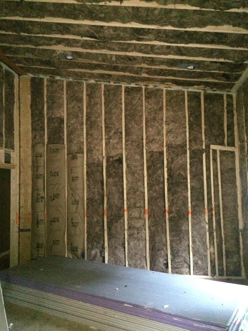

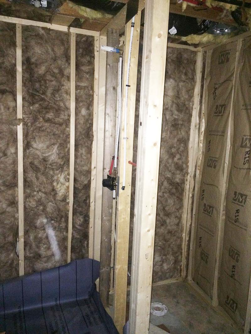

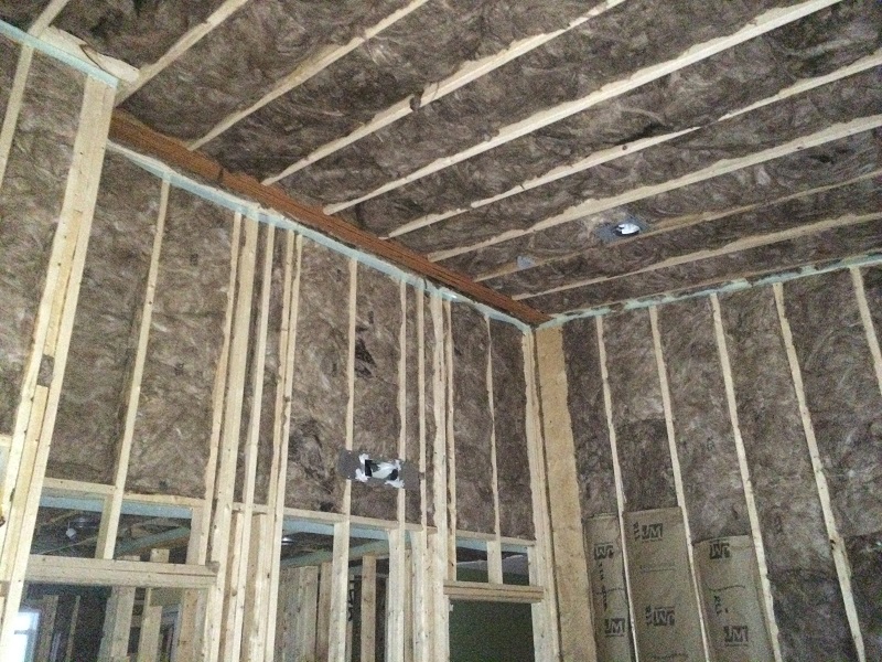

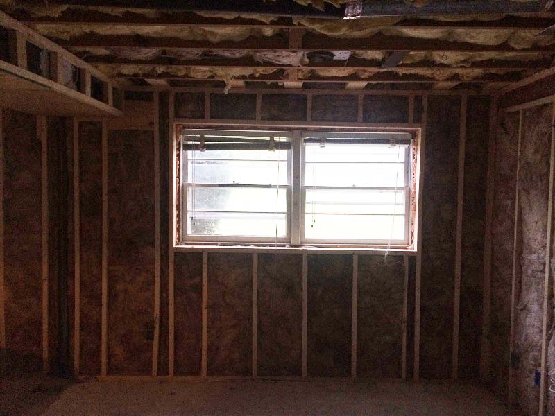

I've never heard of unfaced used in walls? Not that I don't believe for anything is possible I guess but how is that accomplished? Plus I may be wrong but I thought the moisture barrier was the importance of the insulation from an inspector's standpoint?
If the inspector tells you that you need a "moisture barrier", tell him he's not qualified to be doing his job. You want a vapor permeable air barrier installed on the outside of the wall. No facing on the interior of the wall.

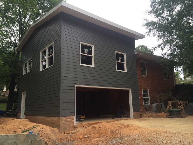

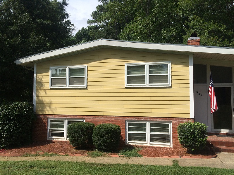

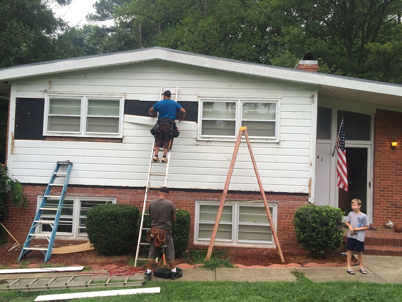

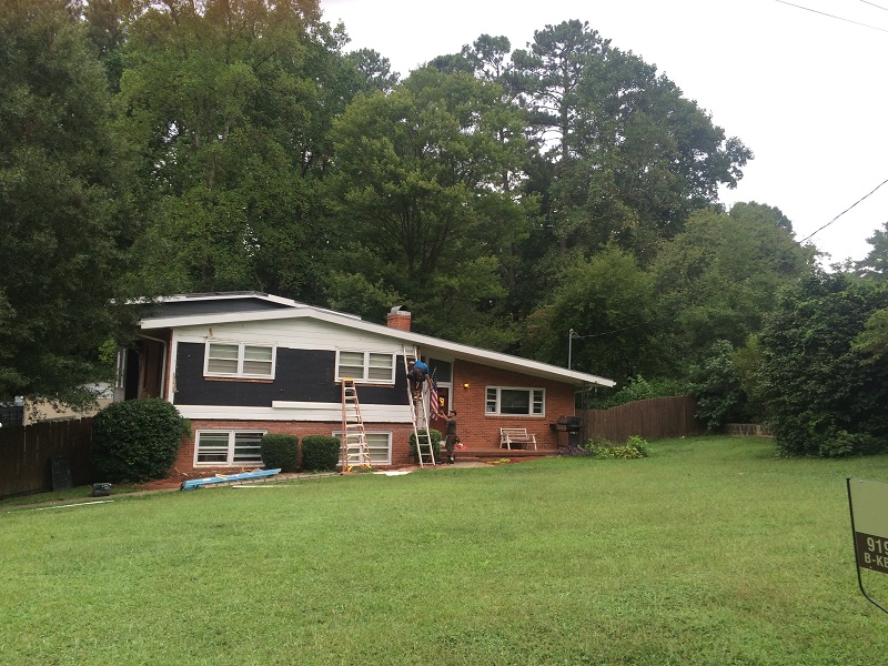

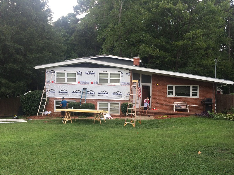

we removed the old vinyl siding from the front, then removed the old german wood panelling
little house wrap
and new hardi plank going up
and done

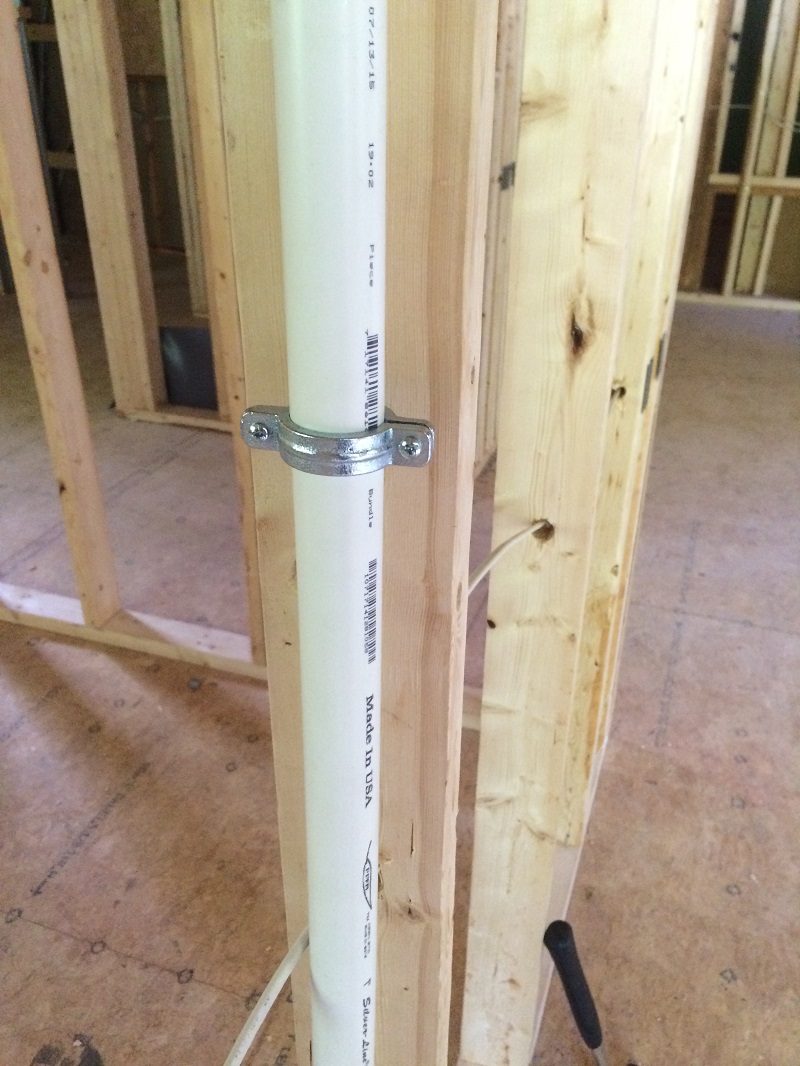

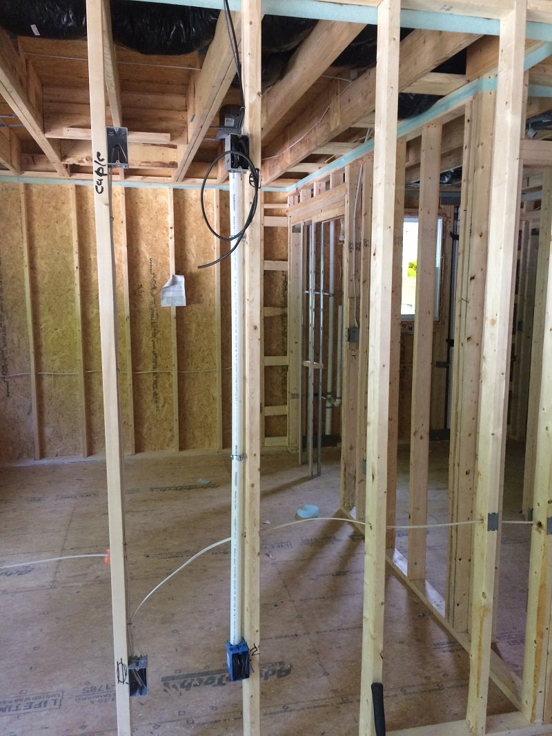

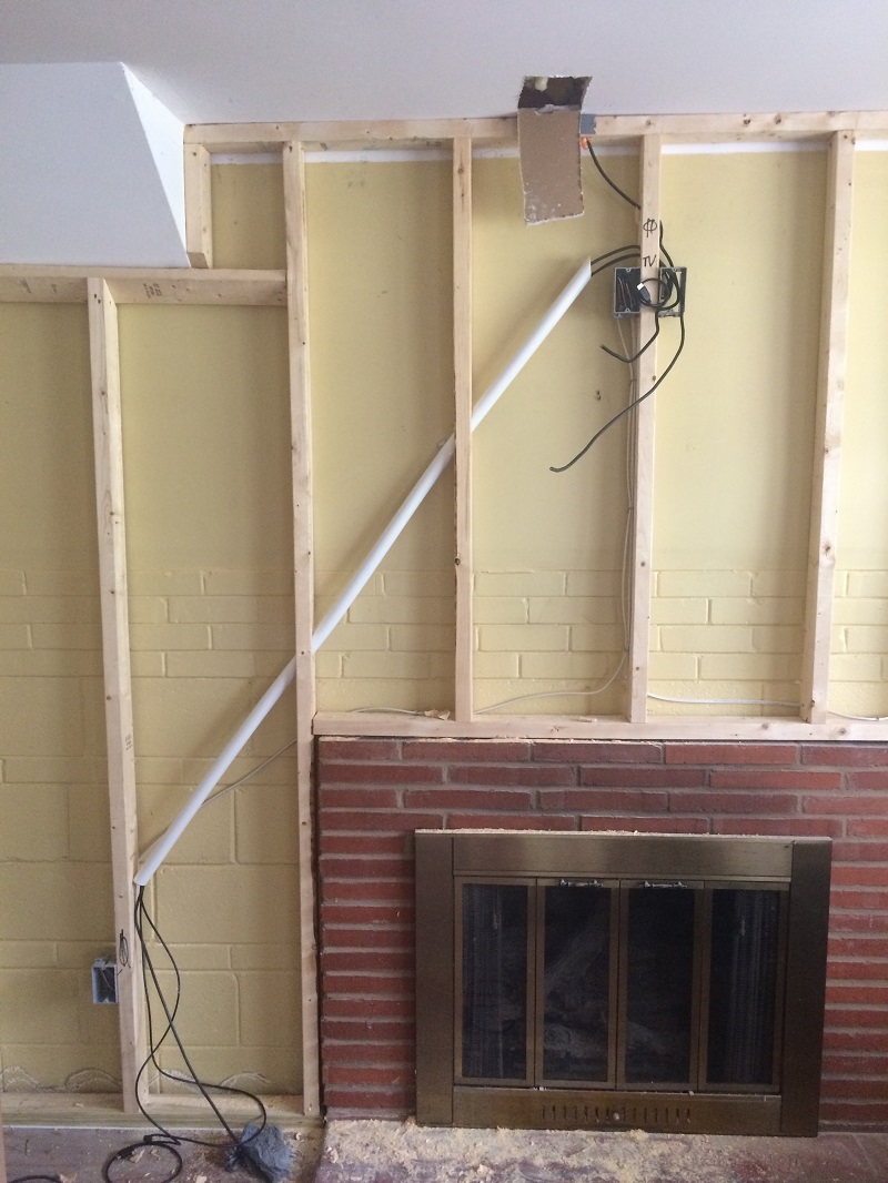

also ran all my low voltage wiring.

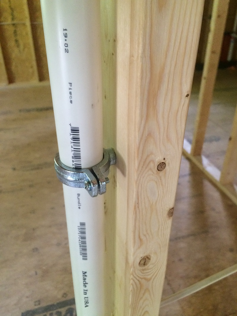

decided to use PVC and keep is simple

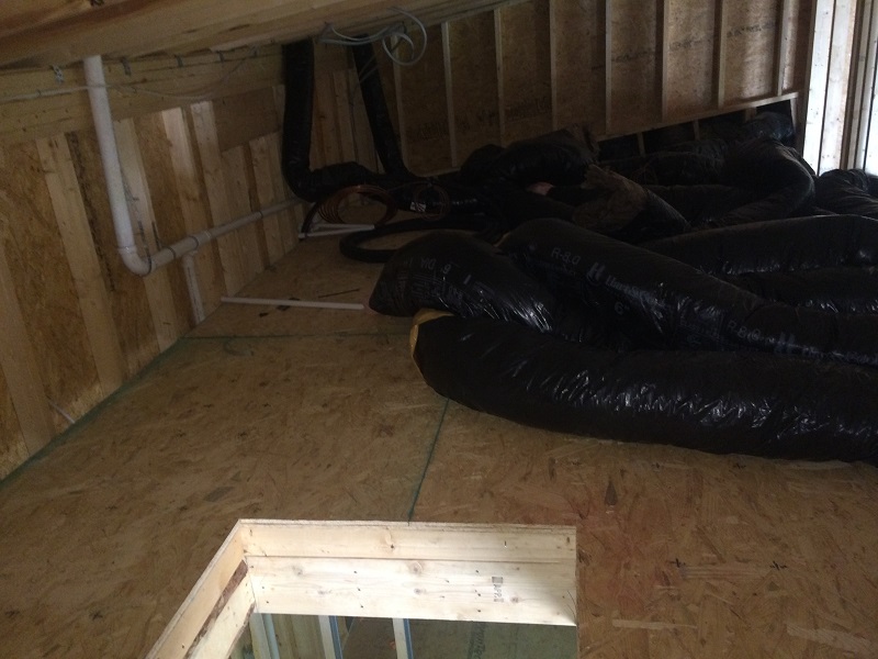

one pic of the attic space above new closet

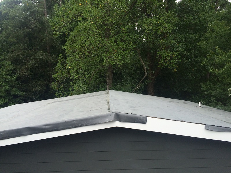

and lastly the roof guys showed up and are working on roof
Excuse my ignorance but what's the need for the pvc for the low voltage besides making it a very neat job? Never seen that before. Seems a tad overkill and additional expense? I bet fishing that pvc at that diagonal was a challenge.
Also, it seems the inspector would have had a hay day for pvc is usually associated with plumbing and could be mistaken later down the road and not recognized as electrical?
No need for it.. I just wanted an easy way to get the wiring from where DVD, and TV boxes will sit and where TV will hang. plus in 10 years from now when all the connectors change I wanted and easy way to pull new cables. I used PVC because it was cheap and I wanted the 1" size as as you never know what size cable end you want to feed threw it..
yes it took some thinking to get the diagonal pvc in place.
as for overkill well that is my middle name :) (reference other builds)
I passed all inspections so far and the next one is insulation so the chances the inspector will even see the pvc is slim to none. I did ask the electrician about my idea and he said no problem at all doing it that way..
I also ran Ethernet cable all over the house while the walls were open.. even ran it to the where the TV's hang so if I ever by a SmartTV I can hard wire it in

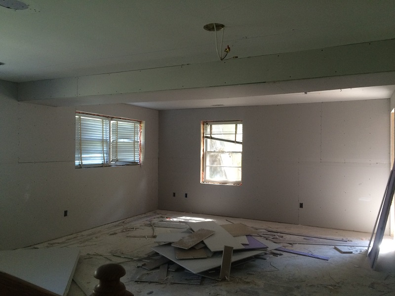

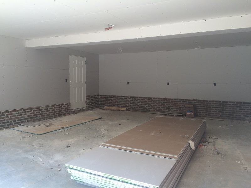

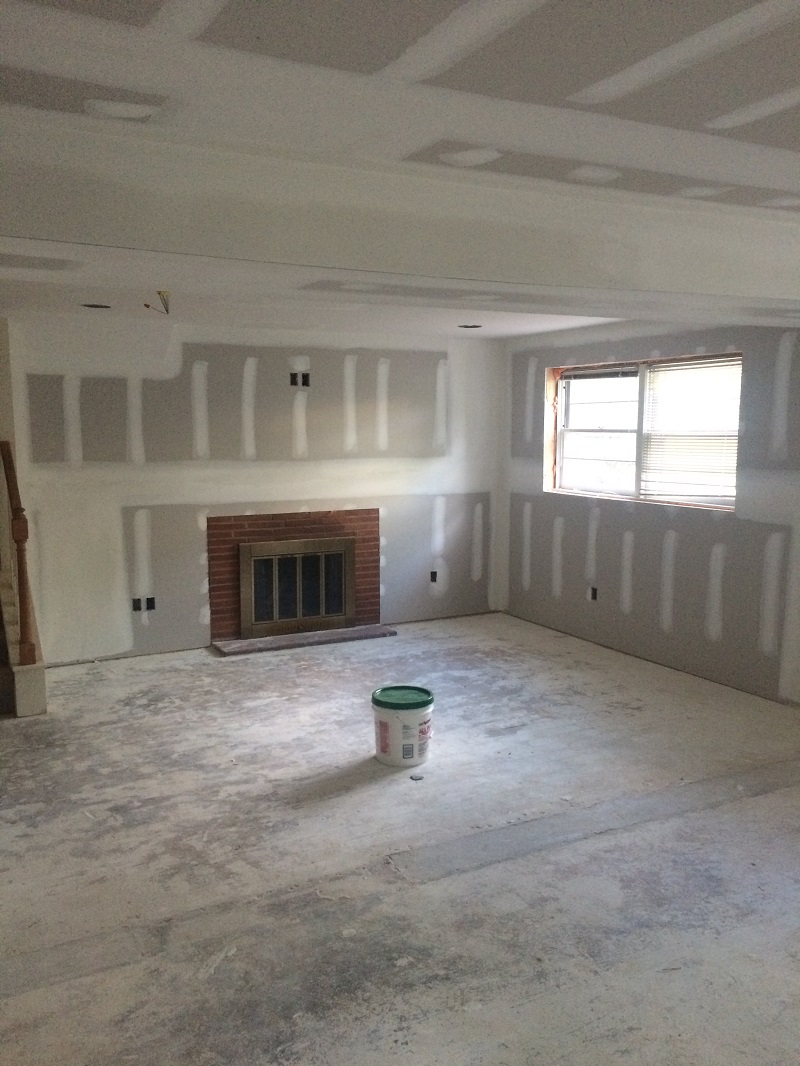

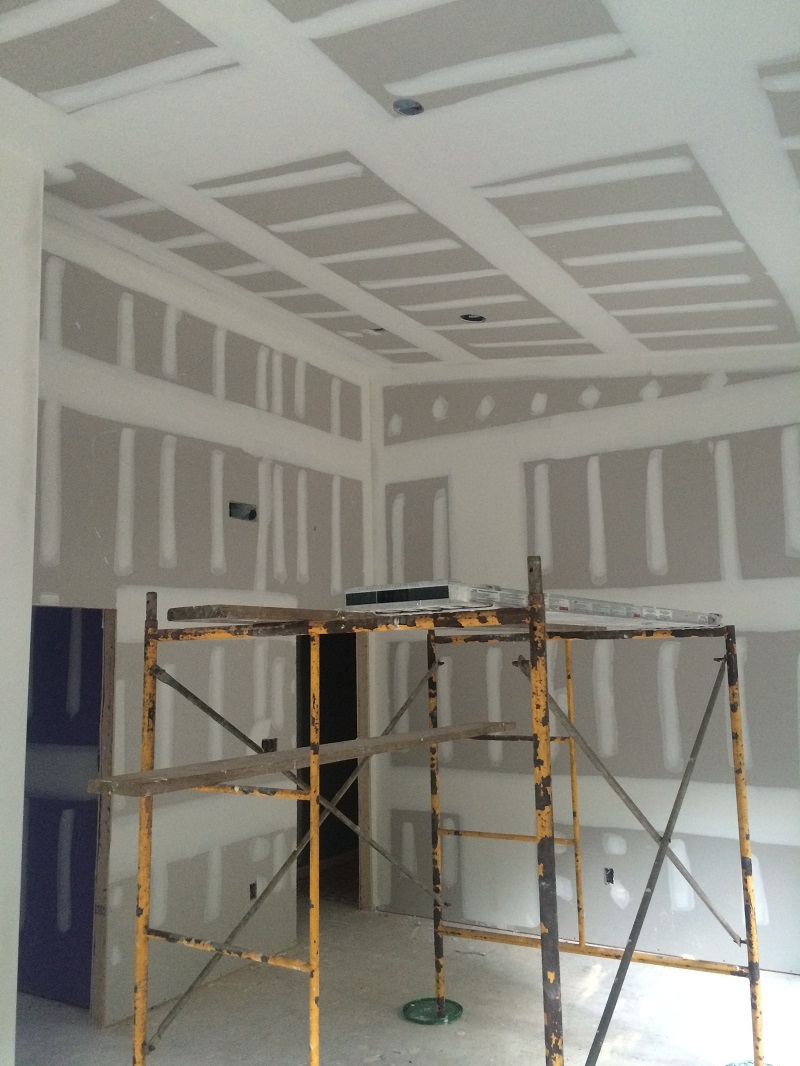

We are moving right along and passed our insulation inspection so next is sheet rock and then the tile guys start in bathrooms

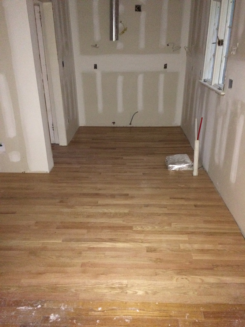

downstairs family room

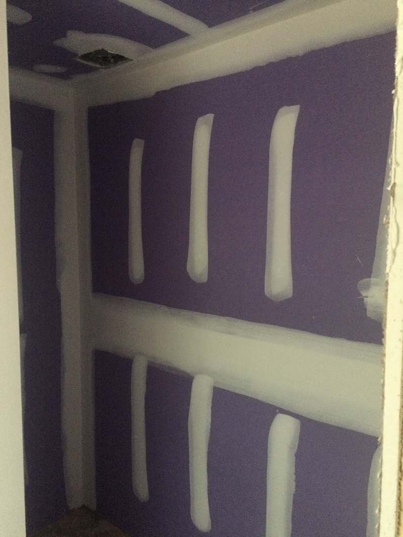

part of bathroom
new master

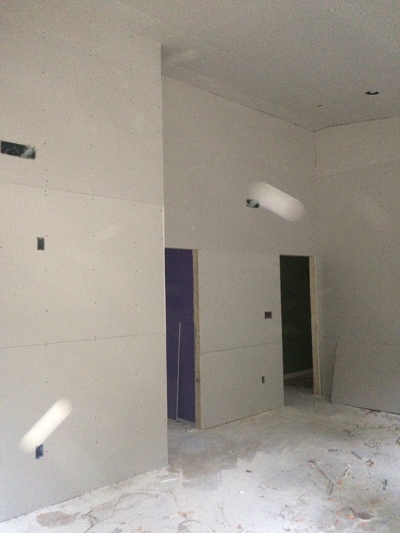

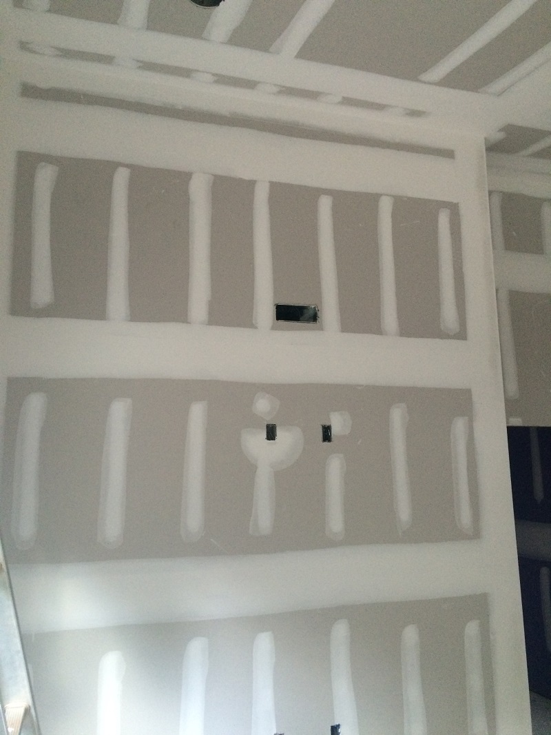

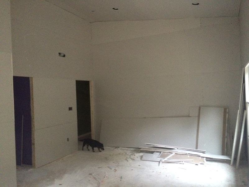

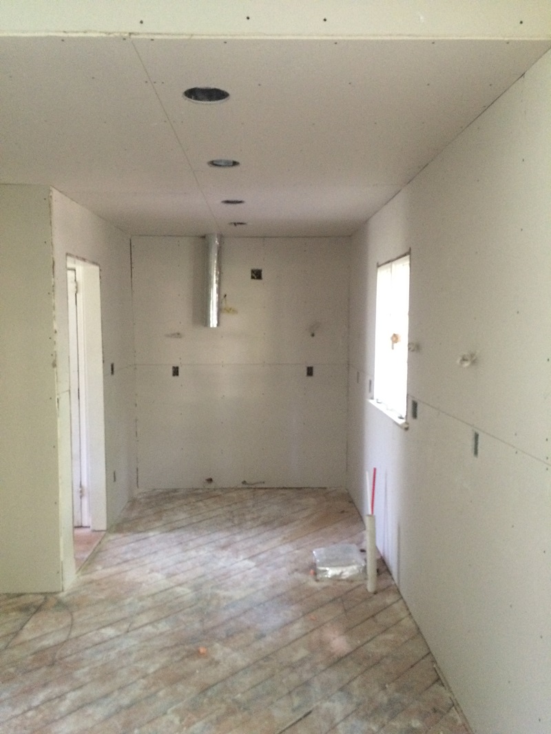

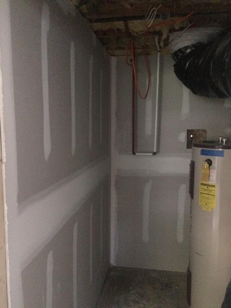

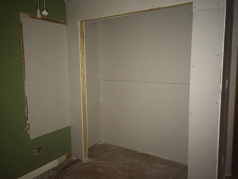

making progress.. guys hung sheet rock, taped and threw some mud..
they plan to be sanding Saturday.. which means everything will be covered in sheetrock dust :(

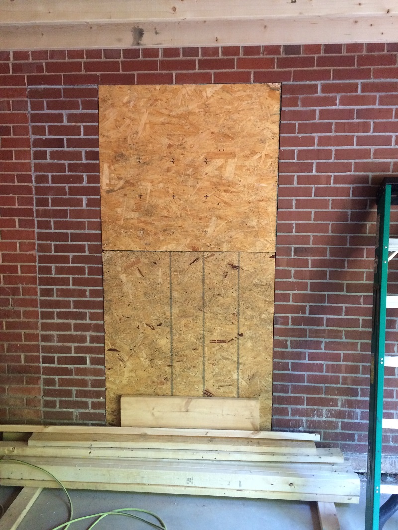

lastly the brick guys showed up and filled in where the old door was

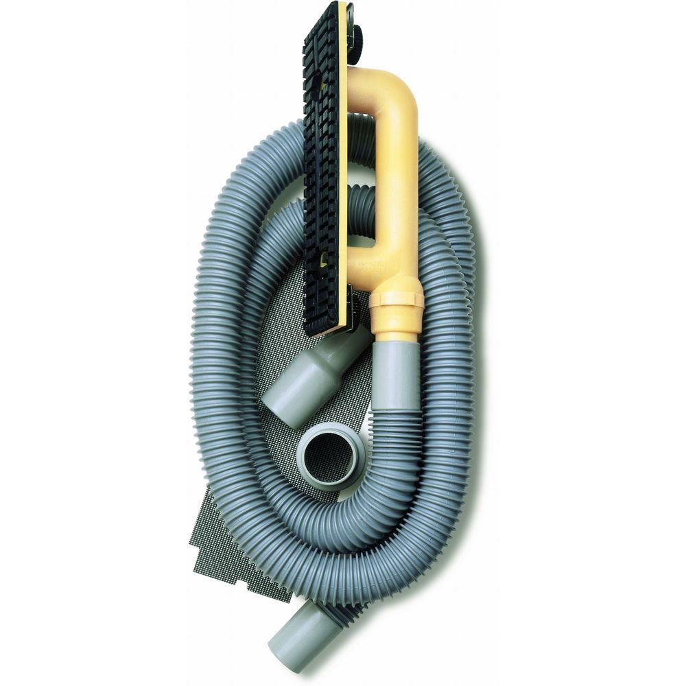

Get a sander with a shop vac attachment on it. You can get hand sanding blocks (for sandpaper or screen) with dust collection fittings as well if you're the hand sanding type of guy (I usually am, because I don't like to clog my Festool vac with drywall dust). Don't know if that's something that can be found locally, but I haven't looked so I don't know.
Nevermind, I didn't see that they were doing the sanding for you. Tell them to up their game and use some f'ing power tools with dust collection because it's 2015. There's no excuse for a professional drywall crew to fill the house with dust. Also tell them to use the ZipWall system.
Yep, you can find hand sanders with vac attachment locally:
Hyde Dust-Free Drywall Hand Sander Kit with 6-foot Hose-09165 - The Home Depot
awww.homedepot.com_catalog_productImages_1000_7a_7af8fef0_607e_49ad_8b53_9a37875e21cc_1000.jpg
Now I need to go buy one of those. Like, today.. so I can finish my guest bedroom this weekend. I don't know why I haven't bought one of those yet...
Good sheetrock mudders don't sand...:flipoff2:
I was taught to take your time and smooth it as good as you can the first go round. Then immediately use a wet solid sponge and bucket of water. It's faster considering the mess and your buggers remain green.
ya it was weird.. the dude that was mudding mon, tues and wed was AWESOME it looked so clean and smooth i thought this will be great no sanding :)
then two different dude came Thursday and laid that shit on thick as hell.. I have no idea why the guys changed or what the plan is but we will how the end product is.
Regardless, I think they covered everything extremely well. Cutouts look good and tight. As long as you are paying by the job and not hourly I would not be disappointed.
