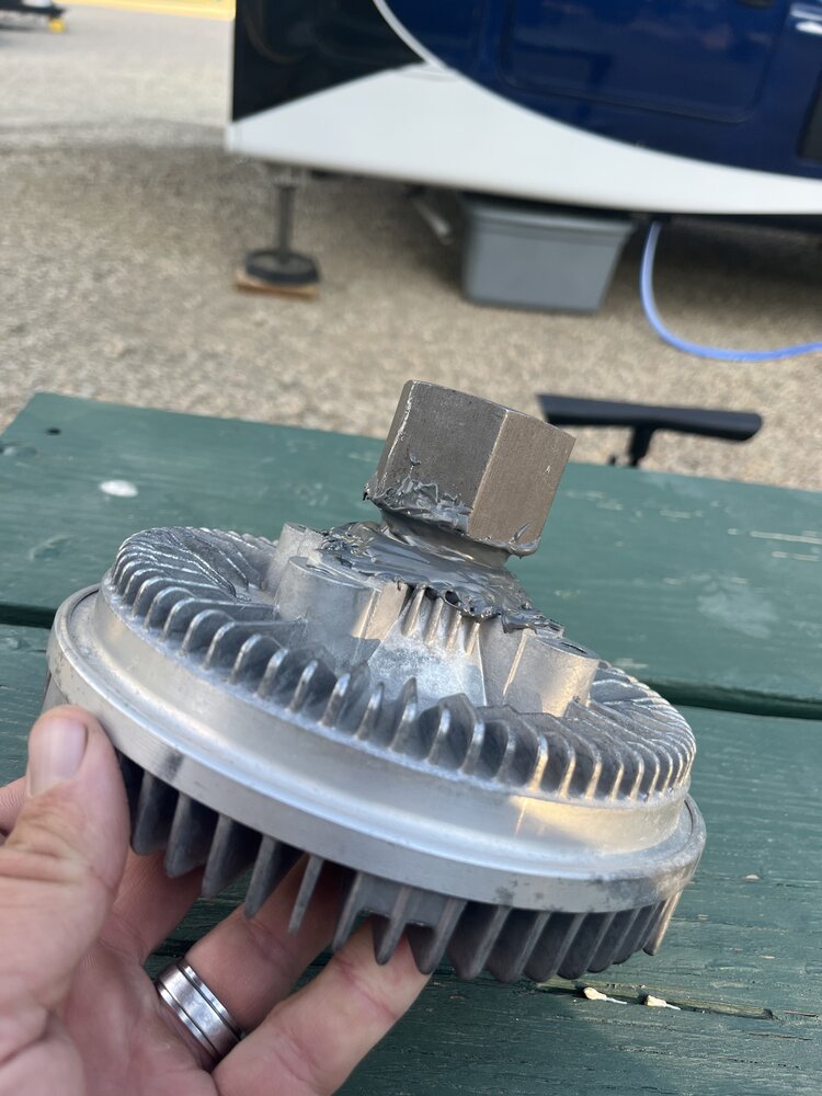

I still have the the one I took off, and plan top JB weld that thing to just be a fixed hub so the fan will be on all the time. I am tempted to have the water pump replaced, but I know it won't be cheap, and I'm bouncing around every 2 weeks again. that water pump in theory should only have 40k on it.

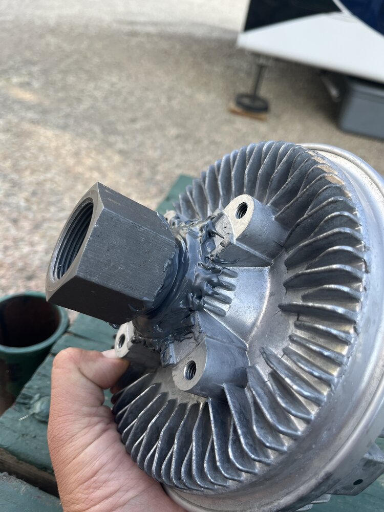

However we discussed the fan clutch fiasco and he said with the massive drop in quality over the last couple years that it wouldn't surprise him and could be possible to have bad luck so many times in a row. With the current clutch actually dropping the temp once engaged around 230* when climbing, that kinda shows that it all works as it should when the fan is on. So I will be installing the Talton Special FFH (Fixed Fan Hub). All fab work done in house, by me. One off custom.
So if this makes the thing run way cooler, I am going to buy an OEM clutch, the AC Delco one and try that. If it still gets hot with this, then I have a bad water pump or a blown head gasket.
The shop I spoke to couldn't even take in any work till the 24th, so it wasn't really an option. But they were nice enough to spend about 30 minutes brainstorming with me. We agreed the "fixed" fan hub should let me know which direction to go.

Is there any concern for the TSFFH being out of balance and inducing vibration into the rotating assembly?
It's mounted on a center hub. It'd have to be wayyy off balance to hurt anything, especially the actual rotating assembly.
People never worry about the china special fan blades 16" out.. I think there is a far lower concern of some epoxy around the hub throwing it off
Point conceded fine sir.
Rock on
