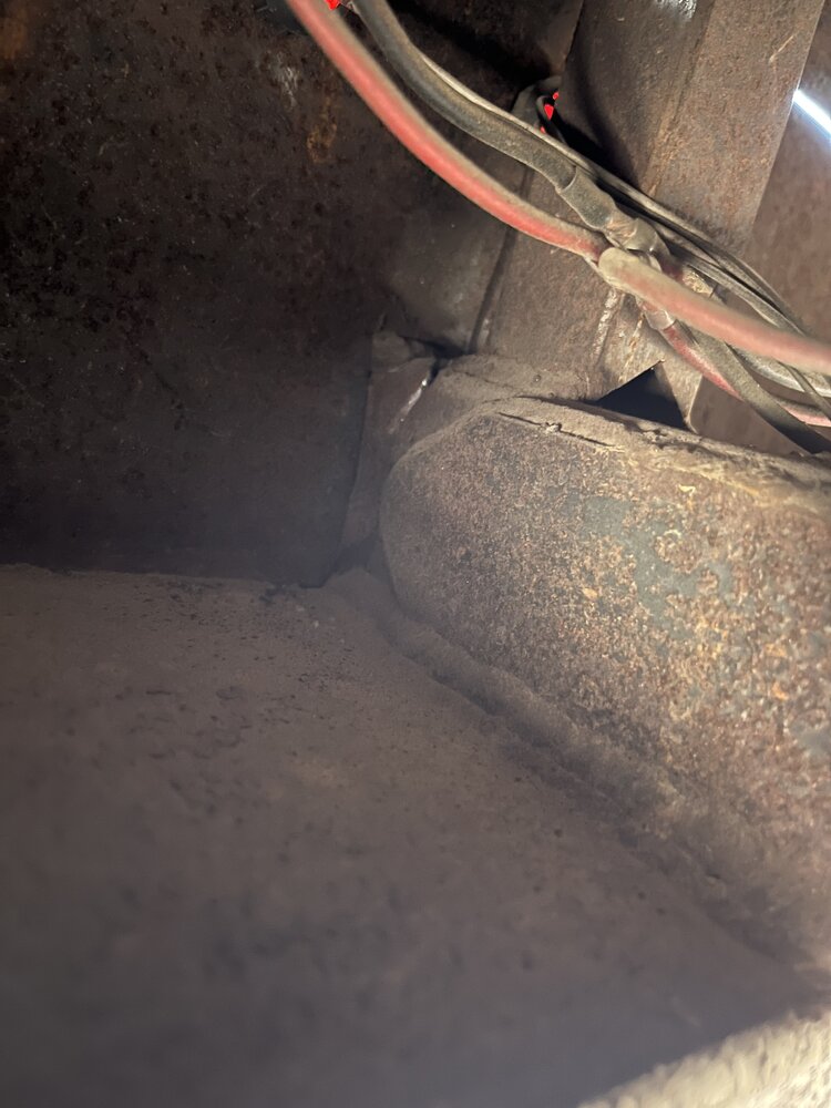

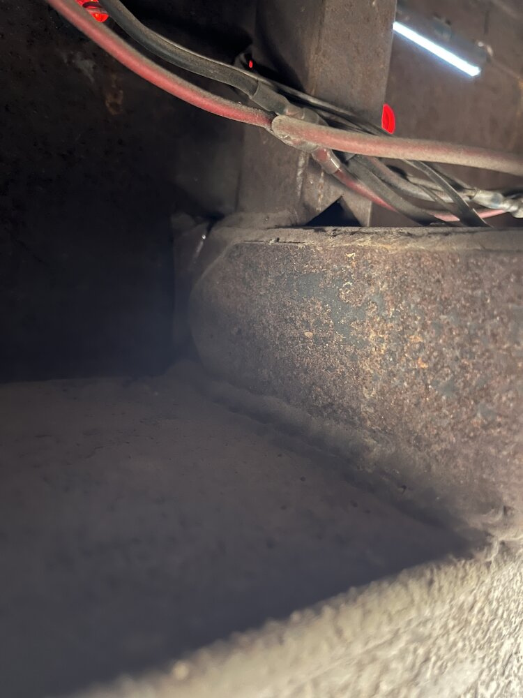

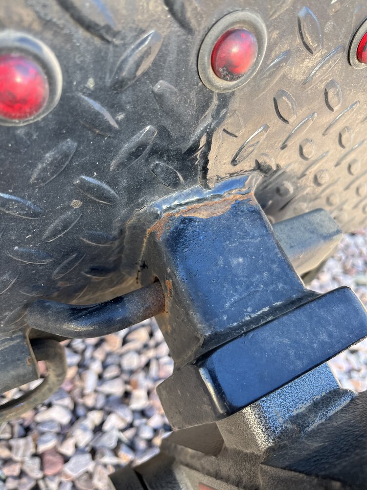

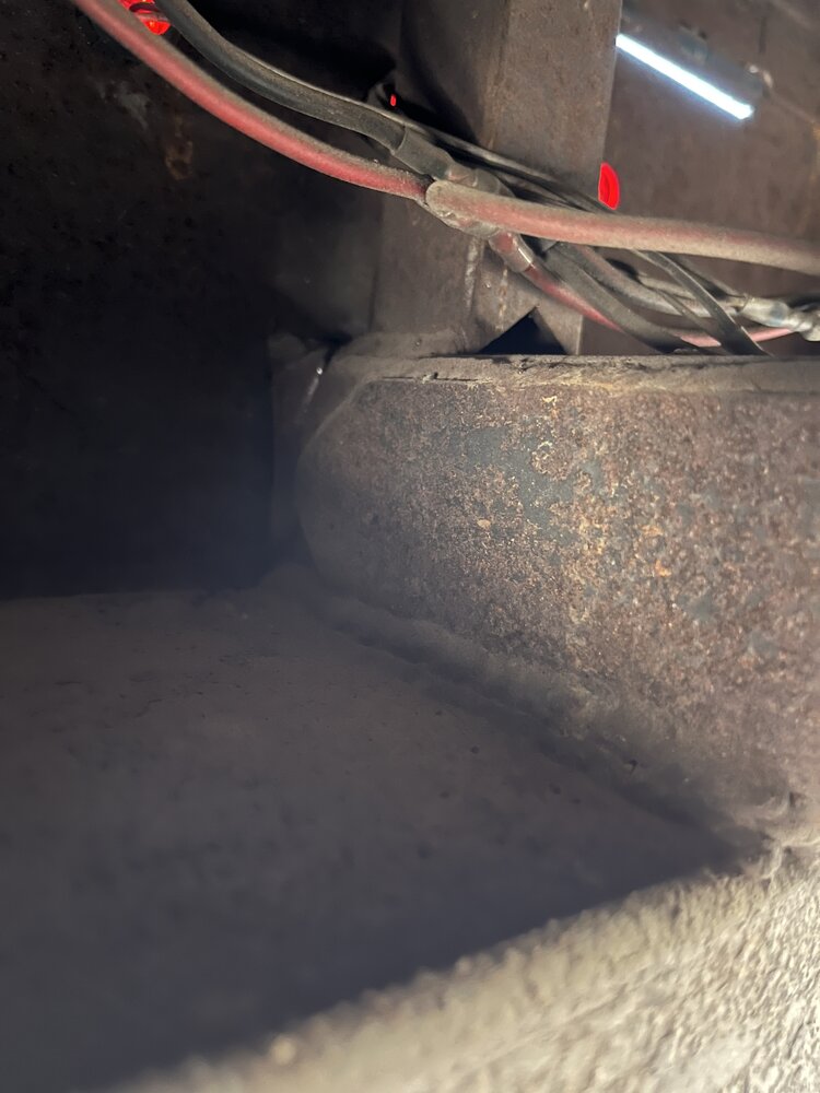

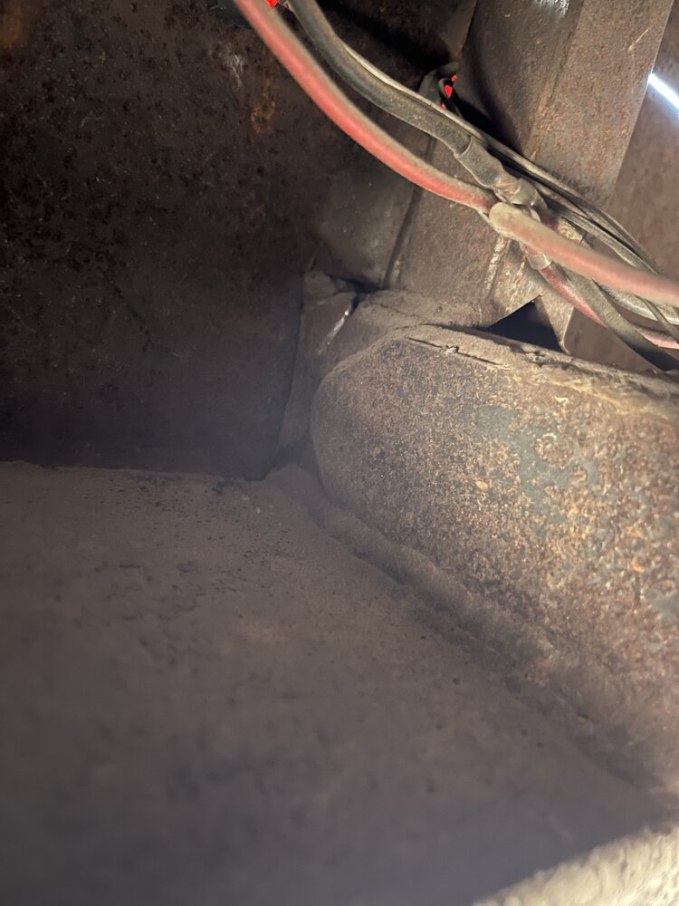

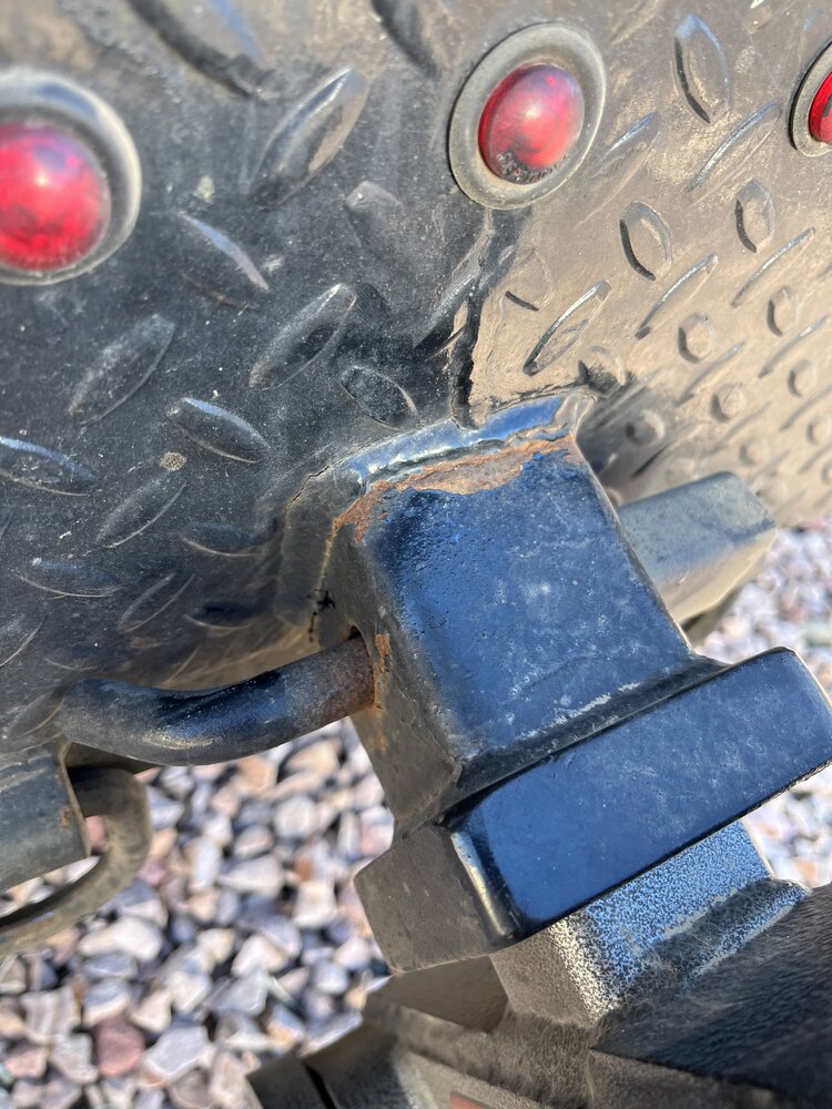

Also, had quite the close call in AZ. I almost lost the camper. The hitch had been down a little bit for a while, but it was braced really well and I was certain it was just that the mouth of the receiver had opened up a little. Well, when I got to Chino Valley after leaving Table Mesa I noticed it was wayyyy down. The camper was very low. After unhooking the camper I got my head up in there and noticed it was cracked. The diamond plate on the back was about all that was holding it on.
Bronson, from Wrecked Gear, had invited me to stay at their house for a week and that’s where I was when we noticed this. He made a call Monday morning and Southwest Krawlers in Chino Valley slid me right in for the emergency repair. They cut out the old hitch completely, and redid everything. It’s very beefy now with plenty of bracing. I am doing a video on this soon.

Holy chit! Was the crack fairly fresh any rust in it? I didn't see that at all. I was worried about the paint telling of a crack out side.
No rust. It was slowly forming and I'm certain it got worse on Hwy 17 coming out of Flagstaff, AZ. That was by far the worst road I have driven in all of my travels, ever. I'd rather driver my truck empty down a dirt road to i95 south all day than spend 1 hour on that road again.
They guys that fixed it said it was a poor design, and where it cracked had really high heat concentration in that area with no gussets or bracing to help it out.

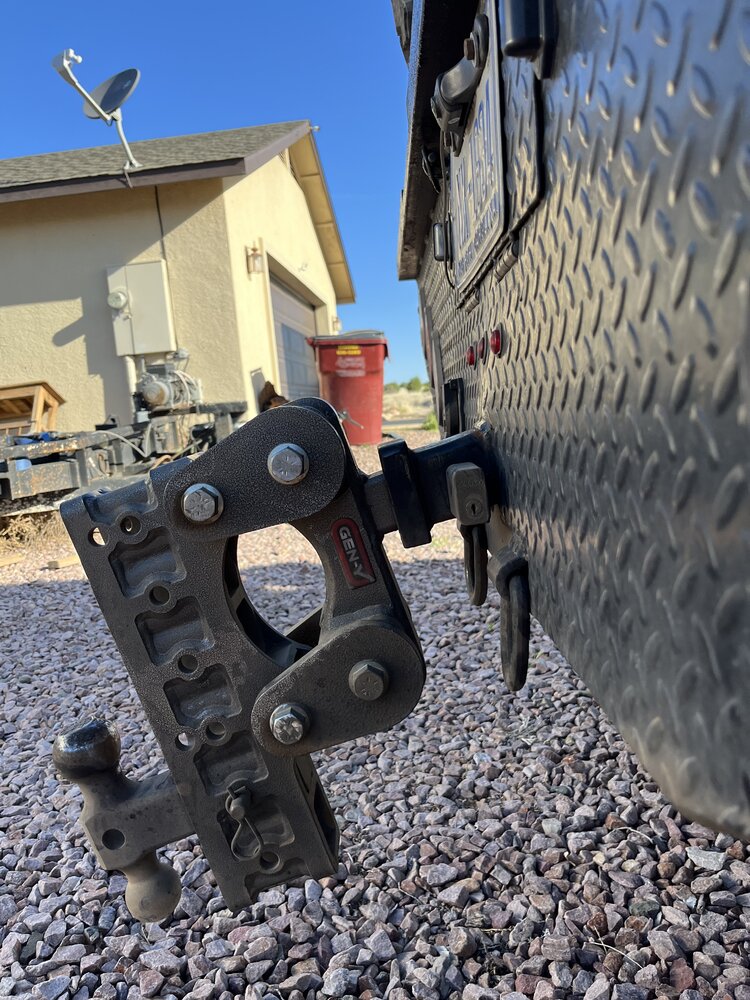

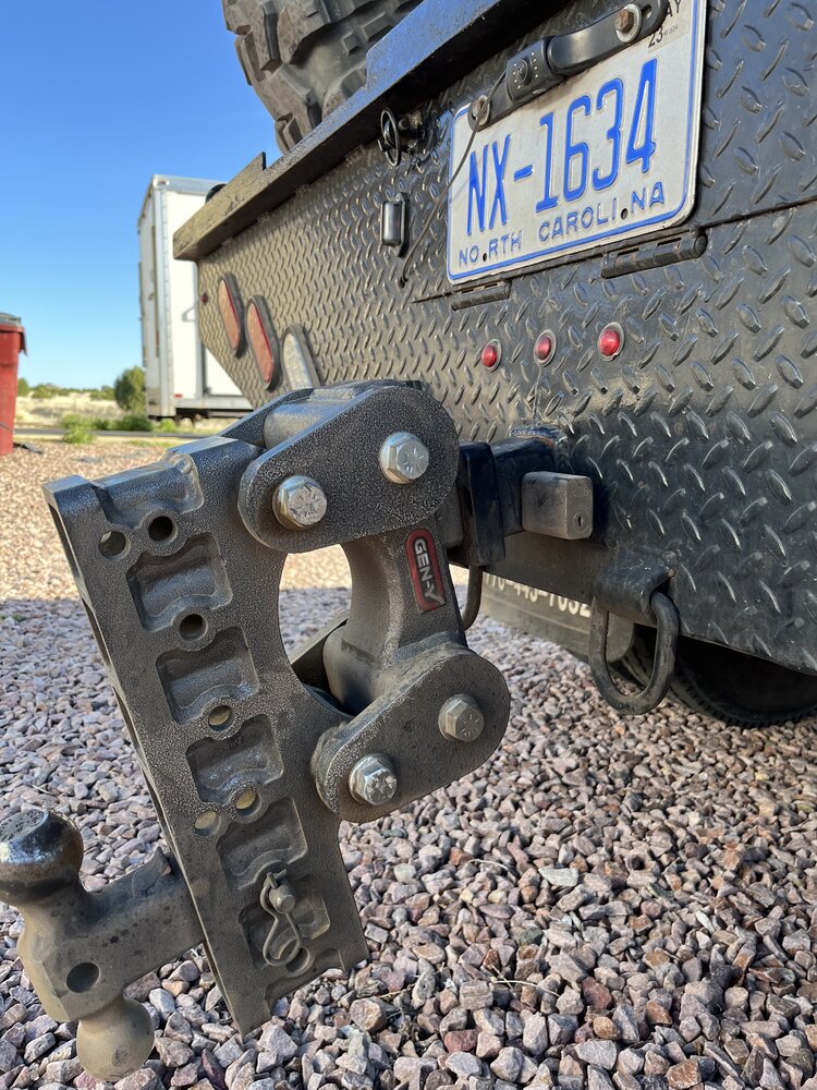

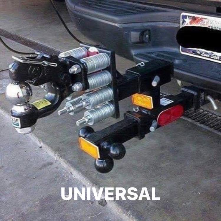

The extension of the drop hitch is more detrimental than the fabrication of the mount. You've got what looks to be about 15-16" of stickout from the bed, and the shank on the hitch is not long enough to engage the braced material that was there, so it bent the 2" tube and then ripped away from the bed and bracing. If you could get a hitch that didn't hang out so far, it would help the reworked receiver last longer.
I wasn't gonna rub any salt and ask him if he got a load assisting hitch or equalizer bars yet.......buttttttttt me thinks not.
Hey dude @77GreenMachine you get one of em hitches yet?? 😂 Keep at it feller you got more desire to chase that dream then 9/10 the population!
Yeah @WARRIORWELDING mentioned how that would help, and I did find a setup that works with this hitch. However as you can see, I procrastinated... I need the offset of this hitch, it allows me to turn all the way without damaging the camper, and that's imperative to maneuvering this setup lol. I will probably order the setup while here in UT.
As stupid as these braces on these lifted truck hitches may look, they do a fantastic job of decreasing load on the receiver.

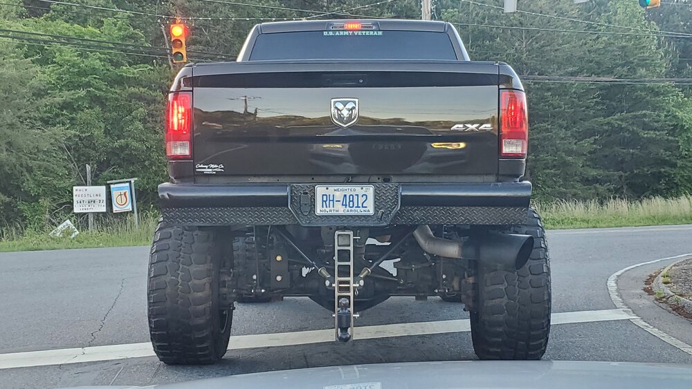

(Took this pic earlier in the week to post in the douchemobile thread, haha)
I've found it's oftentimes the military dudes driving these douchemobiles around. Guy I coach w/ talked about putting 42s on his DD the other day. Not sure I could've given him a more confused look on my face.
