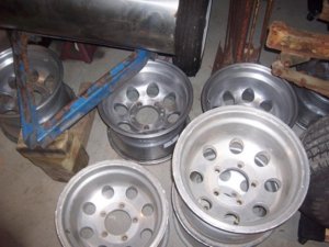

1st: I took off the steel beadlocks and I am going to run aluminum rims with Inner Air Locks to save some weight.
since I could not make up my mind on rims I now have 8 Aluminum rims :)

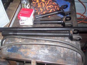

I also got a set of Chromo Shafts from ECGS I originally went with just stock u joints but I have no convinced myself that I should just pony up and get some good ones.. So I guess I need to call ECGS again :)

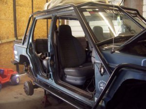

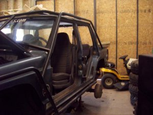

here is how it sits now :)

steel beadlock wheels with bolts weight = 57lbs each
alum rim plus Inner Air lock = 24lbs each
that is a 33lb per corner weight saving, total = 132lbs :)
plus I am switching out spare tire with steel rim to alum rim so about another 20lbs savings..
well 152lbs is better then none :)
Did some more weight measurements and this is what I took of so far
(2)64lb - front doors
(2)48lb - rear doors
45lb - rear hatch
so these total = 269 lbs of Jeep
plus 152lbs of rims I did also
So I am down 421lbs.. my original goal was 1500lb loss but the more i weight things I am now aiming for 1000lbs.

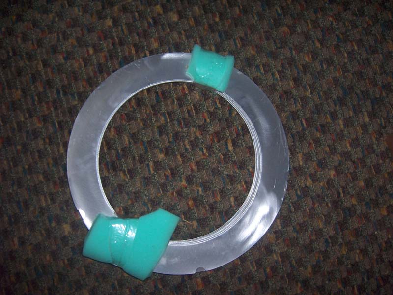

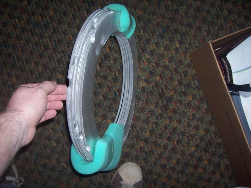

got a little package today:
Thanks to Shawn @ innerairlock for making my alum rock rings
total weight of 5 rings is 10lbs
