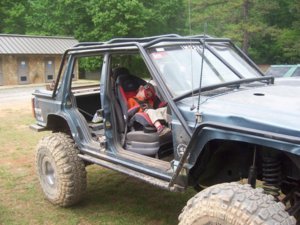

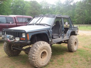

Chop top XJ..with Exo cage... End to an Era..
Well all 4 tires are now double beadlocked..

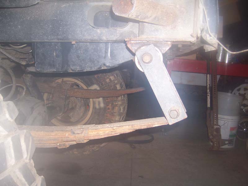

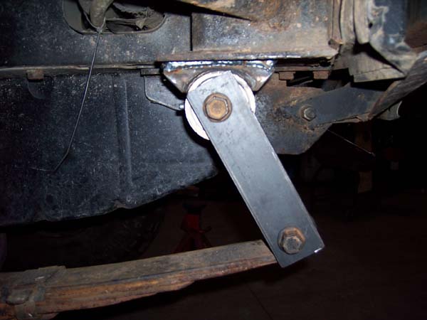

hope to have ball joints and tie rod ends done this weekend and then put it all back together for next weekends URE ride..

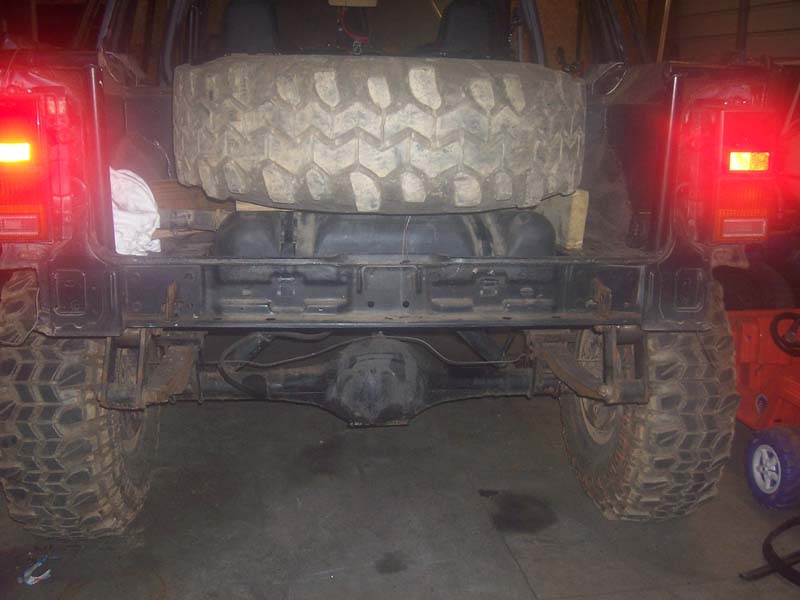

Got rear tires on
found what the noise was last time at the flats :) oops

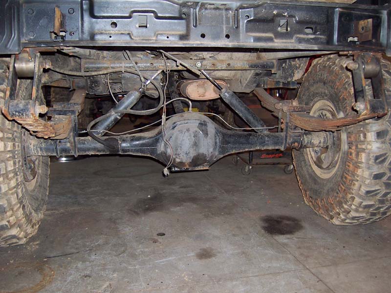

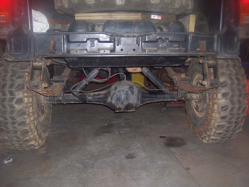

I also took out air bags so my son can ride in front seat with me.
I also added a cool little item into place where air bad was.. now I can see my rear axle with out getting out of jeep :
Ok the cam/screen is pretty awesome... then again so is the whole jeep...
Nice looking XJ! I just started building on with a full cage and softtop. bet you dont hear that to often with an XJ. How hard was it to do your exo cage?
i really wanna do that to my x cause of rolling it because i think it would look really cool liek that
it was not that bad but I did have a bunch of cage experience before we did mine
Are you going to do anything to protect that camera? It looks too exposed.
it is about 3" back from the edge of the skid plate.. totally protected.

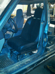

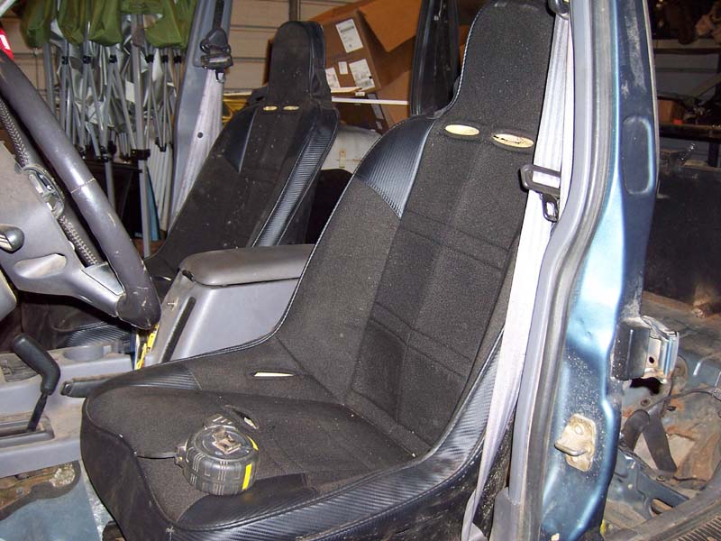

Here is what I got done last night.. more to come over next few weeks
did a little more work..

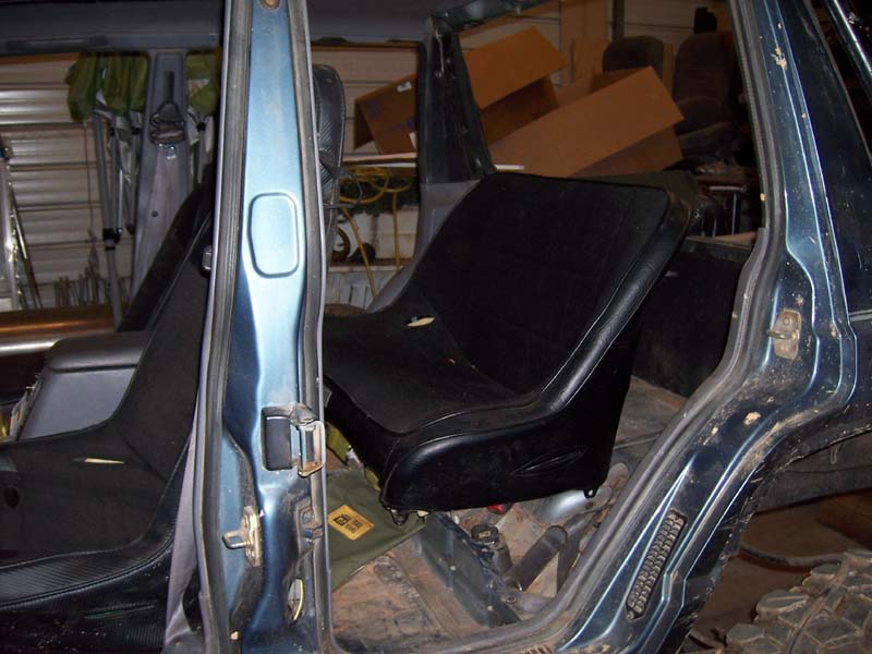

added passenger seat

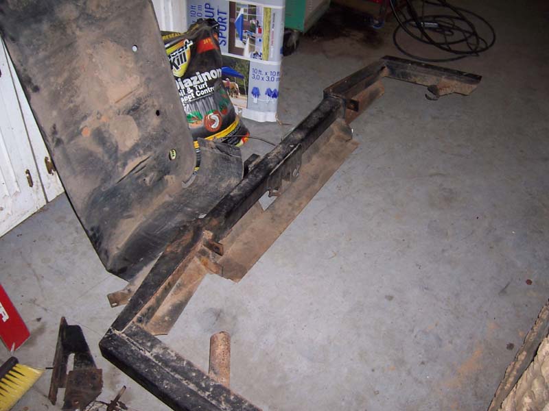

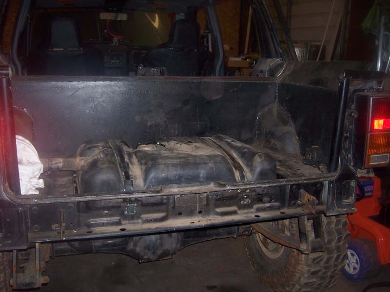

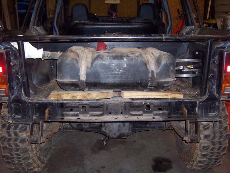

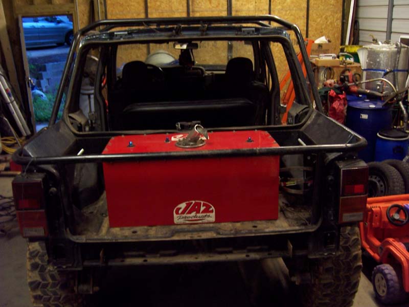

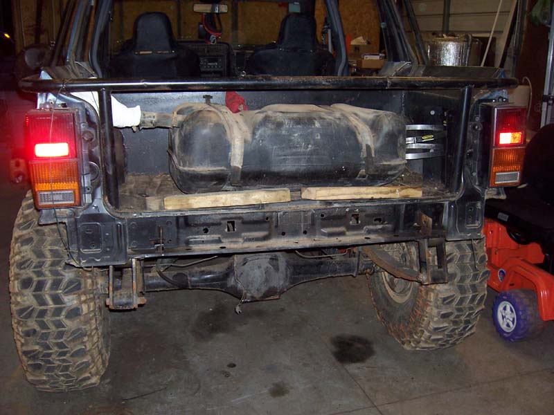

took off rear bumper and gas tank skid plate
pic showing rear with no tank
temp location of gas tank
and put rear seat to see how it looks with front seats in

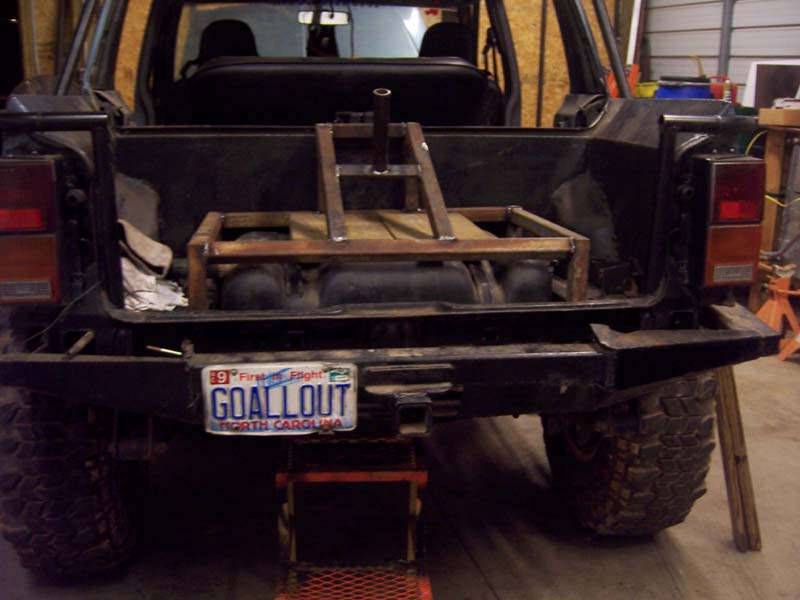

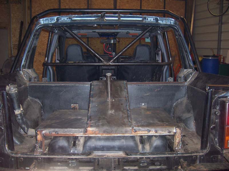

well after pricing out the fittings for the fuel cell I decide for the time being to just modify the stock tank location and gain some clearance.
I cut the floor so the skid plate would drop down in between the frame rails. then place skid plate in place welded it in, dropped tank into skid plate and used stock hold downs just on top of the tank instead of on the bottom.. I gained almost 5" of clearance.

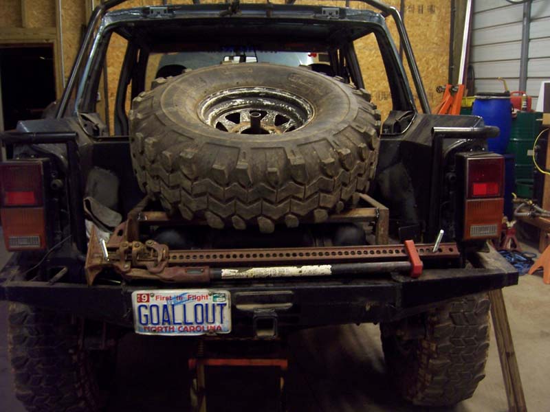

more progress

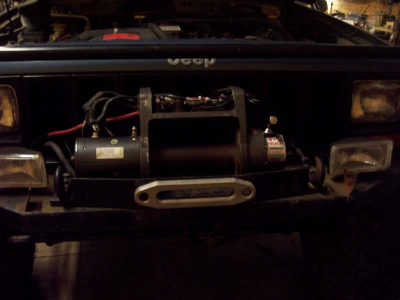

upgraded the winch and I am going to wire in cab controls

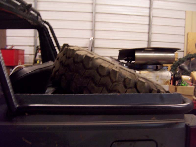

gas tank cover and spare tire mount
with tire and high lift in new location

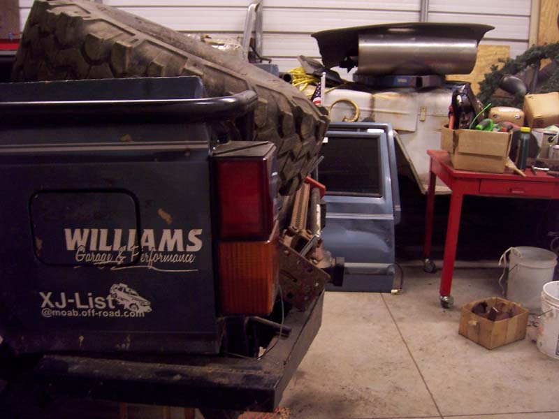

rear bumper still furthest point back
and I still have visibilty out the rear over tire

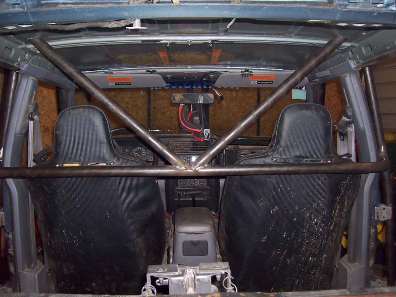

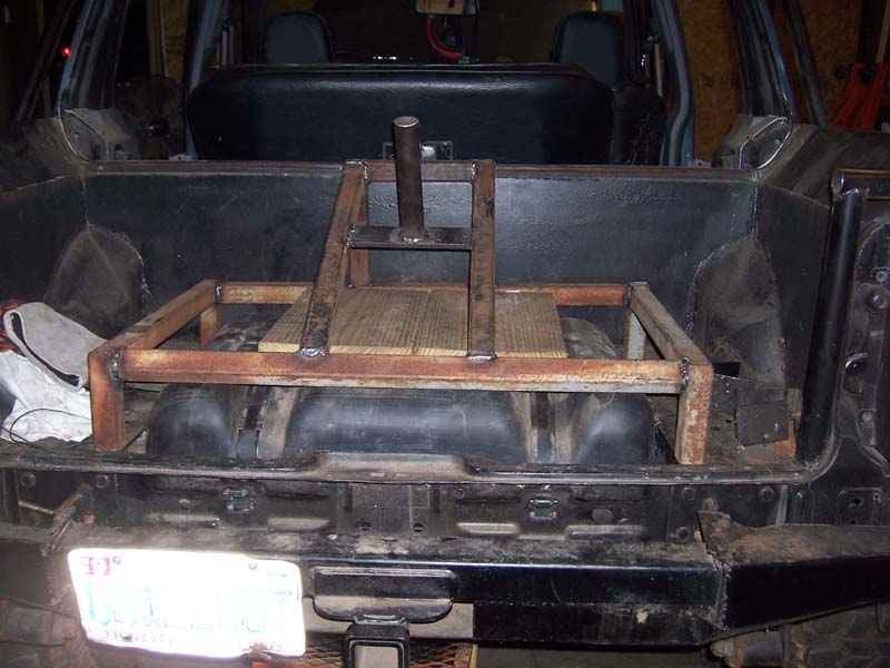

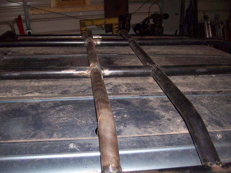

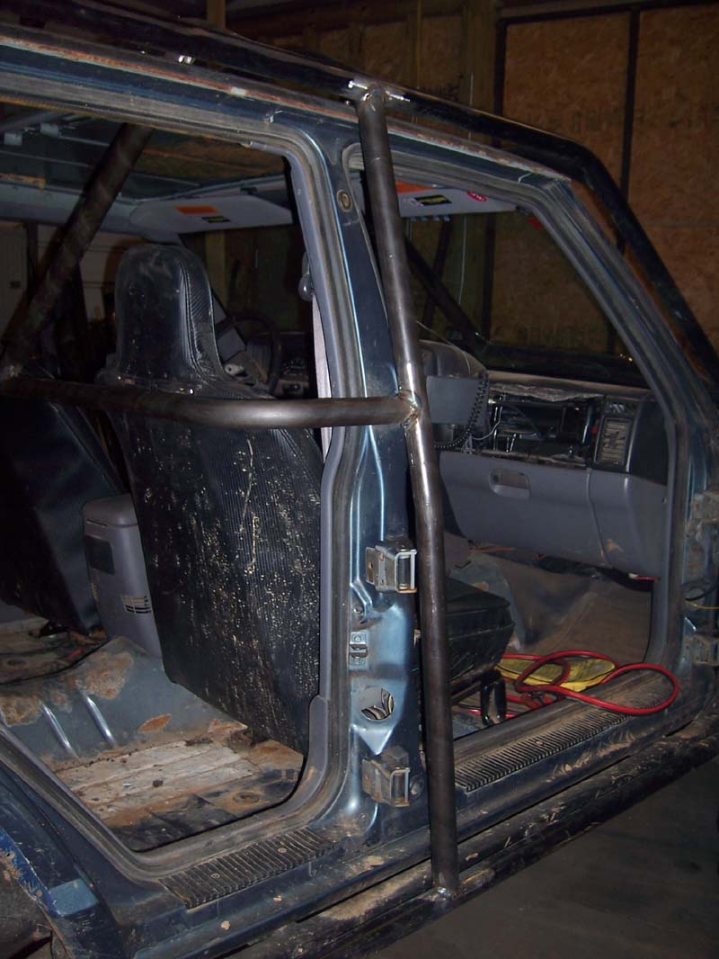

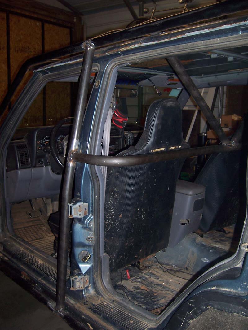

got a little more done today

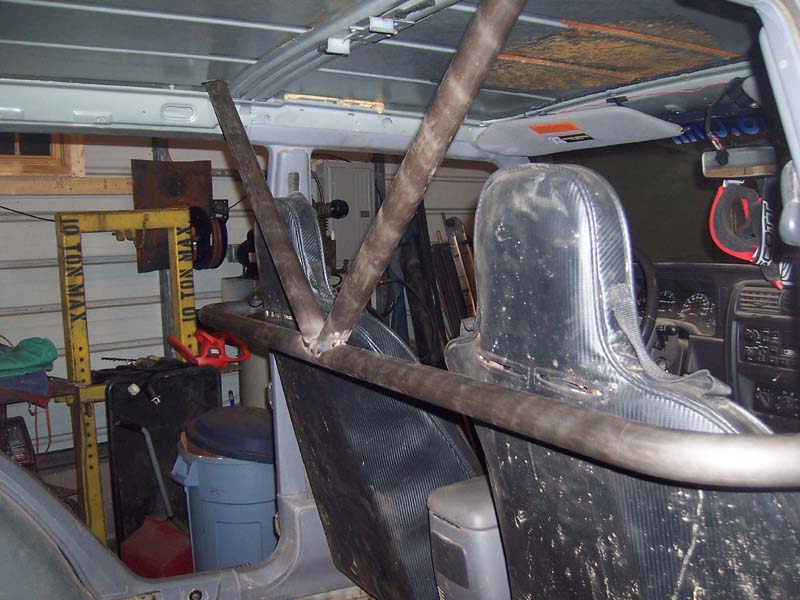

added a second roof bar so I could tie in X support bars
added B pillar bars
also added bar for harness and to tie B pillars together

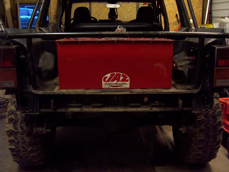

covered fuel tank/spare tire frame
looking in thru back
