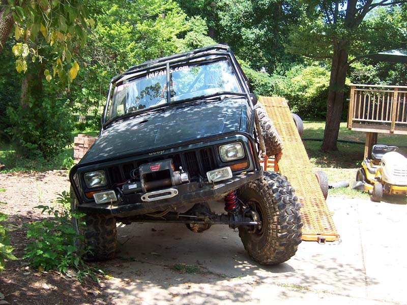

no pics, but we got the winch wired to inside the cab and it works :) did a tune up, plugs, wires, dist cap, etc.. made some bump stop steel stops.. gonna flex it out tomorow in rti ramp to see what is correct size shocks I need to order.

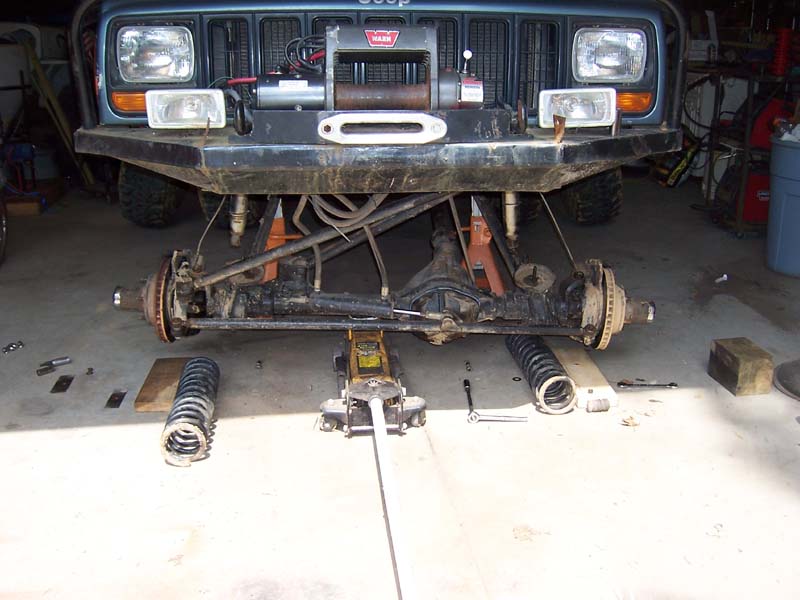

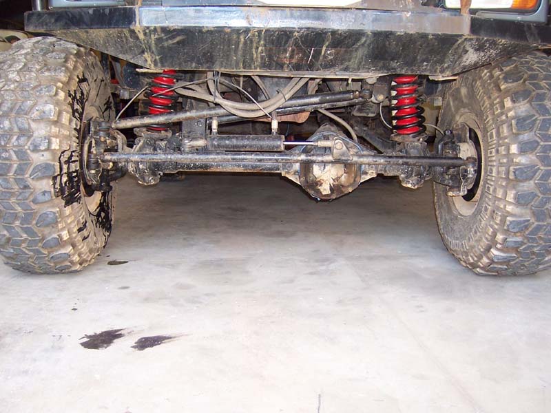

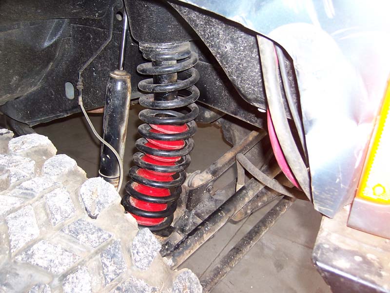

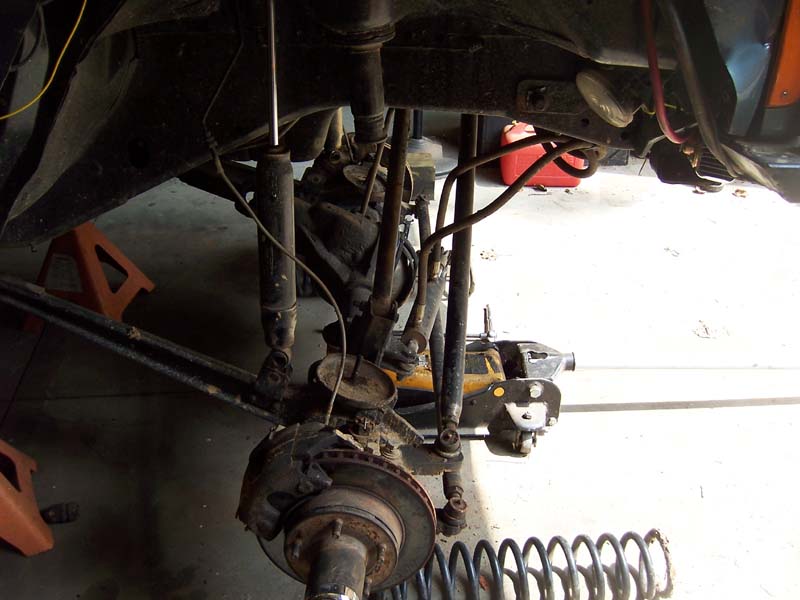

dropped front axle took out springs to add new progressive bump stops
all back together

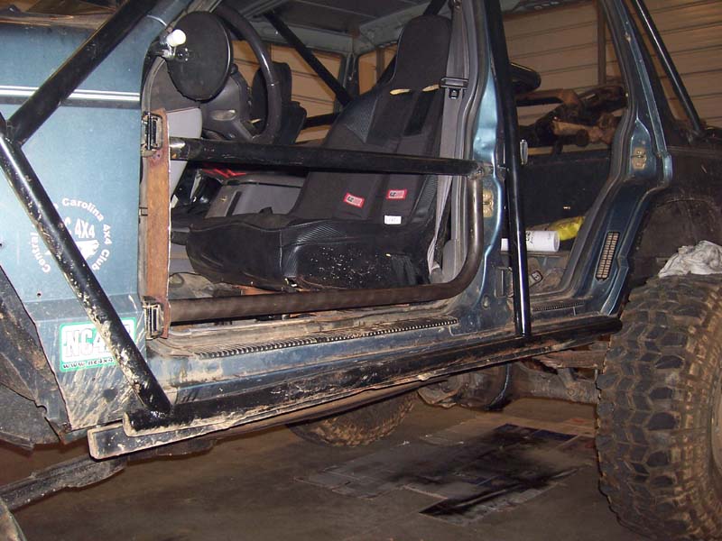

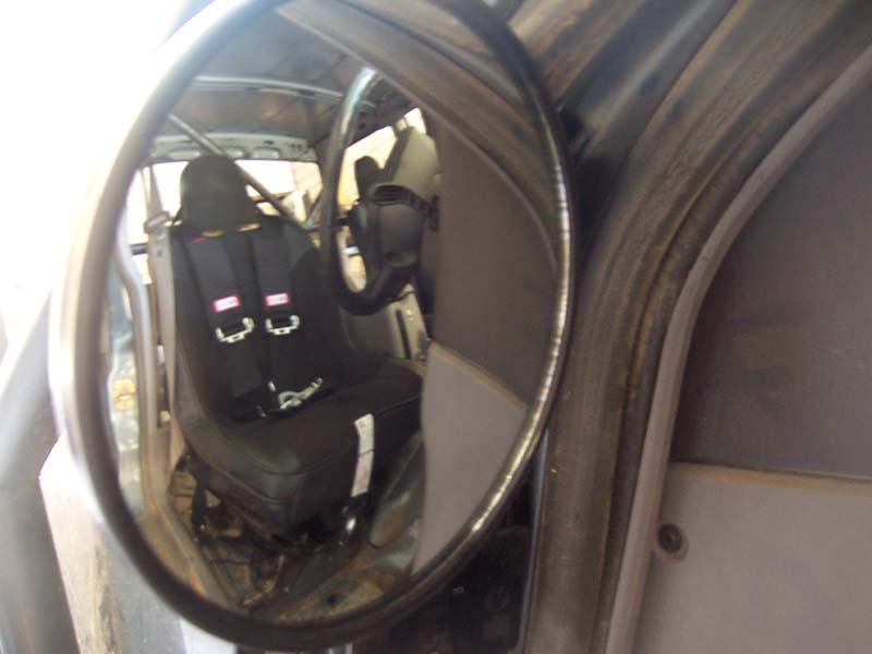

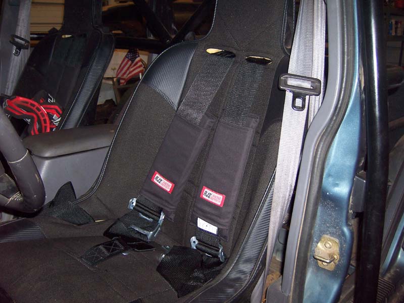

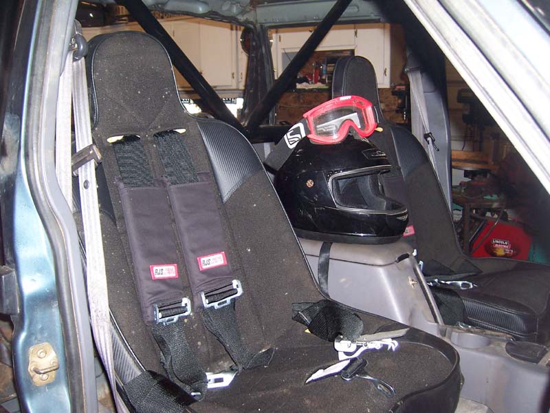

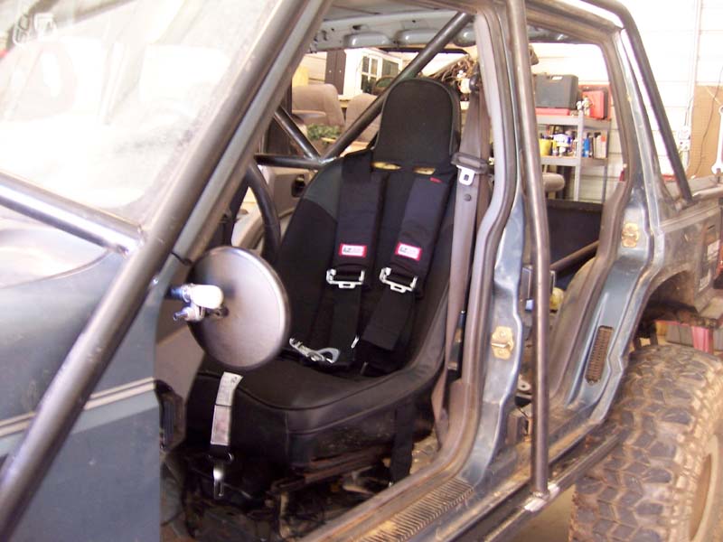

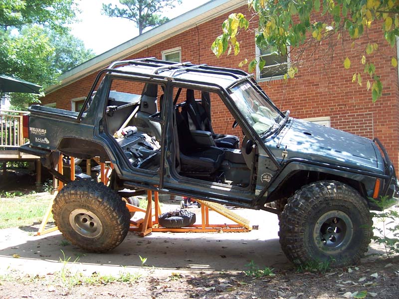

well we got the seats final bolted in and the 5 point harness final in and adjusted to each of us..

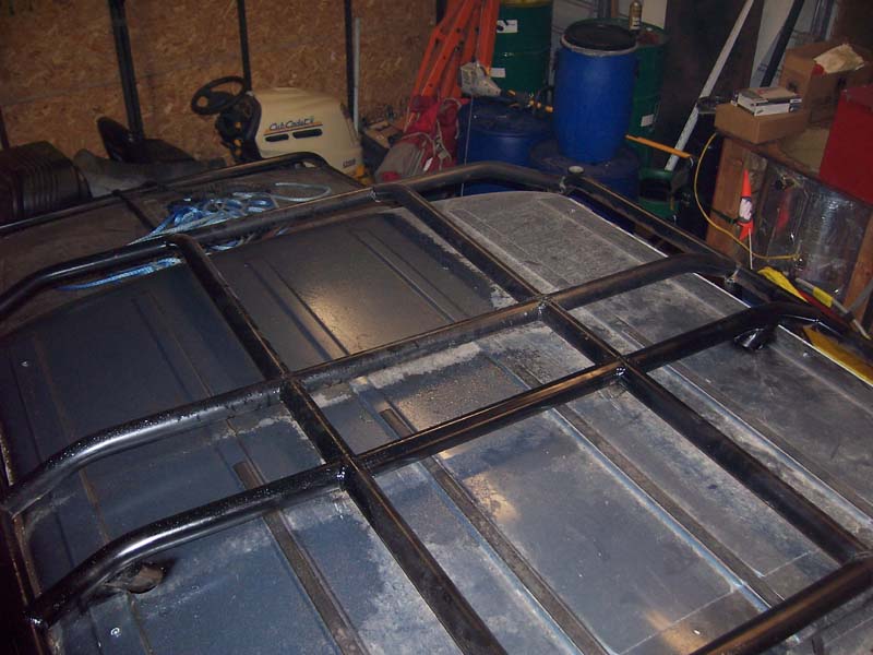

roof bars are all done and painted

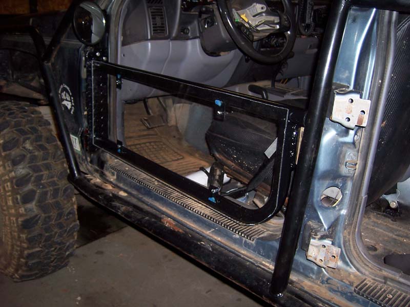

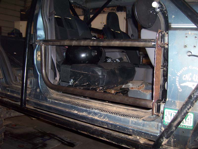

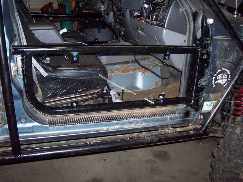

and made some tube doors, these are not done yet

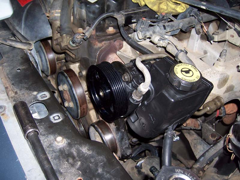

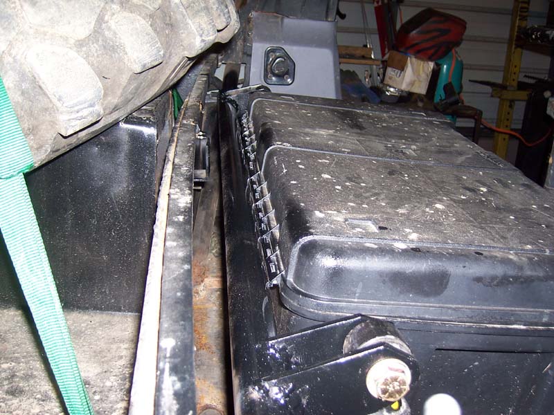

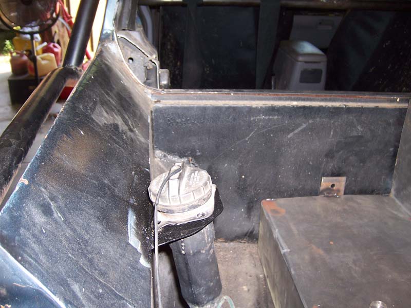

NO pics, but I added rear storage box for tools, etc... mounted CO2 tank, installed down bar from harness bar to floor. I also took power steering pump off to modify it and put on a different pulley to help with hyrdo assist steering
hope to have pump back on this weekend and all the little things done so next weekend we can take it out for a test run
So, gave up on using the doors, huh.
for racing yes... but they are still in garage and if I decide I want them on, I can cut b pillar and move pillar bar inside cab and reattach doors :) this was fastest route to get ready for racing :)

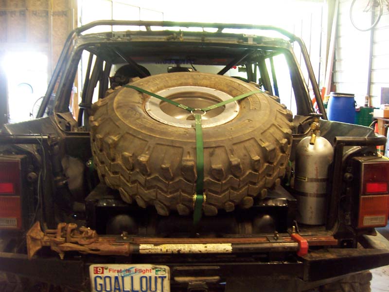

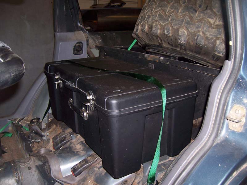

added a storage box to hold tools for race

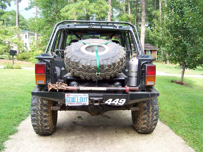

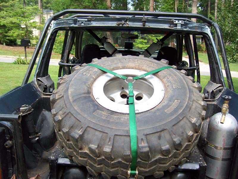

got rear tire mounted with inner lock and got strap tie down system done.. all we do is release center rear ratchet and throw strap into back and we can take off spare easy and quick

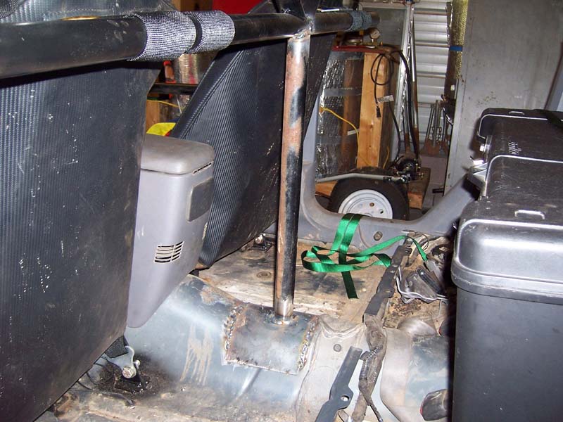

also got middle support bar for harness bar welded in
PSC shipped me my new smaller puley to help with hydro assist when rig is going slow

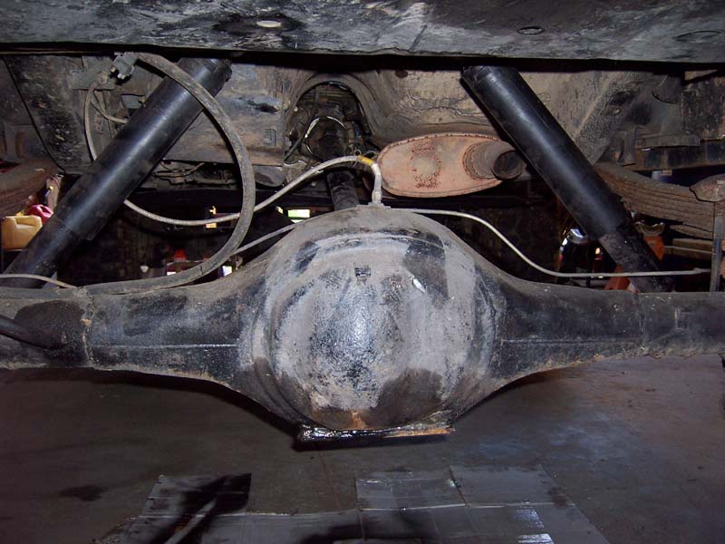

also put new dodge diesel shocks on rear

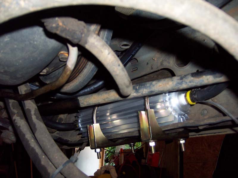

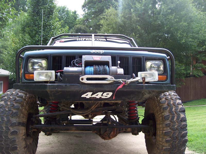

and added a power steering cooler
are you going to leave the PS cooler U-bolts pointing down? I've I'm seeing that correctly, they will be sheared off at the first rock you encounter. Can you rotate those brackets 90 degrees, mount them inside the front crossmember?
ya after we got them on we saw that but i was to hot and to tired to fix it :)

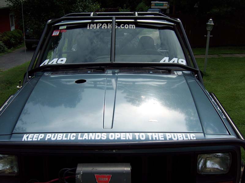

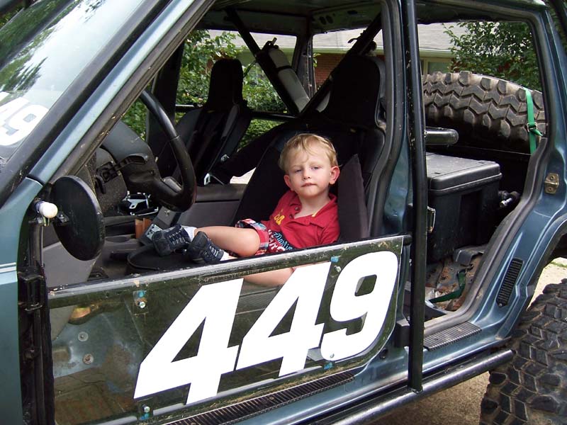

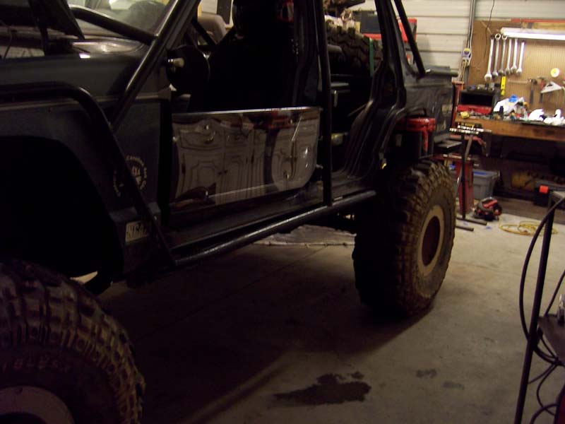

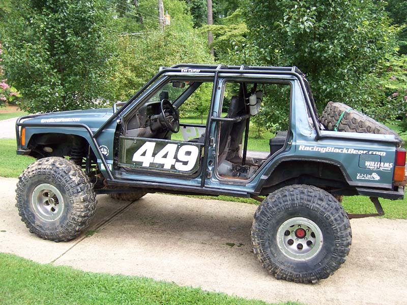

added some plexi to doors so I have a place for race numbers :)

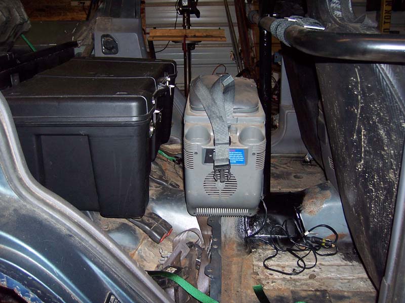

and I found my 12 volt cooler, what would a grocery getter be without some wine and cheese on board
Well took Jep out for a pre run test and it did great..have a few things to fix like rear shocks but all in all we are ready to run..
also added some stickers :)

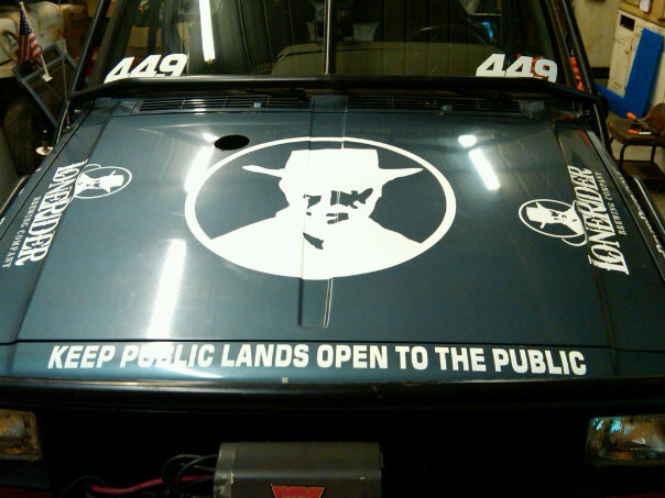

hood ( not done yet )
front
rear
look from rear with quick disconnect spare tire hold down
my son wanted to have a seat

yup rear doors will be made after the race.. but for race we are going to leave it open so we can get into back easy if need be.

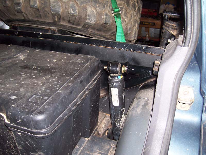

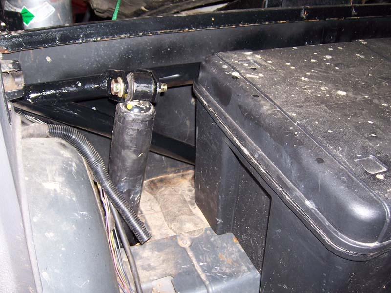

well after prerun we found rear shocks need to be moved.. so I cut holes in floor and stuck them up threw :)
also welded in a connector bar that will double as 5 point harness bar for rear seat and shocks attach to it
shocks are dodge diesel 3500 shocks :)

well the 2 things that took me out of the race was broken front axles and front suspension just turned to slope.
so it is time to upgrade :)

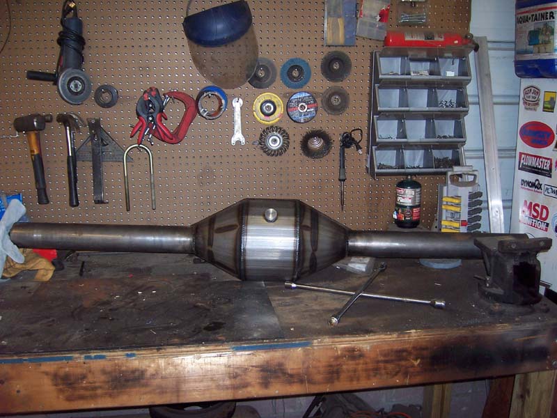

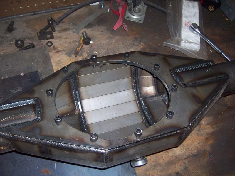

this is a RuffStuff axle housing that I am going to build into a hi9 front axle.. I figure if I build it custom and strong I hopefully will not have as many issues and I also plan to redo
the front suspension
it will take some time to build it but it will be well worth it
