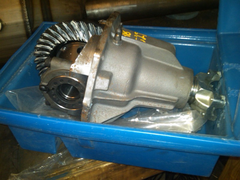

Hi9 w/ 5.29 gears & ARB 35 spline
well I am still in collecting parts stage to build the new front axle but I wanted a better front suspension so I am doing a little work this weekend hope to have them in by end of weekend :)

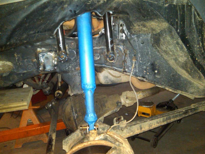

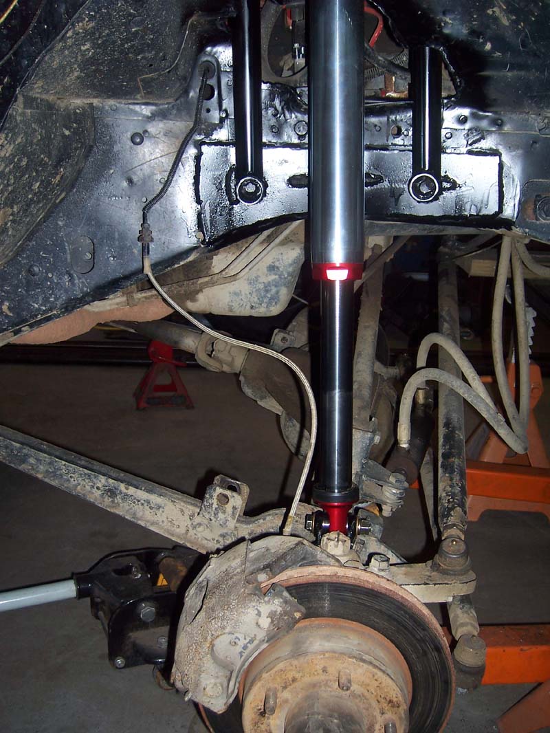

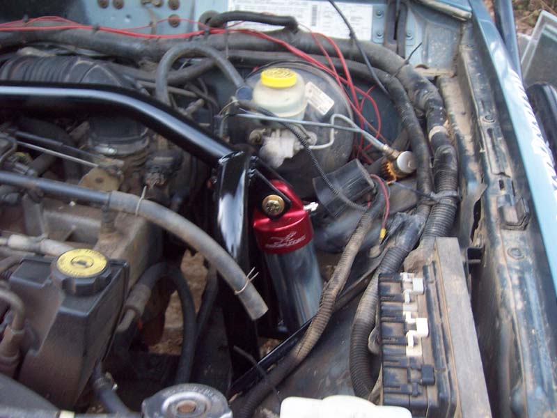

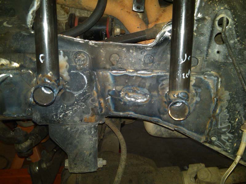

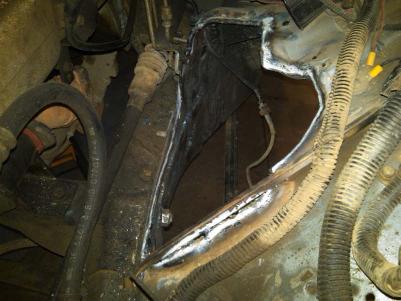

took out coils, shocks, etc.. then had to move the air box on drivers side and the radiator over flow on passenger side then I cut some holes :)
supported jeep with engine hoist, some jack stands, and set axle at ride height.
made some bottom brackets and welded them in
made frame stiffners on both side and welded them in then made some tube slugs and then the tube for shock mount
got drivers side in and done
plan to get passenger side done today and a brace connecting both shock hoops in.. then charge with nitrogen and see how it rides

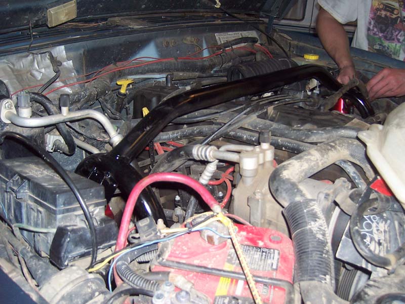

well it is all done and I drove it around the neighborhood a few times with no issues :)
shocks are even tuned..
everything fit except air box.. need to fix that..it is a little tight on passenger side
plenty of room on drivers side

what shocks.. I do not see anything out of place..
from the side

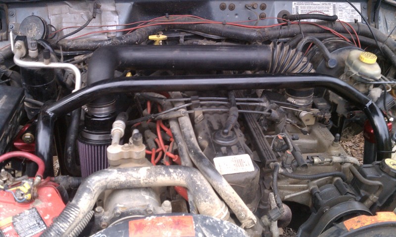

engine bay

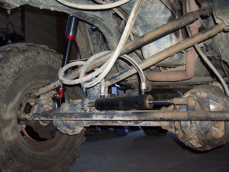

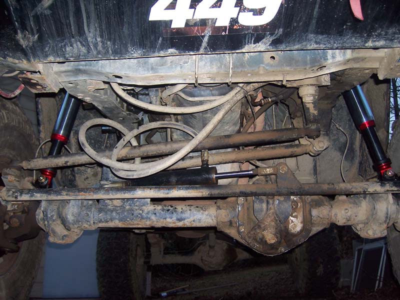

from below showing angle
best news is that it drove very very smooth..

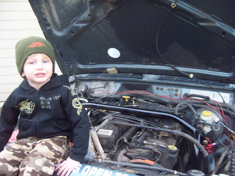

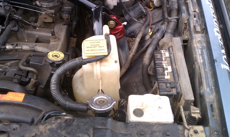

How would you change the valve cover gasket if it needed it?
It looks kinda tight
going to add tube cut aways later on but this needed to be done by Thursday night so we can load jeep to head to Cali for KOH
i got rid of factory one many many years ago and put in one of those replacement ones you get when you buy bushwcker fenders, etc.. it is right next to radiator now ( little white cap if you look hard on drivers side in pic )
had to make a temp air filter location and move radiator bottle to other side.. just could not get air cleaner over cross brace bar without crushing the tube
but this will work
