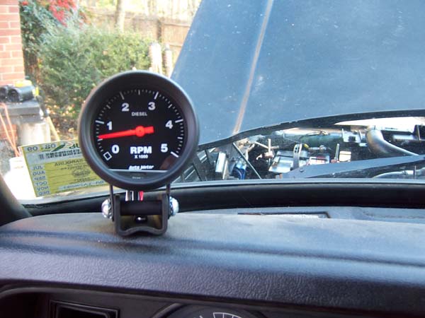

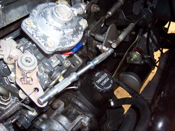

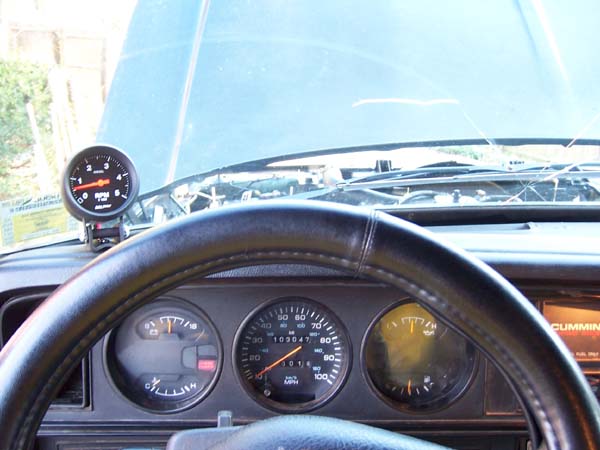

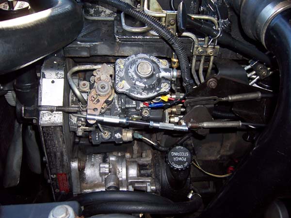

Update: Truck has been pullng every load we can throw at it great.
I just added a new Tach since the Stock one did no work and I could not get it to work :)
I also fixed the factory throttle linkage so now no worries on all that extra play.
more to come :)

Does that tach pick up RPM off the alternator?
How much was it?
I need one for my truck.
How much was it?
Yes it works off the alternator
I got it from Jegs.. price I would have to look it up..
more to come :)
swap the linkage and the spring...and let me know how it goes...;)

How do you calibrate it?
there are a couple different ways...
one is to buy an optical tach and put some reflective tape on the harmonic balancer and actually read what the motor is doing and set the tach to match...
I opted to do it a different way...used an online gear/rpm/speed calculator, and based on tire size, figured out what RPM's it should be running at certain speeds...
I set it at a high speed/high RPM, and then as I slowed down, I checked to see how close it was...and checked it in other gear/speed combos...
I'd say it's within 100RPM at any given gear/speed combo right now...
