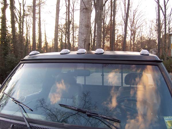

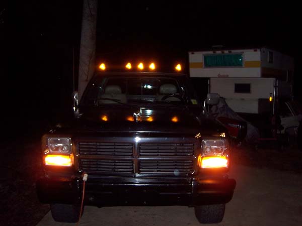

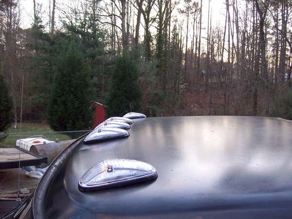

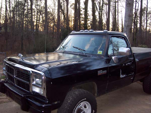

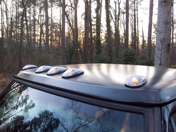

Added some LED Cab lights to truck..
They look good and work well but the lights seem to be a little testy so we will see if they keep working or not..
where'd you get them? the stock orange ones on my f350 look a little odd with the clear corner/parking lights.
Looks good
Looking good

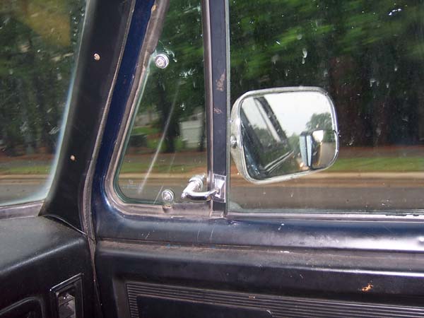

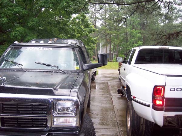

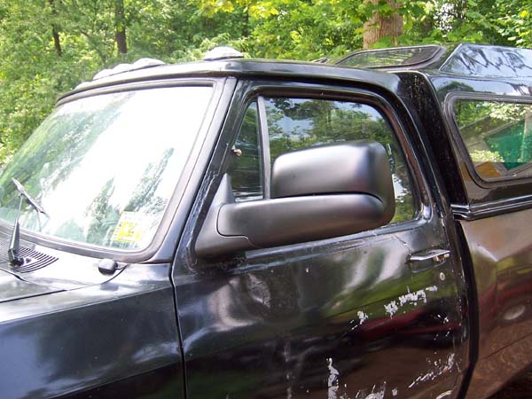

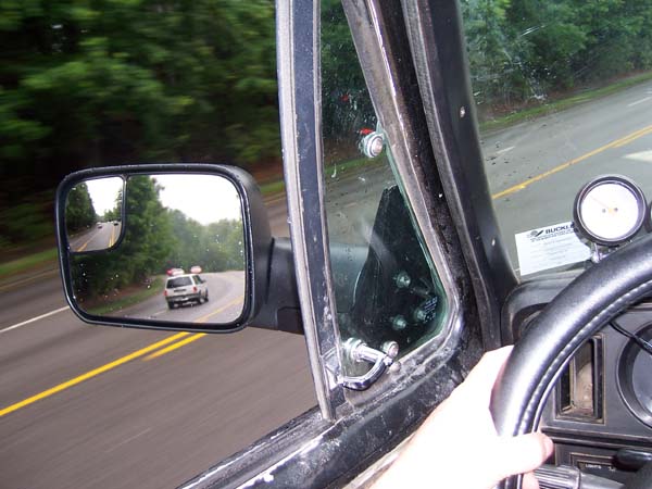

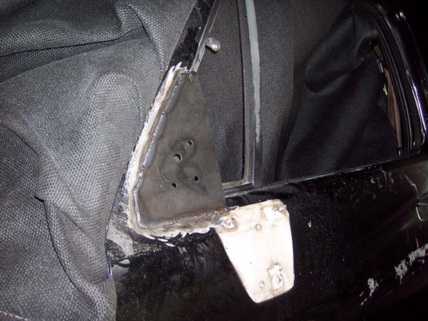

Well a While Back I put bought soem New Mirros for my DODGE since I can not stand the old school chrome mirrors that never stay in place..
And since I have a Big trip coming up I need to get some tow mirrors So I decided it was time to make them work.

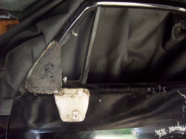

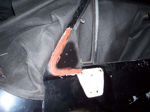

I made a cardboard template then , I copying that onto some steel, etc..
Once I located the correct location I welded the plate into place added soem bondo to smooth it out ... then the rain started so I threw up a tarp real quick but it was so Humid the bondo would not dry..
so I ended up just painting over it and installing mirror so I could drive the truck last night, since I had dinner plans.. I am gonna do passenger side today and hopefully finish the bondo work also..
here are pics:
First shows old mirror
next 2 are plated welded on.
With some bondo

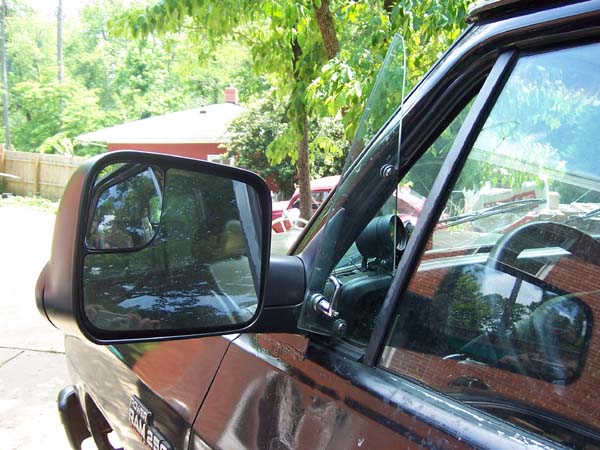

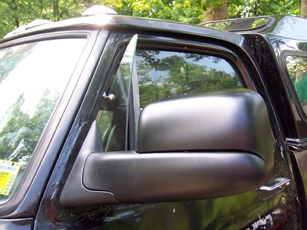

with mirror on in closed position
with mirror on in open towing position
I hope to get some more pics today..
Where did you get the new mirrors? Those are what I want. I think they are a straigt bolt on for my truck.

That is the bad part I bought them a while back.. but I am looking for the info..
I think it was Ebay.
oh and they are 3rd Gen mirrors..oops :)
Close up from side....do not mind the bondo mess i have not fixed that yet :)
with glass open
from back with glass open
Sweet mod! Very unique!
wow, those things are HUGE! should fit in nicely when you get the rest of the paint/body work done.

Those mirrors are a straight bolt on to second gen trucks, '98 + for sure I'm not positive about the earier models. From '98 trough '02 the mirrors are manual, starting in '03 they could be manual or power/defrost. The mirror swap was certainly on of my first mods on the '99, and what a huge difference it makes with a loaded trailer.
steveo
Truck looks good. Those are great mirrors for towing.
Just a heads up for those that might be looking to buy them. They at $352 a piece from Dodge. But you can flip over to the Mopar catalog and get a pair for $355. :lol: And you can always check Ebay, they usually run 150-200 a piece. Be sure to get a genuine Mopar mirror, I've heard that the cheaper knockoff versions are crap.

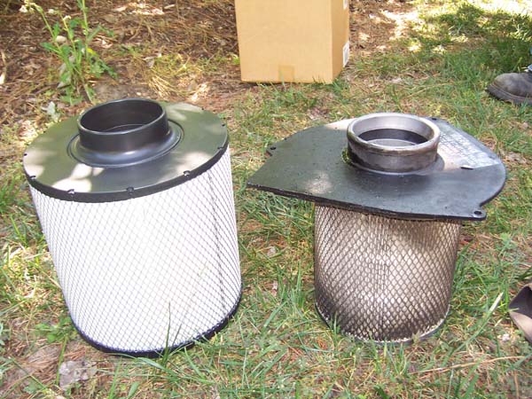

Well I bought the larger air filter (BHAF) a while back and just have been waiting for some free time to install it.
Well today a buddy and myself decided why not lets make it.

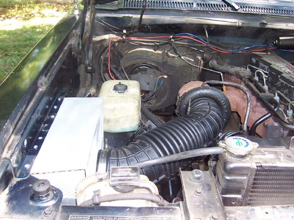

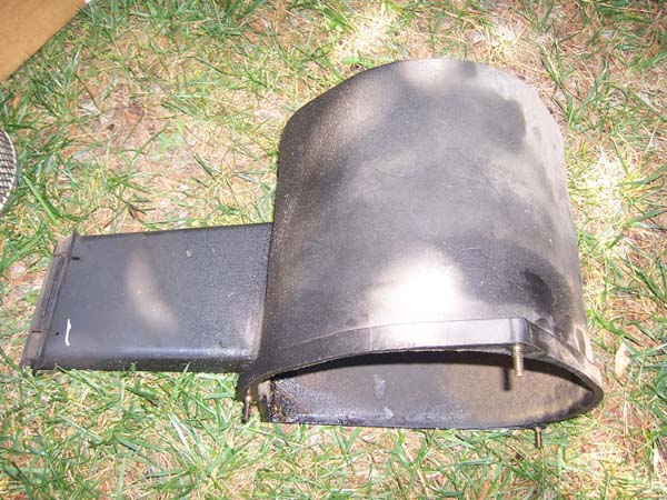

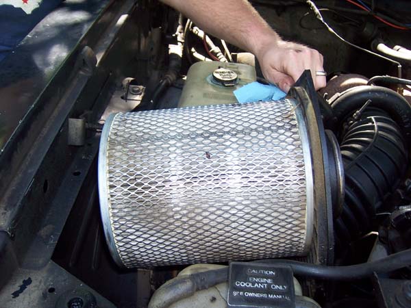

So we first took out the old air box and hose..

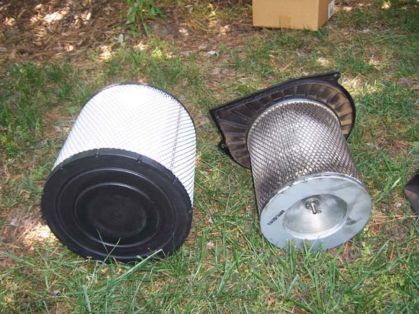

first pic shows old factiry air filter

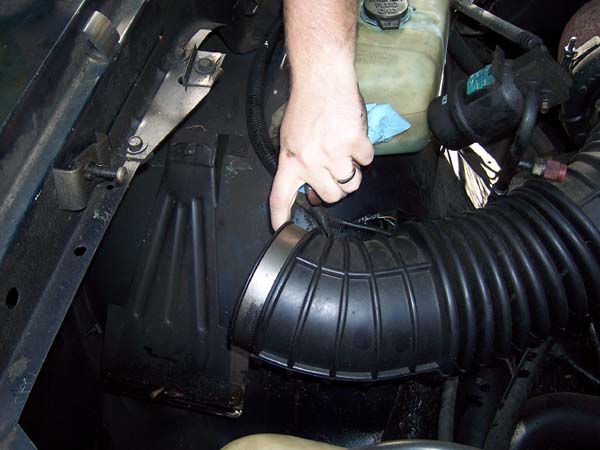

this pic shows the stock air intake hose
Here is the box and the air tunnel out of the truck.
Then we took some comparison photos to show the factory vs. BHAF
wow that is a big filter

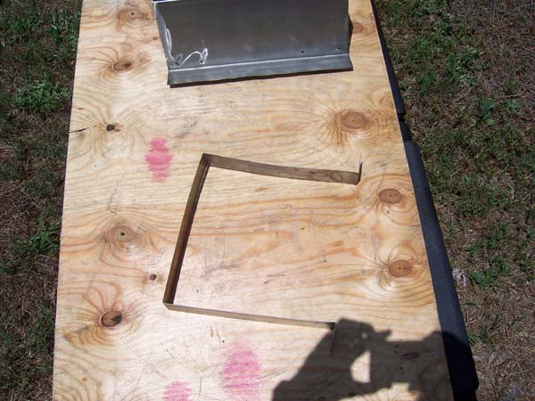

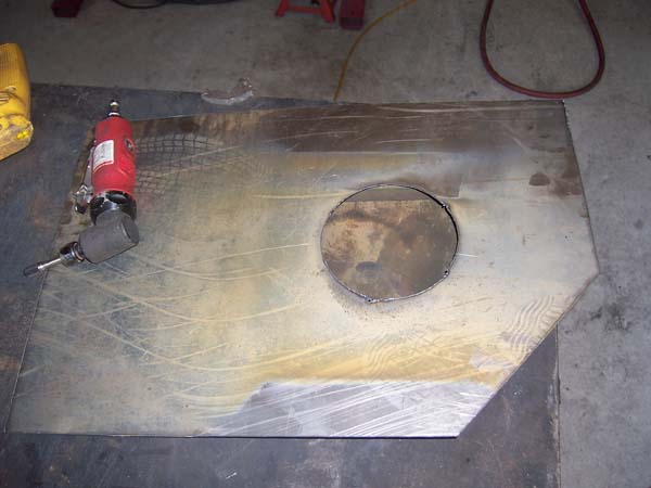

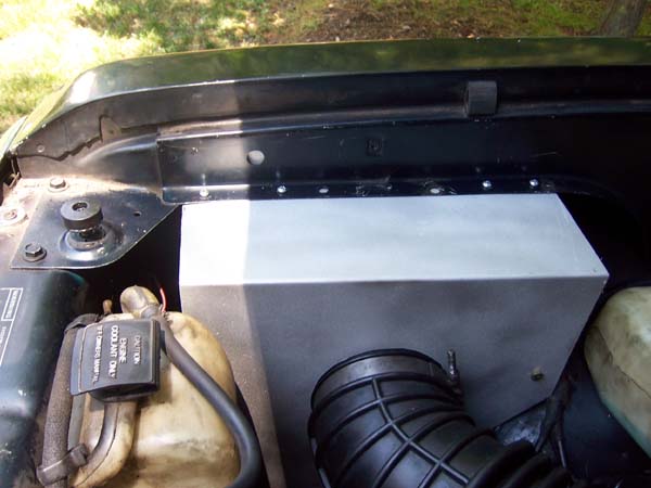

Then we got started on the making of the Old Smokey Mount
we took some sheet metal we had laying around.. and used the following diagram:
http://www.dieseltruckresource.com/pics/showphoto.php?photo=17708&size=big&password=&sort=1&cat=522
we did modify it a little.. instead of 1/2" break we made it 1.5" so it fits up under fender and help hold the mount in place with more metal..
we also moved the angle 45 degree cut up a little so that way I could leave the overflow coolant container in its stock position :)

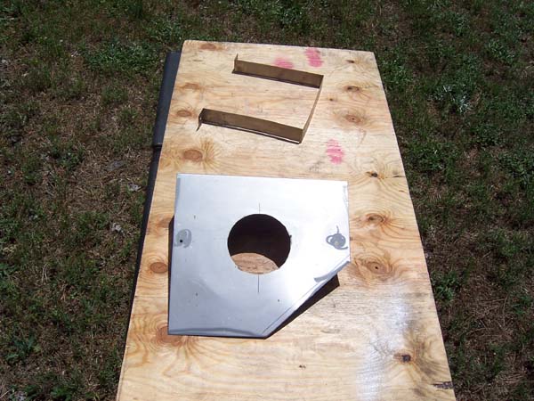

Here is the mount in the middle of cutting the steel
this shows it all cut and bent up
then we made a steel strap to go around the filter to keep it in place
After it was all cut and bent I took some Silver paint I have and painted it all to keep it from rusting
Here is the finished mount done and in the truck
One more pic from different angle
