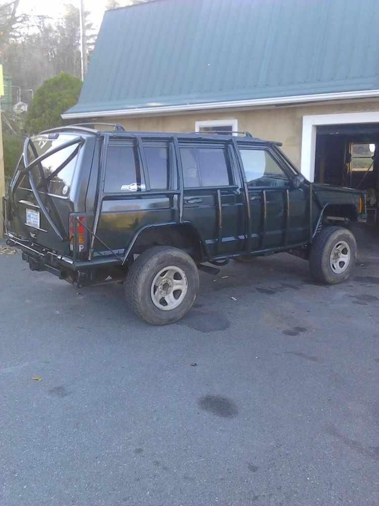

finally my XJ to keep for good, innovative
The more weld passes you put in that small section of unibody the weaker it becomes. The plate is a good start but you need to spread the load across a larger area. The plate should cover the side of the "frame" atleast 4" to the front & rear with plug welding holes in it. That mixed with frame stiffeners would be a good start.

Here is a pic of the ridiculousness called "body armor".

No...being mean would be forwarding the link to this thread to one of the Boone PD officers or Watauga County Sheriffs in my phone. THAT would be mean.
:shaking: I love the fact that the this flying pile of metal and booger welds has a license plate on it in that picture but in the OP it clearly states he has no title for it.
It was a nice jeep before it started. I have a hard time believing its a salvage or something like that. Makes you wonder if there is $ owed there.

Thanks for the photo, I'm an older gent but he may be my long lost son? And I DO have a truck load of the trampoline parts.
