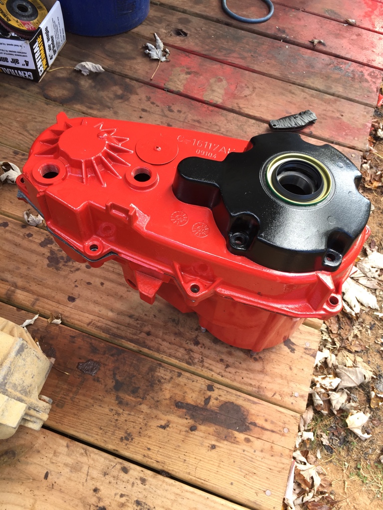

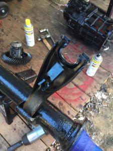

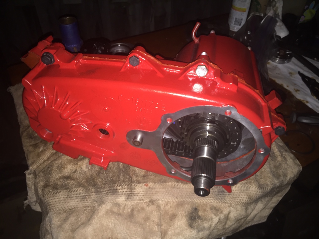

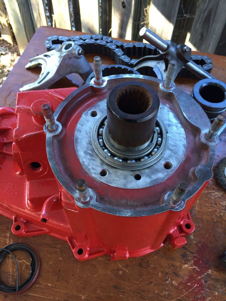

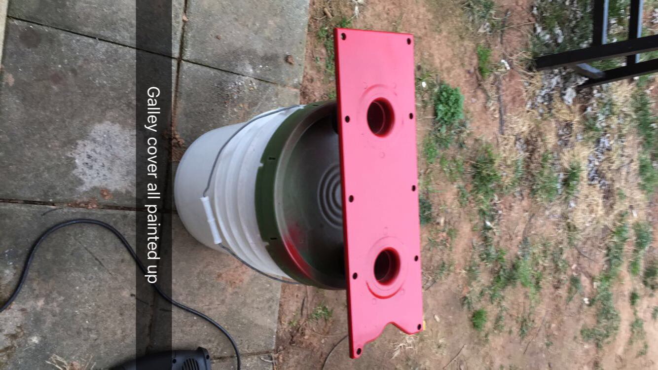

Painted the SYE cover and Yoke.
Rebuild 90% complete haha. I have reservations about the chain. But gunna run it. I have this other case to fall back on if it explodes. Haha.
Hopefully did it right :apprehensive:
Can't have a 4x4 without a front axle.

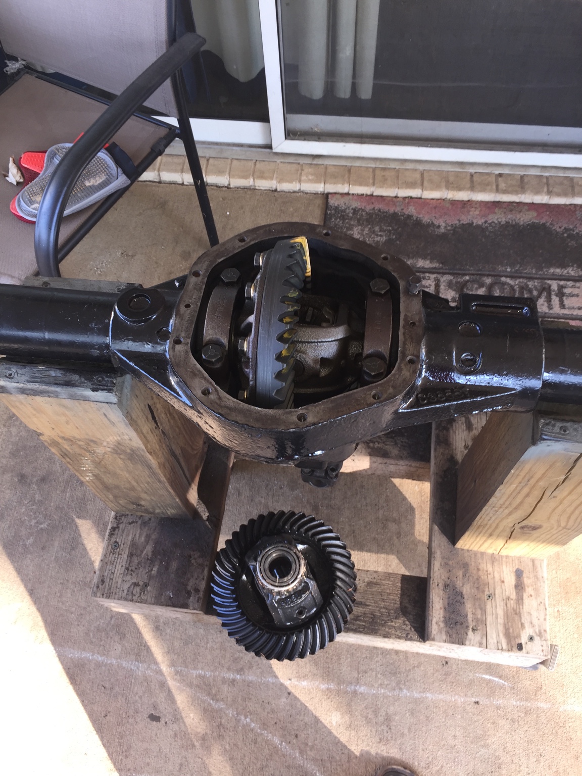

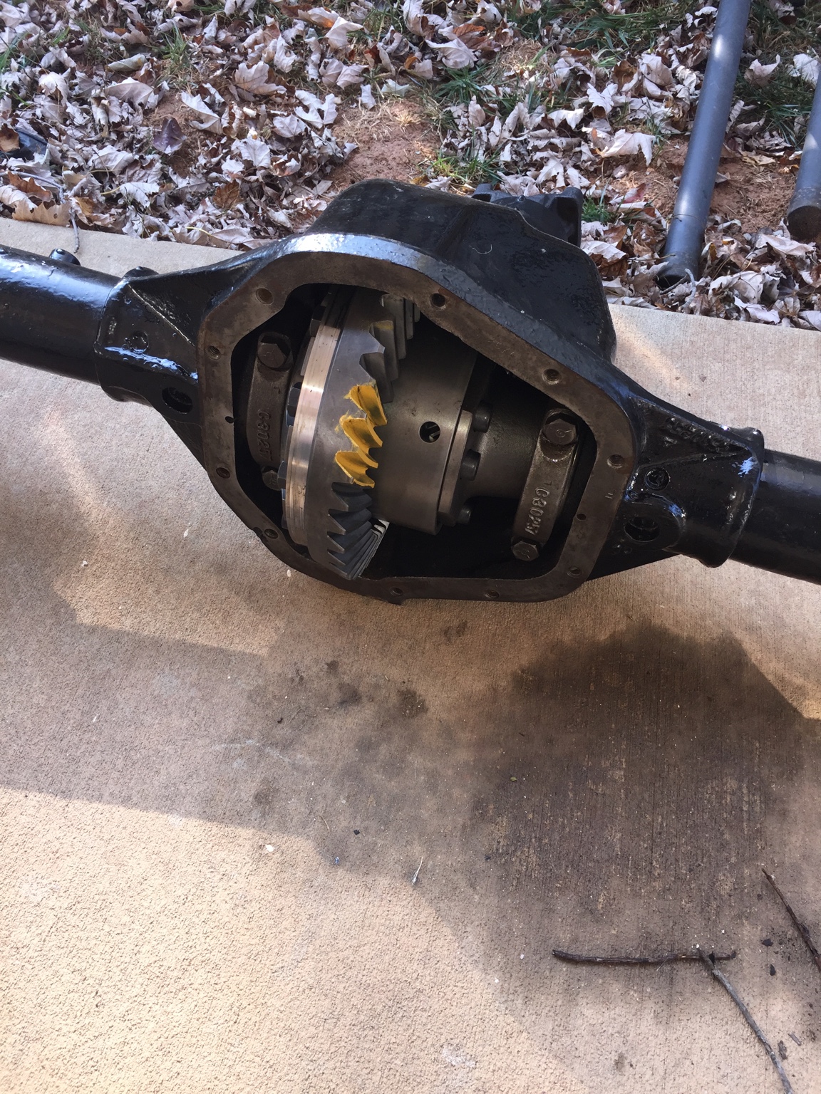

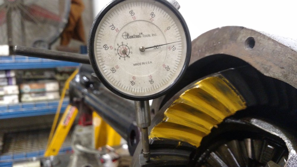

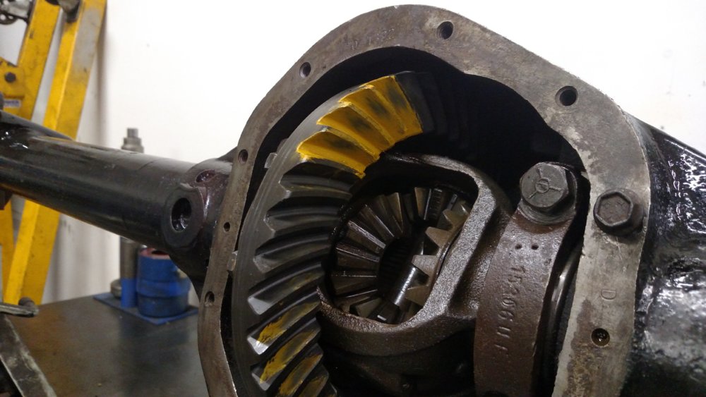

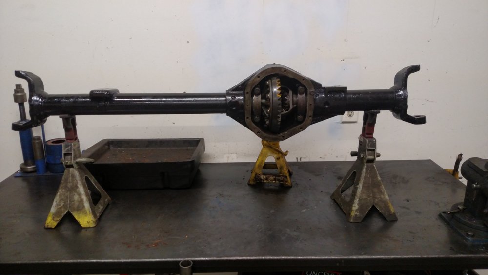

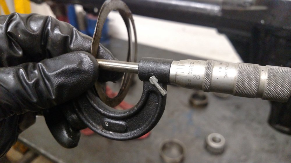

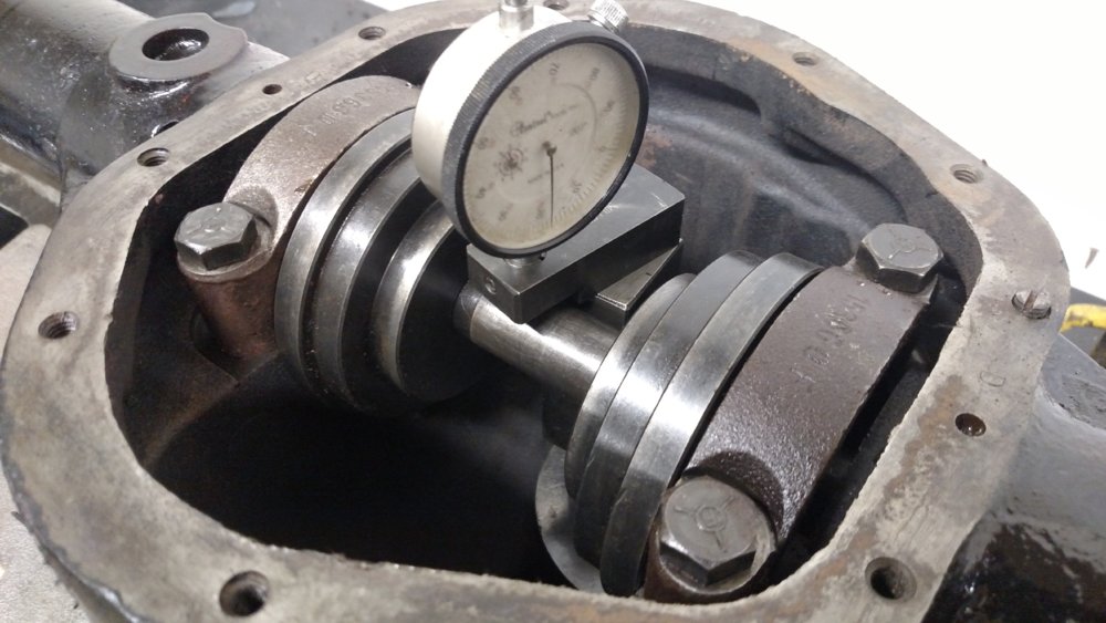

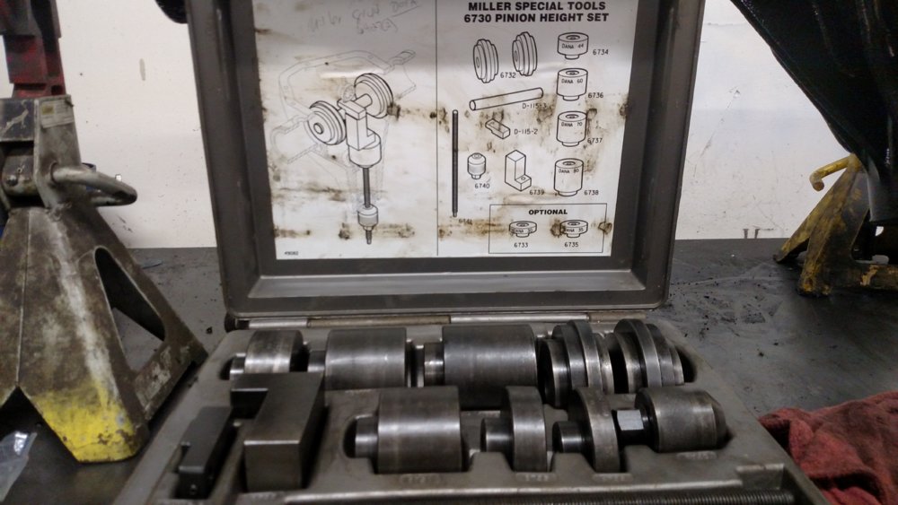

I wrapped up your front HP44 today. 4.88 gears, all new bearings and seals too.
Time to open up the ol' pinion depth gauge set
I came up with 0.018" (with baffle and slinger accounted for)
Someone at Dana used 0.020" back in 1978, so I must be close
Set backlash to spec for initial pattern check
About as good as it'll get given the gears you supplied me with. :-)
Buttoned up and ready to pick up

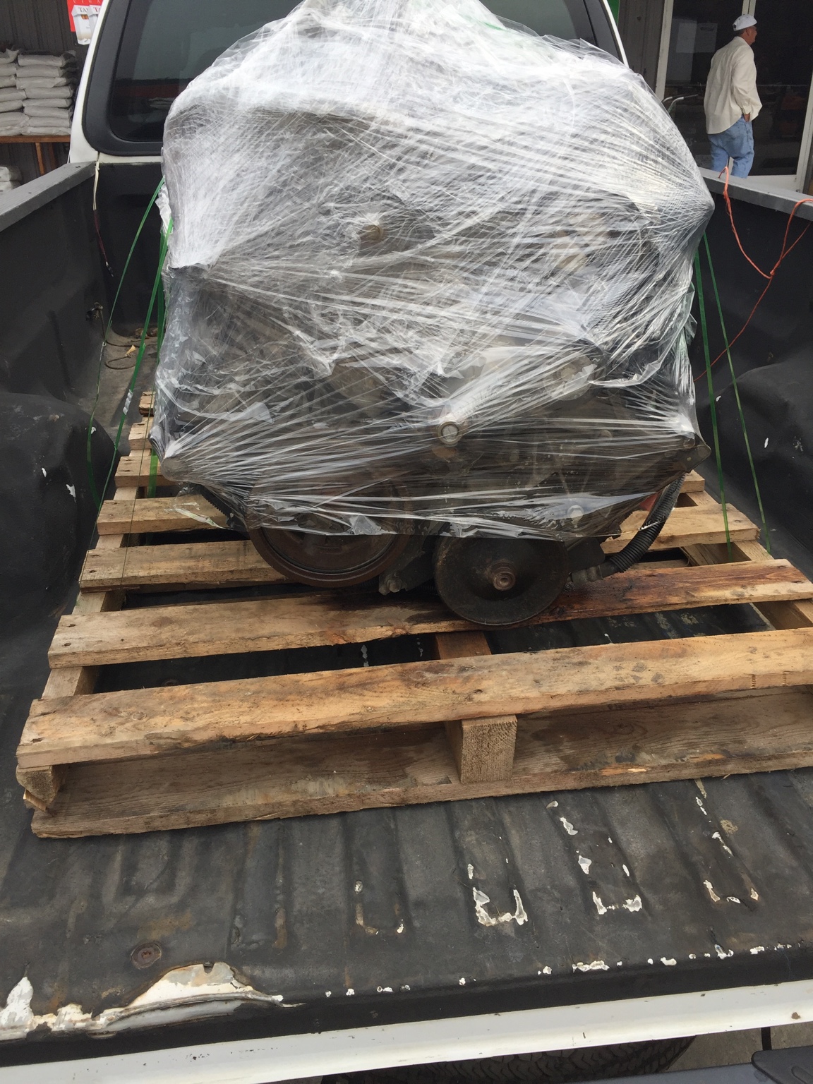

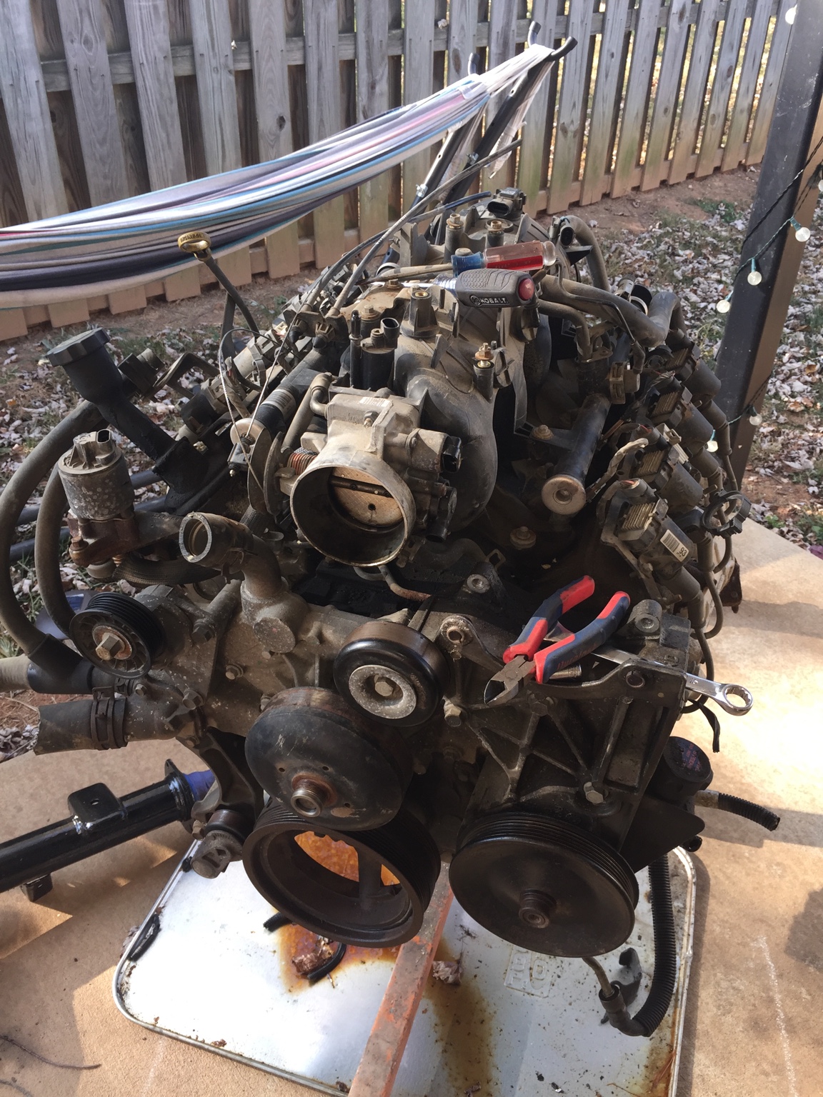

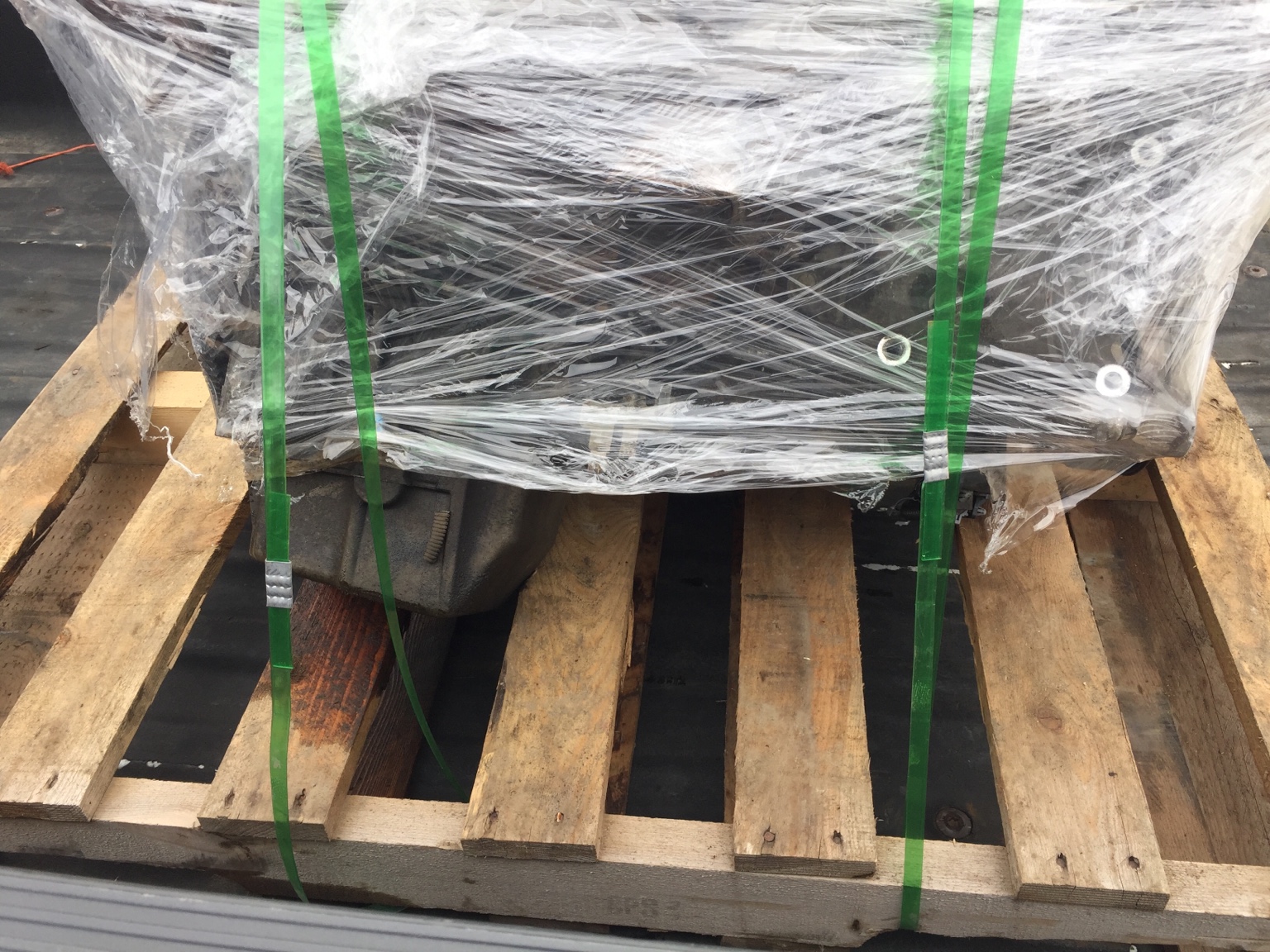

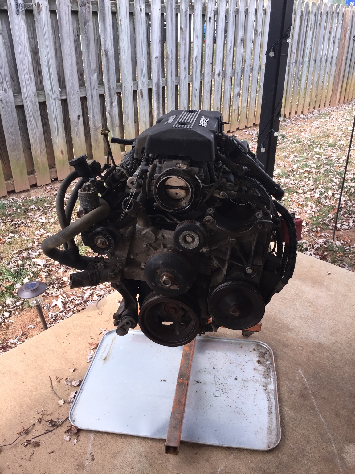

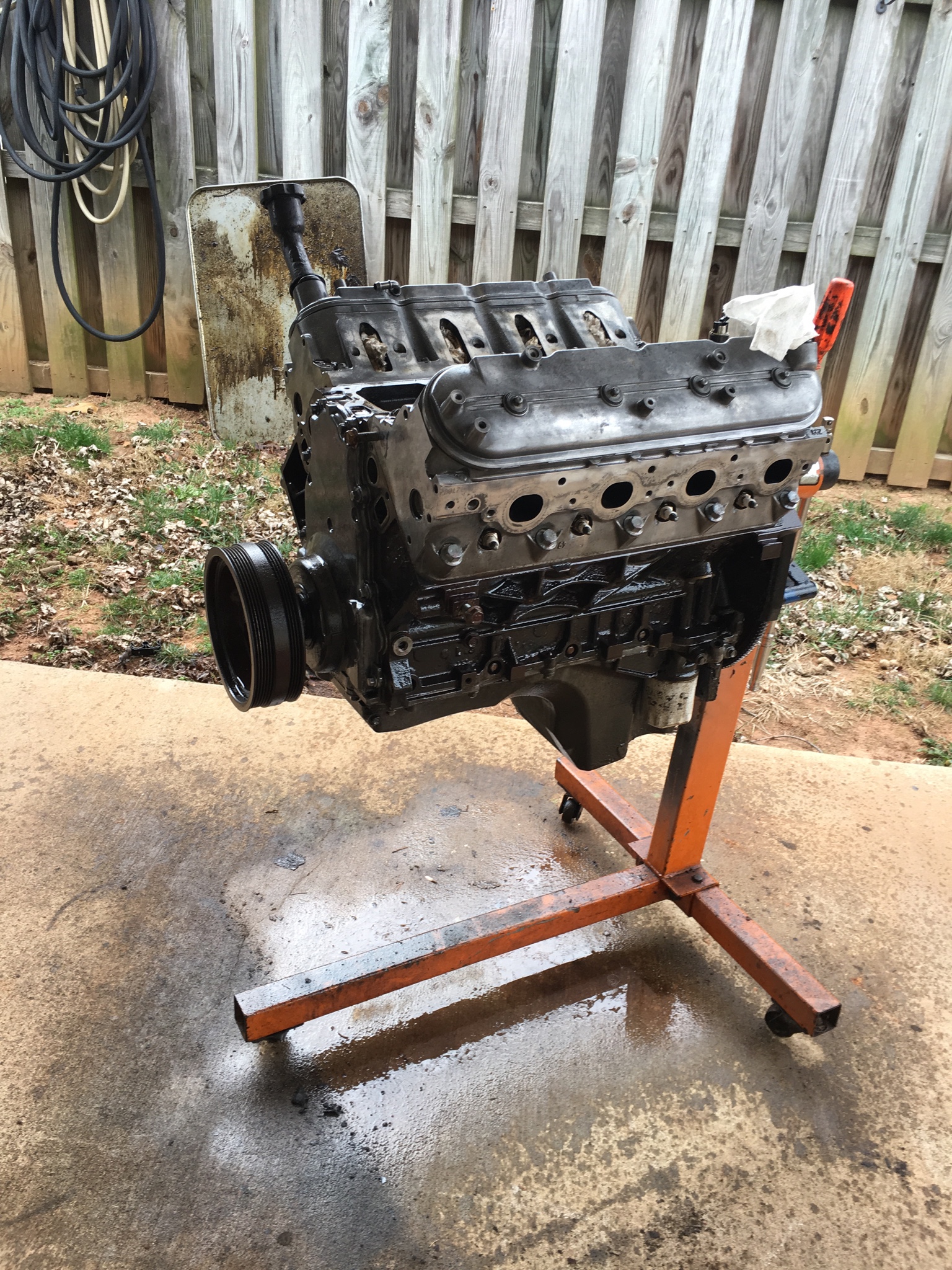

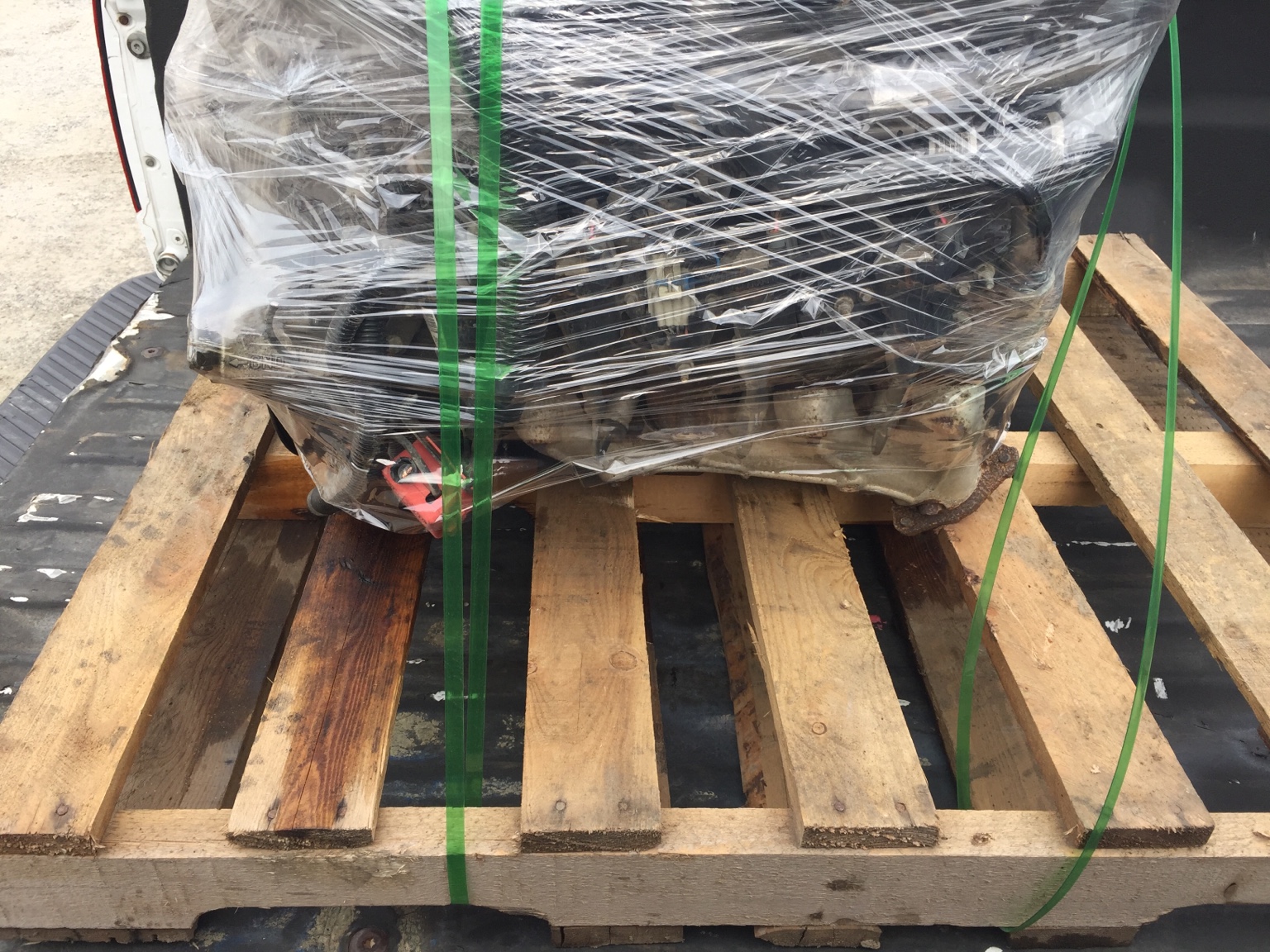

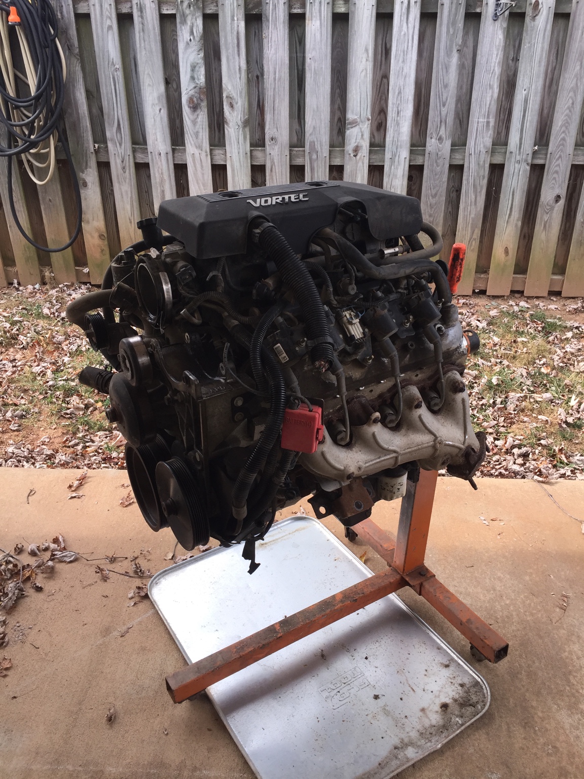

Picked up the 5.3 engine today got it onto the engine stand man this is one dirty engine for only 78,000 miles it's from a Tahoe but definitely has the truck intake. very excited can't wait to start tearing this sucker apart and cleaning it and painting it

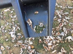

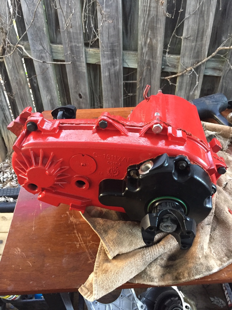

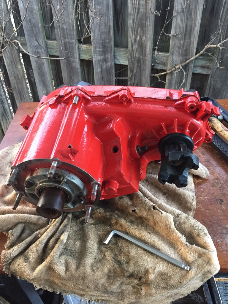

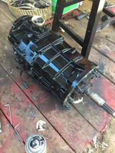

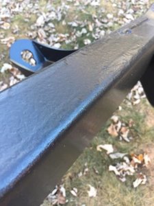

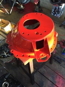

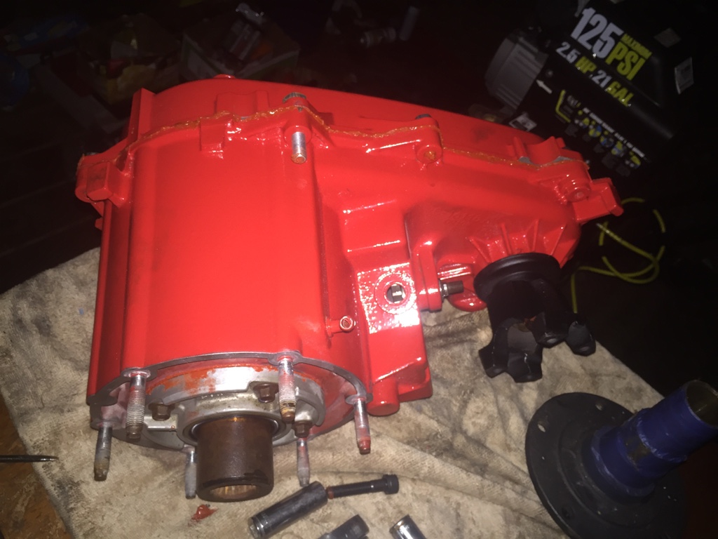

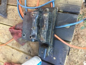

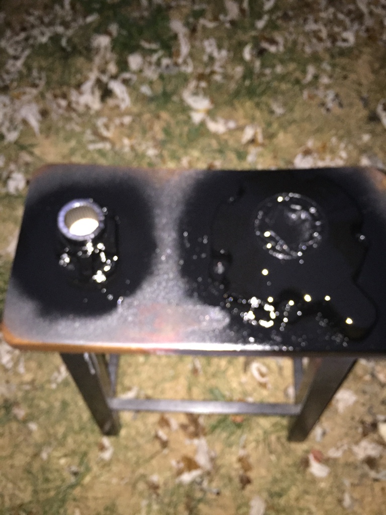

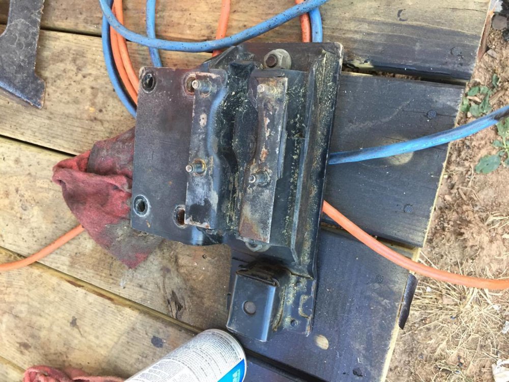

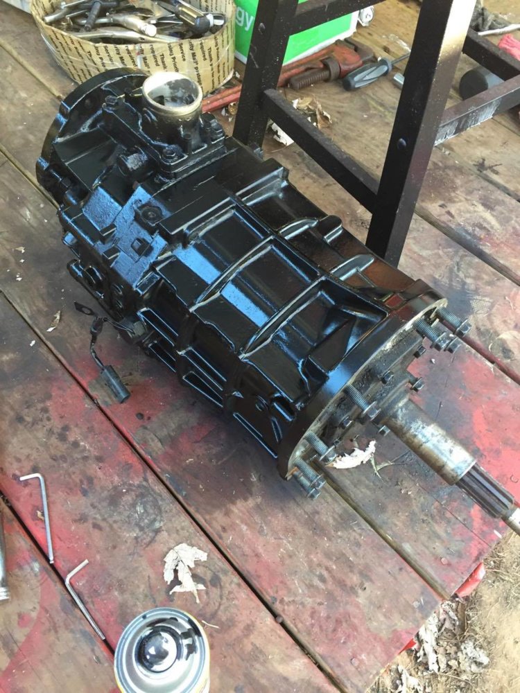

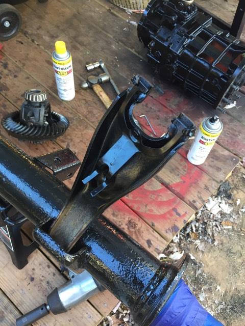

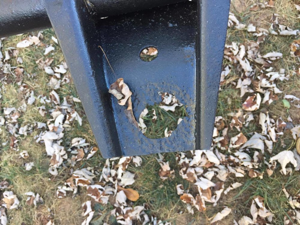

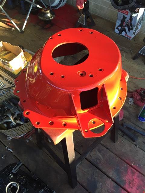

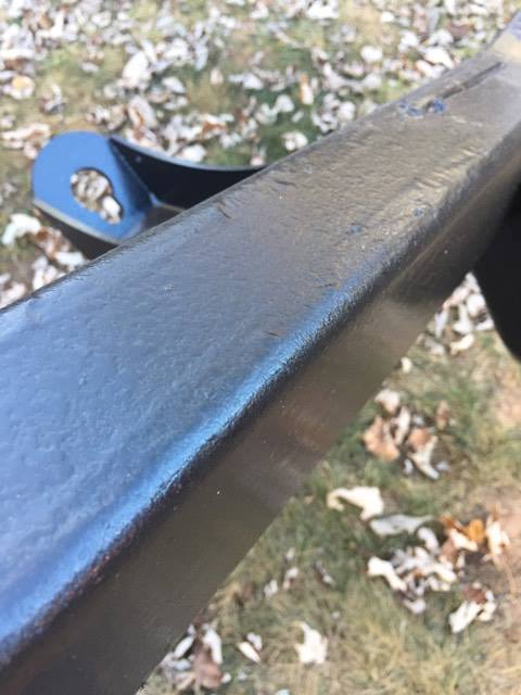

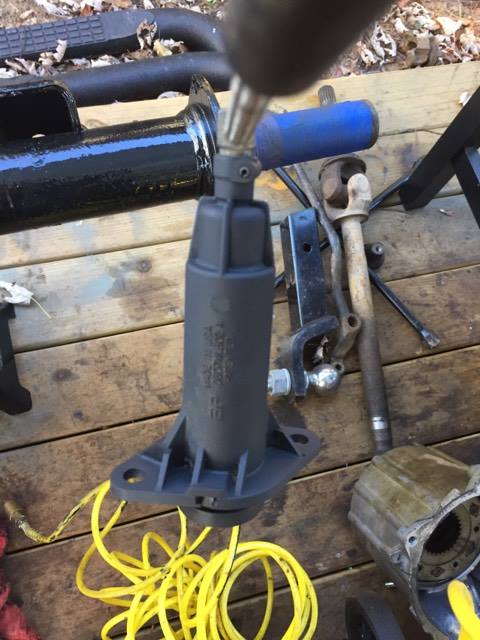

Got to squeeze in some jeep time today! Not much. Just some painting. I need to paint the frame one more time and weld on a plate to fix the front body mount. Once i do that, i can toss the axles under it and move it forward! Gotta call up barnes4wd and drive over and pick up the ubolts and spring plates. Waiting on their email, as i need a custom plate for the d55 cast perch for the ubolt flip. Cleaned and painted up the Lakewood bellhousing! First coat, and i think i can get away with three only. Its stock red underneath so if it scratches no issue. I just wanted to freshen it up a bit. I cleaned up the t/o fork and shot a first coat on it as well. Went ahead and cleaned the camaro mc and shot it with a flat paint. Not sure if going to paint the same black or leave it. Dunno. Maybe go pink? lol. Yanked off the AX15 oem crossmember mount - hope to find a jeeper in need with some bones to spare! haha. gotta fund my bankrupt arse somehow. And here is the shot of the first coat on the transmission. I pulled the t/o sleeve cover and seals/bearings look in excellent condition. I am a little bit worried about the shaft play - got some posts made about it, will see what the gurus have to say.

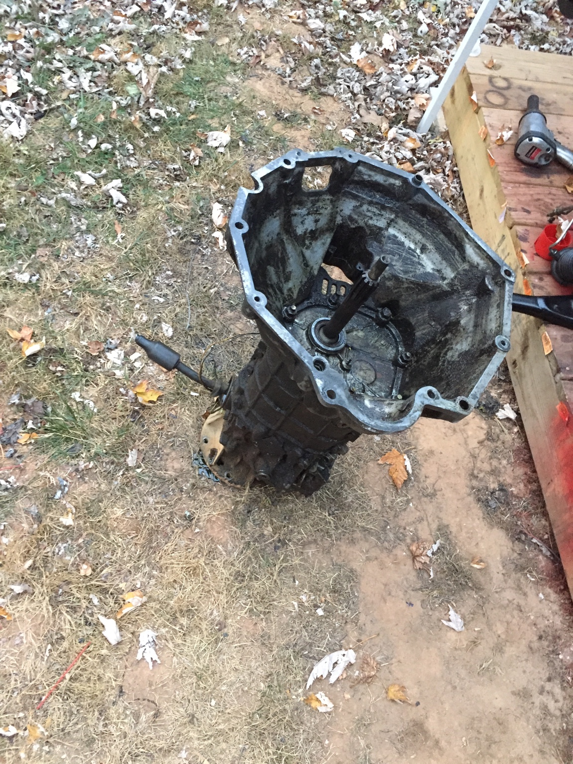

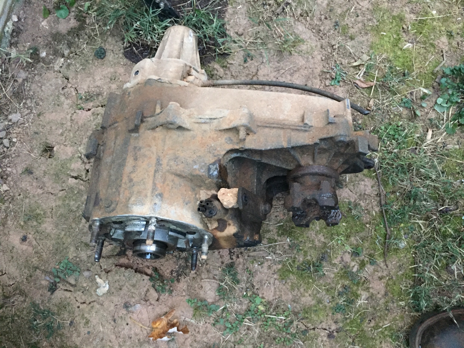

Got the old trans and Tcase pulled today!!! Getting ready to yank the body. Super stoked, but winter is coming fast
The internal slave is in super good condition. If it works on ax5 and AX15 trans then hopefully can help someone out for a few bones
The clutch is in super great condition. So good news on salability.

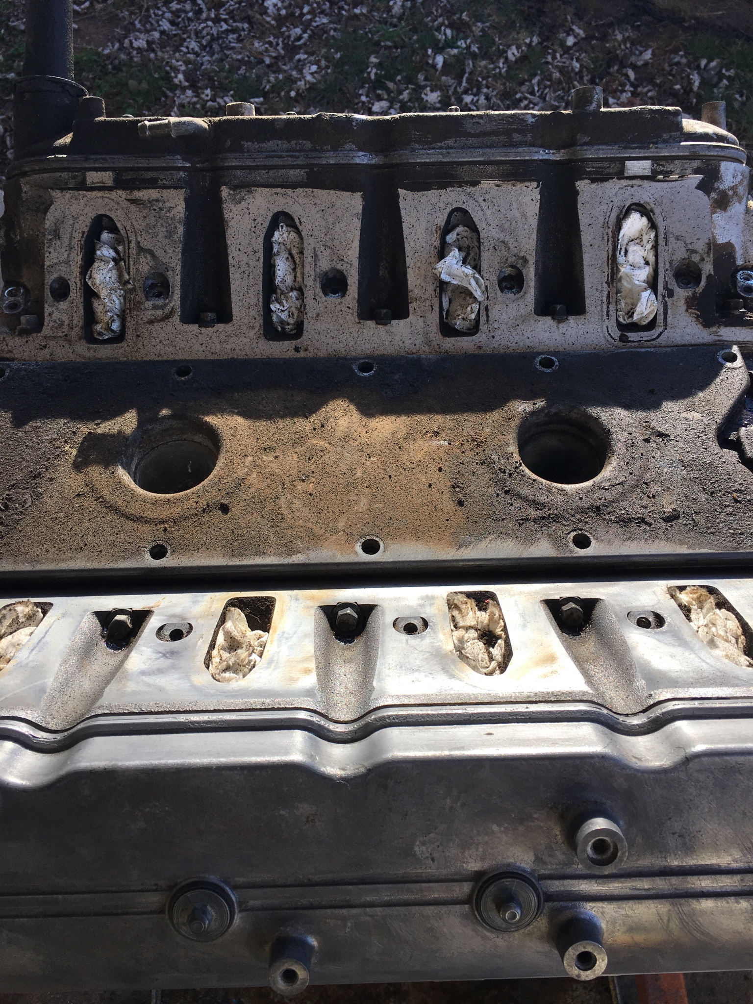

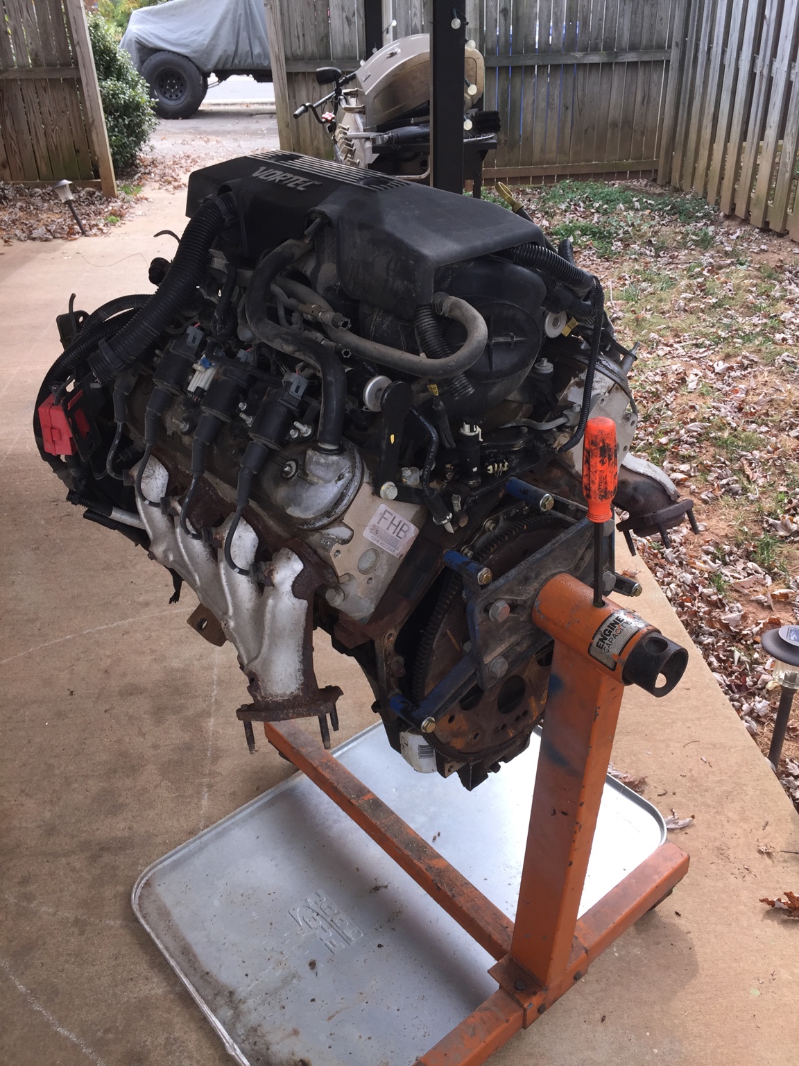

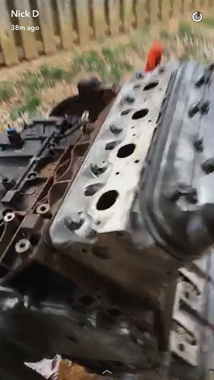

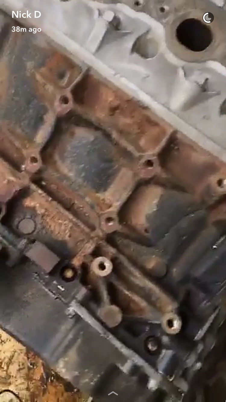

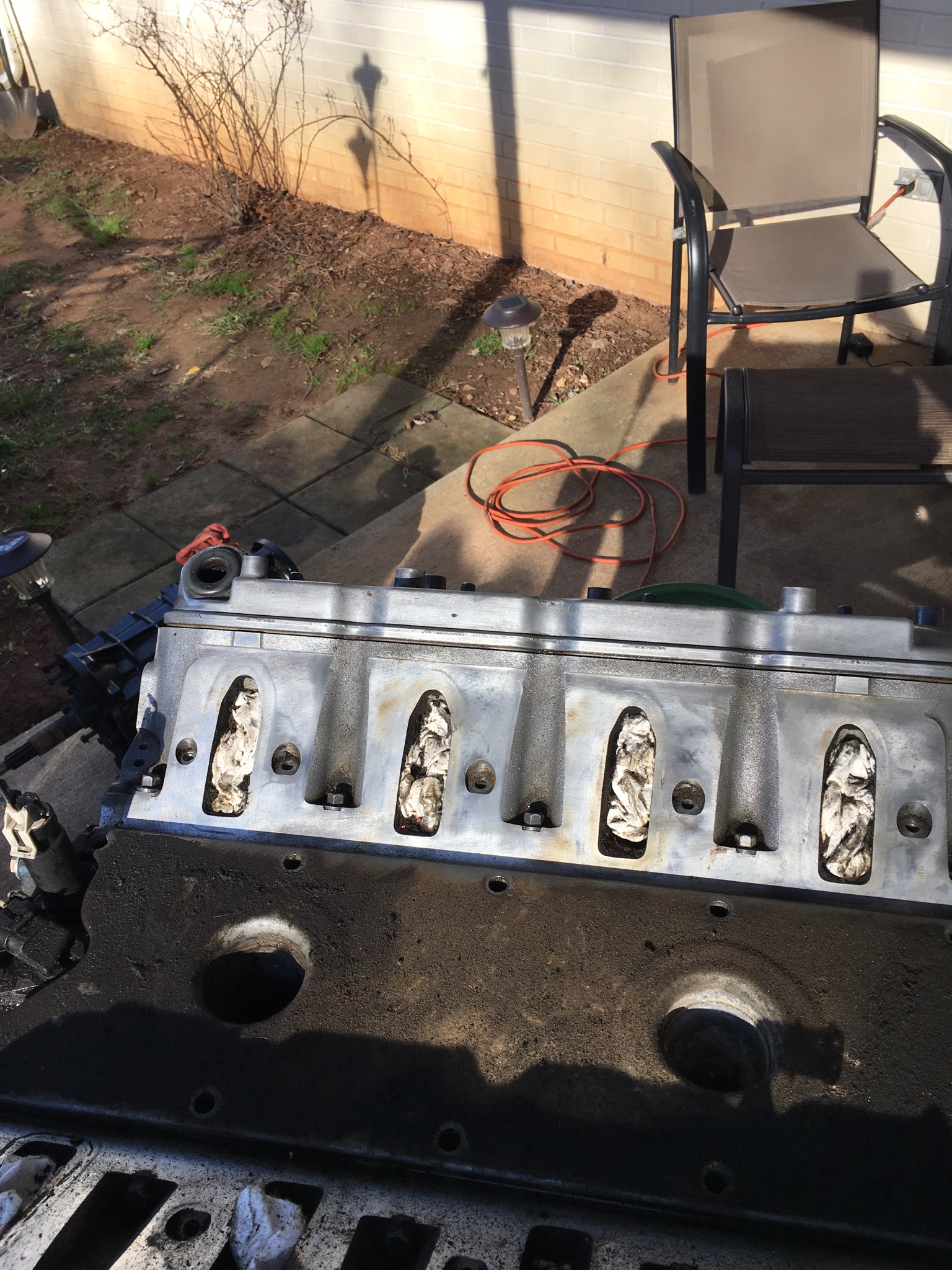

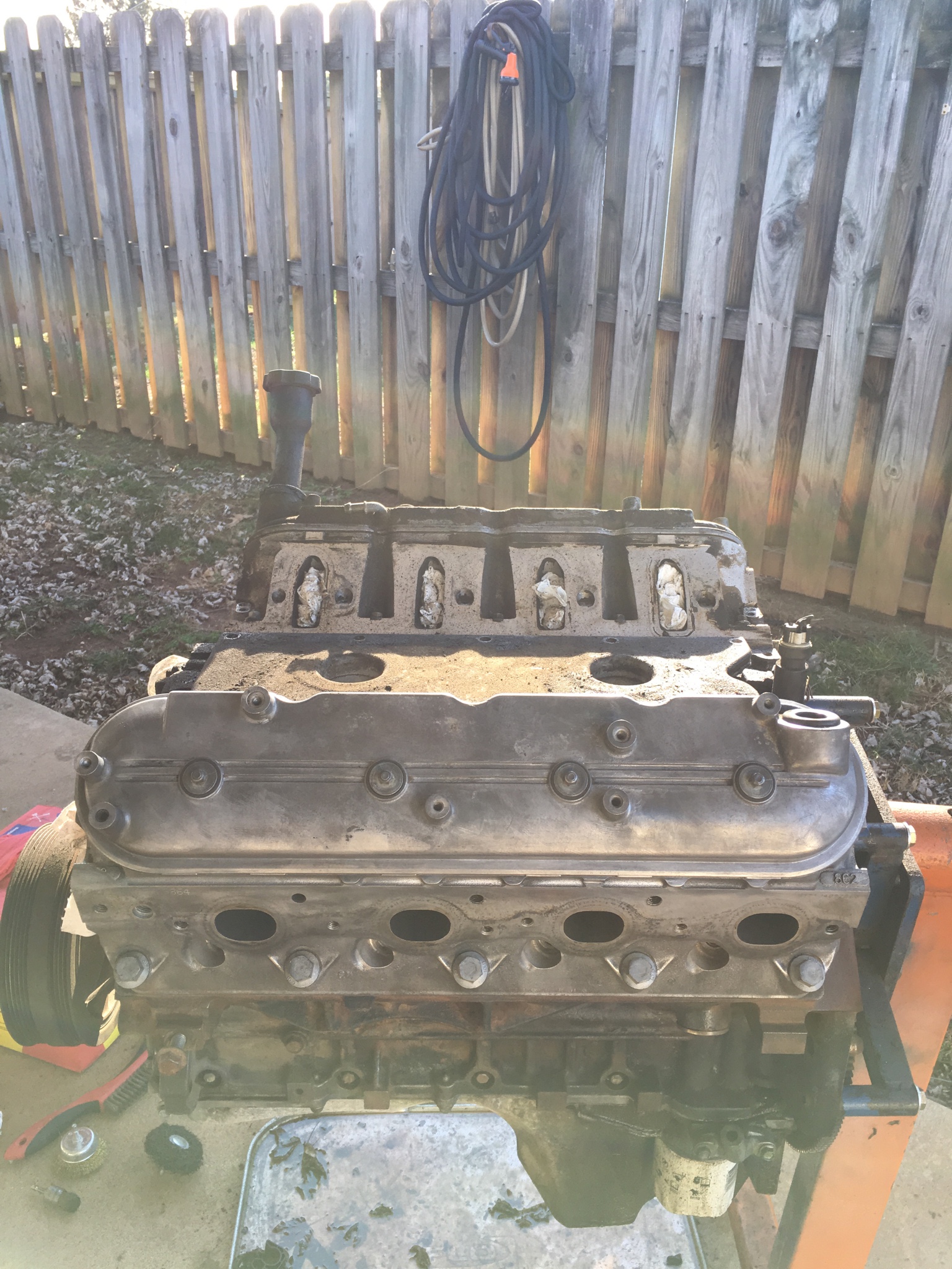

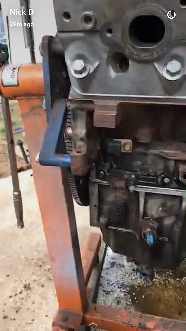

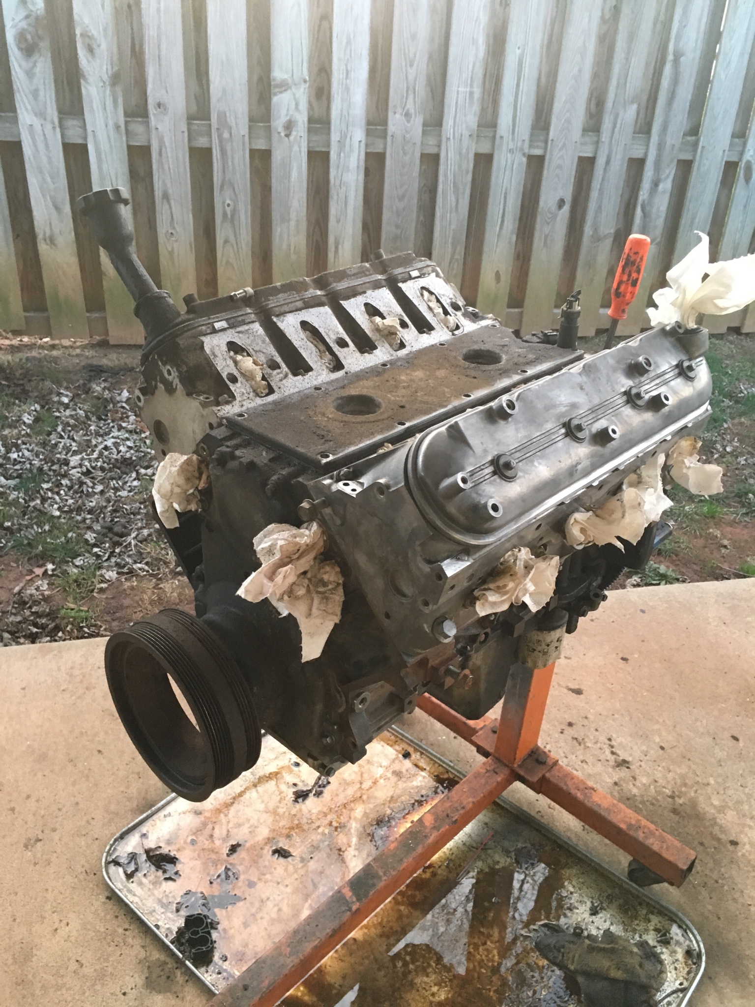

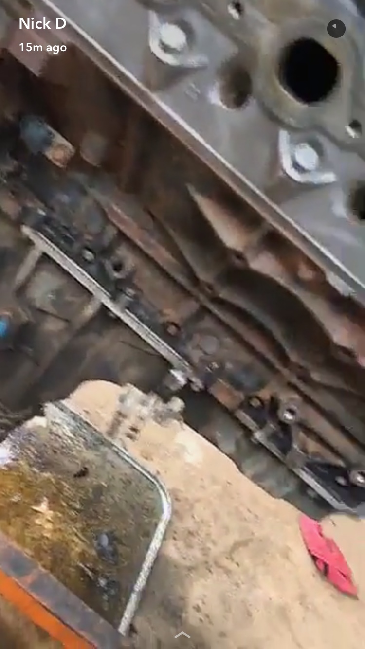

Took advantage of some warm days here and with the help of some friends got the engine tore down and broken exhaust manifold bolts removed from the head. Excited to get cleaning and painting!
So it's not just me then. I wonder sometimes if those bolts are preset to break at 40k miles like clockwork.
Idk. This engine is 70k. The rear bolts are factory broke off so I've been told. But the driver side I had two bolts snap clean off. Most of the bolts I had to use a impact to get off. Welding on washers and nuts went really smooth and came out clean

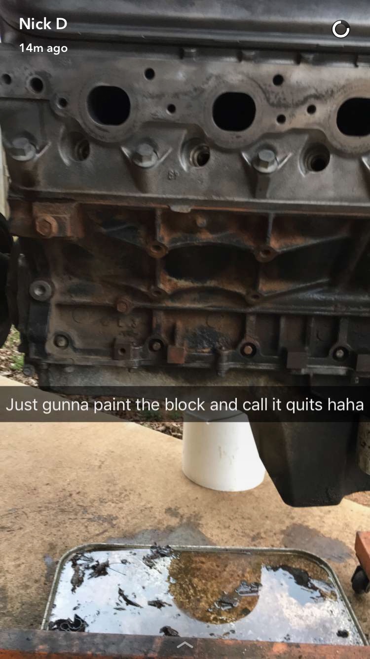

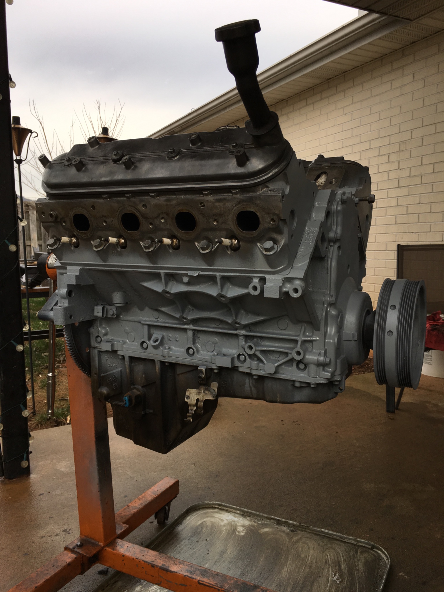

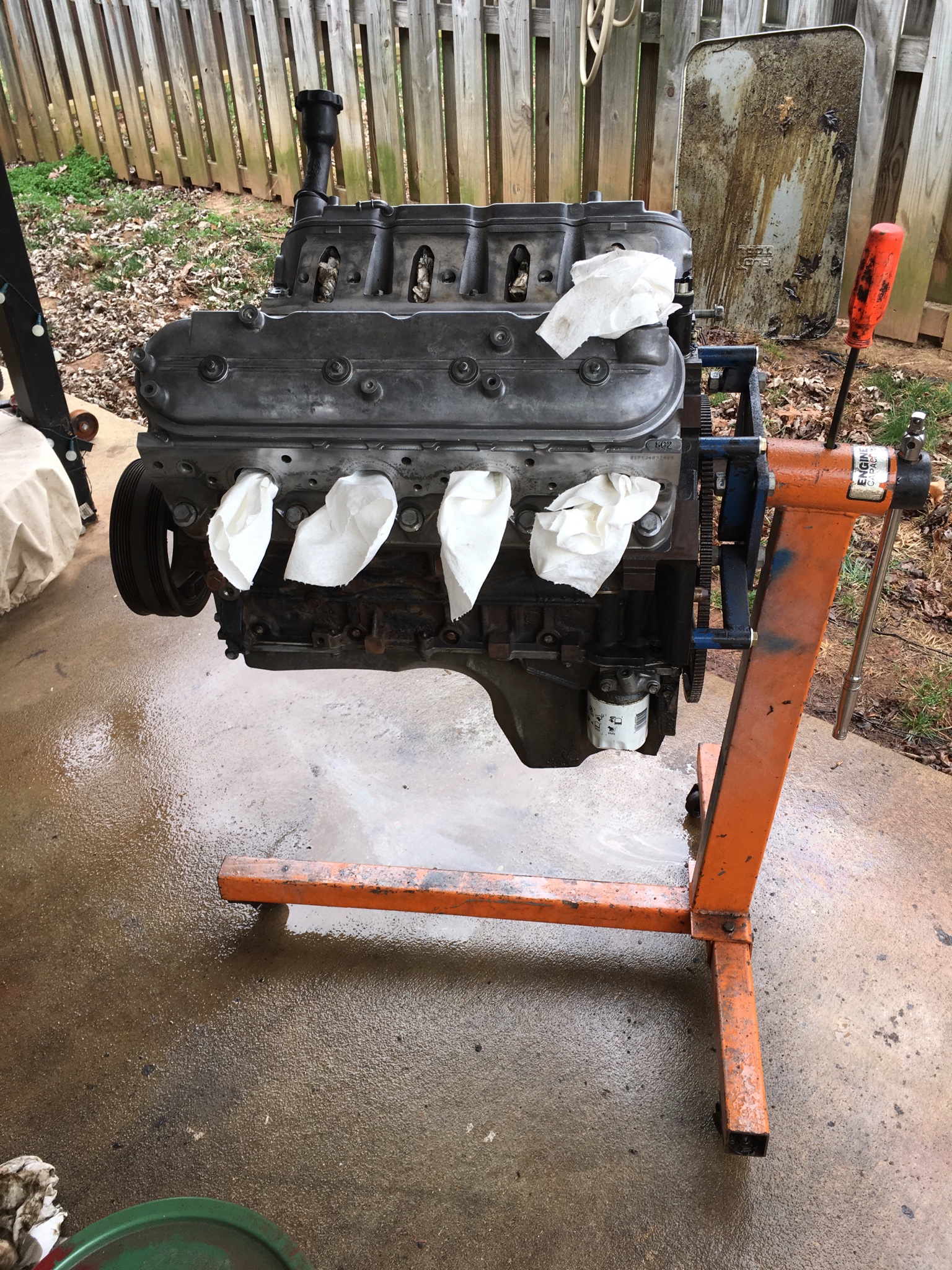

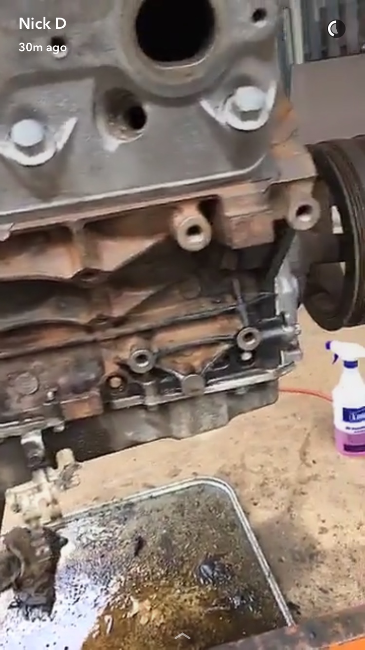

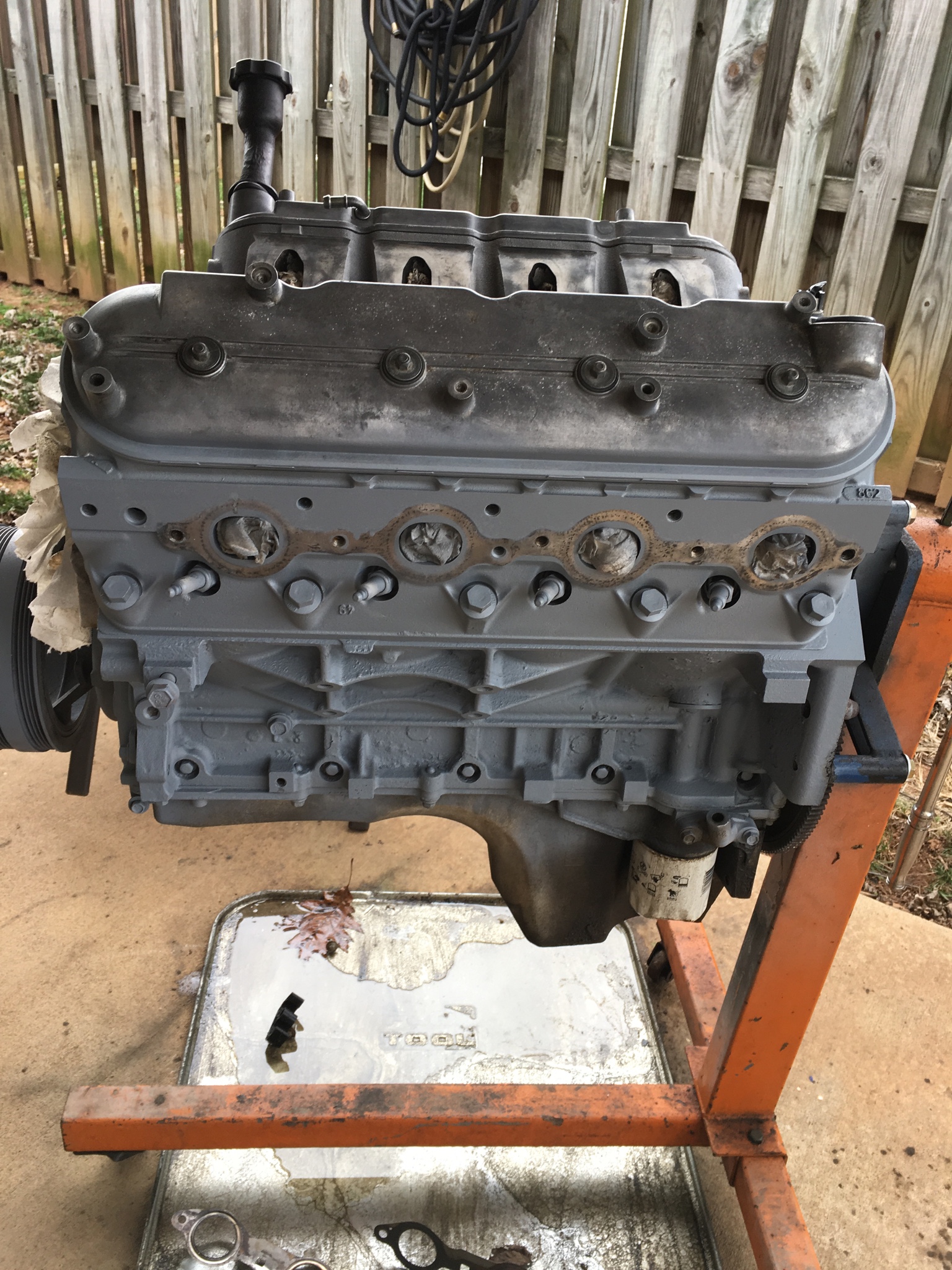

Cleaned up the other head and other side of block. Took a stab at the timing chain cover. Hard to get everything with the main pulley in the way. Gunna go buy a case of brake cleaner and just try and get every bit of sludge of then paint and let it go. Time to get this thing installed! Lmao. Taking too long cleaning.
Oh and painted the valley cover!
Gunna need to replace that gasket and the water pump gaskets. Want to open it up and verify it's still good.

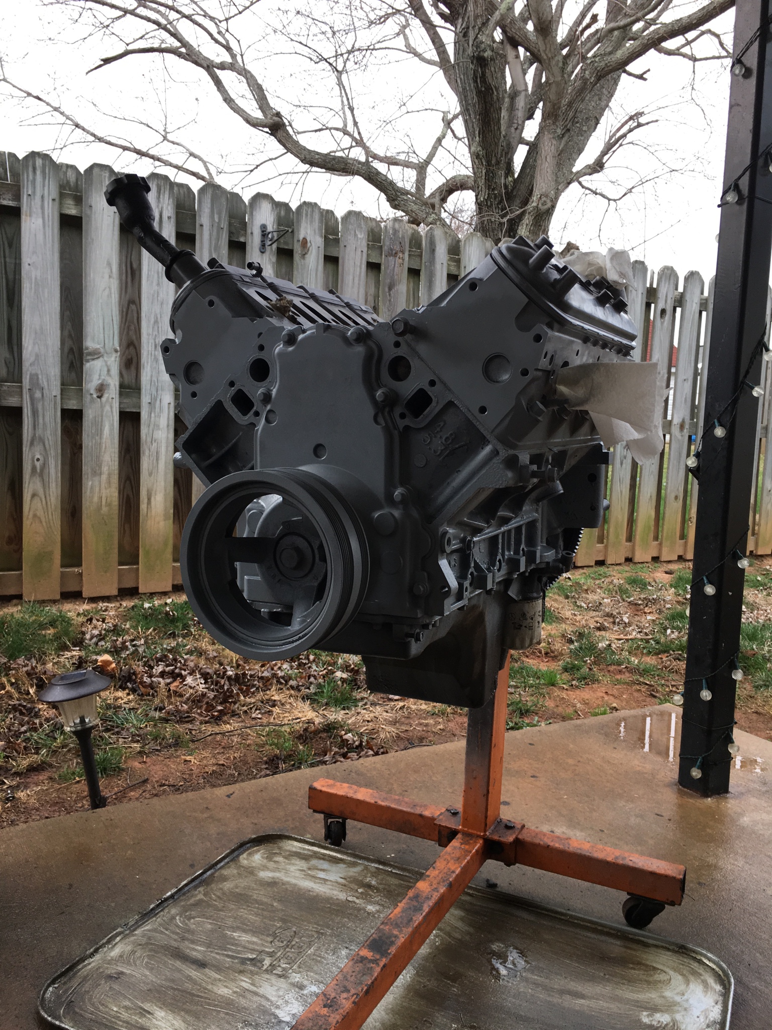

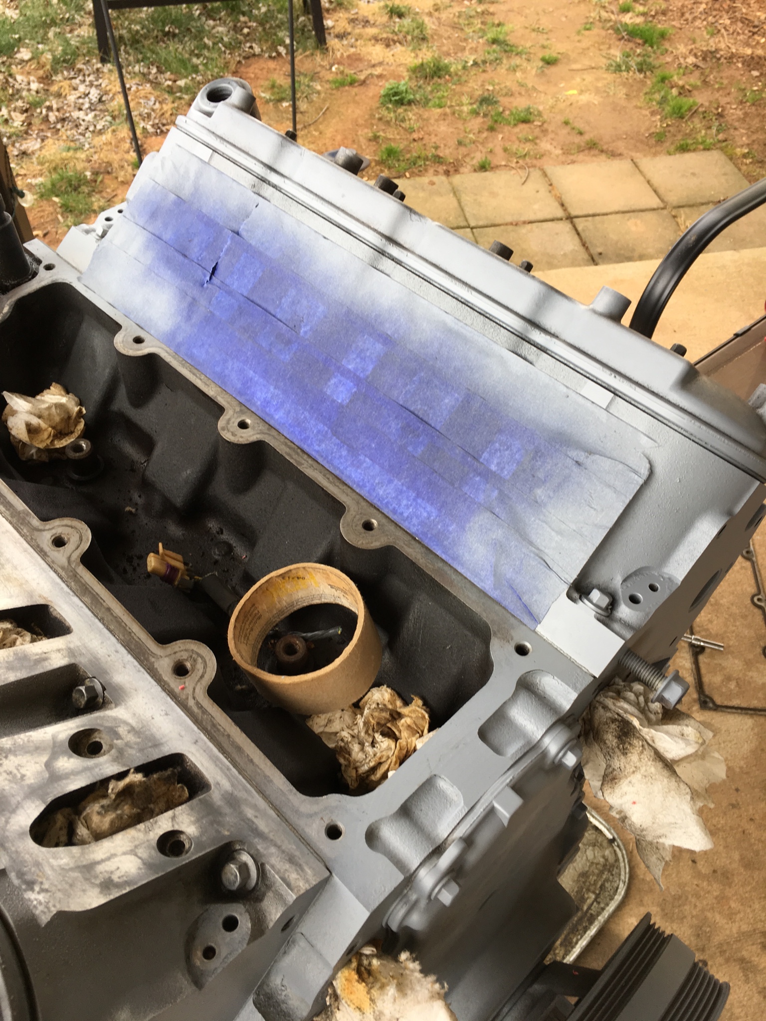

Did a final degreasing and then primed the block. Need to tape off the head and prime the head next. Then time to paint!!!!
Decided not to go bare metal heads. The aluminum was just too grimed up and I'm tired of wasting precious time on anal aesthetics. Haha.
