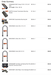

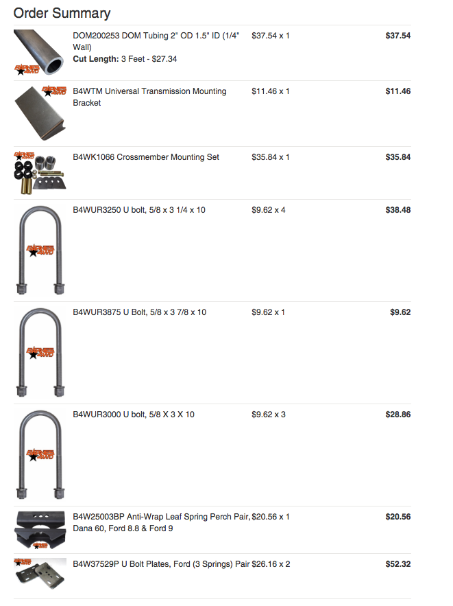

Ubolts. Perches. Plates. And crossmember kit. The tubing is super heavy duty! More so than the one ton steering kit. Woah!

Barnes is never a disappointment when it comes to tubing. I've ran it for years and it's stout!. :beer:
