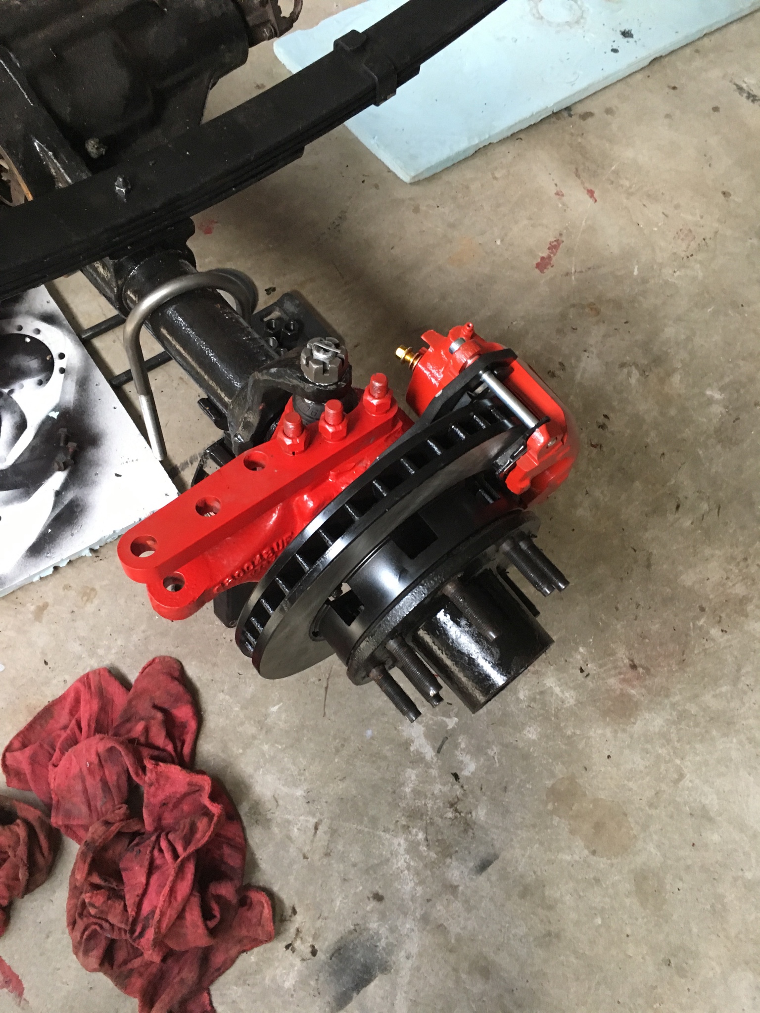

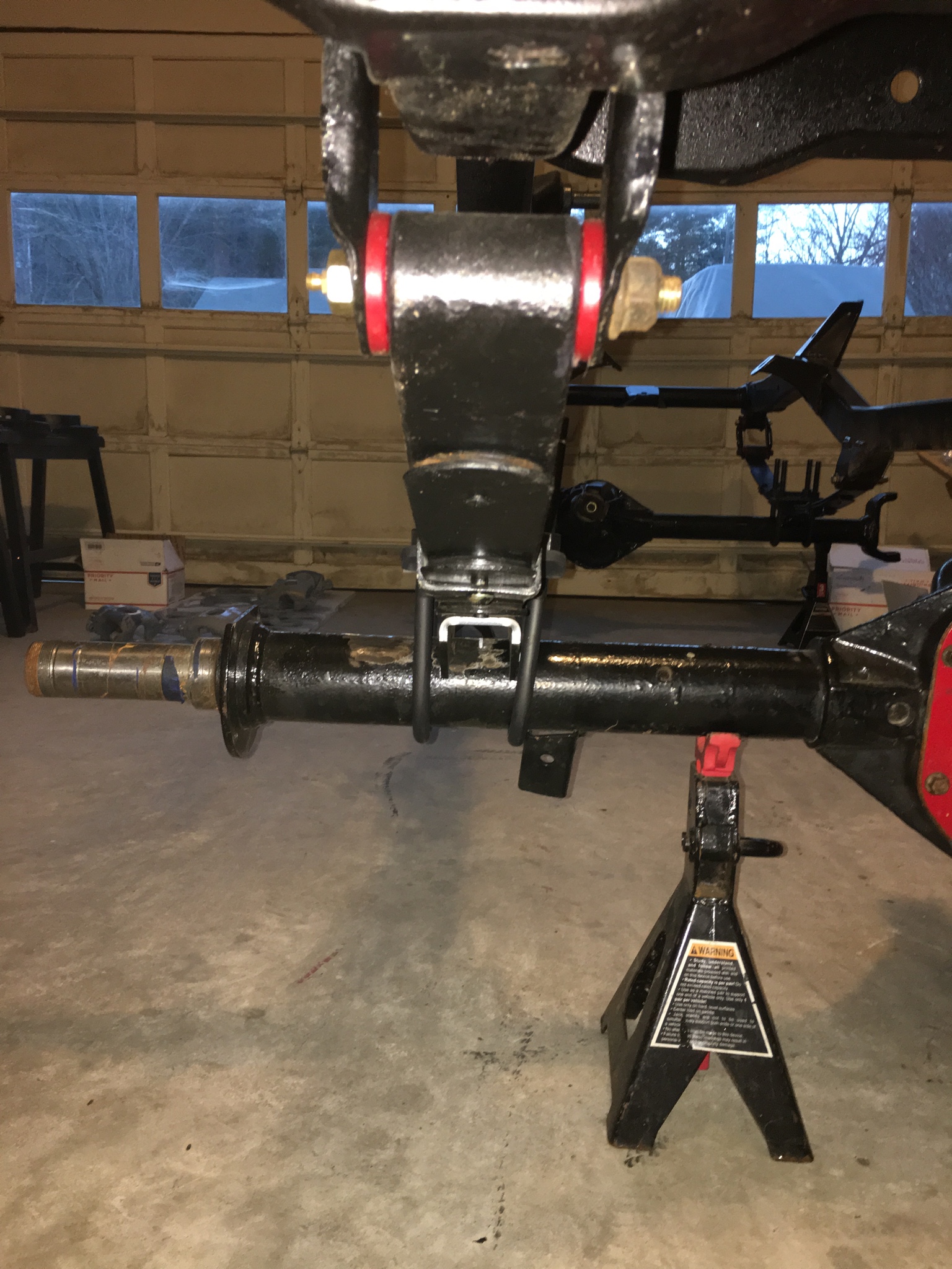

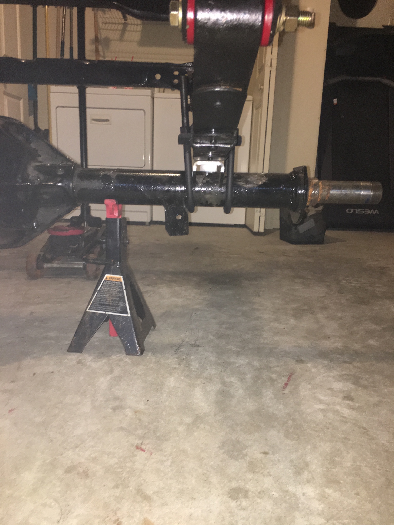

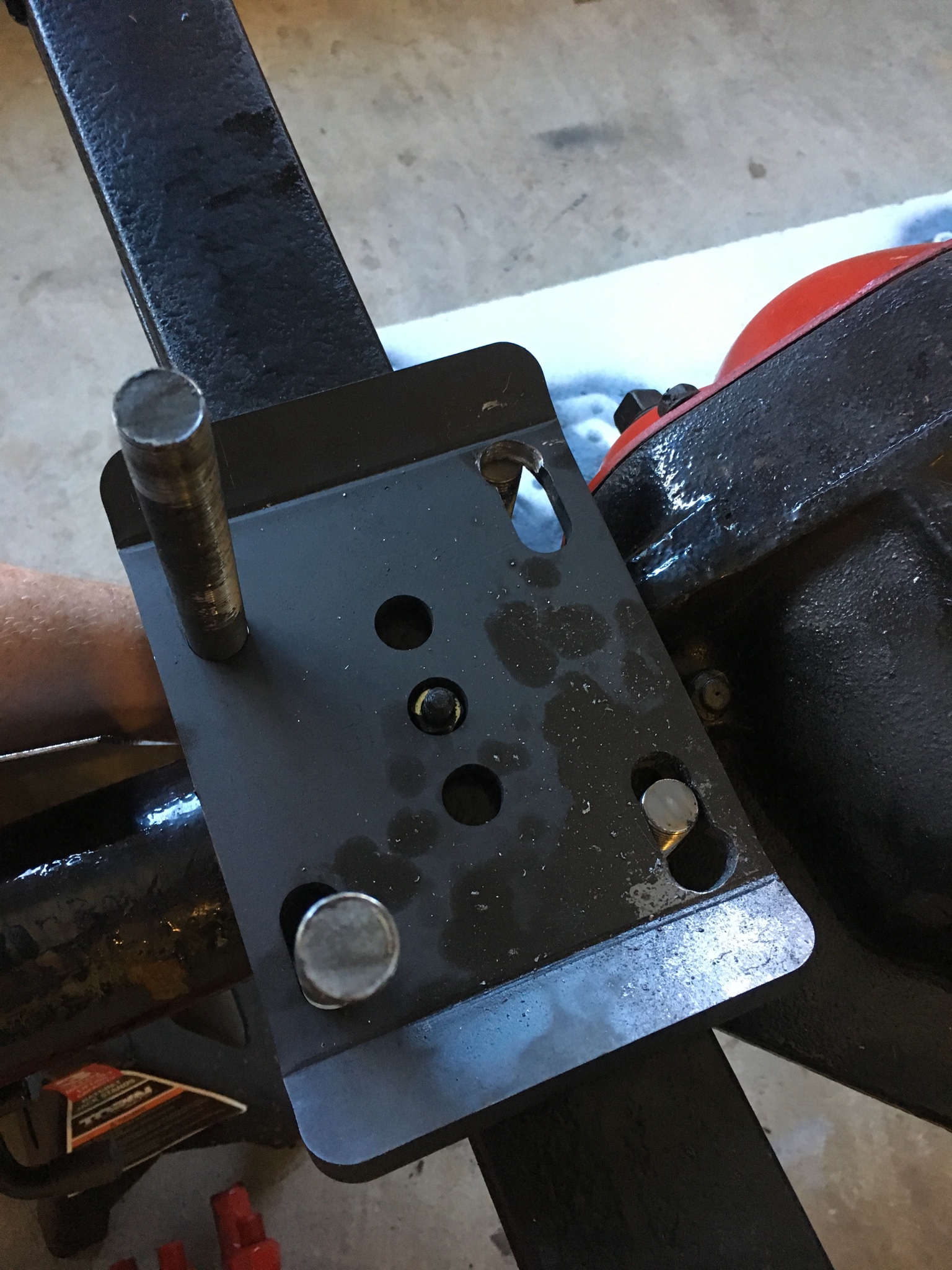

I have planned all along to use the stock d60 shock mounts. Well didn't realize how much the perches had to come in. With the perches at the exact YJ length you can see where the one ubolt is cocked. It's like this on both sides.
Gotta decided to either leave it like this or move the perches over a half inch on both sides (would then match front perch span too). In that case would just have the goofy cockeyed shackles or I could order some offset shackles eventually to help a little.
I WILL NOT be outboarding the main eye hangars. No one mention this. My stupid ADD light DOES NOT need to go off right now. I got a deadline to meet lmao
