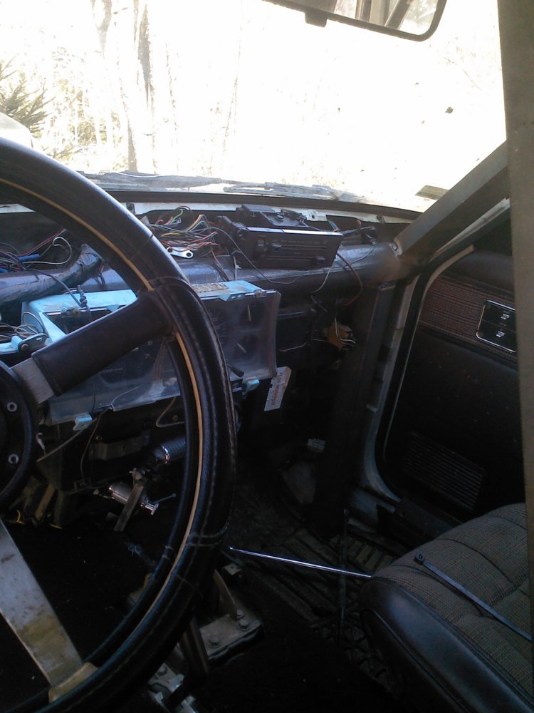

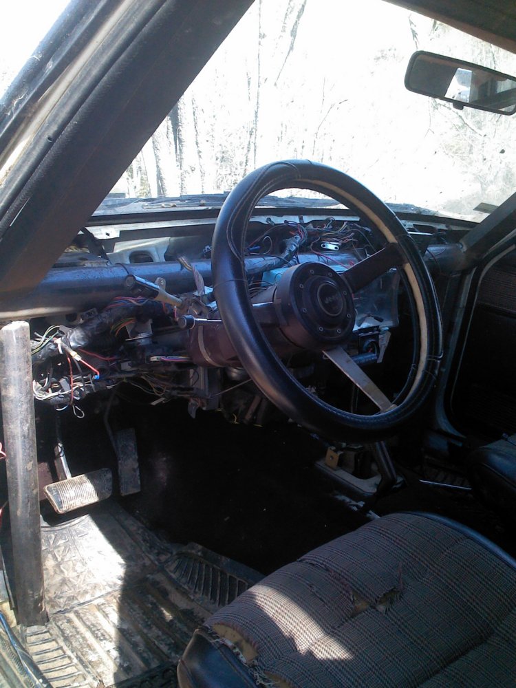

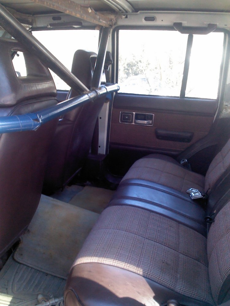

    i guess you forgot all my stuff gets welded in not bolted...those 8"c-channel plates are welded in all the way around to the unibody rails then they are tied together along the bottom with another plate.
    you and anyone else who says you can't do nothing safe with 110v welder....you need to go back to welding school i guess cause if there's one thing i DO KNOW is how to weld to the XJ unibody and how to weld with this welder and my welds is probably the only "good" and "proper" thing, lol, that i have going for me. My welds have never ever given or broke or let go. (the winch bumper i did for friend got put to some pretty intense testing recently and he even was telling me he had his doubts for holding but never gave and he was maxing out the 12,000lb winch pulling some heavy crap up some incline.
    I've been welding with 110v all my life and for stuff up to 5/16 it burns more than enough but is also very very easy to weld to the smaller sheet metal on floor pans/rockers/rails without putting holes in it.
    might benefit you to pay attention in other posts/threads brah....my wife and daughter choose to not ride on anything outside of greens (my daughter does like Easy St though lol) and I wouldn't ever let them ride up anything steeper than Easy St either. You talk "safety" so much........SHOW ME IN THE LAST 3YEARS WHERE ONE OF MY JEEP BUILDS HAS FAILED ME AND CAUSED HARM TO ME OR ANYONE AROUND ME. if I had the money for it, I would roll this pile of metal along with another xj with "worthy" cage down 500ft drop and still put my money on mine...why? cause i know how to weld what i know and what i do and my cage might be from scrap pieces of thick metals but i know it will hold and get the job done and then some.

    Is the back to support on your cage flat plate?

    Horizontal top piece of your cage at the back of cargo area near your rear latch

    this is all I have for now but the cage isn't done by far...i still gotta buy some more sch40 stuff to add in few longer pieces in back seat area down to the rock sliders and other places to tie it in together better and do a X across the ceiling but it's all i've had time for so far...and now were moving so def can't finish it yet...speaking of which gotta go...so much work packing and still have jobs to do here back seat area.jpg passenger dash.jpg steering area.jpg

    no its a 4"angle iron 1/4" thick piece i had and fit it up there to have more room to weld those pipes to...pictures don't show everything but if you saw it all up close, it's plenty sturdy for layover and will "hold up" to a roll....now sure it might give a little here and there in it's current state without further support but hey, isn't something better than nothing....well anyway for me its plenty so far and I'm happy with it so far until I add to it and brace it completely. adios off to work

    All i was gonna say is if it was flat plate it will bend easier then you think and it really needs a vertical piece under it to help with bending

    Please tell me you're not making anything related to a cage out of water pipe...

    Don't even get into it. It's not worth it. Dude is actually delusional enough to think his cage should pass tech, and you're not going to convince him otherwise. He doesn't understand that "something is better than nothing" until it shatters apart and sends junks of jagged poop pipe at your helmetless head. Don't bother with him. Ain't worth it.

    Not defending him but a guy built a whole bouncer out of sch. 40 and did decent in the series before selling it

    Yeah I'll have to say, Stump built a while Toyota truggy out of schedule 40 pipe. Now we all know how he drives. My buddy actually bought that truck and rolled it a few times. It works, it just dents easy. BUT... That was with proper triangulation and good notches throughout the rig.

    I don't know really anything about offroad racing of that type, but I'm surprised the sanctioning body let him run a sch40 safety cell, or that there aren't rules that specify using proper tubing for the main safety cell...
    I know people make stuff from it all the time, but I'm not trusting my safety with it because it's not rated, designed, or specified for things like that. It will probably be fine for mild rollovers, etc., but when you roll off a hillside, etc., things change very fast. Given the minor price difference between Schd40 and actual rated tubing, why not use the tubing? I'd maybe use sch40 for subframes, sliders, whatever, if I didn't care about the weight, but I'm not using it for a roll cage. Again though, decent tubing is barely more money...
    Ladder racks, that's what it's for. It's perfect for that if you're just looking for cheap. And staircase railings.
    Wait, what am I saying though...? People can't even triangulate or properly tie a cage together with the vehicle, so why does the choice of tubing matter at all?
    There's the whole "it's better than nothing" argument, and that's somewhat valid. I'd rather have marginal sch40 protection than nothing at all. But there's also the "if it's worth doing, it's worth doing right" argument too.
