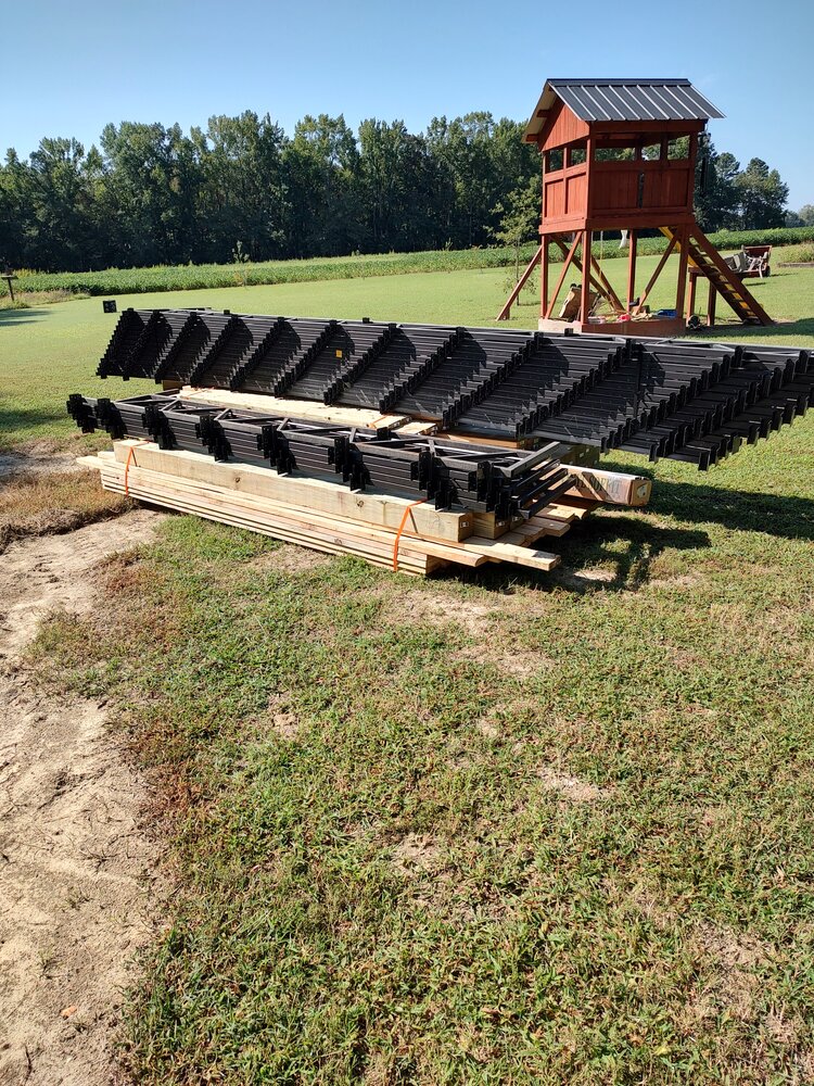

Package being delivered today. Should start coming out of the ground tomorrow before lunch. Ive been told that its going to hurt my feelings to know how much I'm paying to have it built when I actually see how quickly it goes together.

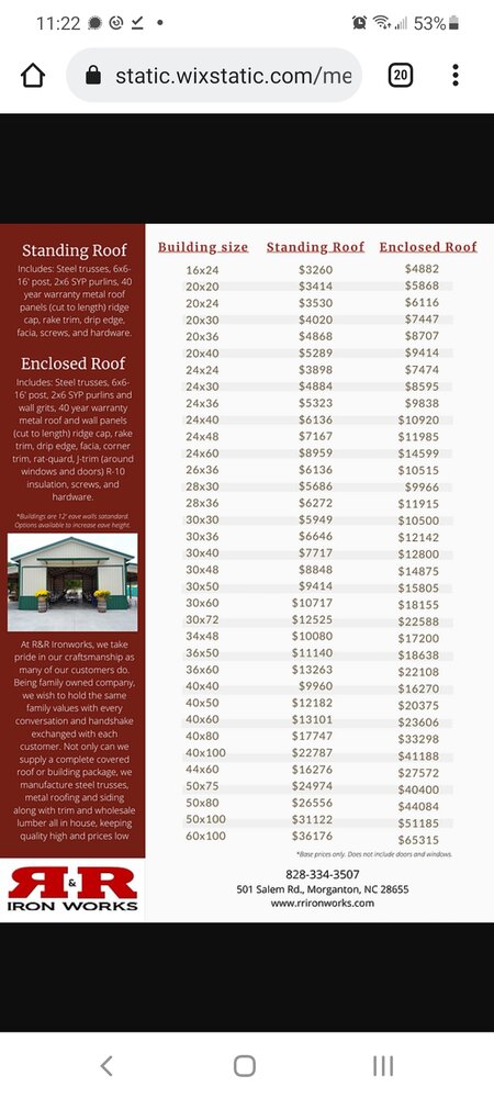

Who did you go with? Size price? if you don't mind sharing. Are you doing wet sets?
Builders discount. 40x50, 14' eave, 12x40 lean to. 3 insulated wind rated garage doors, bubble wrap foil backed insulation. Right at 30 for the package.

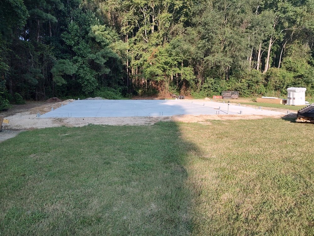

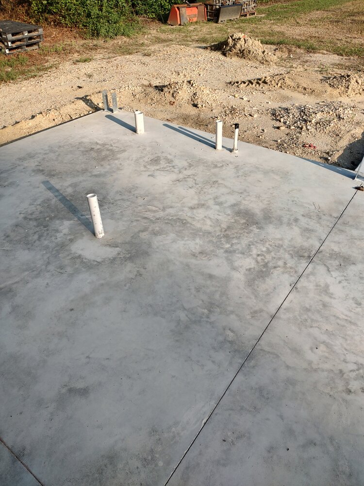

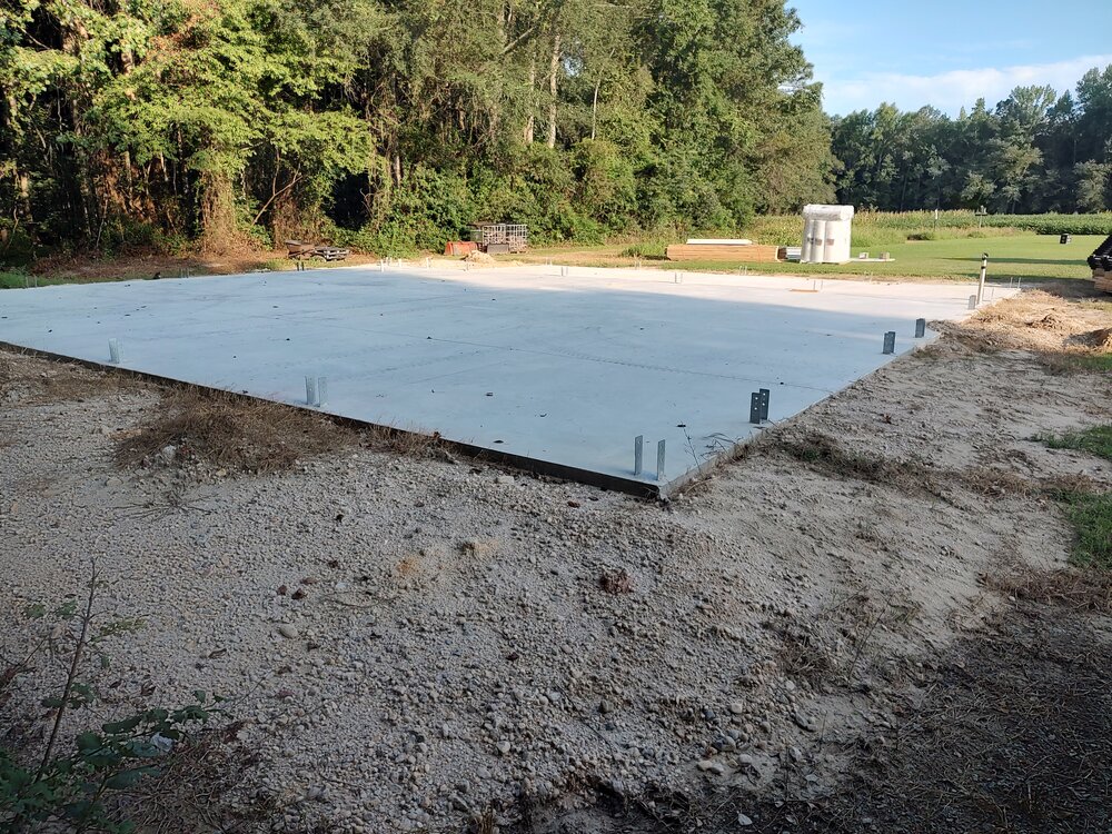

Yes, I did wetsets. I don't trust wood in the ground around here. I get termites in my mulch pile. I thought I had a picture of my slab but apparently not. I'll take one when I get home
Wheres your floor drain?
Didn't want one. A drain without slope leading to it is useless, and I didn't want my floor sloped. It would just stay full of dirt and random trash. The only time a drain would be somewhat useful for me would be when cleaning deer. I've got a big tub that I use to catch guts and blood and it works fine.
