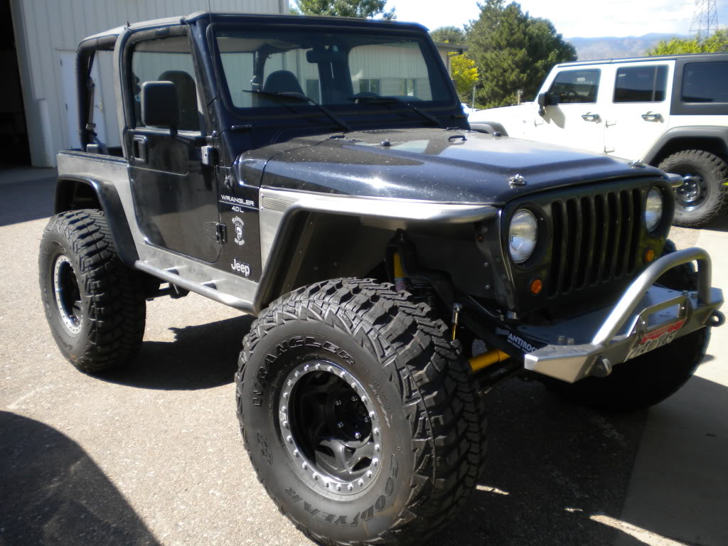

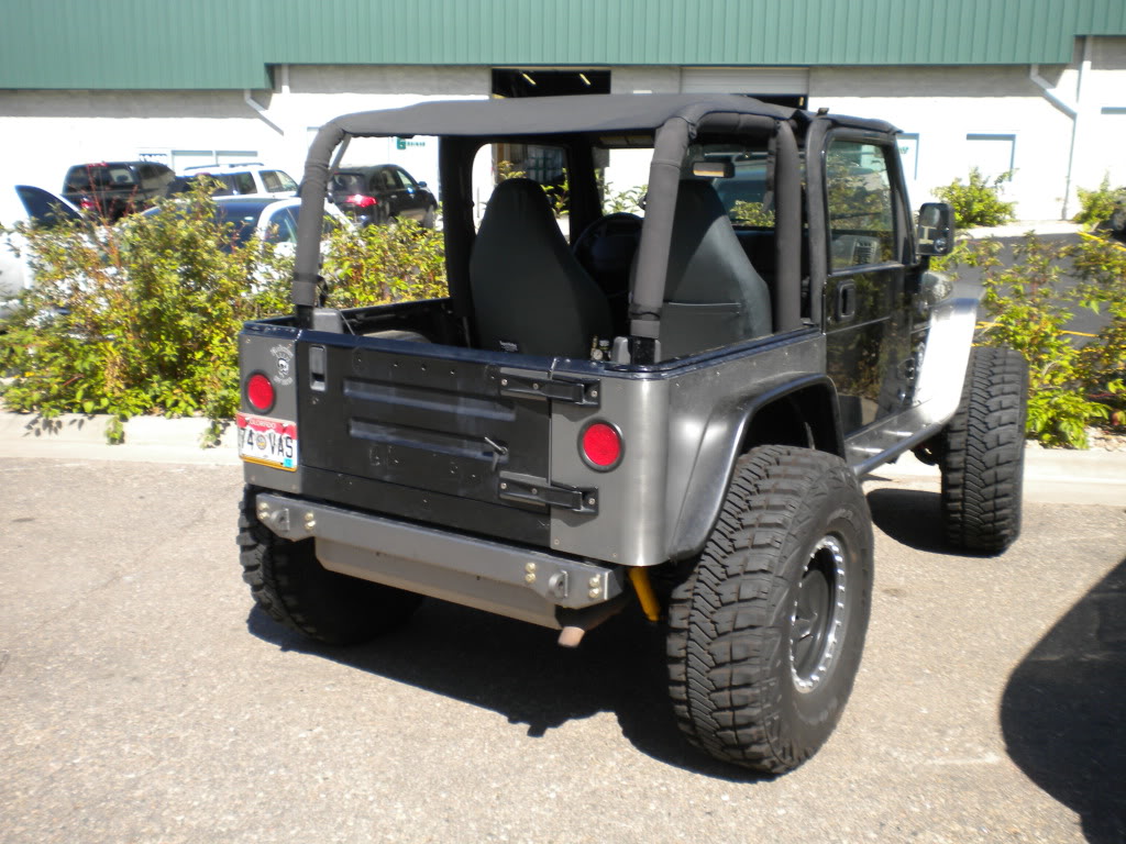

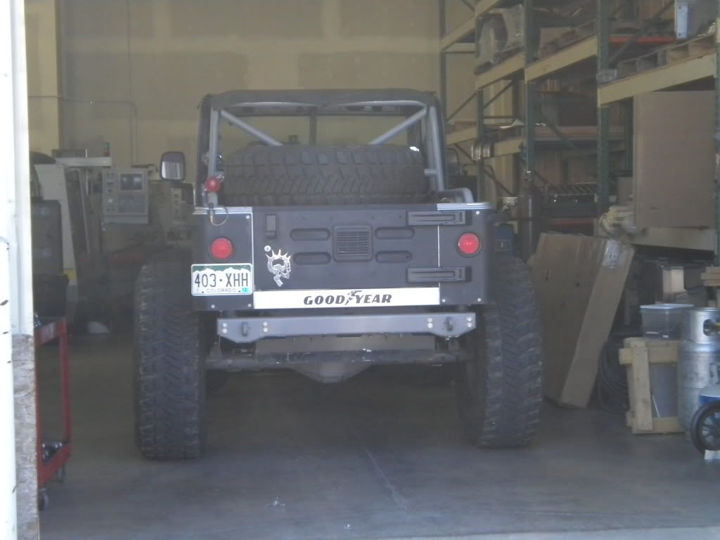

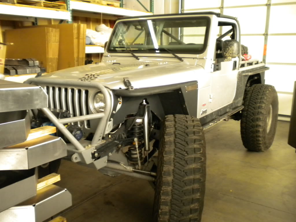

i haven't gotten any work done this week because i've been in denver, colorado. while i was out there i stopped by Rokmen Offroad and met part owner, Dave. Talk about a super guy! i got to check out the original "freak" and their newest creation "niblet". I got some great ideas and just had a blast talking with Dave about jeeps. couple pics for ya.
Rokmen "freak"
another.
Rokmen "niblet"
another. those hyline fenders and armor are clearcoated steel. talk about COOL!

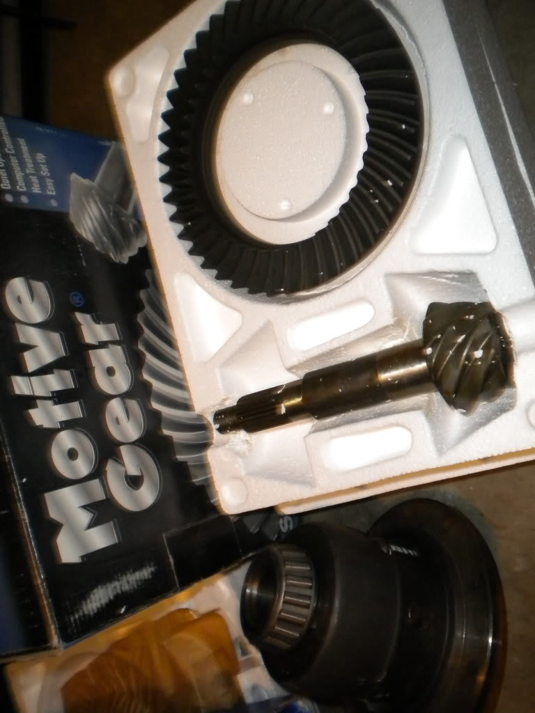

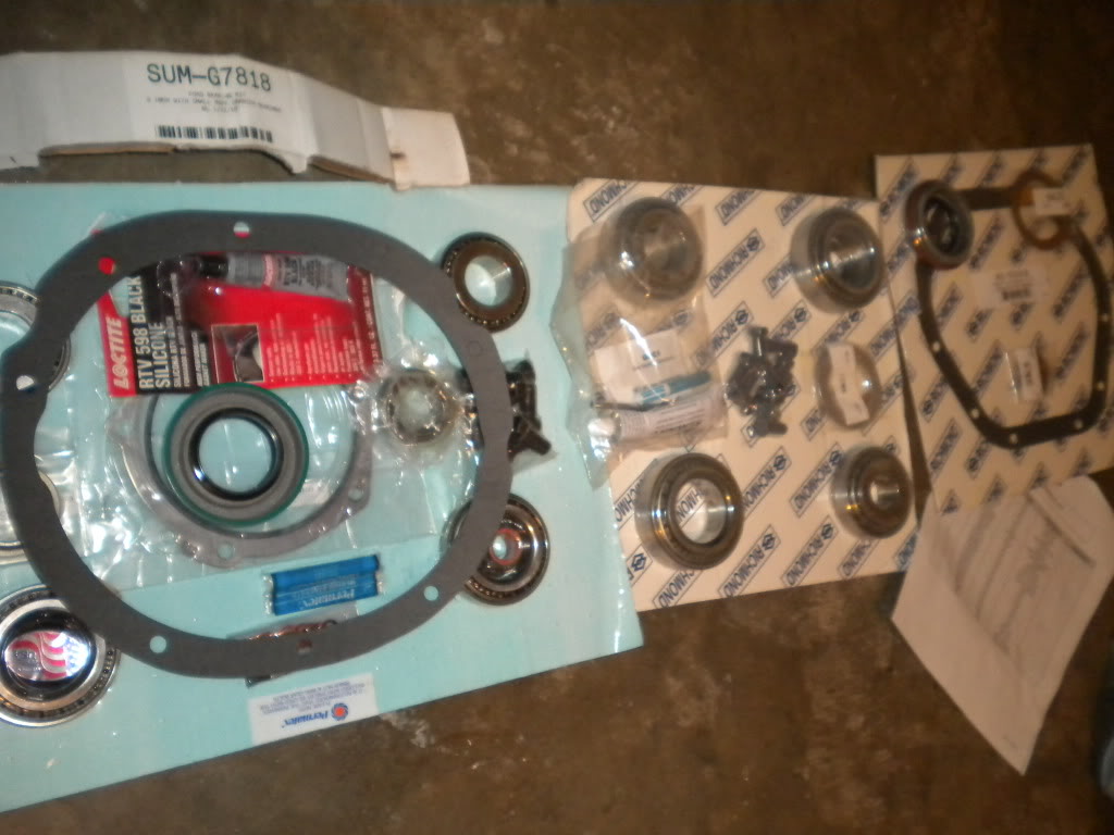

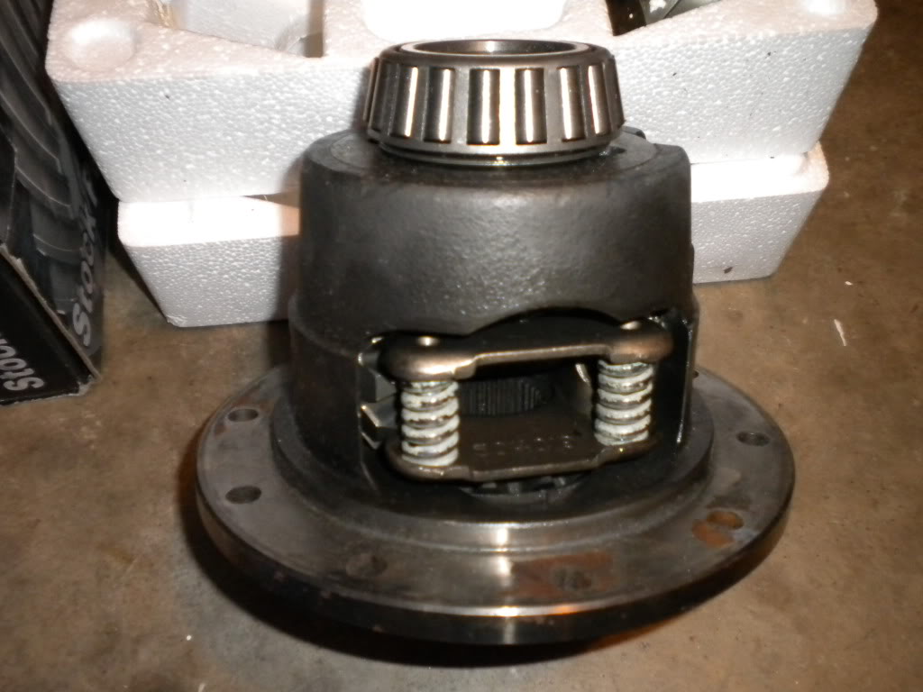

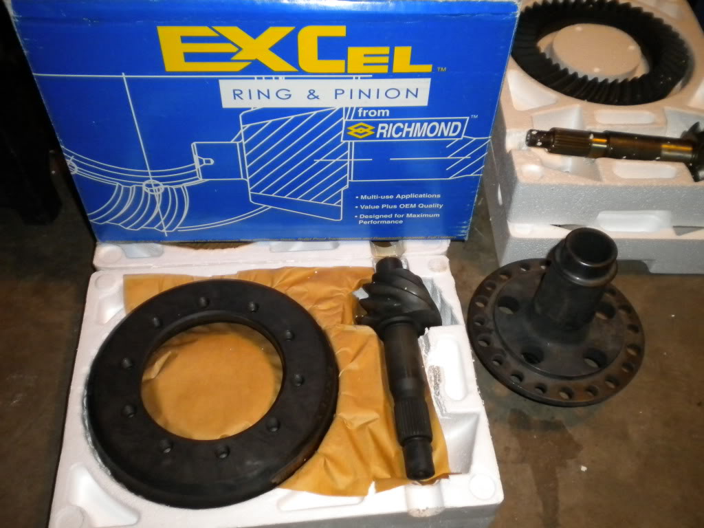

got some shiny parts....well kinda! 5.13 ring and pinions. ford 9" spool and auburn pro front limited slip diff. :)
Still lookin good man!! Cant wait to see this bad boy in action.. I may have missed it, what motor are you throwin in it?
thanks man! i'm planning on a jeep 4.0l, ax15 5spd trans and np231 t-case with SYE as my #1 choice.
i'm also thinking about a 5.0l sbf mass air roller motor from a 89-93 5.0l mustang or tbi or vortec 350.
it all depends on what i can find in the best shape for the best price.

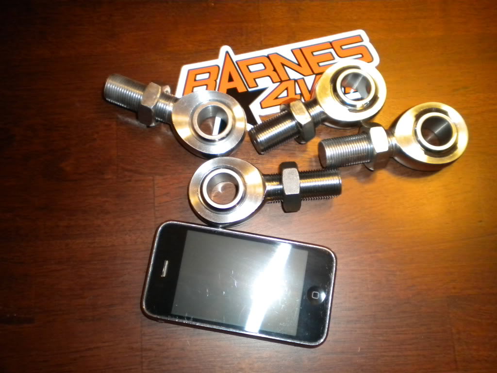

got my parts for the heim steering from barnes 4wd. high quality parts and next day delivery as usual! couldn't speak any better about Brad at Barnes4wd. anyone have a tool

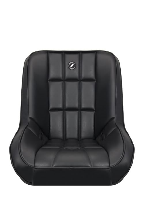

hey guys, i need some help with seats.
I'm looking at 3 different seats.
#1, corbeau baja ss fixed back seats. i am running these in my yj and absolutely love them. they've held up great and are really comfortable when behind the wheel for an extended period of time. i know i like the fit but i was thinking a different style seat might be cool. variety is the spice of life, right?!
#2, corbeau baja ss LOW BACK seats. i think they'll look old school in the jeep when i mount them to the cage (to be built) and will give it a cool old gasser like look or something. i think they'll be comfortable but i'm not too sure how much so without the upper headrests. your opinions? anyone running these? or a similar low back seat? your thoughts. i've really been leaning towards these but don't know if anyone is running them and if they're as comfy as the std baja ss fixed back seats.
#3, i found these hunsaker envy seats on polyperformance's website and they've got a smokin' deal on them but i don't know if they're worth a crap AND apparently Hunsaker is out of business so that makes me wonder why they're out of business?! any thoughts?

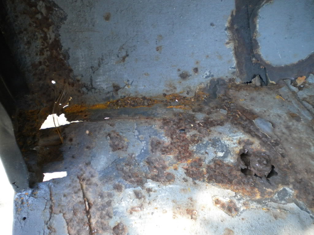

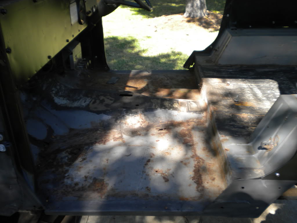

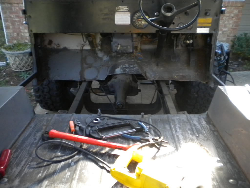

i got busy today. i was awesome weather and it was fun to get back at it. the project i'm working on now is cutting out the old rotten ass floor and replace it and make it stronger so the tub won't flex as much.
what i started with.

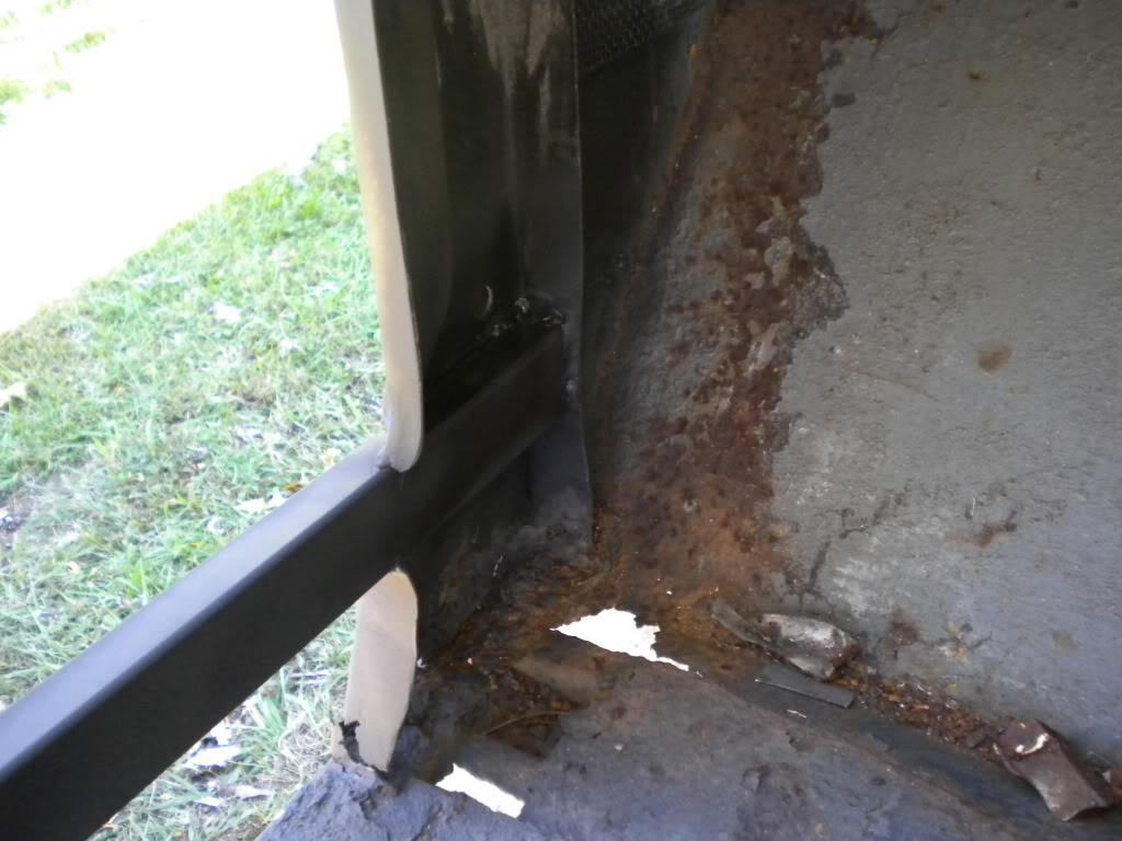

before i cut out the floor i added in some new cross supports to keep the tub from buckling when i cut the floor and sub-floor out. i'm going to keep these in there and i will drill holes so my rock sliders bolt to these cross beams.

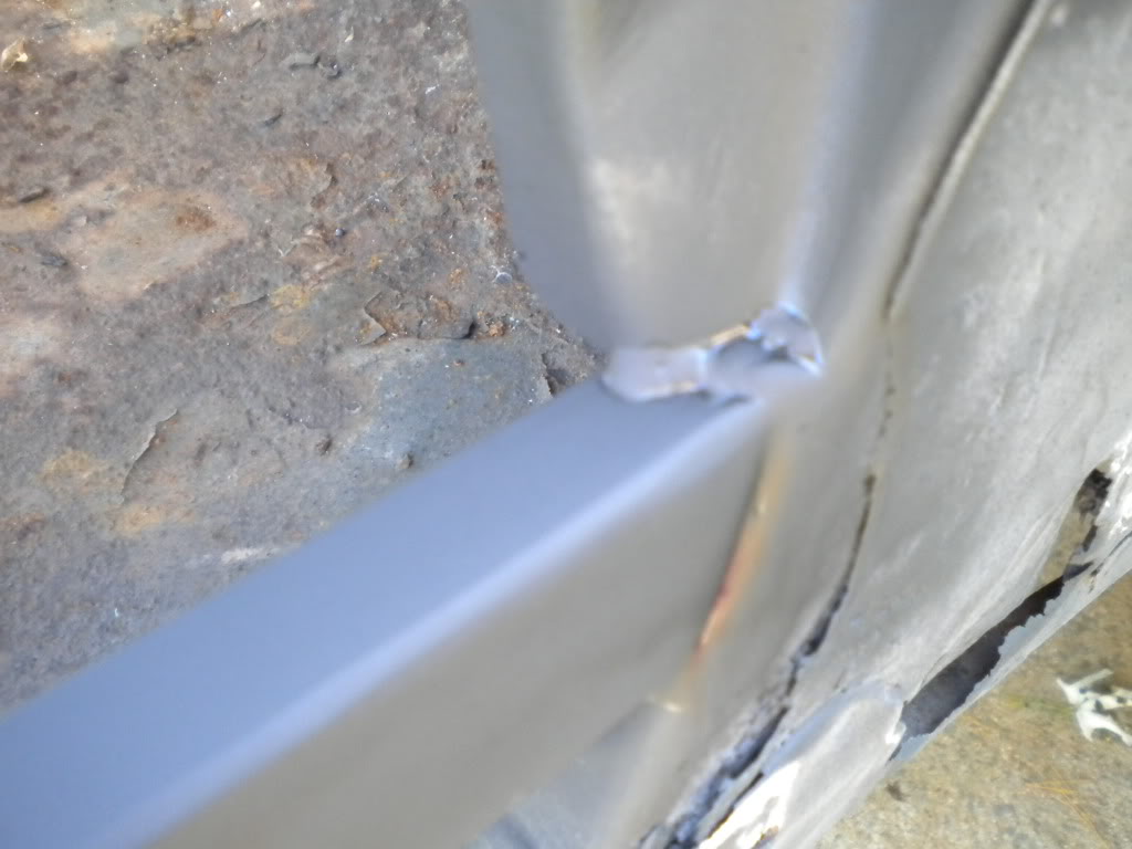

close up. i notched the factory vertical a-pillar support beam and welded it in. it should be stronger than factory for sure.
another.

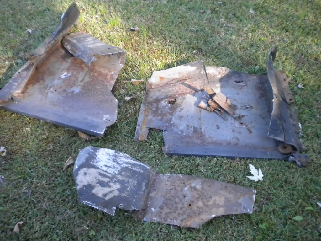

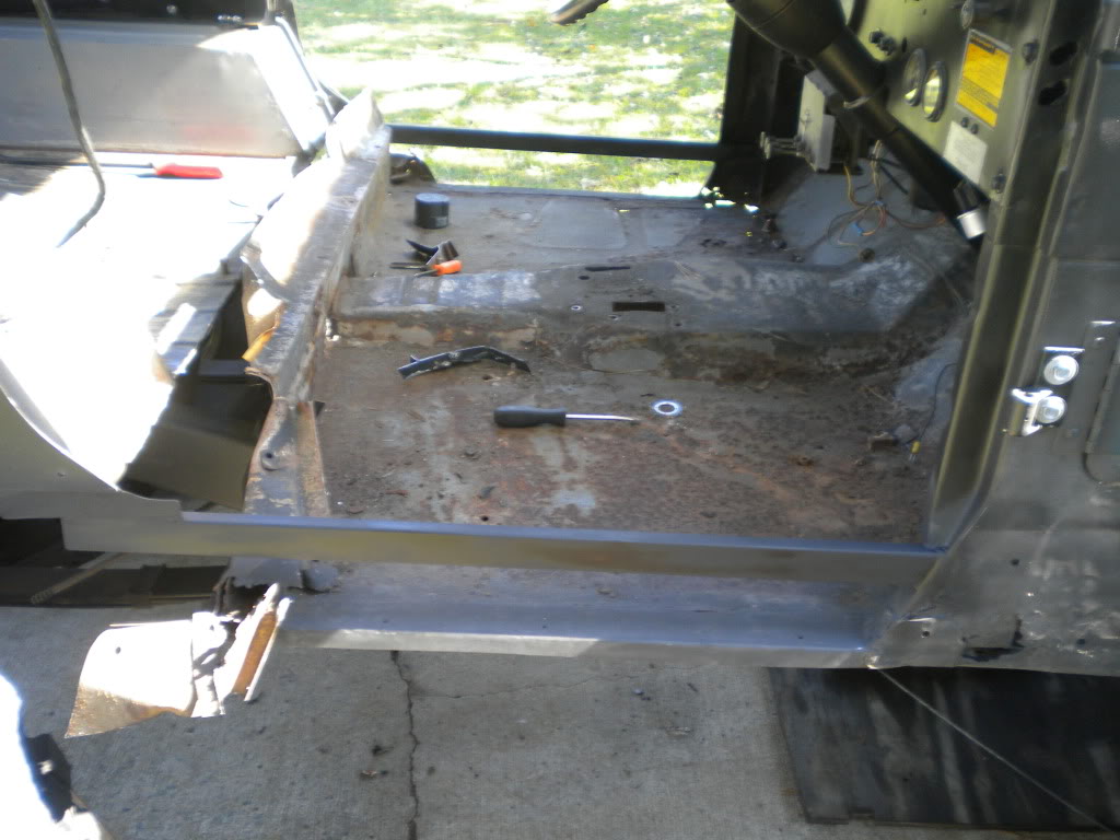

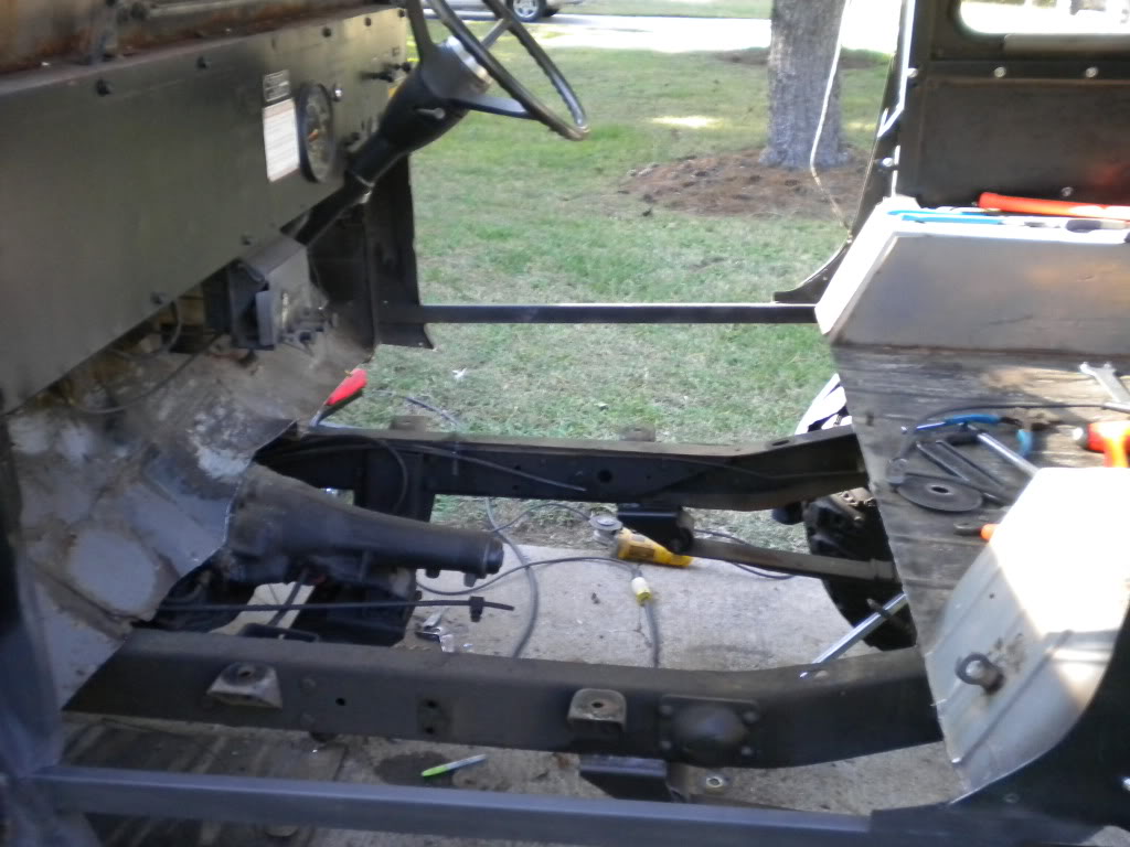

then i put my sawzall and grinder to work. you can see i cut the tub back to the wheel wells. this will give me more room to move my seats back so it's comfy to ride in for long periods of time.

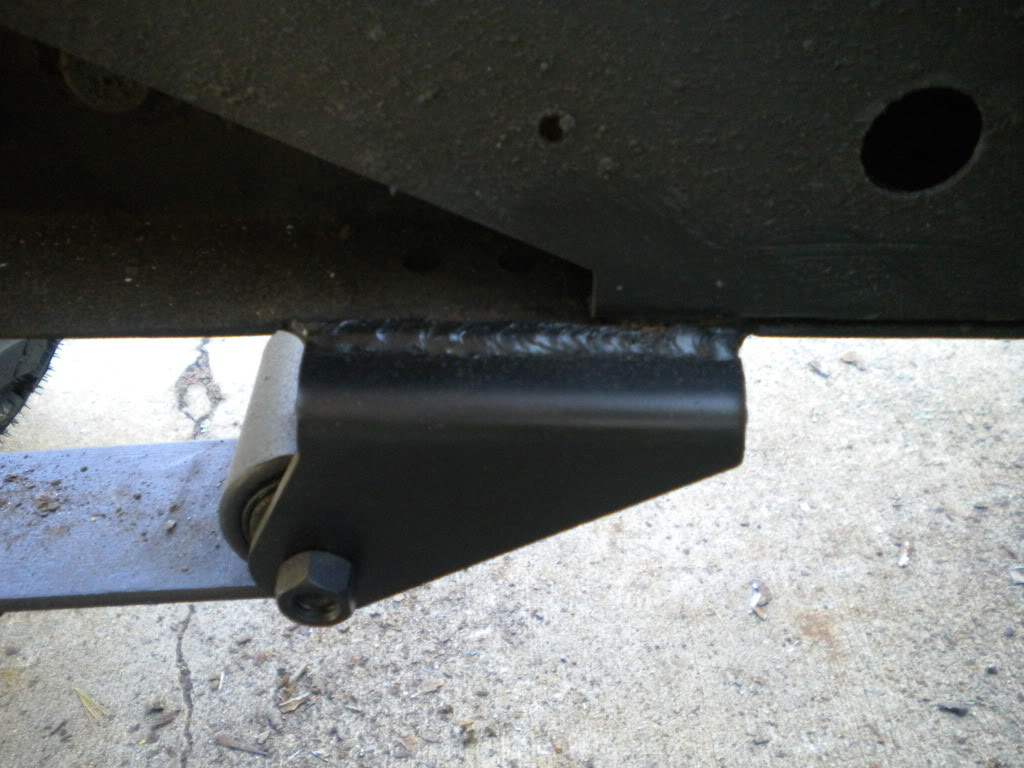

upclose of inner welds on my spring perches that i welded up a few weeks ago.

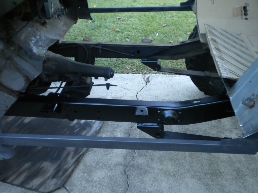

i wirebrushed the frame on one side and hit it with paint. i ran out of time to do the other side. i'll hit it tomorrow.

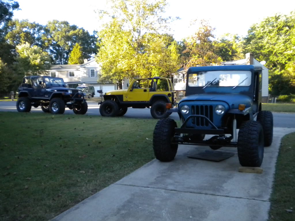

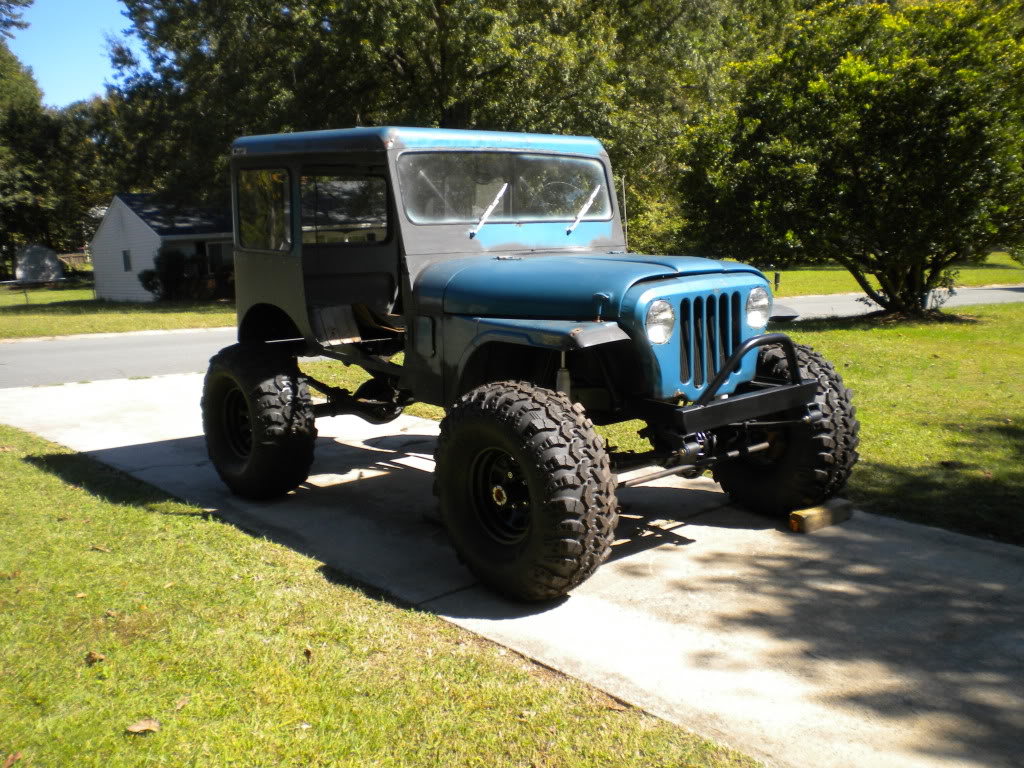

my buddy drove his tj over (reedymsc08) so it was a good photo op.

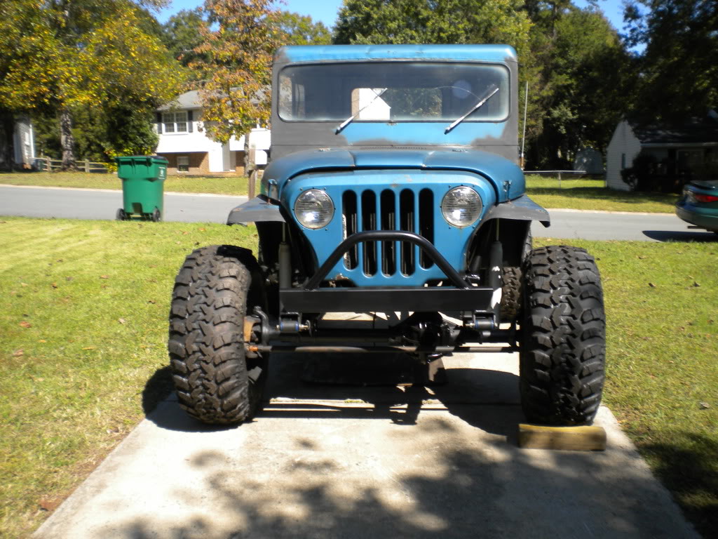

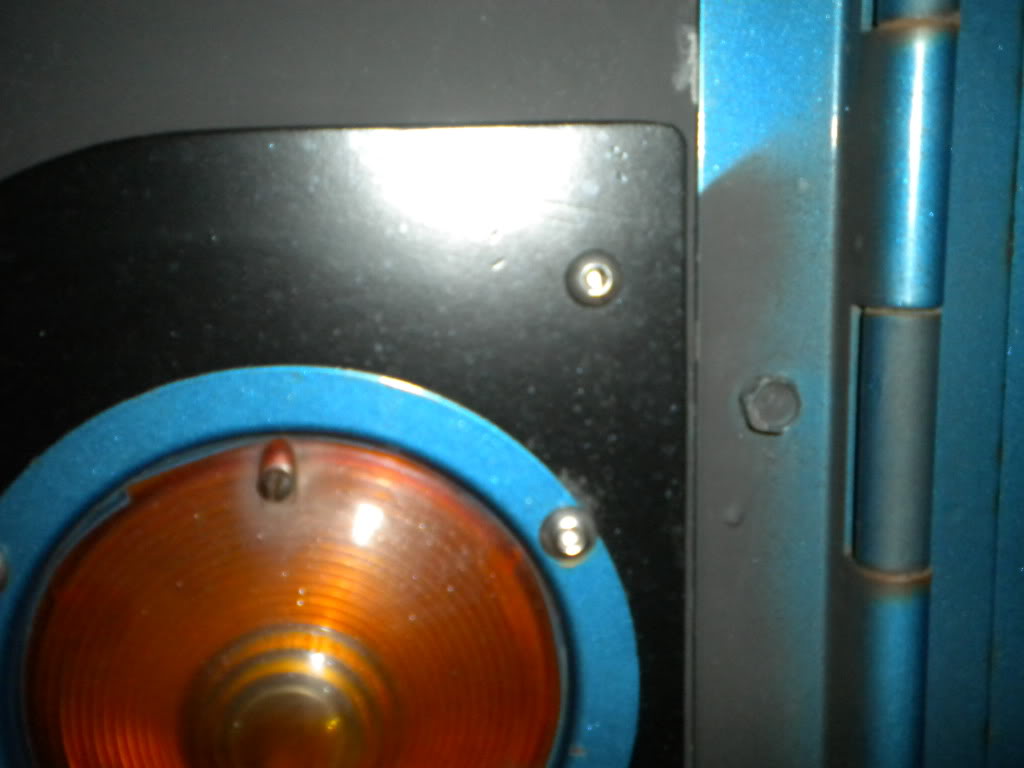

got a little bit more work done. painted the other framerail, removed those goofy turn signal since i figured they would be trail targets.
i also fixed the hood where it was all dented in. couple hammers later and it's back to it normal shape. i tried to adjust the grill since it's sitting crooked but i couldn't do much with it. i'll get it squared up when i get my body bushing kit from polyperformance this week.
i like the look without those big turn signals.

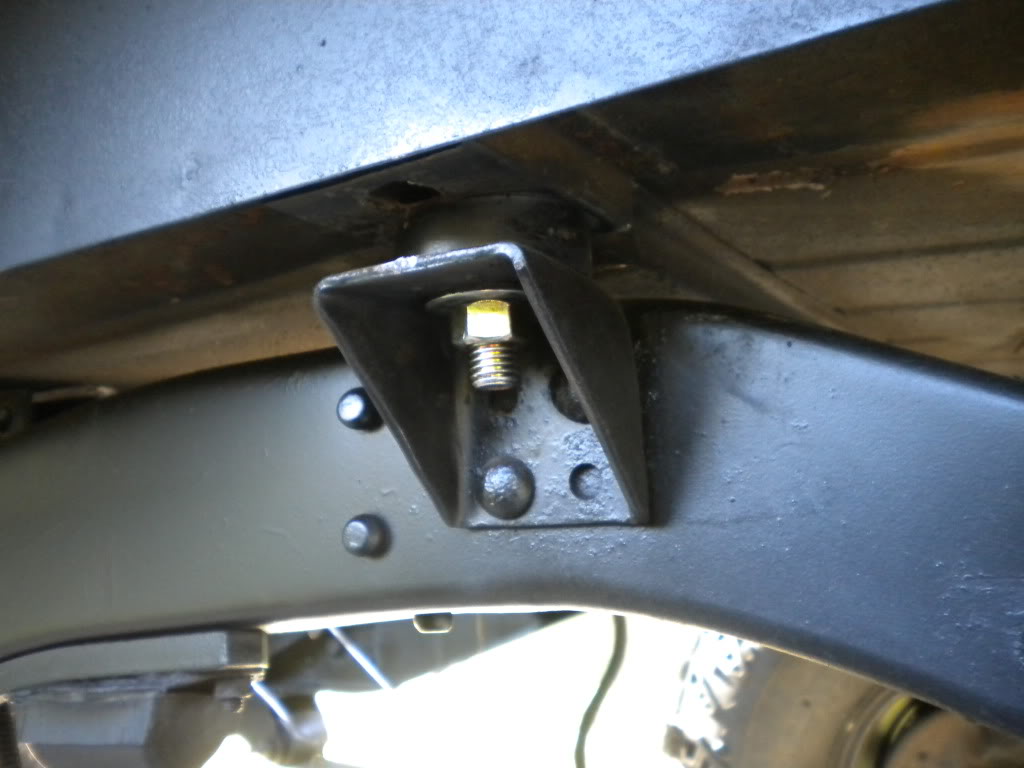

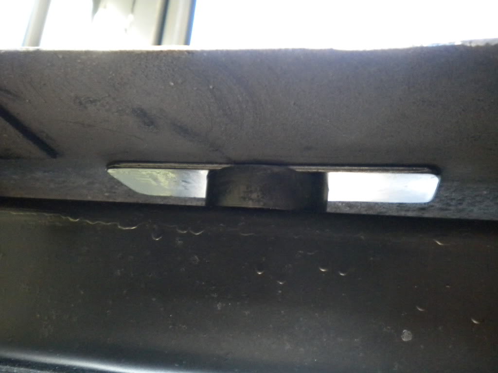

i added an additional body bushing to the crossmember right behind where the seats will be. i added a 3/16" piece of plate to add a little more support to it.
rear tub body mount.

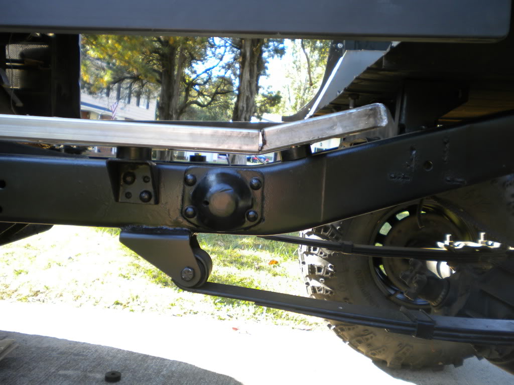

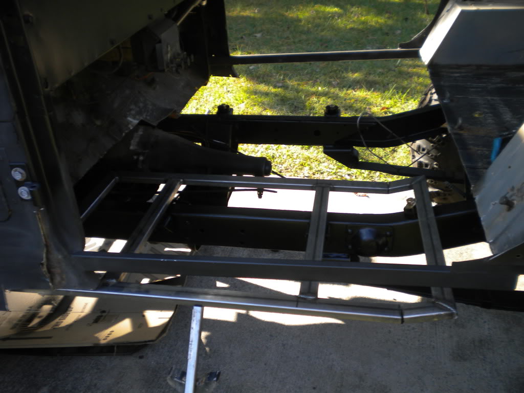

then i formed the .75"x1.50" .83 wall rectangle tubing for my subframe. what do you guys think?

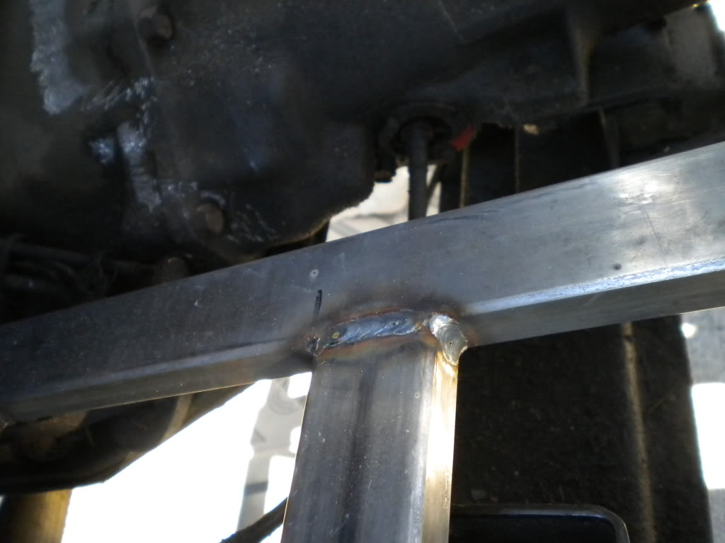

upclose of welds.

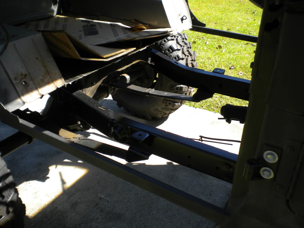

this is the side shot. i used a hole in the frame to add a 3rd body mount per side. (daystar sent me way more body mounts than this turd has). i angled the back of the sub-floorboard so it matches the angle of the frame. still a long way to go to get this thing project finished up but i ran out of metal. i'll get more on monday or tuesday.
