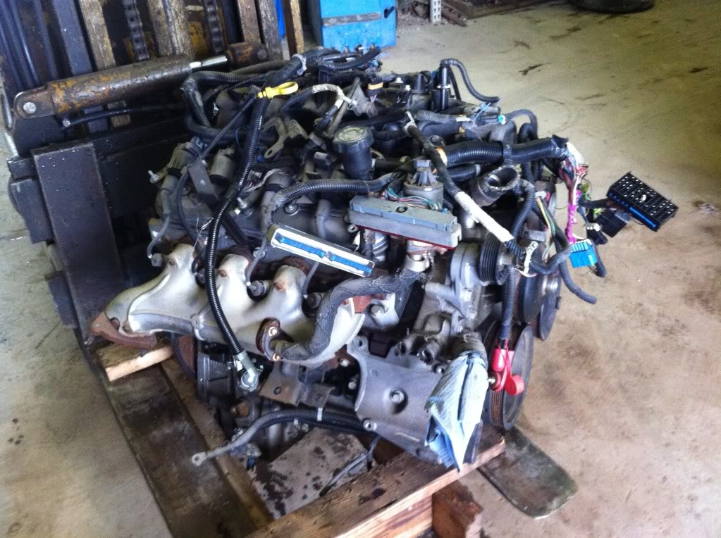

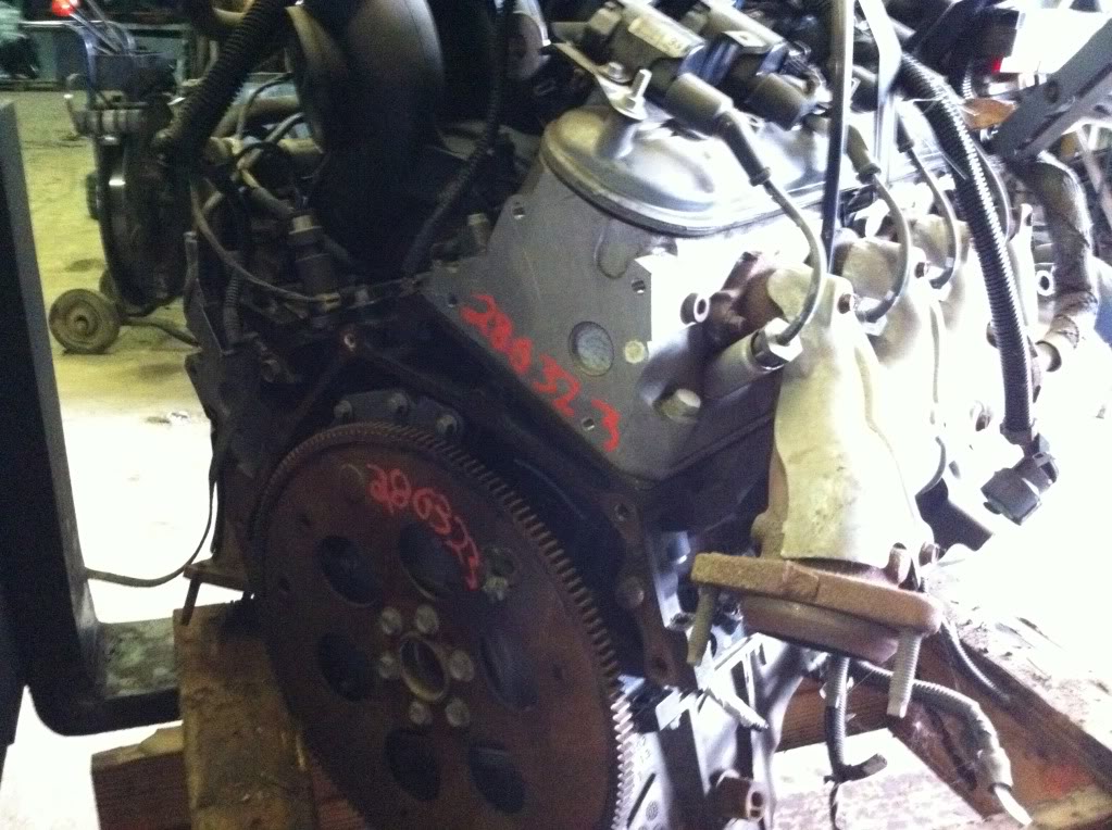

As you guys know, my original plan of running a 4.0L jeep inline six has been thrown out the window. For the same cost, I could run a modern chevy v8 with better power and better fuel economy than the jeep engines, and a v8 is just damn cool in my book! So enough of the rambling...this decided to follow me home today. A 2000 GMC Sierra 5.3L V8 with wiring harness, computer and everything else to make it go vroom (except an alternator)! hopefully?! haha! I'm really starting to freak out since I'm to the stage where i am getting to the motor/drivetrain swap. I'm sure I'll be needing a lot of help from all you guys so get ready for some questions. i'm going to try to gut the factory wiring harness since i don't want to spend $700 for a new one from painless or holley or somewhere else. It looks like it will be a pain in my ass but i'm going to give it a valiant effort.
i'm ready for it to run. with 295hp and 335ft-lb of torque, I hope I don't twist up my frame like a pretzel. I guess I better get my welder out and start plating EVERYTHING!

Thank you guys for all the input. There were some great choices brought up but this option ended up being the most cost effective for my build and I couldn't resist the price. Supposedly it "runs good" but i'll find out shortly i guess. Wish me luck! I'm going to need it.
i thought a D300 was pass drop, arent you running a ford d44?
engine looks beastly though, where did you snag it? the u-pull down there?
5.3?! AWESOME!!! Hey man, let me know if you ever need a hand. I just moved to south Charlotte, and have too much spare time on my hands.

I found it on a site --www.car-part.com and picked it up from B&B auto sales in Charlotte. Seemed like good guys but you never know with used parts places. you know?!
I usually work on it every weekend. I could always use a hand. I'm definitely going to need some assistance figuring out how to get this wiring harness stripped to the bare essentials.
Generally speaking, I could basically plug in all the wiring and disable all of the security and emissions info on the computer and it should run. Then I could use a pin out to strip the extra wires. sounds easy but it will be much more complicated then that. haha!

When I did my motor swap, I grabbed a Factory Service Manual for the car that the motor came from. It showed the wiring for the computer and told me everything I needed to know to mate it to the Jeep's harness. The cool thing about the Chevy is if you can get the power to the fuse block under the hood, throw a little fuel into the cylinders, then it should run. Of course there is some more to that but thats the basic part of it. You might want to check out PCM4less.com as they can do wonders for a chevy powerplant with the computer tune. And they are very quick to turn it around for you as well.
If u thin the harness or want to know what u can cut out, give Aaron at trudyno sports in conover a call. He's tuned a number of lsx in buggys.

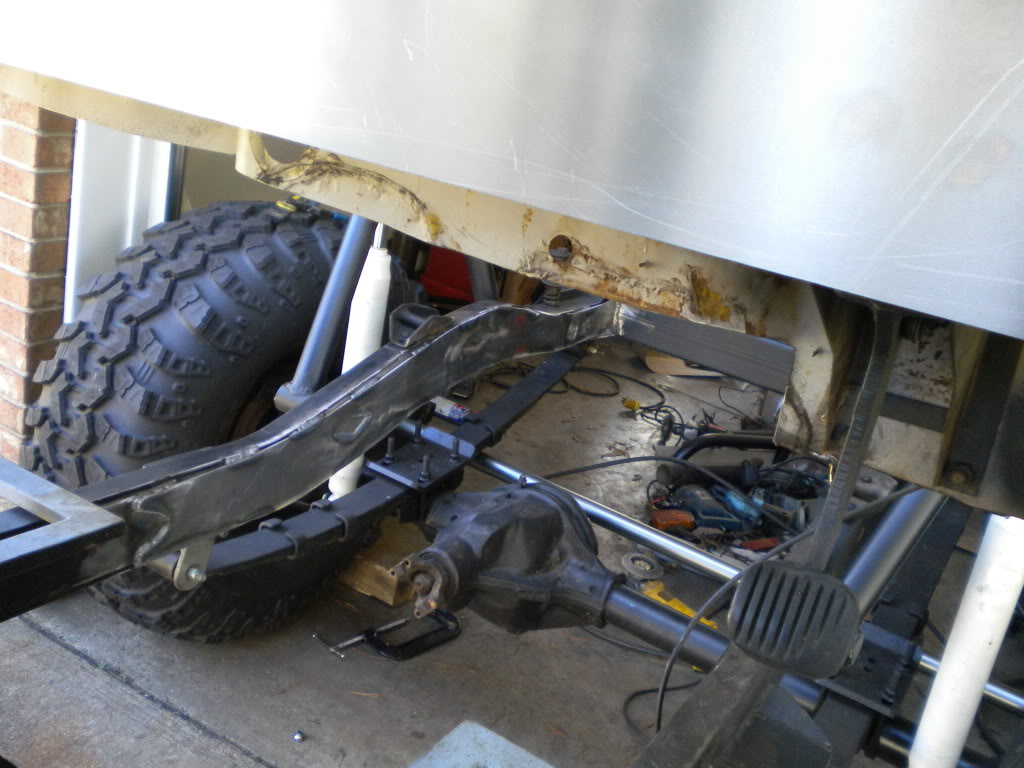

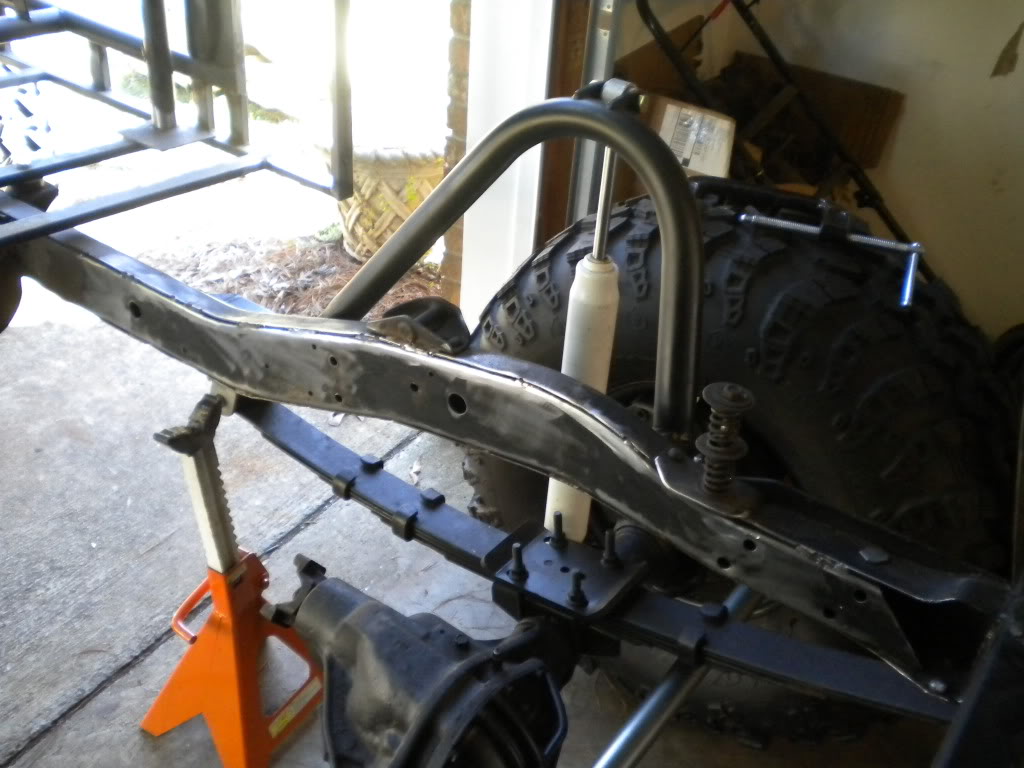

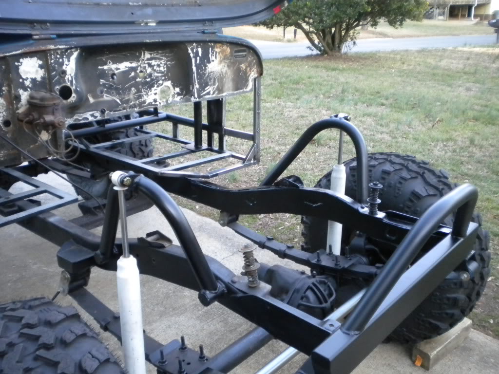

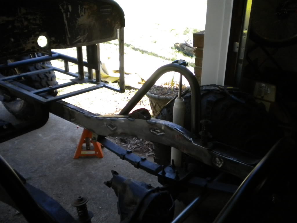

I got quite a bit of work done over the weekend. I'm trying to prep the frame and get the body setup so I can get the motor in it.

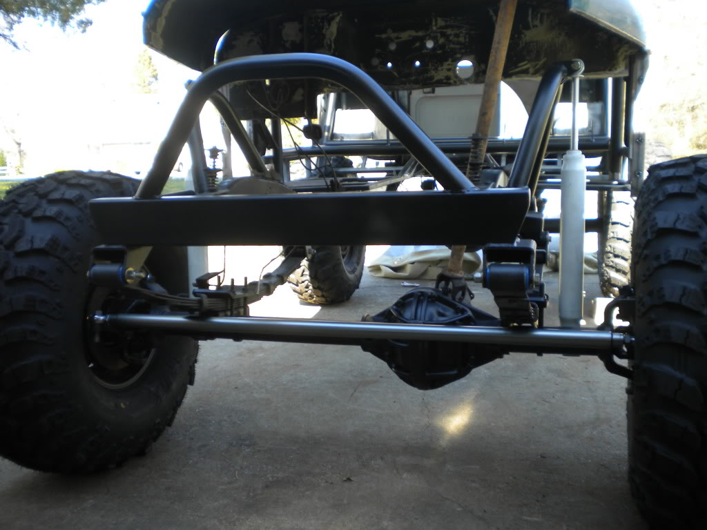

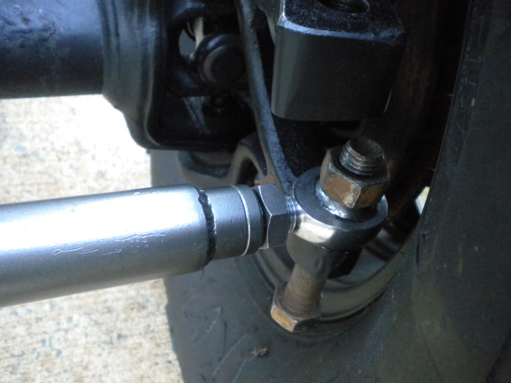

painted up TIG'd tie rod.

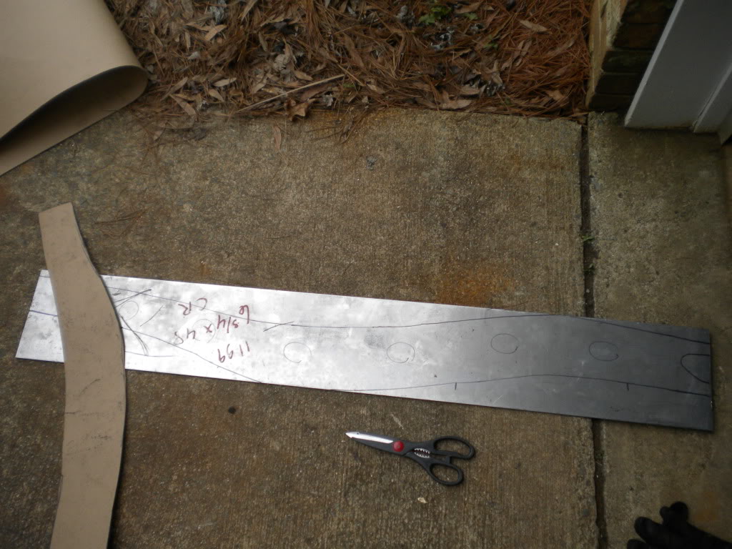

the frame plating that I made. This is the sharpie'd up metal. It's 1/8" plate.

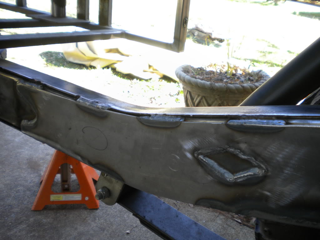

frame prepped before welding the plate on.
welded up.
upclose.
another angle.

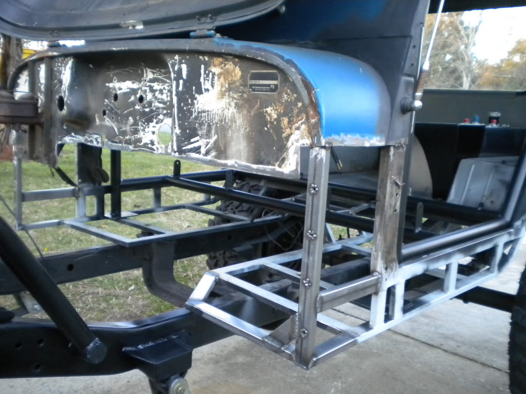

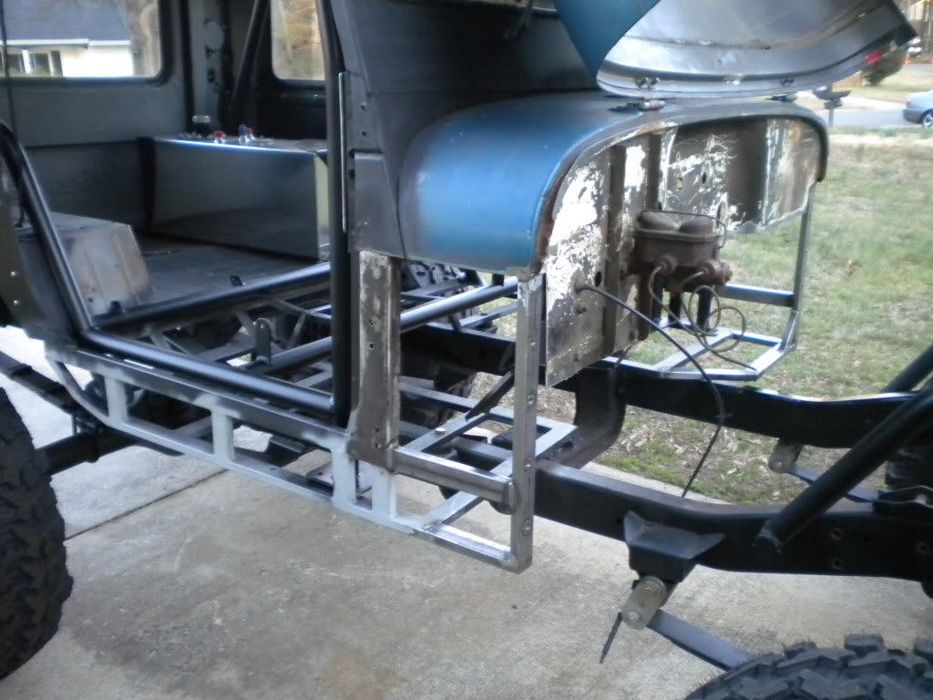

I also started adding supports to the cowl/firewall area. You can also see the passenger side framerail painted up.
I also drilled and welded in nuts on the new firewall/cowl area where the new tube fenders will bolt up.
Opposite side more complete.

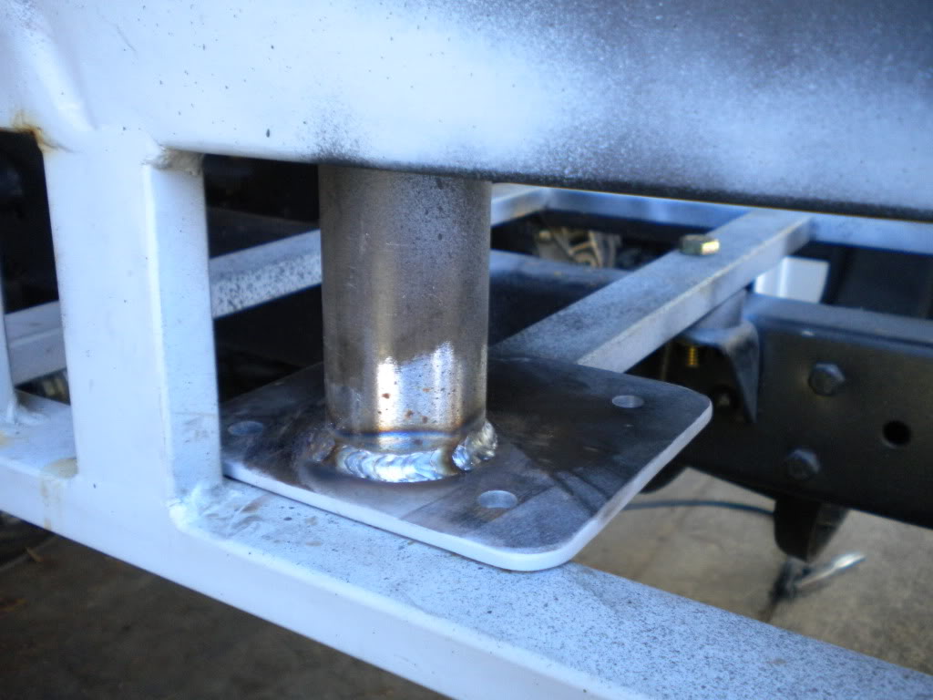

I also fab'd and welded up the front rollcage floor plates. Thanks to Chris at MarsFab for giving me some valuable pointers yesterday at his welding class. It's making my welds look better and better. :beer:
those welds do look good. what kind are you using? i'm laying flux core now, but i want to get gas one day
Thanks man! I'm using .035 wire with gas. My machine is a Miller Millermatic 185 and I couldn't be happier with it.

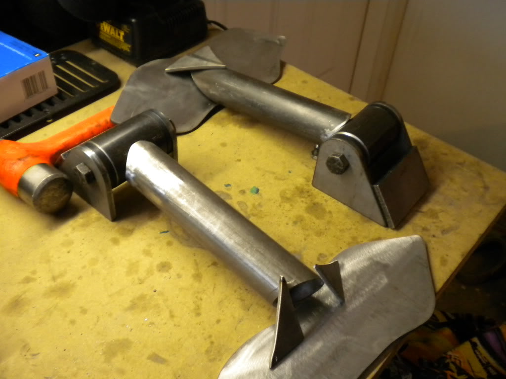

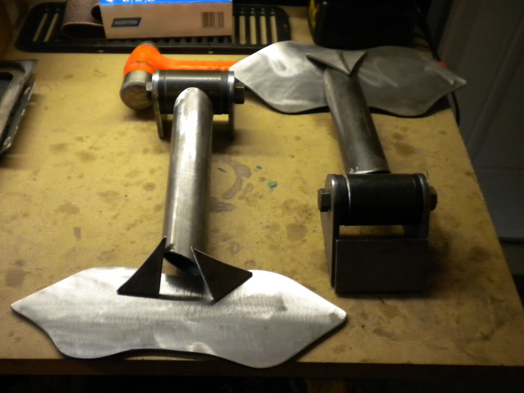

With today's shitty weather, I couldn't get much done so I built the motor mounts in the garage. I didn't want to pay for pre-made ones so this is what I dreamed up.
another angle. The wavy pieces will be welded and bolted to the frame.
