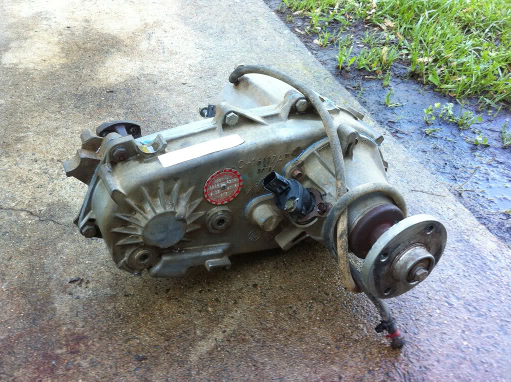

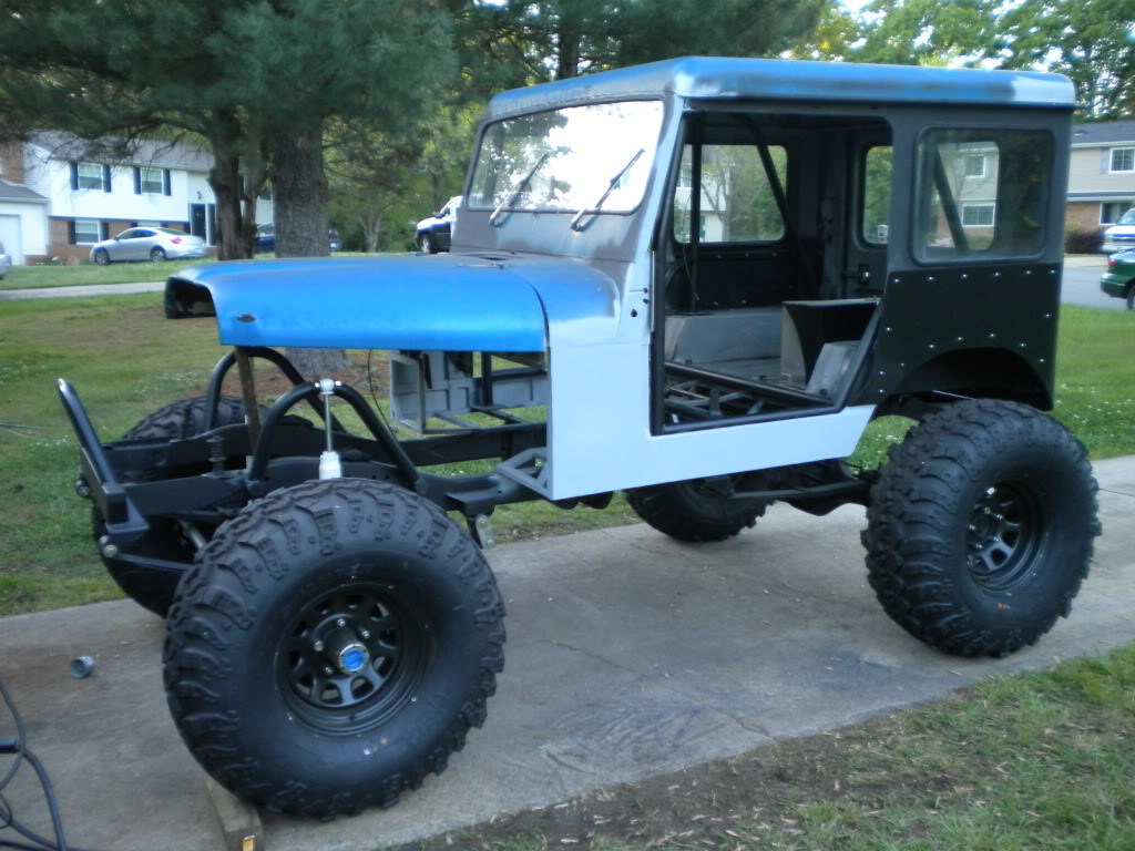

Thanks for the info guys! I'm considering a Dana 300 but by the time u add the custom adapter + flip kit + clocking ring you're looking at some serious dough! Damn near close to atlasII or stak case pricing but it'll leak unlike those. I think I might do an np241 or np231 + sye and upgraded chain and build a custom case down the road. I'm wanting to have this thing wheel-able by the end of this year and I can upgrade the case down the road as needed. I thought eb Dana 20 but I don't know of anyone that makes a sm465 to eb Dana 20 adapter. Novak and AA just do sm465 to heep Dana 20 cases.

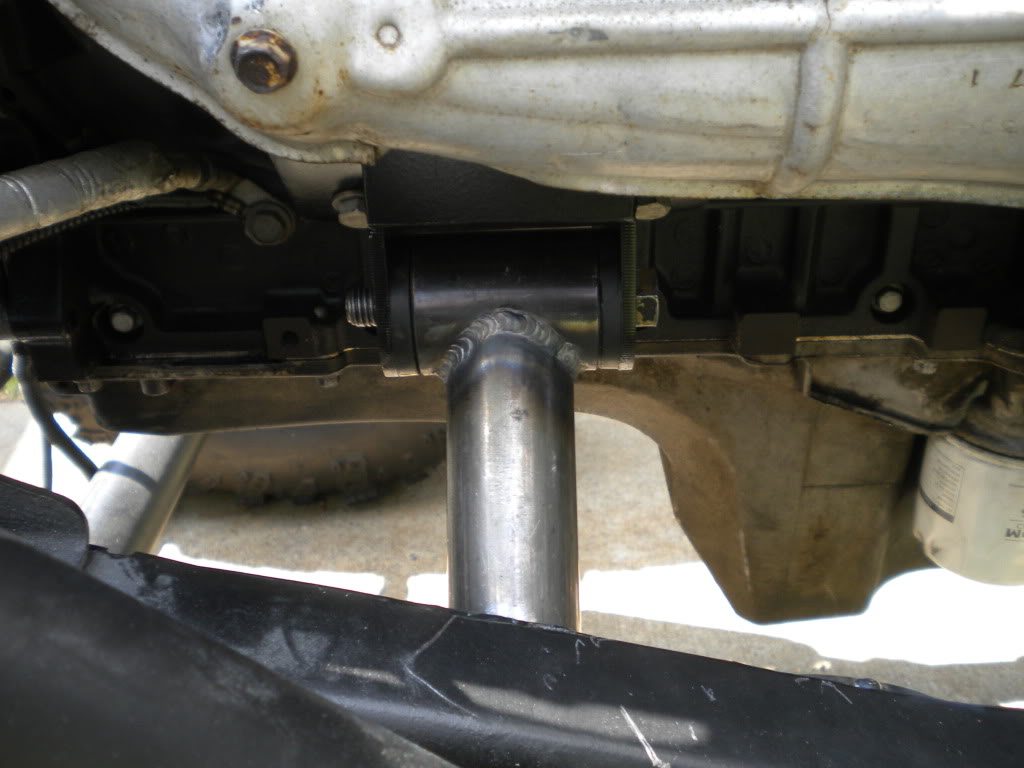

I'm planning on using some junkyard parts to put together my hydraulic clutch system. I'll see what I can come up with.
