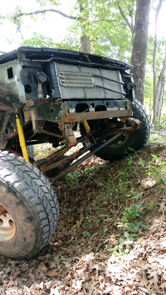

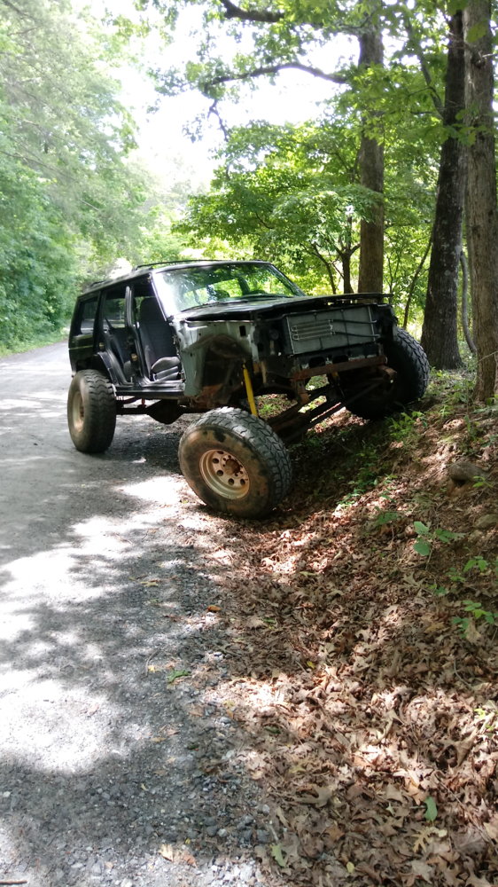

I agree! There's a reason I've missed last 2open rides and it's not until my steering feels up to par will it be ready to go. Sure I can't prevent everything but I know how my last jeep steered with welded front and this one just isn't there yet. Wj pump, piston mod, and cooler are set and working great (can dry steer these 37s easy) but once rolling just hasn't "felt" right...then I found loose bolt yesterday on drag link, stupid me. Later today will tinker and fix that and looks like it will fix the looseness.Well built rigs have broken on trail heads and people have died and been injured due to steering problems.
Steering is no place to half ass. It is that critical and shouldn't be taken lightly.
Yeah but I'm used to that ...my yellow one steered flawlessly
No took those out as told to..so that's what I was gonna try today on drag link is to remove those and limit the flex in it but tightening the bolt should fix it ...I think/hope since drag link can turnTo be clear, your yellow one was not a 4 link. it was either 3 link, 5 link, or radius arm.
Do you have any mis-alignment spacers on the tierod? If so, that will allow it to rotate and make your dead spot larger.
Daiiiiaammm..even I wouldn't go no where near that far with "cobbling" something together lol...wow whole new meaning to ghetto![]()
Why not try this?
Now I understand the term "dead spot"..that's exactly what it does but a lot..so with drag link being able to turn (stupid me, loose bolt) and too much flex maybe in that heim it should become more "normal"...will find out laterDo you have any mis-alignment spacers on the tierod? If so, that will allow it to rotate and make your dead spot larger.
The heim is 7/8 designed to go with 3/4bolt so I drilled the arms for 3/4 and all is tight/right..Did the misalignment spacers change to through bolt size and if so now you have play from the wrong size bolts
Unless I'm missing something
, soo now either wheel it like it is or back to drawing board. Everyone told you that this was gonna be the case..
Main problem is the long bracket I made onto tie rod. Tie rod has small 1/8side to side play...well since my bracket is 8-9"tall, that 1/8"play transfers into 7/8"-1" of play up top, soo now either wheel it like it is or back to drawing board.
Ok ok it drives fine without it...remember I did 40 with no shocks lol. However with track bar and crawling like I would a trail, track bar are like 40%difference. Like Mac5005 used similar,.. Several xj leaf packs together with 2main leafs so it flexes real good but soft ride still, so they give a lot. Track bar just takes away an extra 20%body movement that's all.Probably because the axle is not straight, and the shackles seem a little flimsy... I have never had a Trac bar on any of my leaf sprung trucks, all drove fine...
And I thought I was persistent lol lol. I know this but gotta use it now that its done lol, at least once or twice1- install a high steer arm on passenger side (we told you this)
2- your track bar is attached backwards (we told you this)
3- there are steps required when welding to cast iron/etc above what's required to weld to steel. (we will have told you that)
Thats funny right there3- there are steps required when welding to cast iron/etc above what's required to weld to steel. (we will have told you that)
It wouldn't be me, it would be a professional welder so he would know all the proper steps..it was thoughtjust because you use a 220 welder doesn't mean you'll have a successful weld from the cast/steel
Both metals must be very clean, preheat, correct rod, post heat, ect.
I don't think it's worth the risk
This is my last concern hehe, it works and deal with that cheap later, got more important issues at hand hahayour track bar is attached backwards (we told you this)
