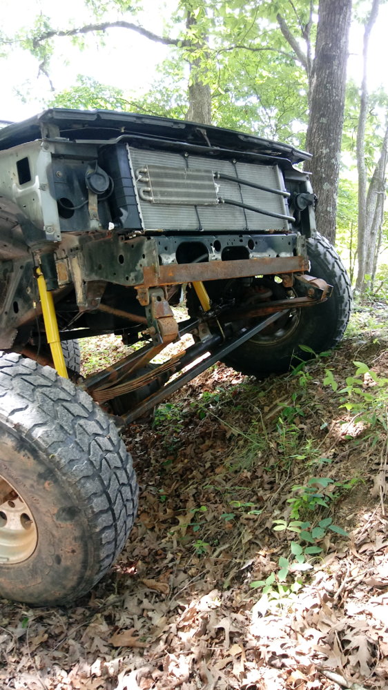

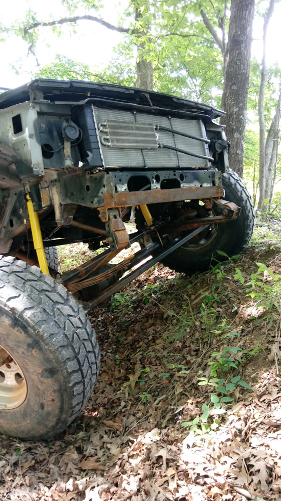

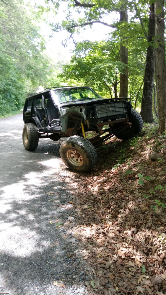

Here's how much the leafs give, especially the uptravel, and yes the front of leafs aren't tied together so the pinion rotates up a little rather than staying level (my yellow xj did real good in the rear like that)
View attachment 248278 View attachment 248279
Is it me or does it look like the shock body is contacting the frame and bowing slightly in these pictures?
