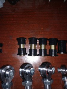

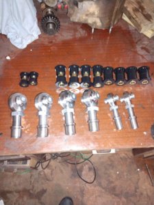

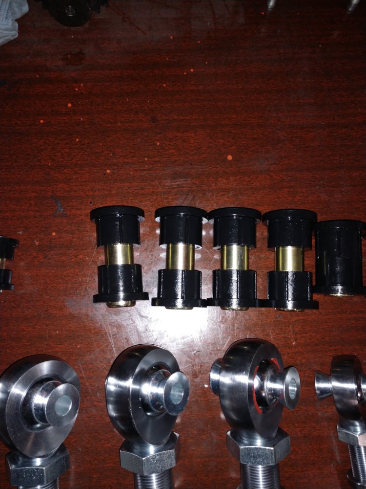

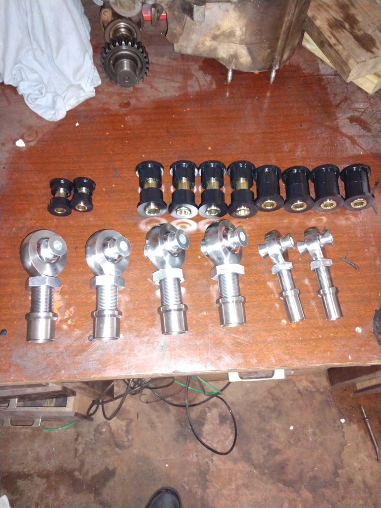

So are the 3.5" bushings supposed to look like this or did they give me wrong bushings
(Gotta say these 1.25 heims are straight BEEF)

You need some tube to put the bushings in. Or maybe I don't understand the question.
I mean like how the bushings don't fit the whole sleeve..is that the right way. Thanks
The 2.5bushings cover the whole sleeve but bigger ones don't..so it's just how they come
Oh, I see what you mean. Yes - that's how I've seen them come. The only difference for the wider bushing was a longer sleeve. I've also pulled bushings out of leaf springs that were set up the same way.
