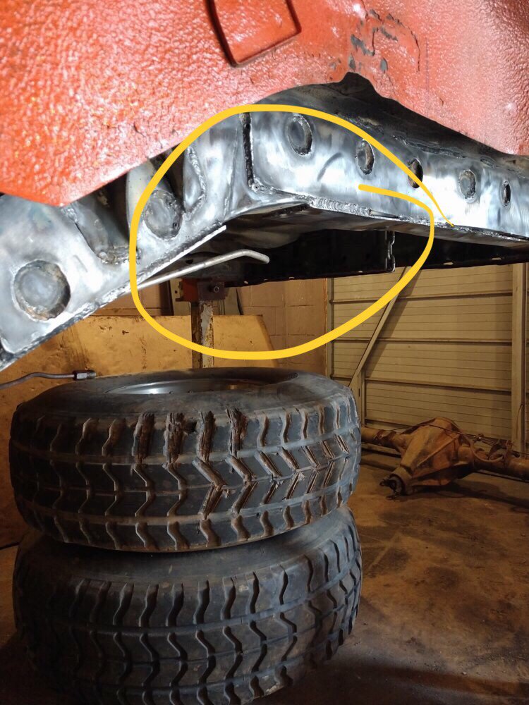

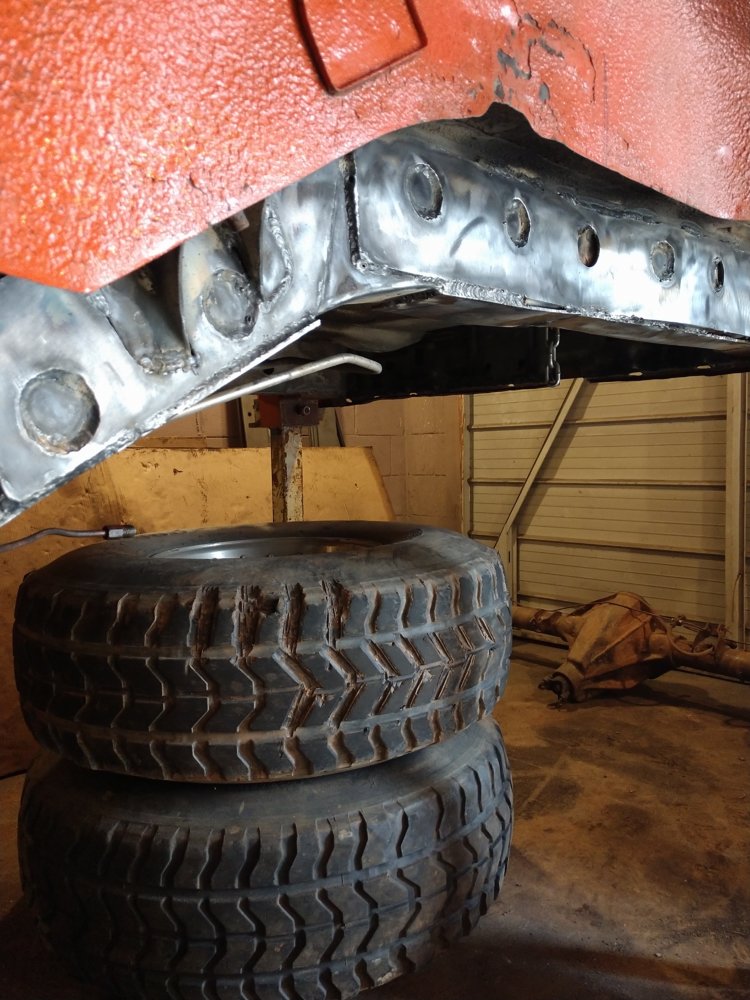

Yeah I am, got lazy and started on other side.. I'm getting there![]()
If that bottom has a gap in it like it looks like it does. You’ve made a weak place in your playing right where xj tend to bend and crack anyways. You need to add a piece that fallows the contour of that bend and then add a fish plate to make it stronger on bottom and the sides
