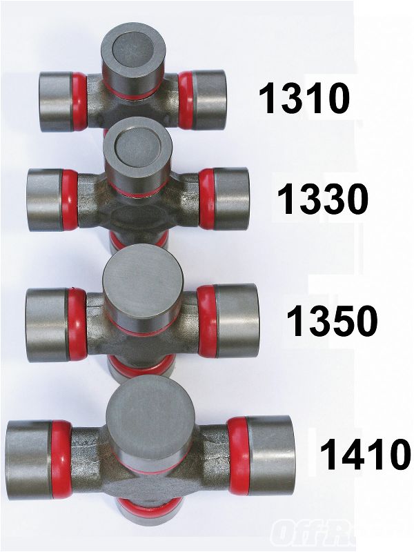

If it’s second gen dodge axles it should be 1350 but measure to be sure. Hell take the yoke off and take it with you to the parts store. They make a conversion joint too so you can run a 1350 pinion yoke and 1310 driveshaft yoke.

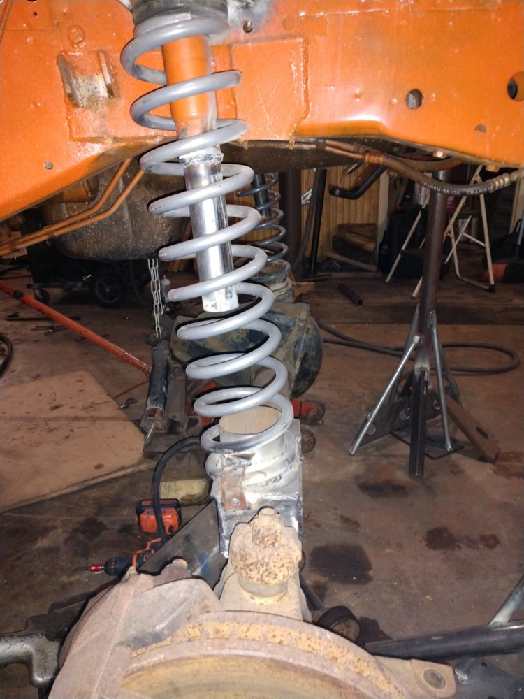

How do I know where the ride height of axle without the spring in place and weight of Jeep on em?
Huh??? I've never done that in all my years. IvI' only ever done it this way.
Well, you sorta just said so...you said that the suspension will squat another 2-3" with the weight on the springs...so, measure the static height of the spring, subtract however much you anticipate the spring compressing, and that's your static ride height (relationship) between axle and frame.
