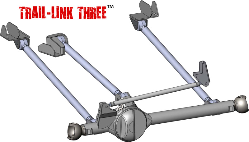

I would do a true 3-link like this instead of a Y-link.
This!! I have ran the Iron Rock on a ZJ and XJ. I have run the rough country on both platforms as well. When I got rid of it and went full 3 link it was night and day difference!! Take your time. Set the Jeep and axle in proper relation. Build your link mounts. Measure the distance and build pvc mock up links. Make sure everything is happy. Build real links. Fine tune.
