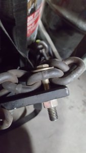

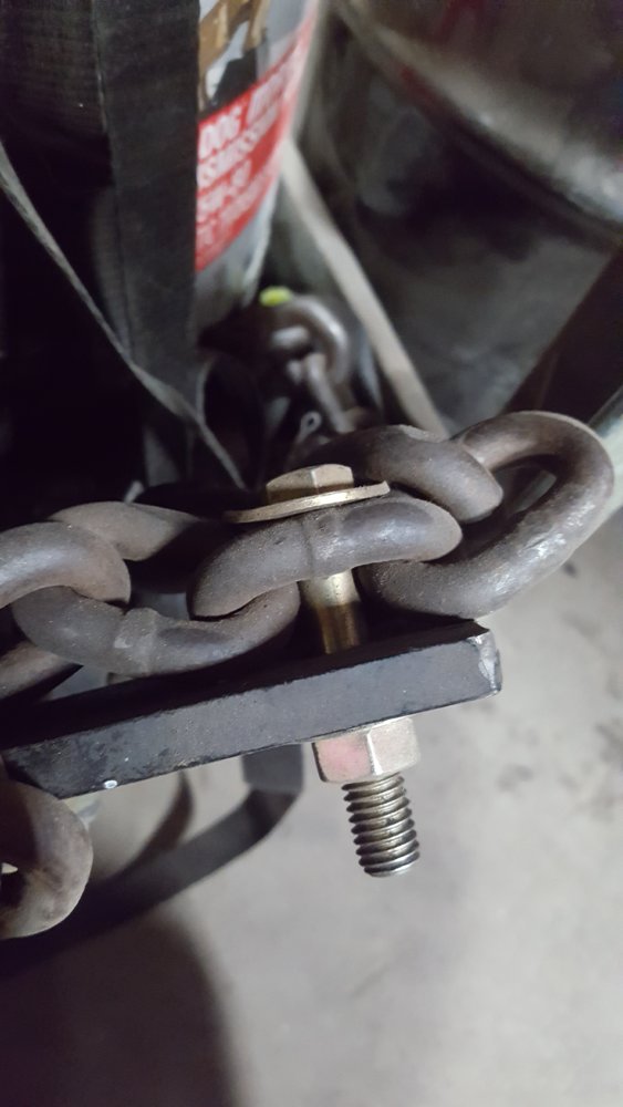

What lengths would work for you for the limit straps?
I have a small collection I'd sell relatively cheap
And let's see some homemade limit strap ideas..yes I'm a cheap butt with some things we know this already so don't go therelol
Well depending how I make my mounts I can make 20 or more work, probably even 17ish work if I make taller mountsWhat lengths would work for you for the limit straps?

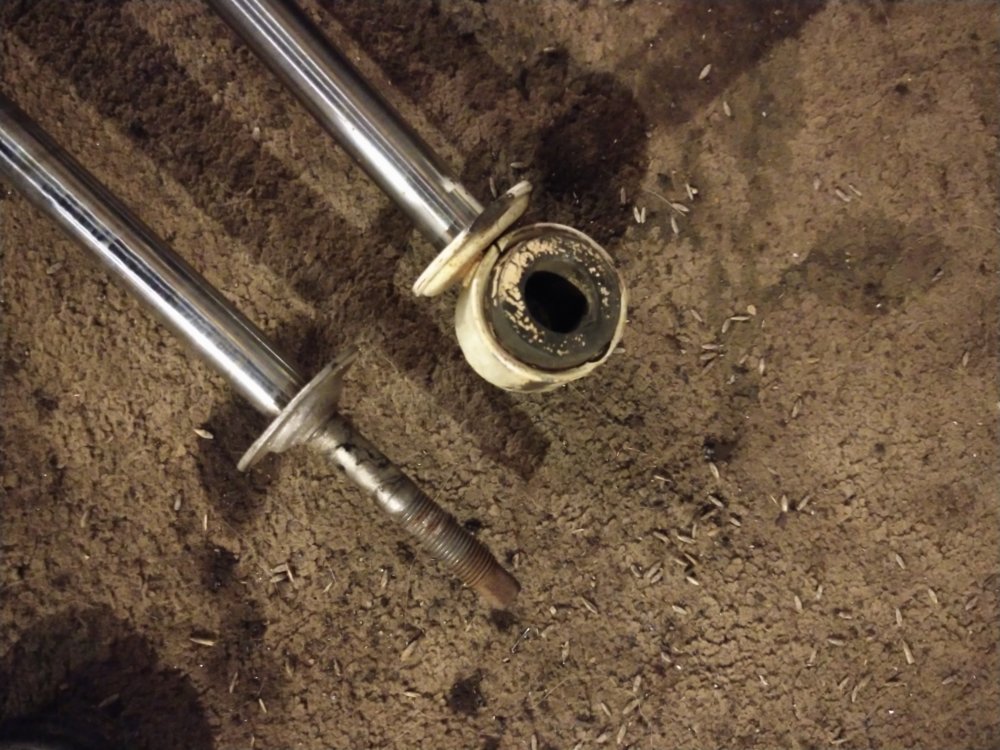

Thought on thisthere any reason I can't cut eye off and weld a bolt to the top of the shock on top in picture to bolt it in factory location
Thought on this
Thought on this

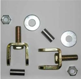

Buy or build something like this.
https://www.summitracing.com/parts/...EQZEb9oSwUVFbRxENWfWM0QjvO_97pBoaAmIuEALw_wcB
Oh yeah didn't think to make thisBuy or build something like this.
That's why chain was out of questions, last thing I want is more clanking. The coil springs rub on my centering tubes like I've always done and that's about all I care to deal with when flexing.x3.
On the limit straps, you can use chain or steel cable. Both of these make racket going down the trail though.

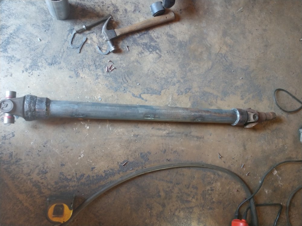

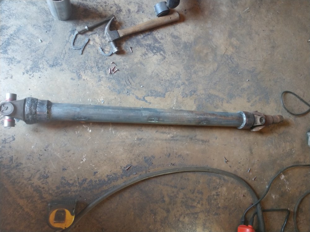

Is it straight? That 1" wide weave bead at the yoke scares me a bit. Do I also see rosette welds down the length of it?Now boys this right here is a dam driveshaft....almost 3/8 wall hooweii that ain't gonna be a weak link lol (hope not)
I call it the "tomahawk"
Tcases maybe haha, I actually have only broke 2 in 15yrs both times tcase went (didn't care I had spares lol)You sir should keep spare u-joints, yokes and transfer cases handy
The heck is rosette welds lol, plug welded yes both sides but rosette??? English please heheDo I also see rosette welds down the length of it?
It's beef and gets the job done...till I hit a dang rock and shear off the yoke or bend it...I'm gonna be pissed lolWell that's one way to do it.
Harbor Freight axle wraps.
X2 on this. I just bought cheap 10 dollar axle straps and made my mounts work to the length of the strap.
It looks funny I guess but it's strong, like the normal Fuller stuff heheYea if it works, it works
I just have a hard time liking the slip yoke
