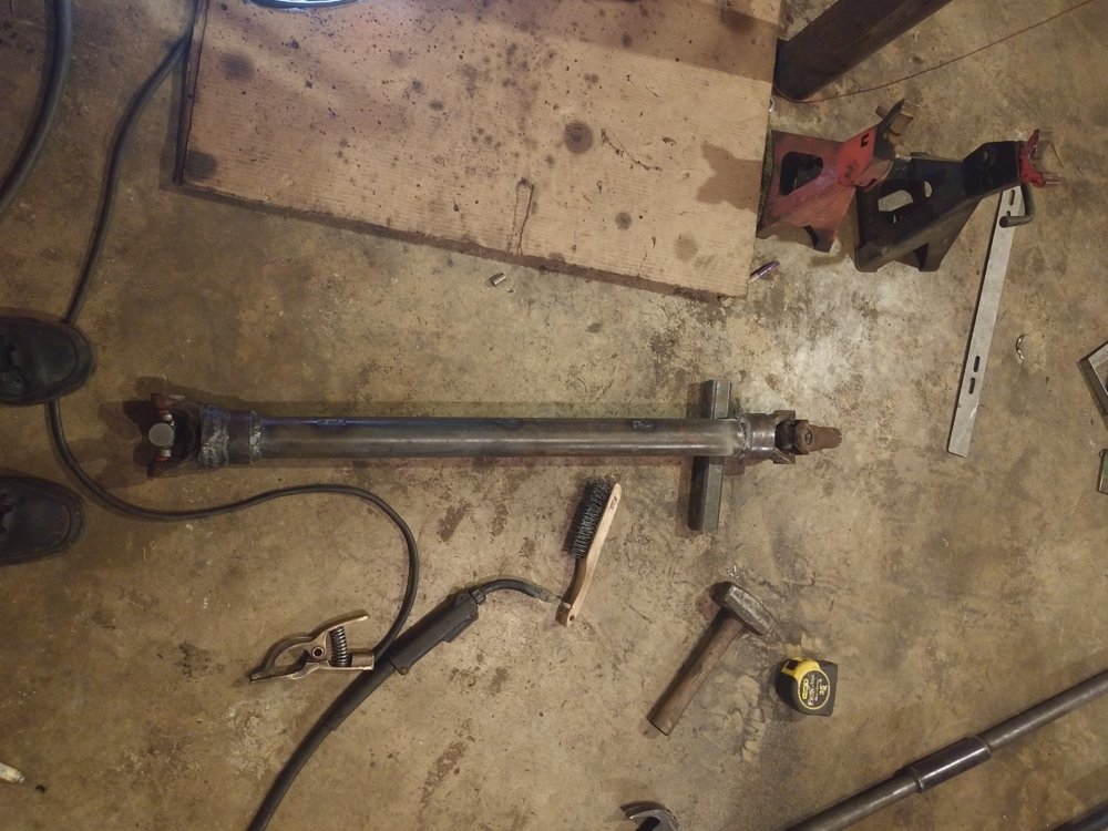

Shouldn't you have considered that before building the world's first 100 pound driveshaft NOT connected to a Peterbilt?
Ok so what the heck am I supposed to build then. I thought I was doing right building a thick wall one to hold up snagging on rocks..man y'all got me all confused
The point of my question is why did you build a solid 1310 rear drive shaft but 5 seconds later start asking about a 1410 yoke to fit aforementioned shaft?
IMHO, our hobby keeps us chasing the weakest link. By making that driveshaft so “heavy duty”, you’re gonna make something else the weak link. Some may say, something more expensive. A man can recover from a broken u-joint on the trail... broken transfer case, not so much. That much weight, rotating & vibrating, is gonna put unnecessary stress on your u-joints and cause them to fail prematurely and more often as well.
I'm confused, I needed to use a 1410 cause of the D70 once I realized that so figured make it beefy knowing I'm gonna hit on stuff often.
I get it other things will be weak now but at the same time a driveshaft breaking can also put a bind on output shaft at that moment causing tcase to break (aluminum xj housings are bad prone to this) so I guess my end result was beefy driveshaft with good pinion angle like my previous one and it should handle all the rpms the motor can give it..the other 1310 1/4wall did great on 37s even with all the rock marks all over it.
Contrary to popular belief and "facts", 2 np231s I've broke ever...both was me being stupid not caring cause I had spares so with my drivetrain, it's never been a weak link until I purposely beat the snot out of it. Just sayin, true for me though
I guess I'm open to rear driveshaft suggestions without getting crazy money involved
The super duper rear driveshaft you built, does it have a ujoint currently installed that matches the yoke currently on the Dana 70 rear?
I assumed the shaft was still rocking 1310 series joint. If it is still 1310, I was wondering why you put so much time intomit, knowing you need to change the axle yoke.
If I'm mistaken and the axle end matches the yoke, my bad.
No I got a 1410 yoke so the rear at axle end is 1410 full joint (no bastard stuff) and tcase side has regular 1310 yoke, stock. So is this ok then..
10-4. Didn't realize you did that.
I'd leave it, run it and see what, if anything happens.
So it's out of round a little, I've gotten them much closer to straight before so should I fix the little offness it has or let it go, thanks

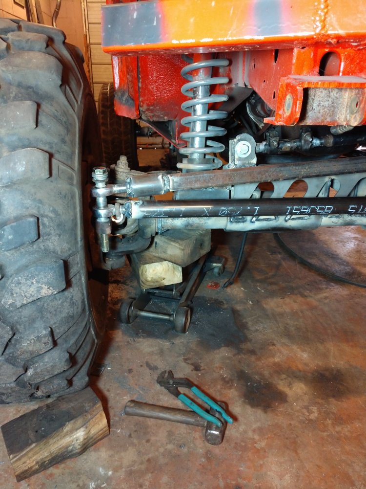

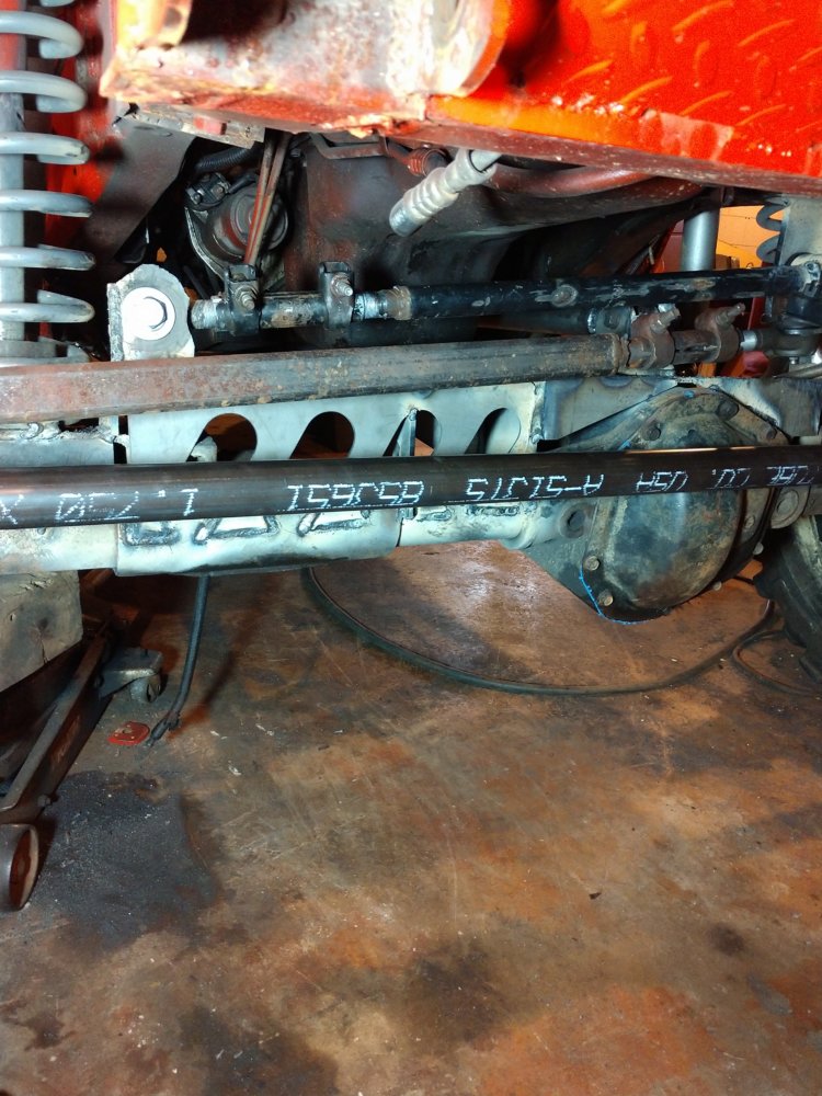

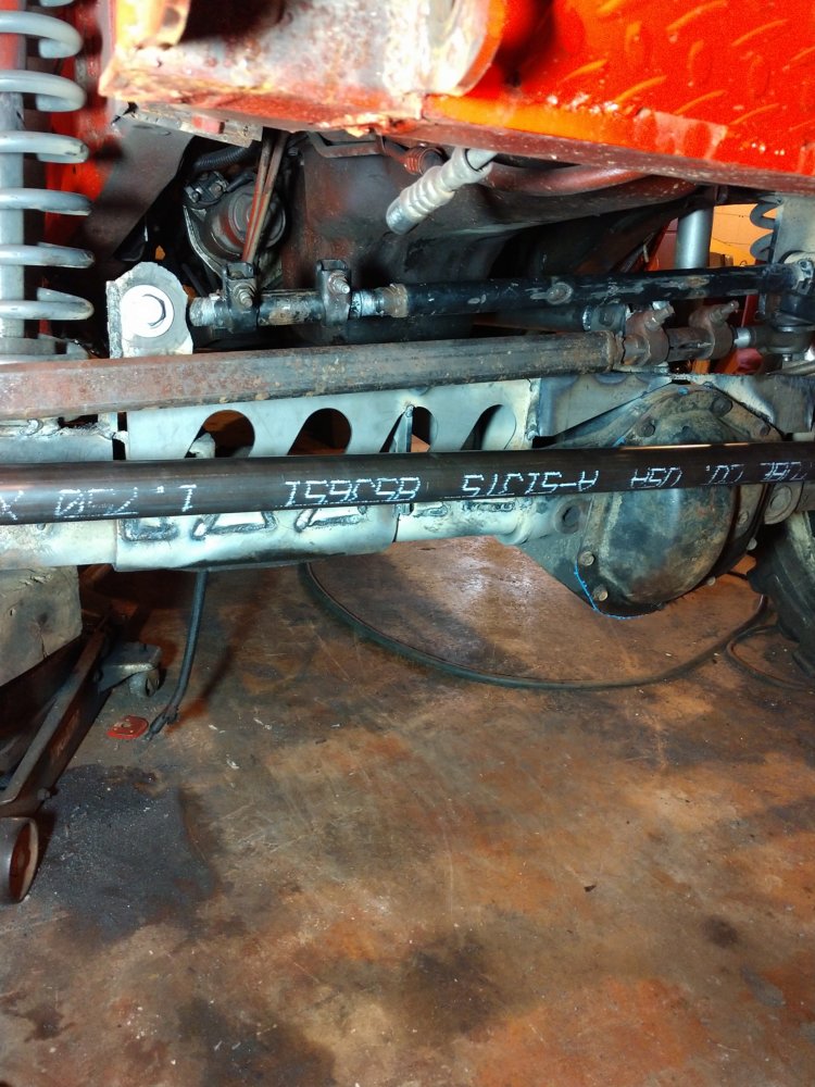

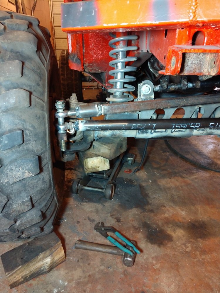

Nevermind I did it this way. Steering is DONE. Track bar is DONE. Woohoo
1/4 wall 1.75 tie rod, adjustable trackbar and ended up about as level and parallel as it can be.

You will need to add a high steer arm or something to that knuckle. Way too much leverage on it as it is. Will have a lot of slop too.

Are you sure that trackbar won't cave in your oil pan at full bump?
I see that tie rod hole in the knuckle breaking off the first time you hit a big hole or rock.
Dam y'all serious, first time I made straight and good angled steering nothing but negative...well this is discouraging
