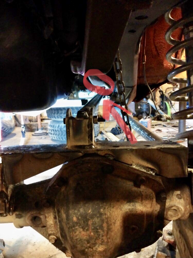

If your relying on the floor pan to be your bump stop to keep the trackbar from crashing into your oil pan and into the crank is a bad idea. That floor pan will never stop all that from happening, maybe with just jacking it up but with the full weight of the rig bouncing over bumps the floor will give in. Have you even cycled the suspension with no springs to make sure nothing hits?

No no I'm not using the floor just saying it would hit so I have to bump stop the driver side for that.
At 1" uptravel? That is going to be very lousy to ride in. Maybe you should think about getting some in person design help on the front.
Why, JKs run 37s on 3.5-4"lift all the time with 1.5" up travel or less so don't see the big deal. Sure it sucks for driver side flex up but it will work..I've had very similar setup before and rode just fine. Compared to any and all crawler I've had, this rig gonna outperform those by long shot and ride quality not even camparable. (In actuality I'm looking at it it's more like 1.75 before hitting floor board before I trim the floor)

Where is the control arm going to contact the floor? Near the frame side joint? If it has 1.75" of clearance there, that doesnt equate to 1.75" of uptravel at the axle.
As others have said, you really should pull the springs and compress the axle upto the chassis to see what hits when, and then bump stop it there. I bet you have more uptravel than you think.

This circled area is the floor pan right below the gas pedal. That is where the upper arm WILL hit. When I had my 3 link setup very similar and flexed out under full weight of the vehicle it hit and dented the floor pan in about 1.5 inches. Completely a non issue. But like has been said numerous times. Take the springs out, get rid of those stupid paper towel roll looking spring holder thinga-ma-jingys and cycle the axle. When the axle bumps take notes and set your bumps.

Ok sorry I thought if there was 1.75 before arm hit the floor that meant same up travel but now I see it doesn't so I guess I do have more than I thought. Shocks have 4" roughly before topping out so that should be plenty.
