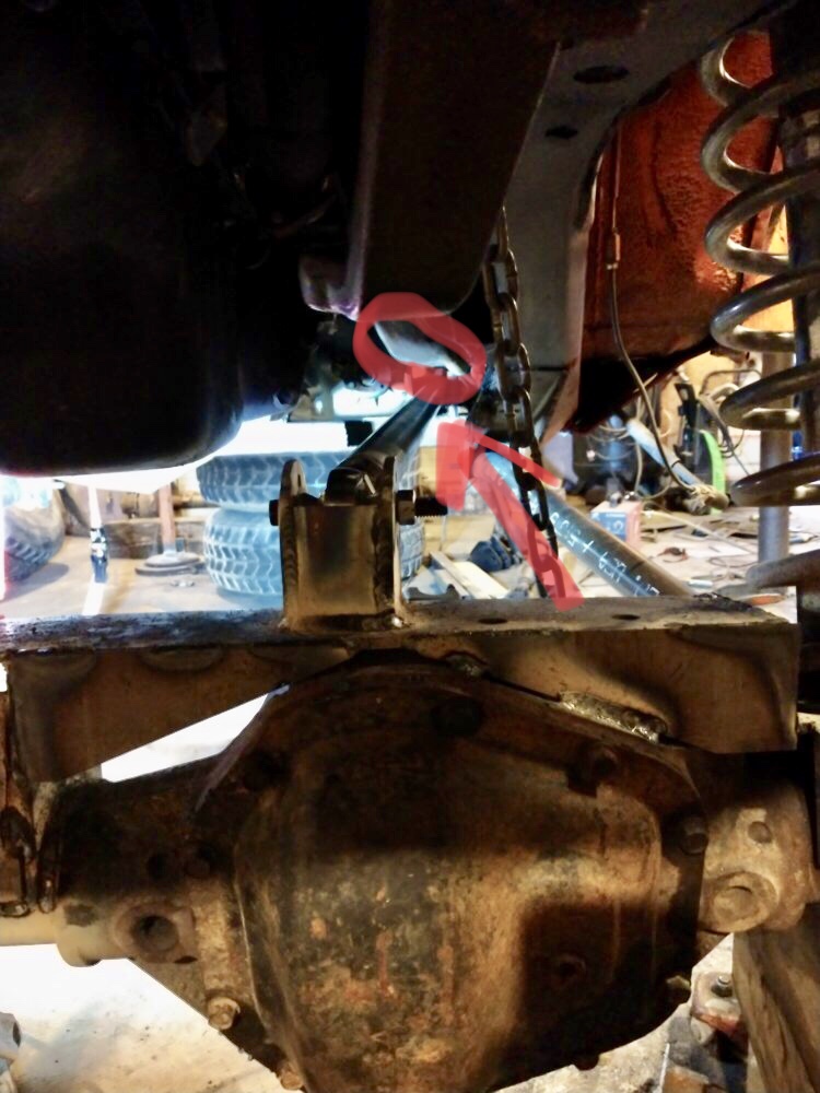

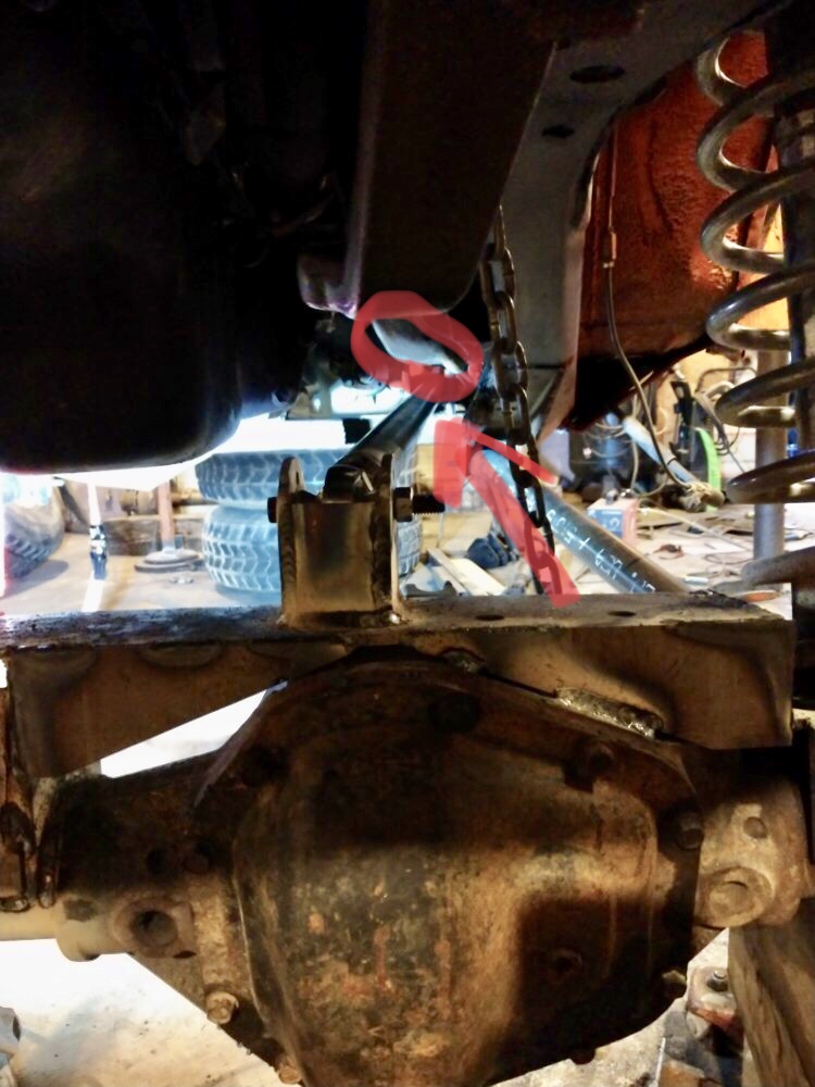

What about the trackbar to oil pan clearance?
The second pic is how it needs to be. I'd also be surprised if it didn't contact the top of the diff on compression (not flexing) the way you have it.
If your relying on the floor pan to be your bump stop to keep the trackbar from crashing into your oil pan and into the crank is a bad idea. That floor pan will never stop all that from happening, maybe with just jacking it up but with the full weight of the rig bouncing over bumps the floor will give in. Have you even cycled the suspension with no springs to make sure nothing hits?
Where is the control arm going to contact the floor? Near the frame side joint? If it has 1.75" of clearance there, that doesnt equate to 1.75" of uptravel at the axle.
As others have said, you really should pull the springs and compress the axle upto the chassis to see what hits when, and then bump stop it there. I bet you have more uptravel than you think.
This circled area is the floor pan right below the gas pedal. That is where the upper arm WILL hit. When I had my 3 link setup very similar and flexed out under full weight of the vehicle it hit and dented the floor pan in about 1.5 inches. Completely a non issue. But like has been said numerous times. Take the springs out, get rid of those stupid paper towel roll looking spring holder thinga-ma-jingys and cycle the axle. When the axle bumps take notes and set your bumps. View attachment 265895
